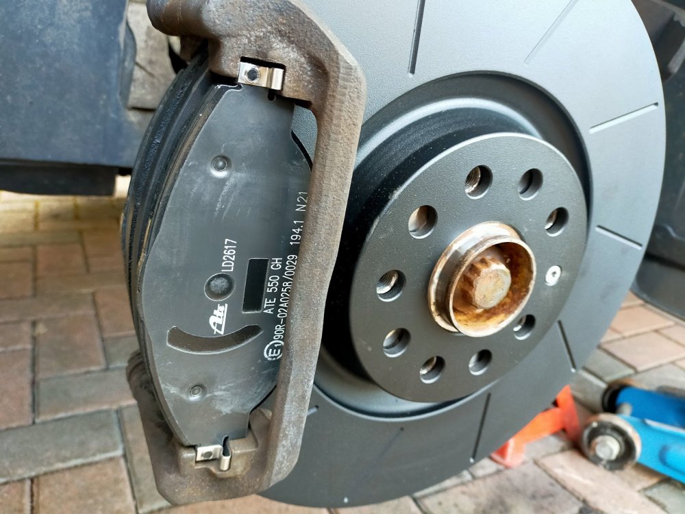

Very happy with my MTEC grooved front discs fitted in March - MTEC1807 - black coating so the centre hub doesn’t rust.
I paired with Ate Ceramic pads from Autodoc, which were slightly more expensive but literally zero brake dust on my wheels now.
Certainly stops well, and relatively straightforward to fit.
https://www.mtecbrakes.com/brake-discs/volkswagen/golf-mk7-2012/golf-2-0-r-12-2016
They certainly look the part. I'm looking at ordering the Zimmerman coated disc's I think.
