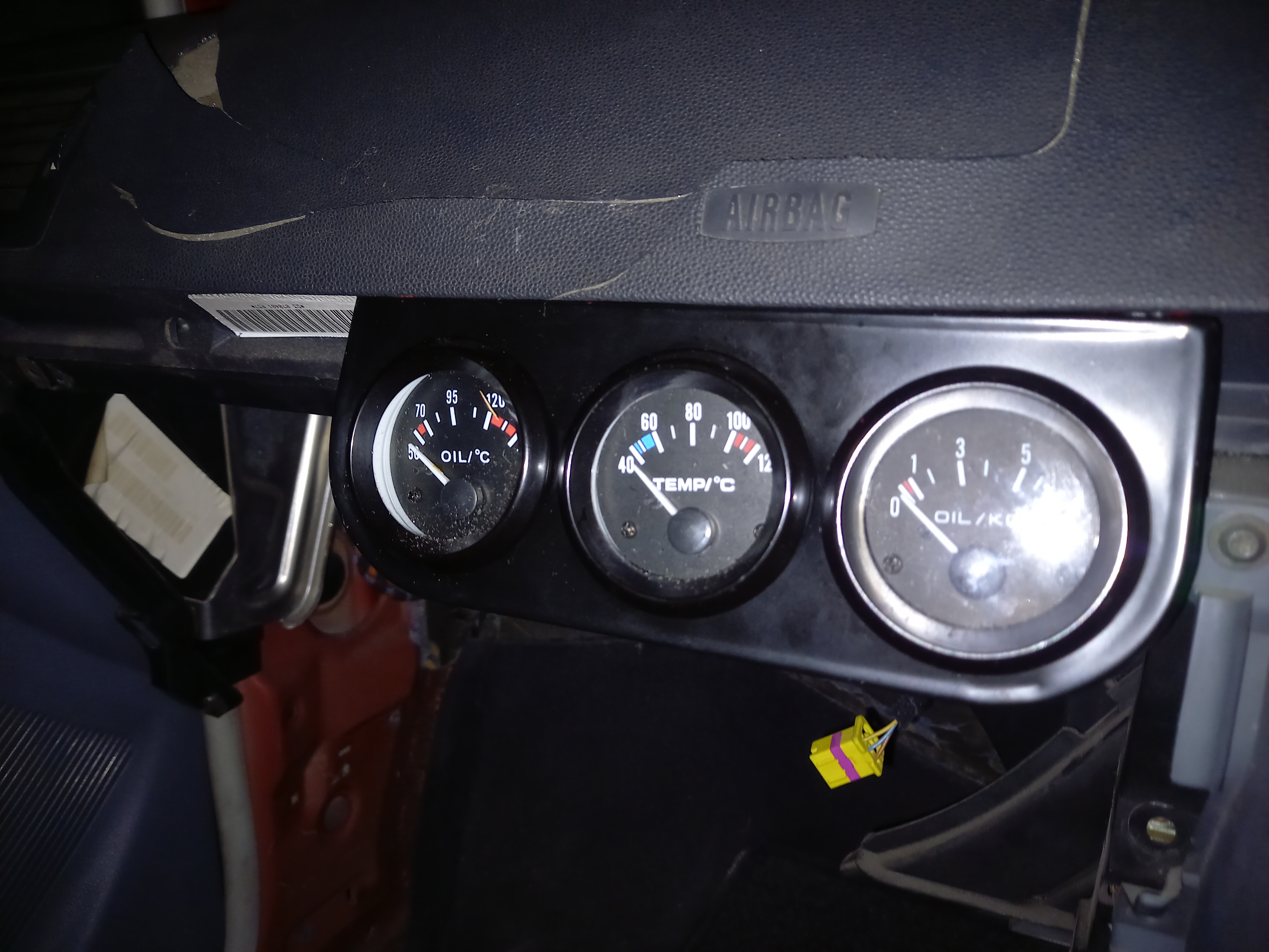

Installed the gauges on the remains of the dash the other day. Still waiting on some stuff to wire them up so they're just in place for now.

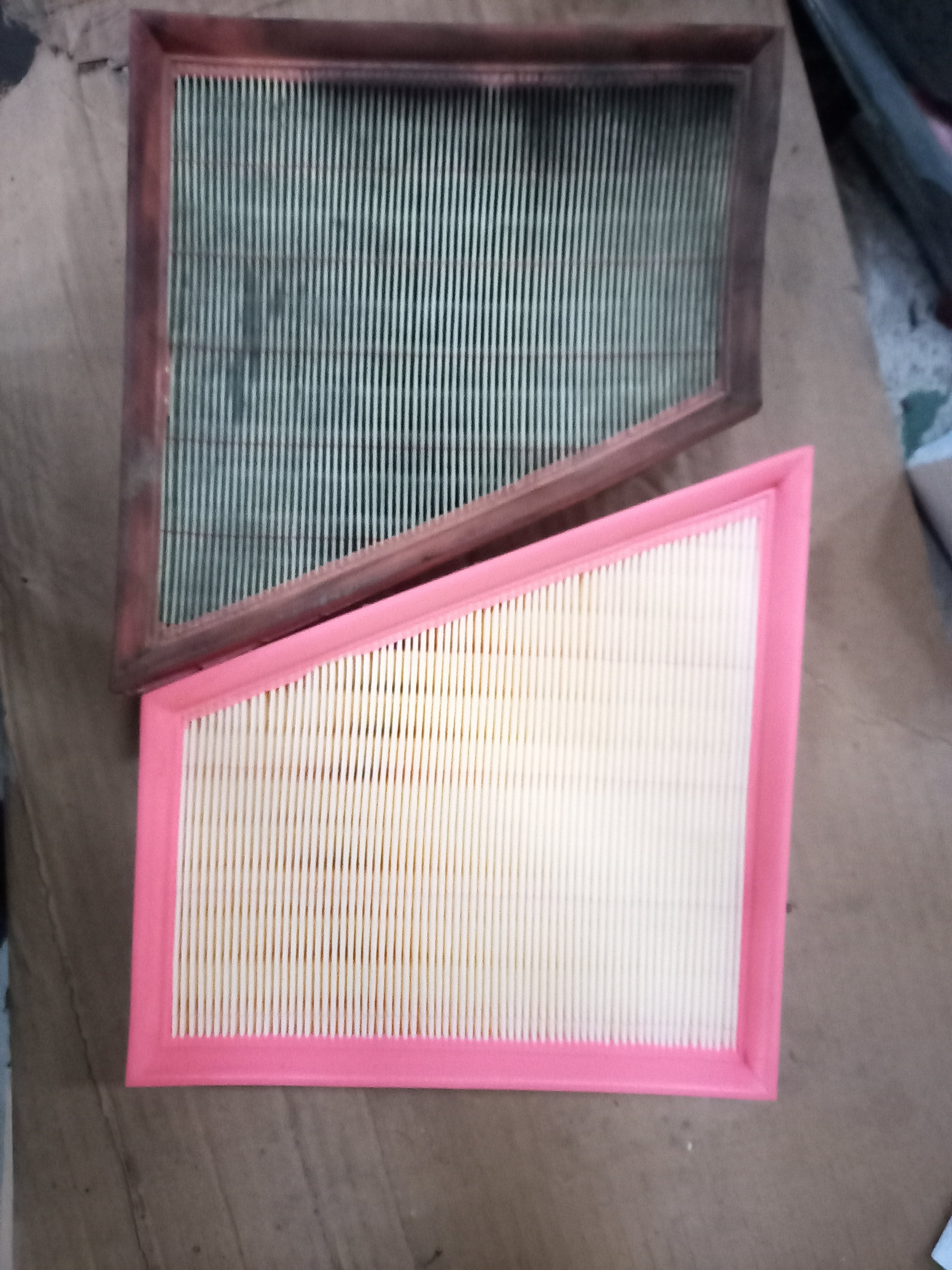

Got a new air filter for the fabia, it was on sale and for a fiver I couldnt pass it up. I knew mine was bad but I cant comprehend how bad it was. Pic isnt great and it makes the new filter look pinker than it should but still.

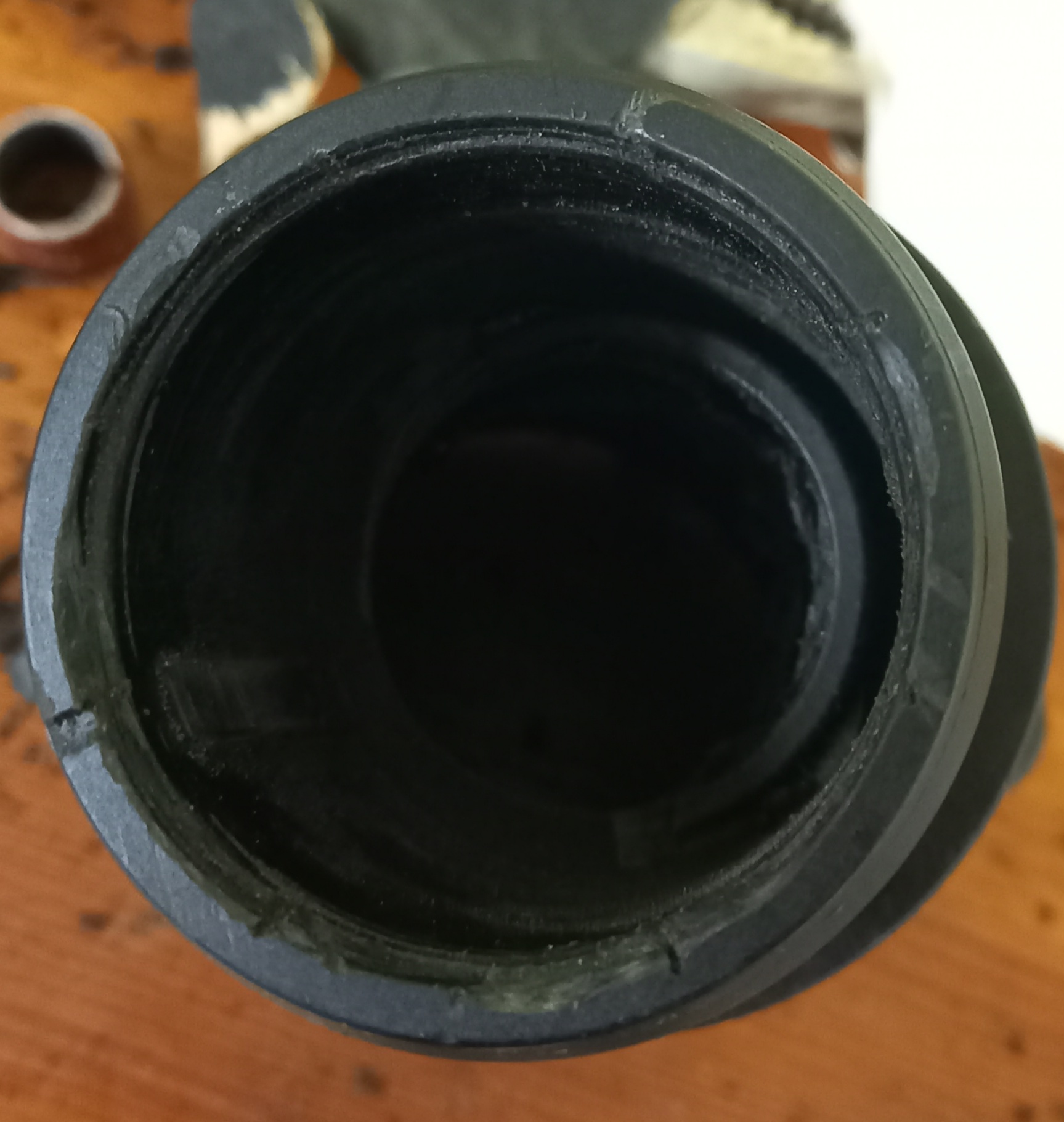

The pics here is the "near" finished product. I had bored the turbo side of it (big side) smooth, The o-ring is sitting under a ring that pops out, it pops back in easy so dont worry if you accidentally pop it out. I wanted to leave a bit of plastic around the "choke point" on the damper as I was worried I would burn through the plastic or weaken it too much, risking it snapping. when I had taken the worst of the rough out with a dremel I sanded it by hand with 120 grit then 800 grit to smooth it out slightly. I put all back and started it. I didnt record a video as it was midnight by the time I had it back together. On an unrelated note, this car sounds amazing without the air filter hooked up, I ran it like that to make sure I had tightened up all the hoses and that there was no boost leaks.

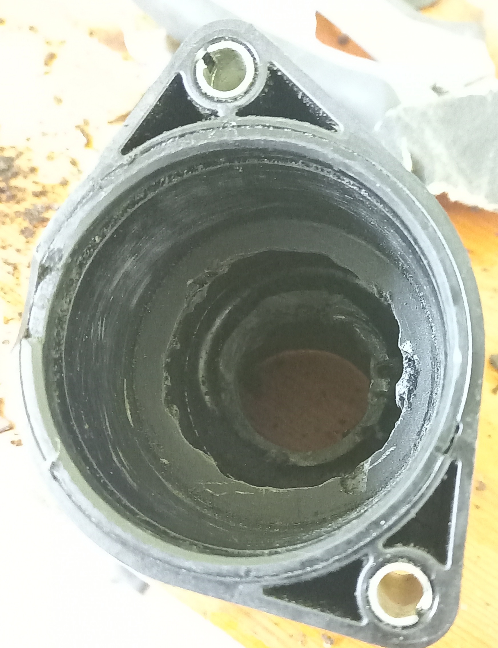

Pics below are of me partway through the operation. I cut out the "rings" from eachother and the cut portions from the rings to make them easier to remove. Oddly, its not a solid molded piece like I had thought. The inner piece is pressed into place so instead of having to bore out the entire piece, I could chip away at the inner piece and get it out separately. If I had a better way, or a vice, I might have been able to pop it out as one piece. The lower portion (wider part at the turbo) is molded in place however so you have to cut it out, the top piece (intercooler side) is pressed. Last pic is of the cars holes covered as I spent much too long going at this and had to leave it for the night.

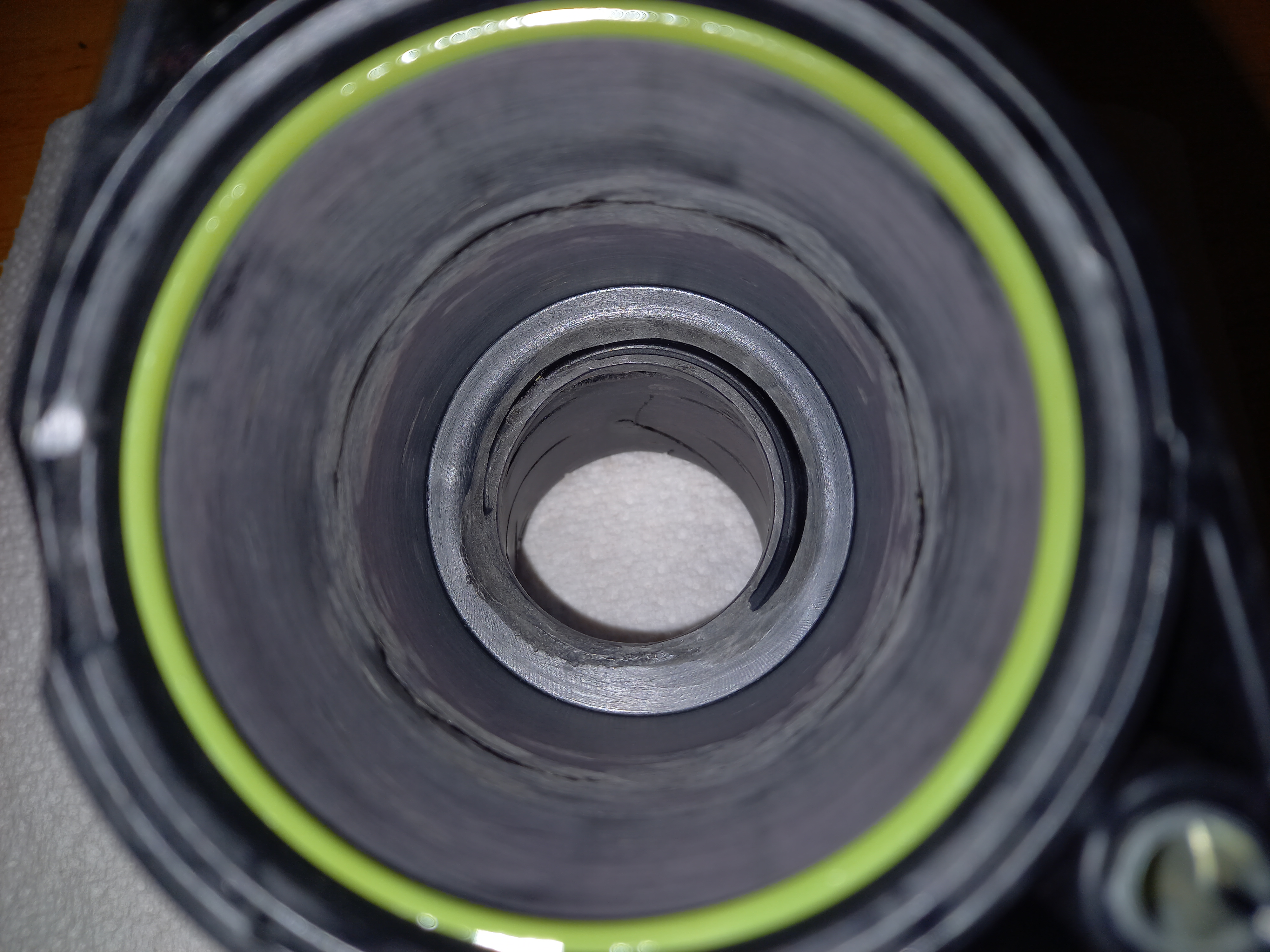

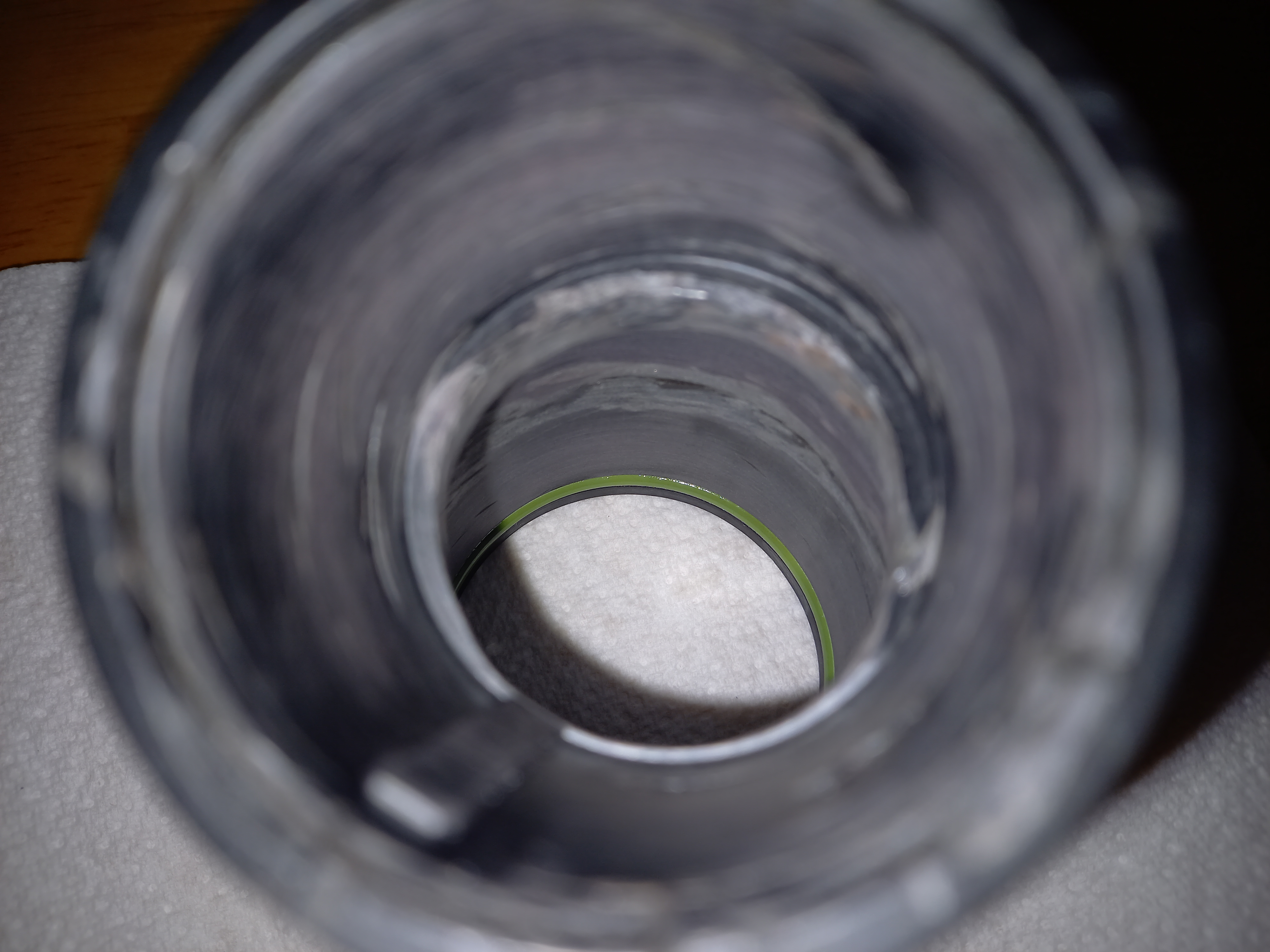

Pic of the damper off of the car. Hose was a MASSIVE pain and took an hour to get off of the car and then damper without breaking it. I ended up using a tool to remove bike tires to separate the hose without breaking it. Pic of the damper off the car with part no. You can see that the hole is much smaller than what it could be. These pics are showing the inside of the piece.

Did a thing the other night. I was going through old threads on briskoda and found one where someone had bought a spare turbo damper to modify and replace with the stock one. I researched futher and found that darkside makes a replacement piece, about £50 iirc. I also found that people have done this mod on tdi golfs. So I decided to do it myself. Pic related is the damper in question, just on the outlet into the intercooler.
