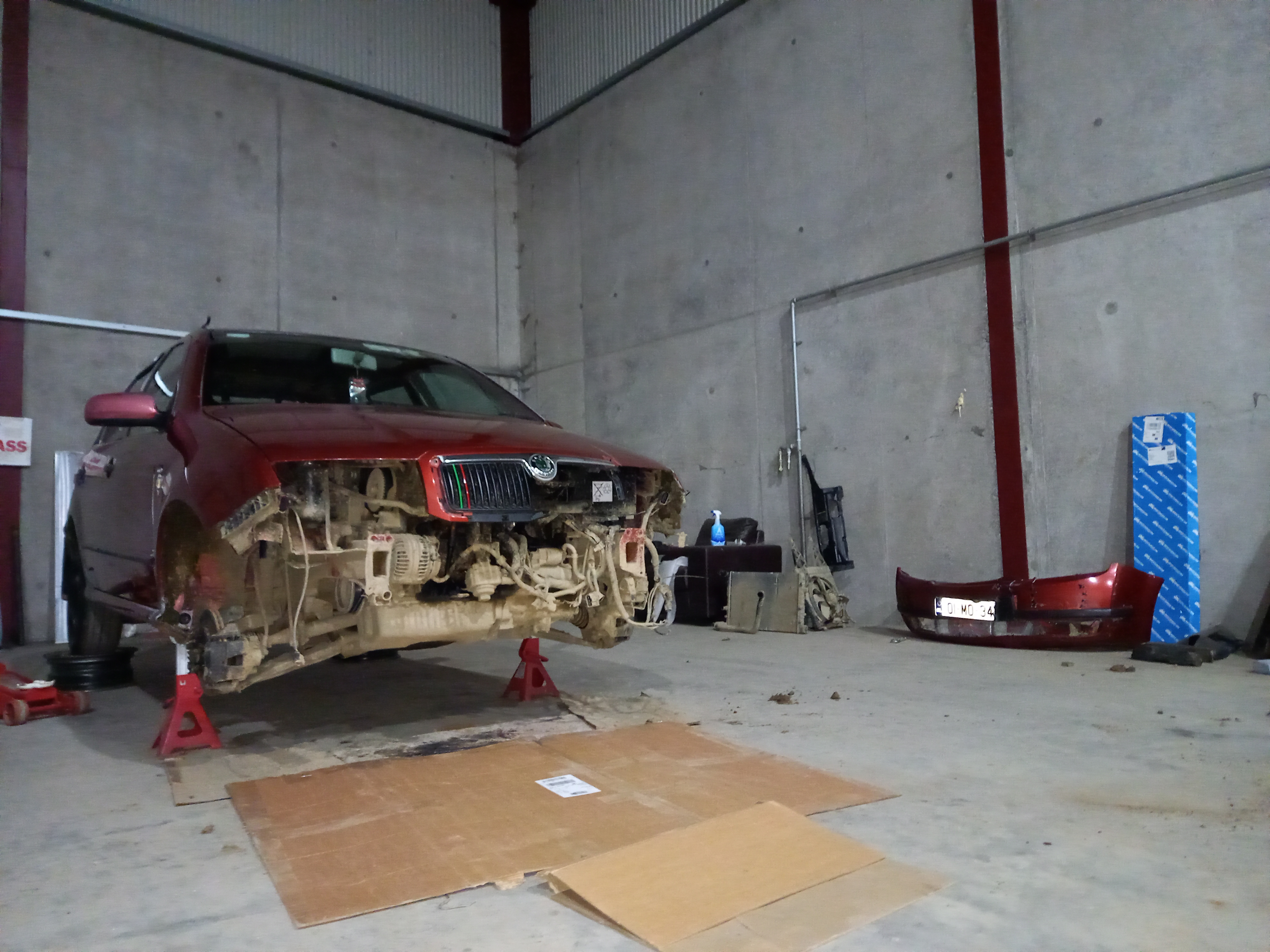

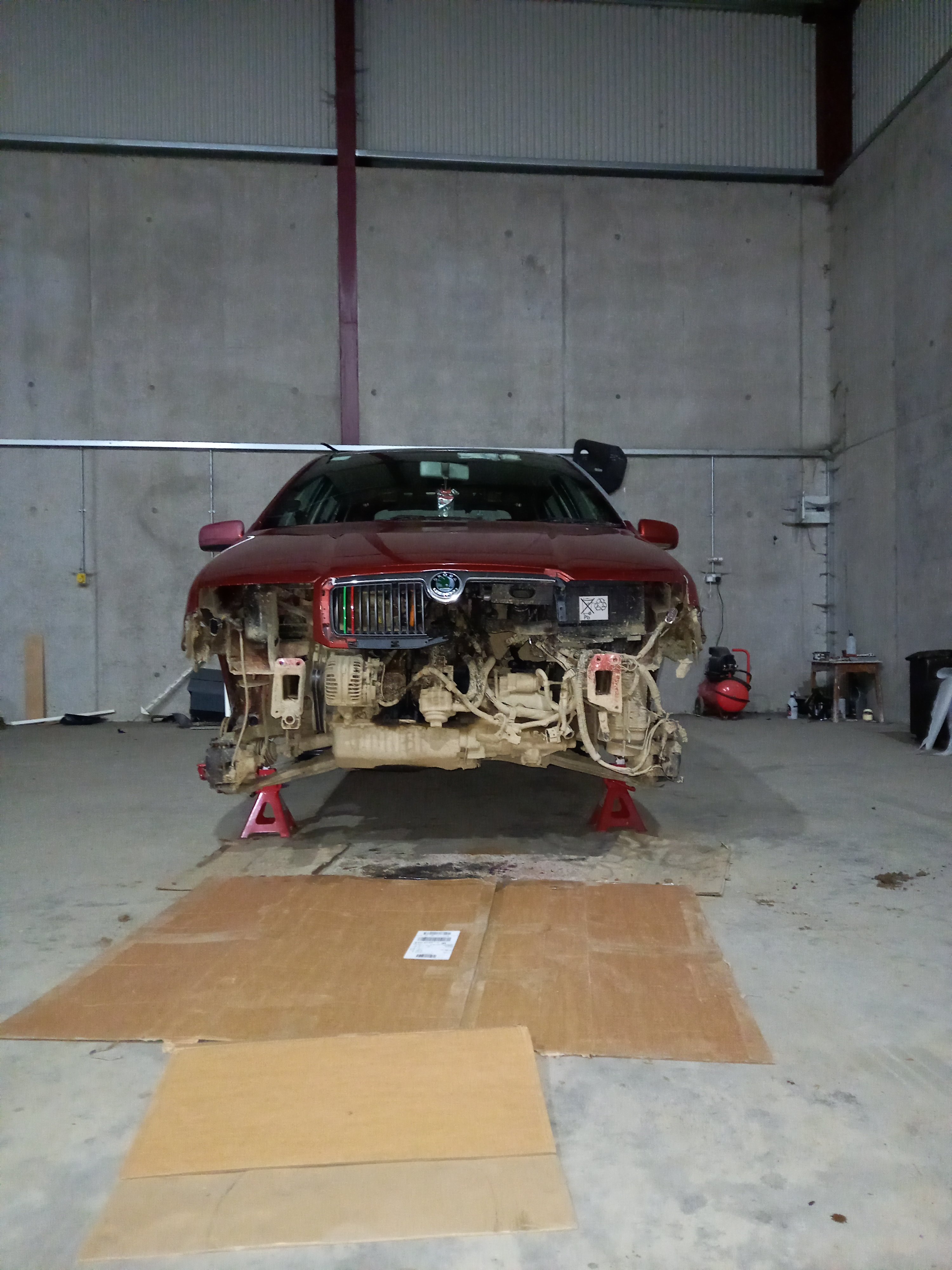

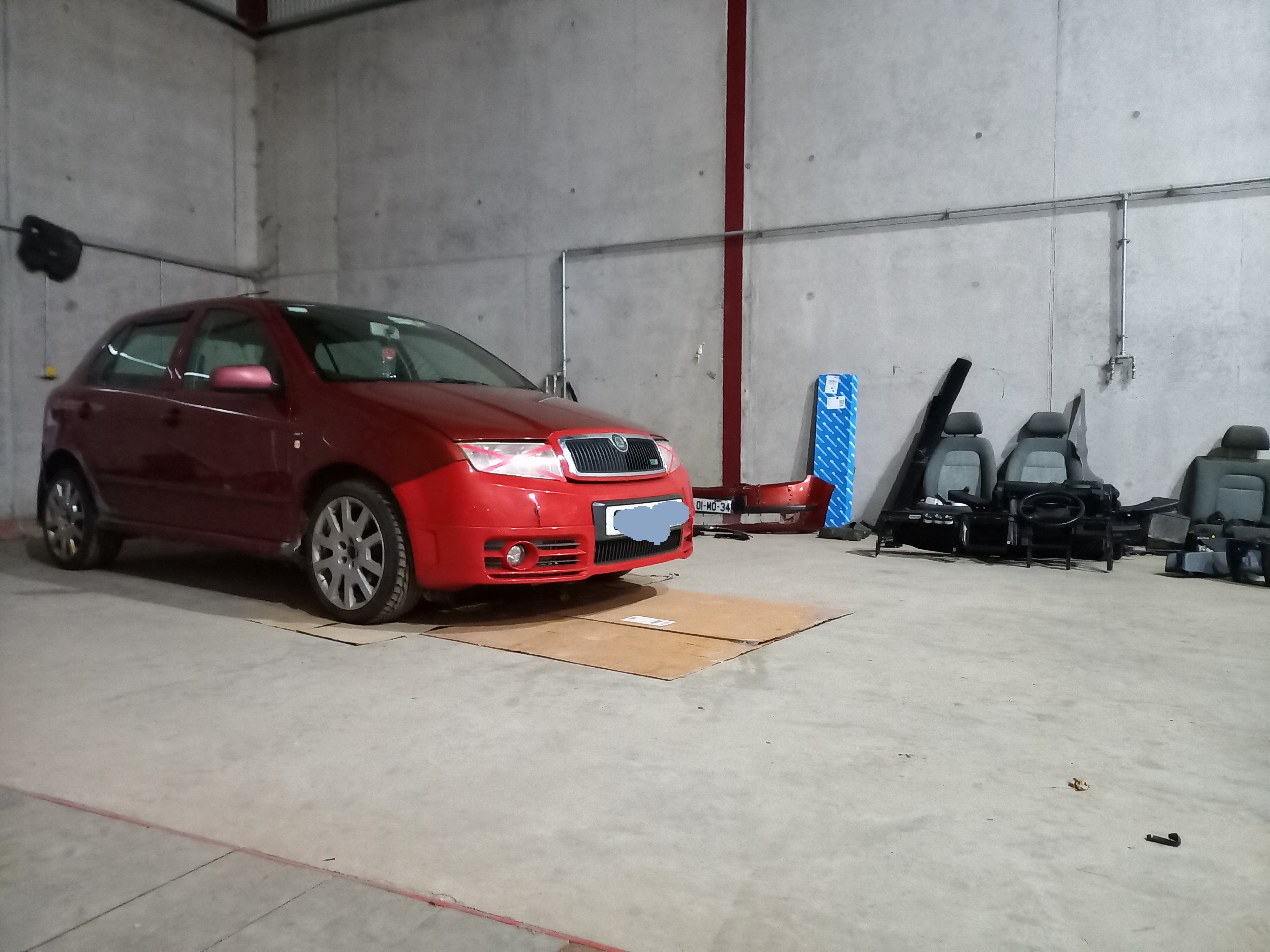

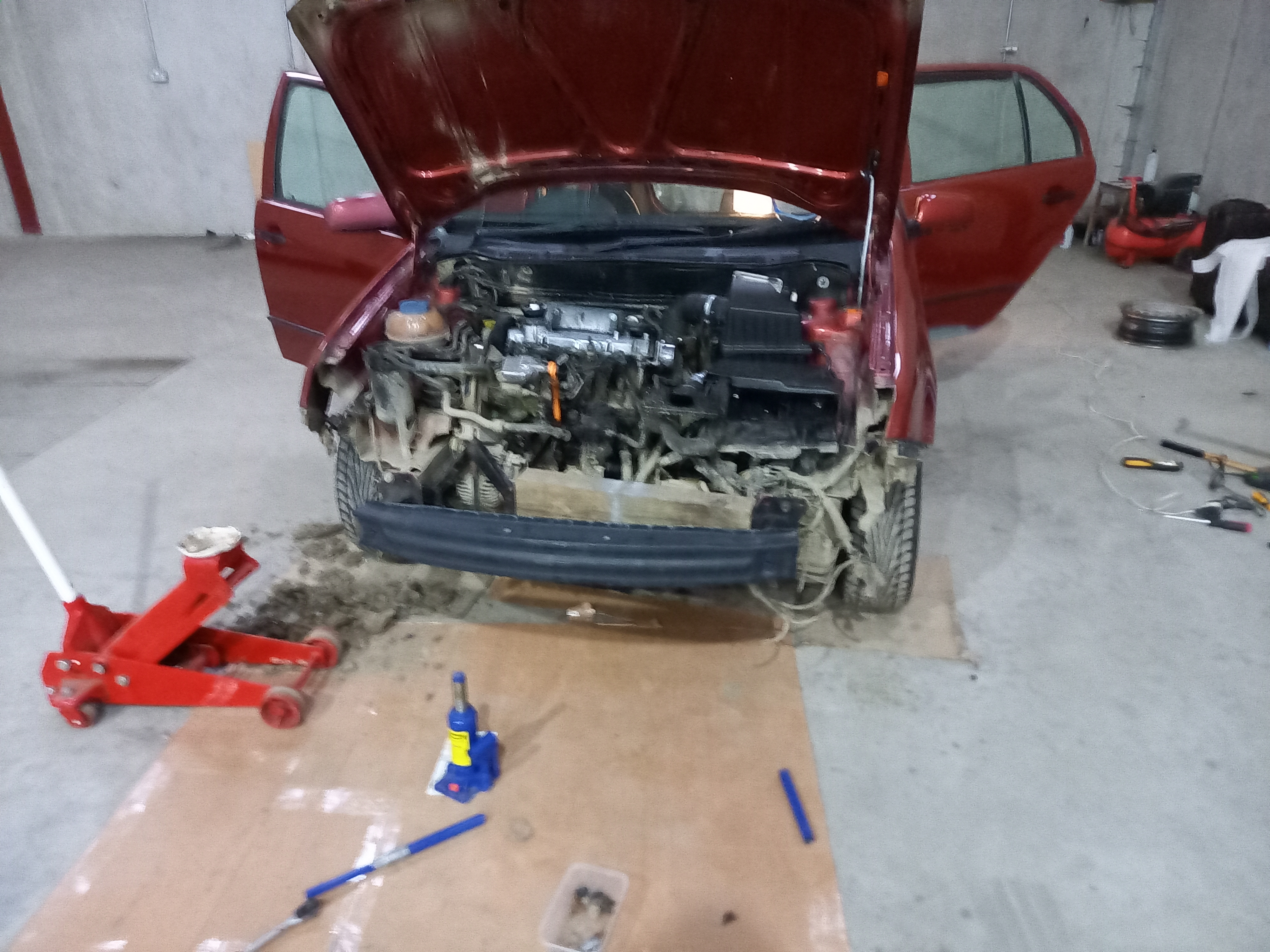

  4. Car is cleaned under the arches and front is back together. Not perfect mind but Its much better than what it was before. Only problem is that I ran the battery low by quickly starting the car to move it down to the power washer and then back up again. Couple that with the fact that the belts and alternator got a little wet it was obvious that I was going to run into trouble. I had the car Idling while I was bleeding the radiator, all the electrics on, draining the battery. I noticed the gauges had frozen and knew straight away what was up. Just to make sure, I opened torque on my phone and noticed that it was reading 6.6 volts on the voltmeter, not good. I gave the car a few revs and to my surprise it revved freely and much quicker than it normally would, but it sounded like the power washer that cleaned the **** out of the arches just an hour or two before, I presume it was just dumping fuel into the engine at this point. Shut it off and put the battery on charge overnight. Its a big battery so it'll take a long while to charge. Hopefully the car dries out a bit more and the alternator hasnt in fact crapped out on me. The pile of dirt you can see is the dirt I scraped out of the passengers side quarter panel while I had it off.

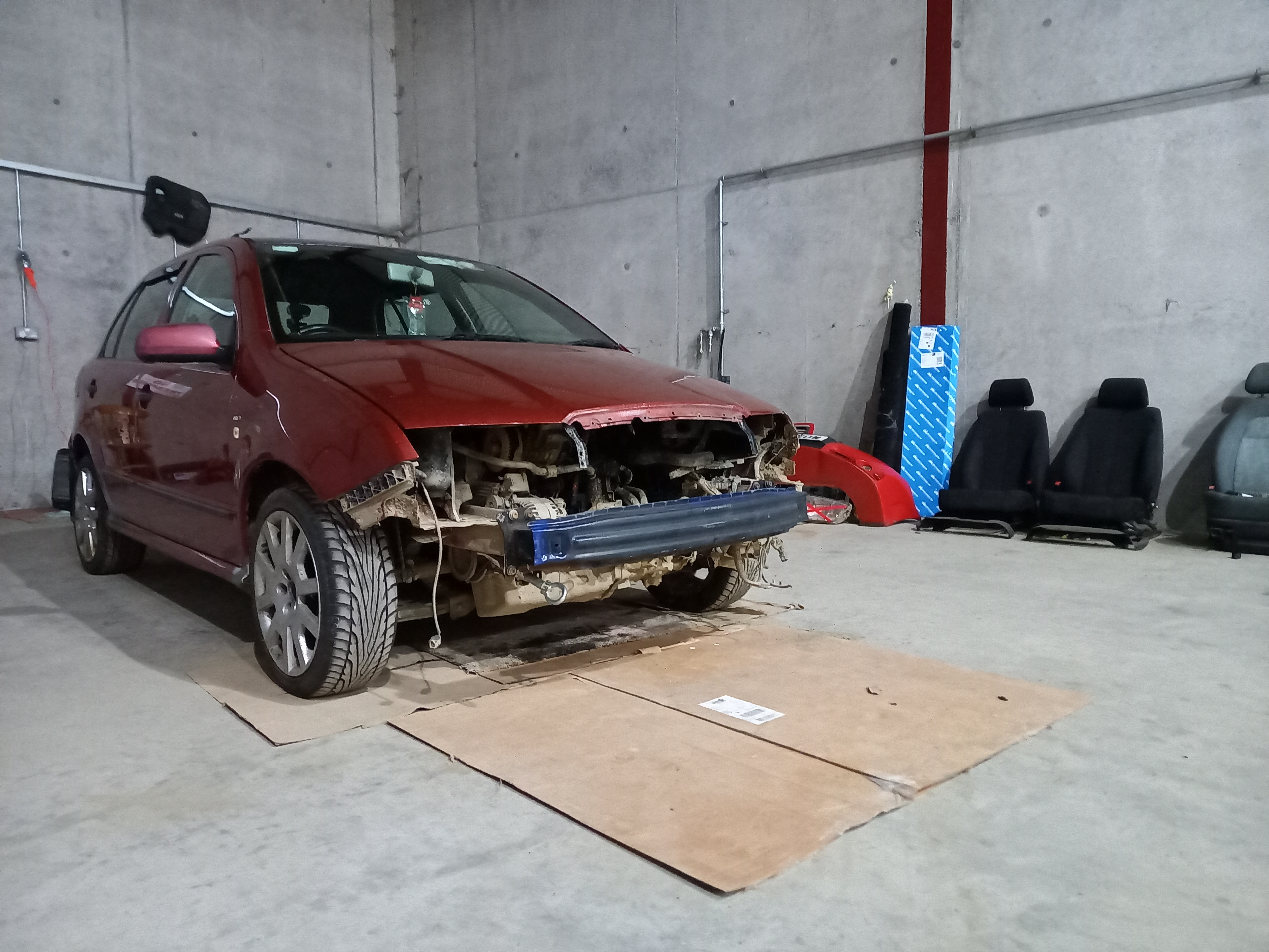

  6. Making a lot of progress over the last few days. Have the front radiator support and crash bar back on. Ended up giving the crash bar a quick scuff with some 120 grit and 2 coats of gloss black just to clean it up a bit. Took both front fenders off as I thought i'd need a bit more room to get the front support on, I didn't at all. On the brightside I managed to remove about 20 kg of clay from the front arches. Next day i'm out i'll take it down and pressure wash the bay and front arches and see where the car sits.

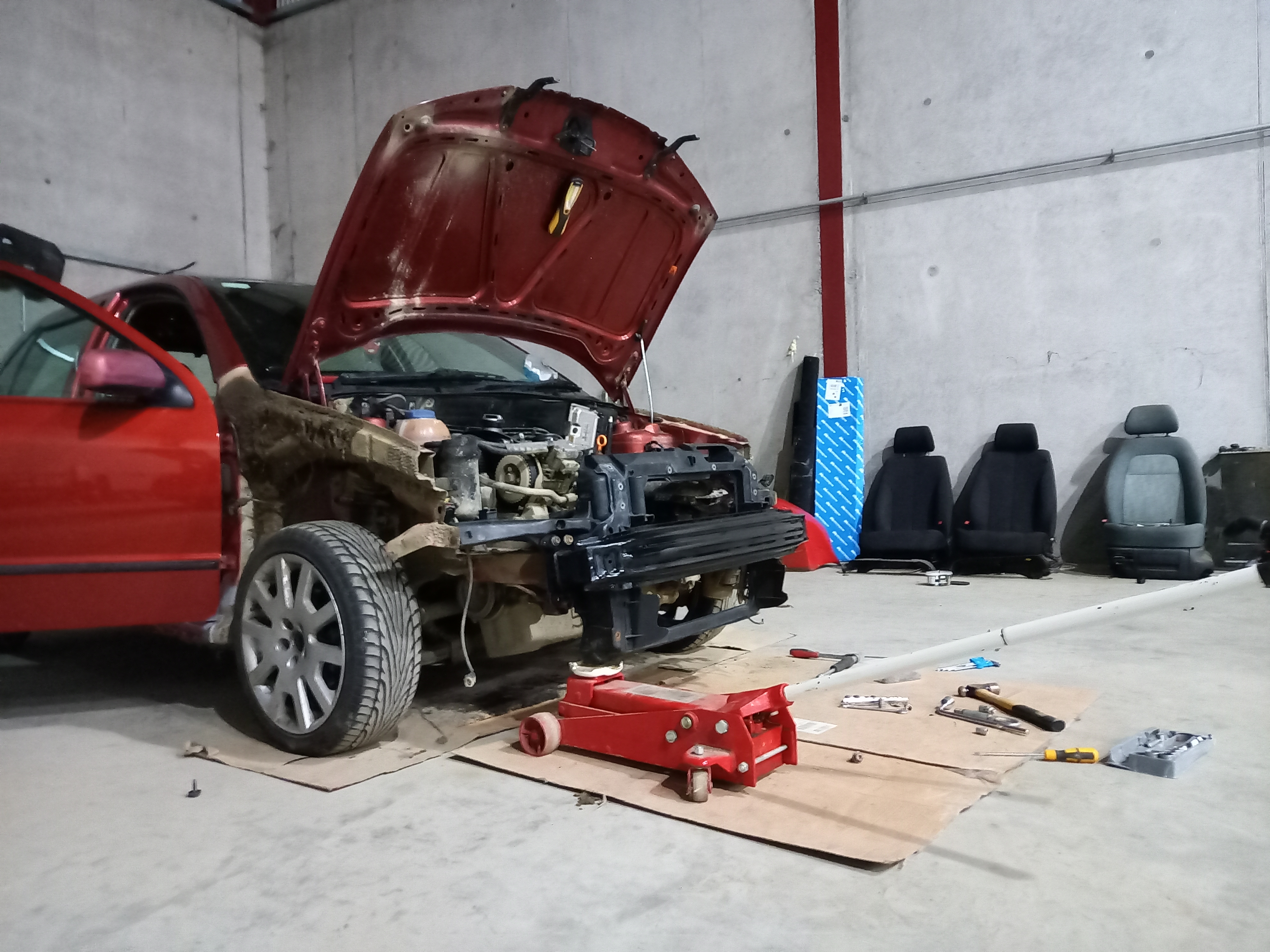

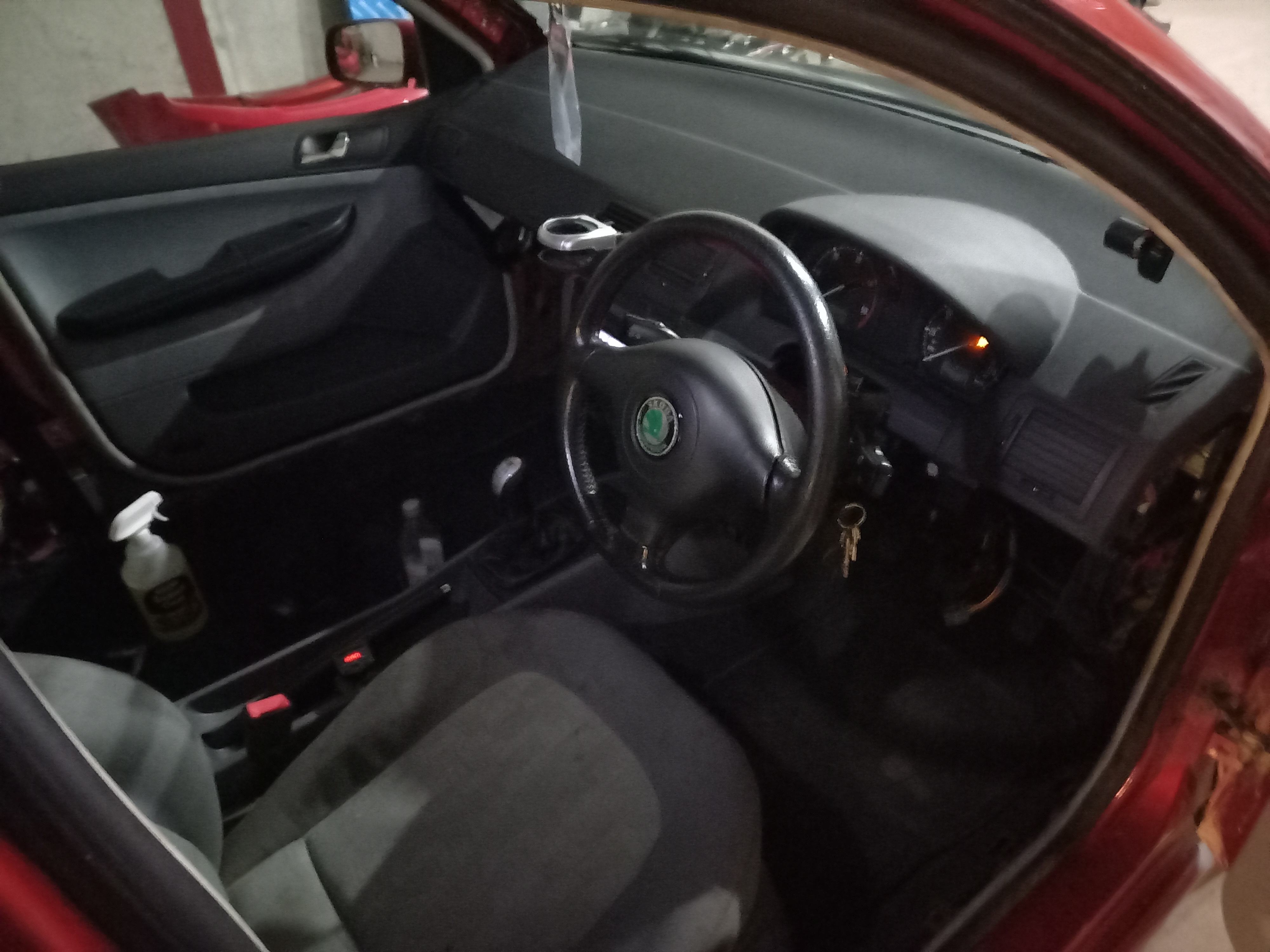

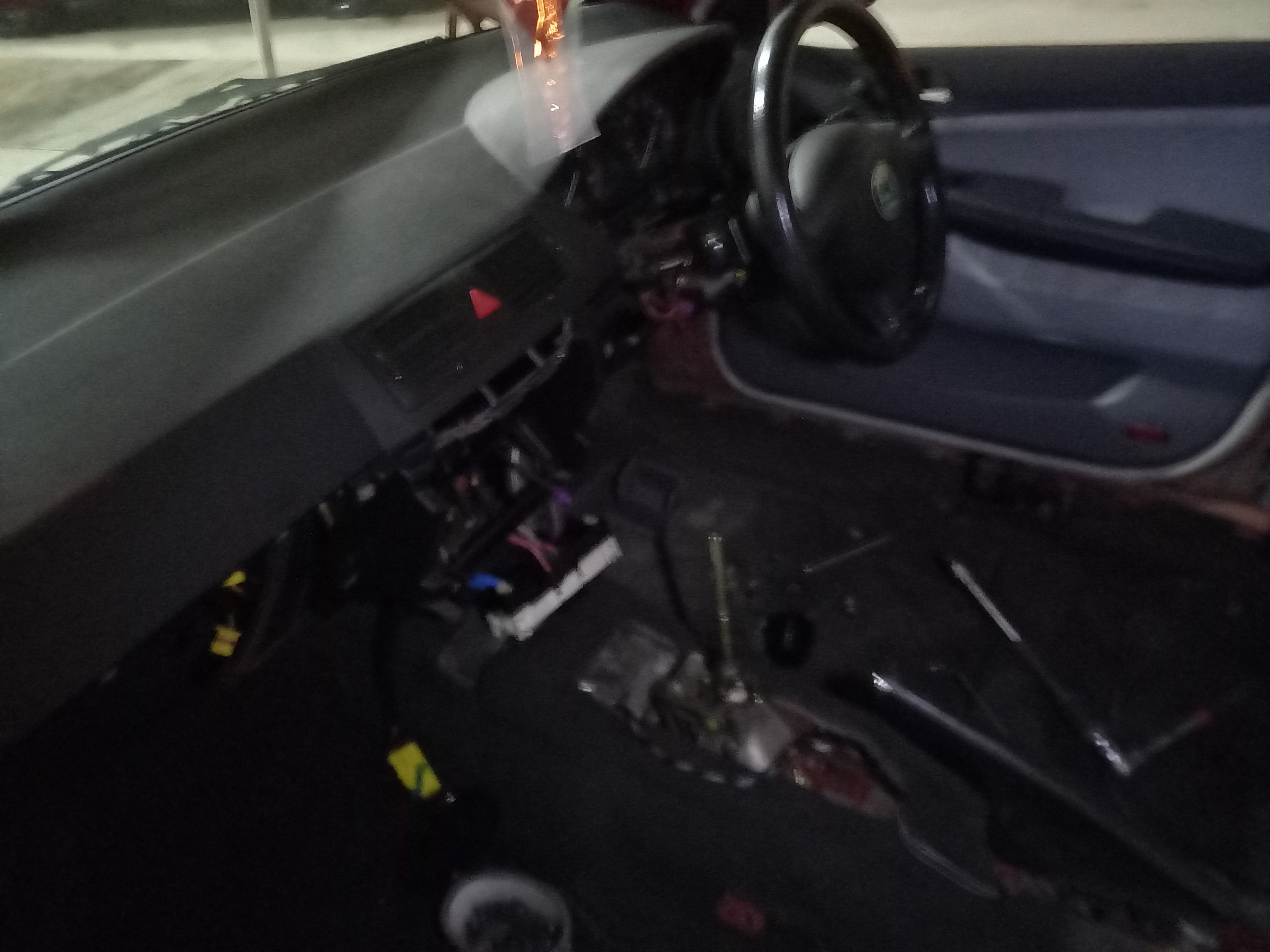

  7. Making good progress thus far, have the interior 80% done, vRS bits et al. Also,made good progress on the front. Got the Front crash bar on and bolted and can probably get the radiator and other bits in soon. Only thing is one of the bolts holding the crashbar to the frame stripped so I need to extract it. Also have put the passat seats aside and just put the standard seat back in for the minute.

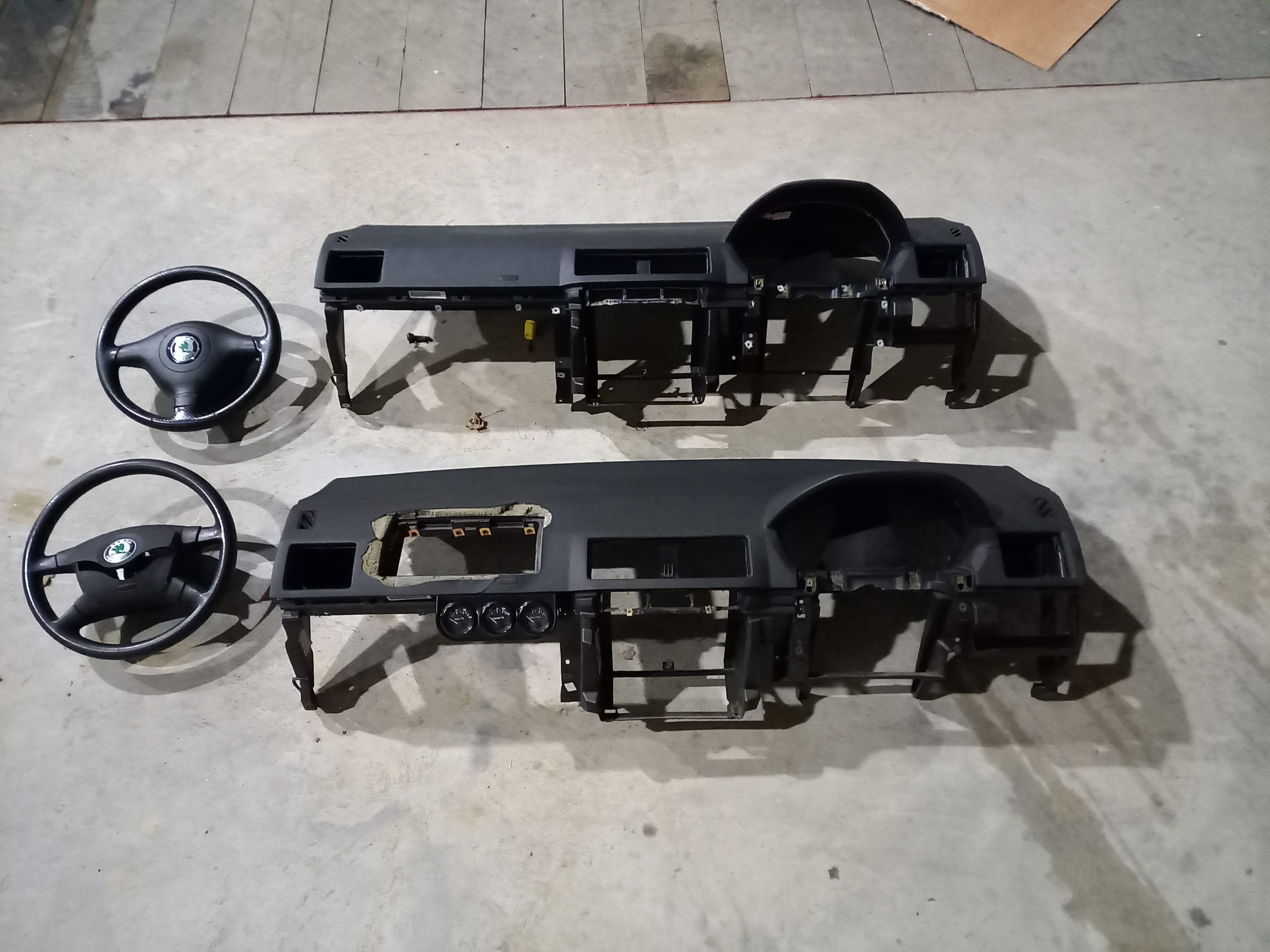

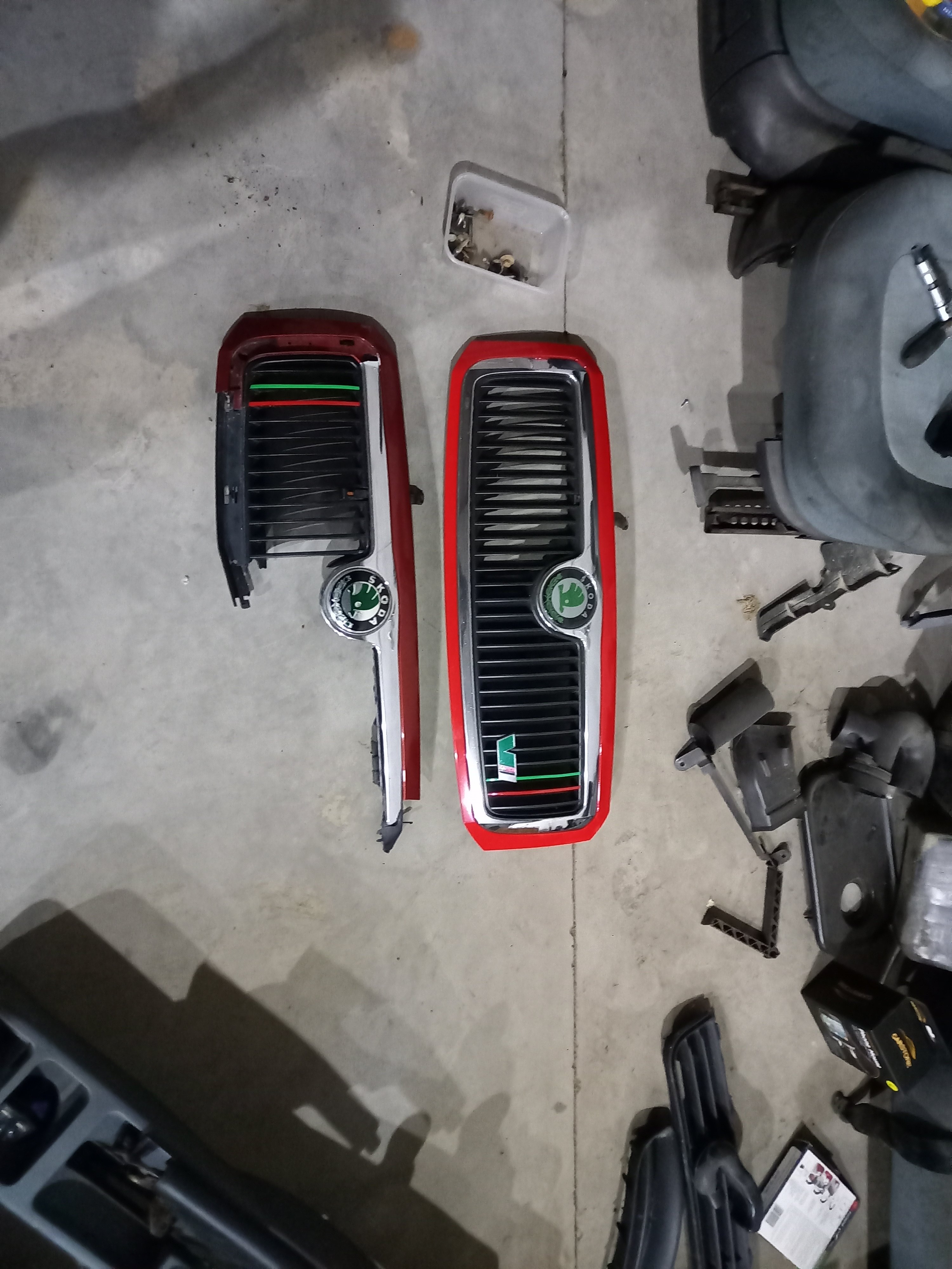

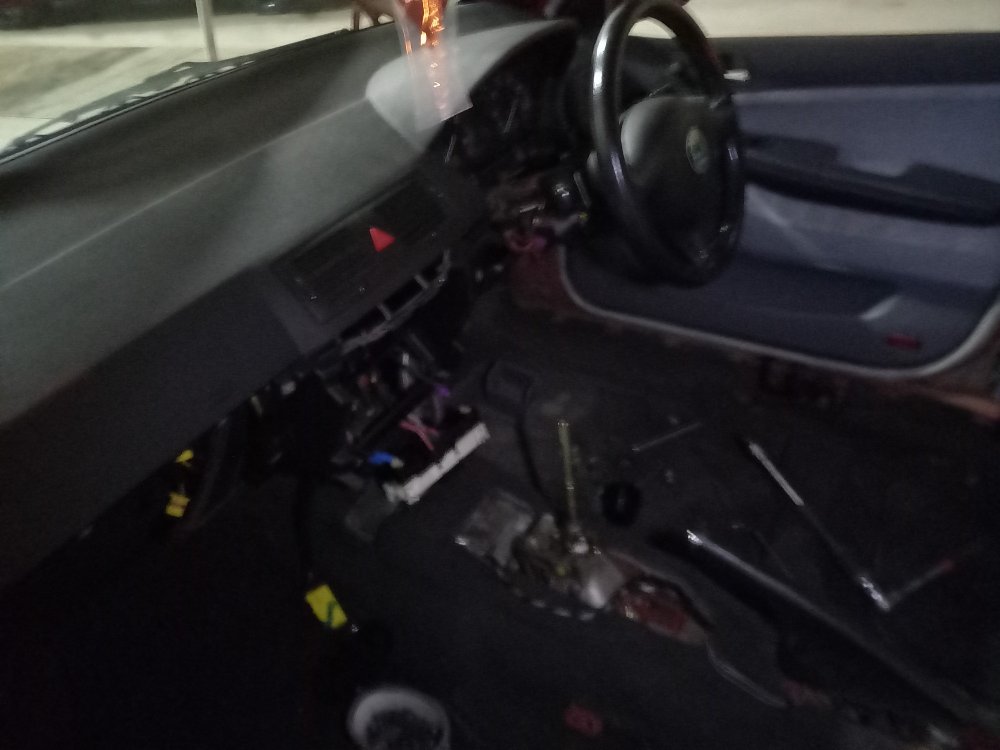

  10. Polished up the new grille and put my touch on it. The vRS badge has seen better days but i'll leave it for now. Got the dash in today too, massive pain in the ass trying to get the fusebox in properly but got it done in the end. Lastly I made some progress on the front end, got the vrs radiator out and my sdi one in. The bits being from a UK car are a little rusty, all of the Torx bits are covered in Crust, some of them stripped straight away and one was stuck so tight it snapped my cheapy torx wrench. I have the a/c rad from the vRS but it looks like one of the pipes were cut trying to get it all out, probably of no use to anyone now, not that my car has a/c anyways.

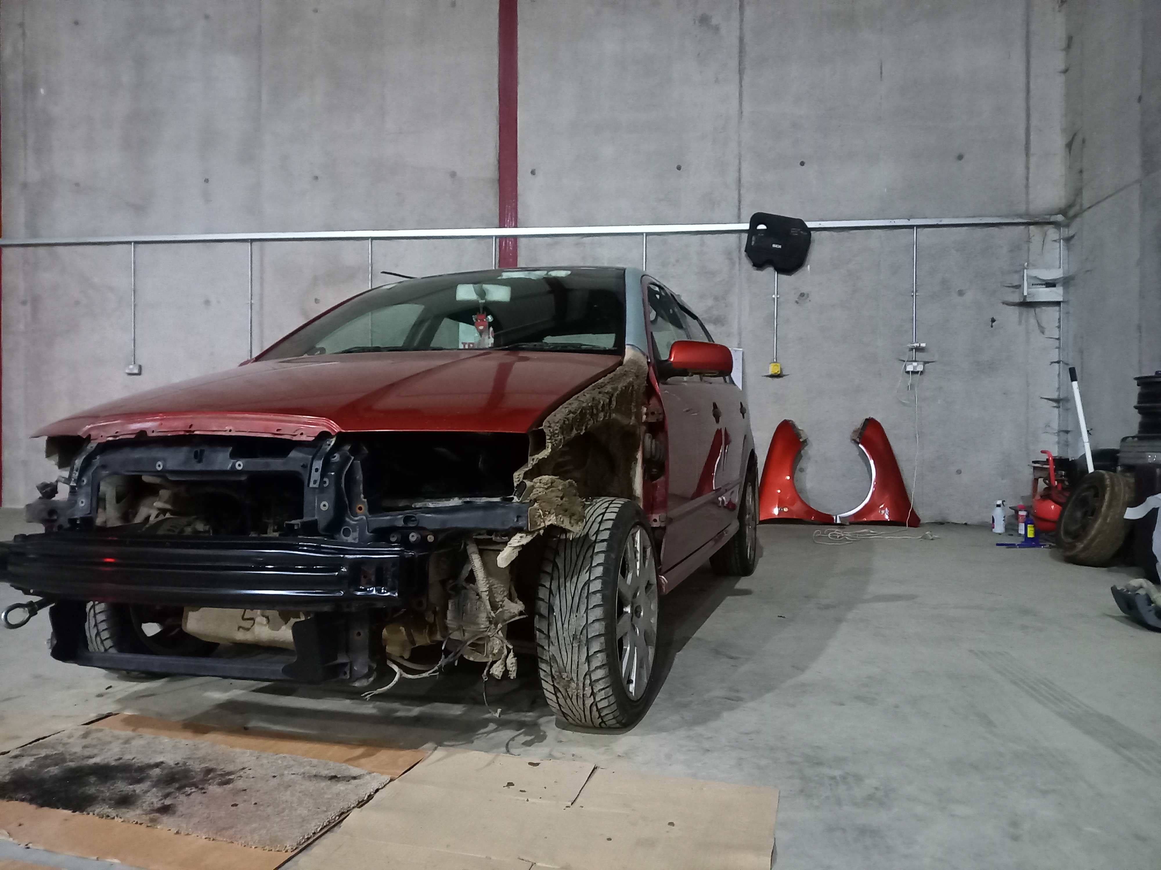

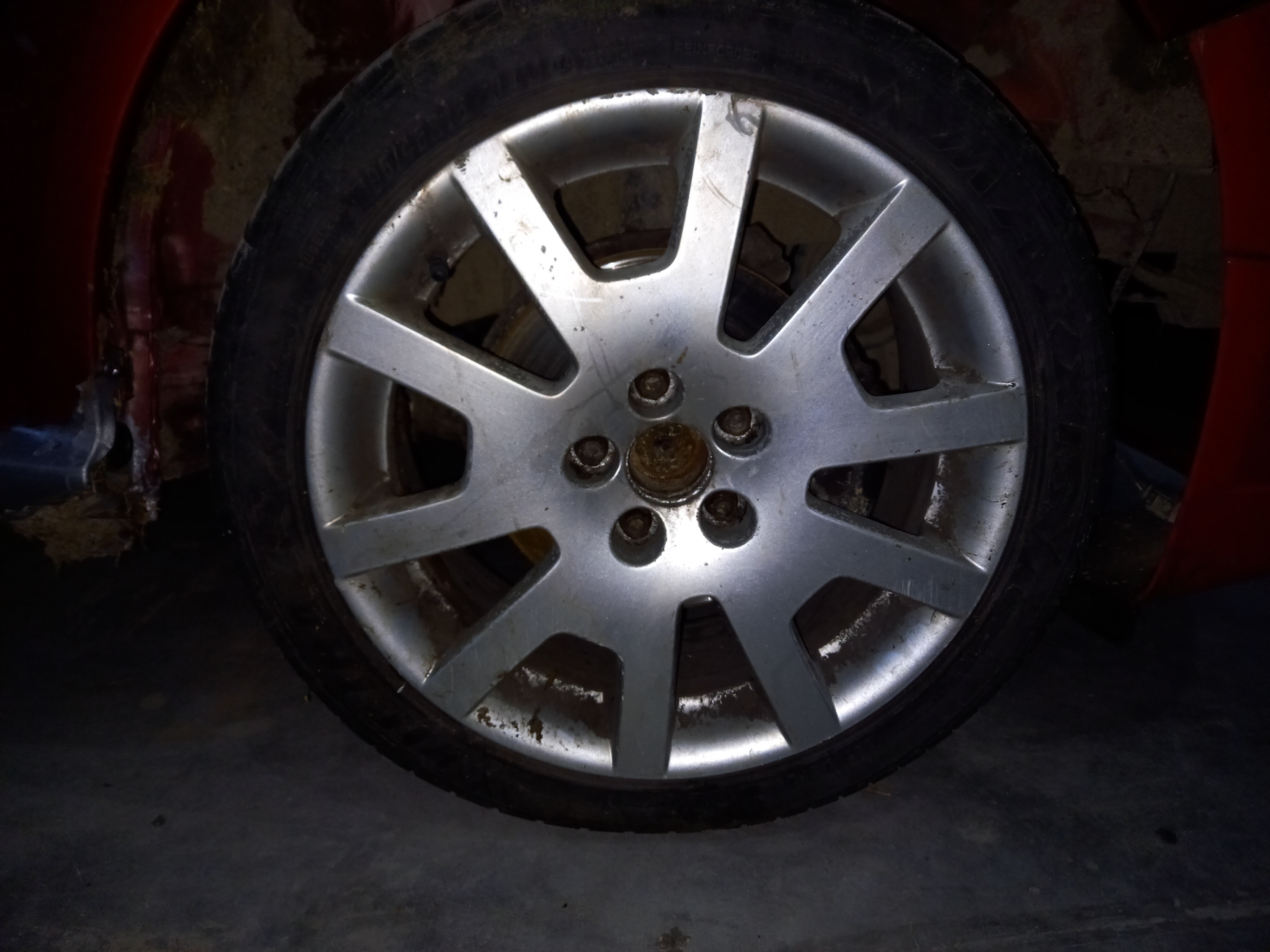

  11. 4 wheels on and all holding air. 2 have old but still quite decent looking maxxis tyres, they went on the front. 2 have Toledo brand tyres, One is on the wear bars and is scrubbed bare on the inside, the other is cracked around the side and is bulged all over the sidewall, It is on the car and holding 15 psi of air but I wouldnt dare drive the car on it. I have the front bumper and all sitting in place but not bolted to the car, need to straighten the chassis to be able to properly fit the front end onto my car. Finally, I put a bit of wood onto the drivers strut to make the car sit level for now.

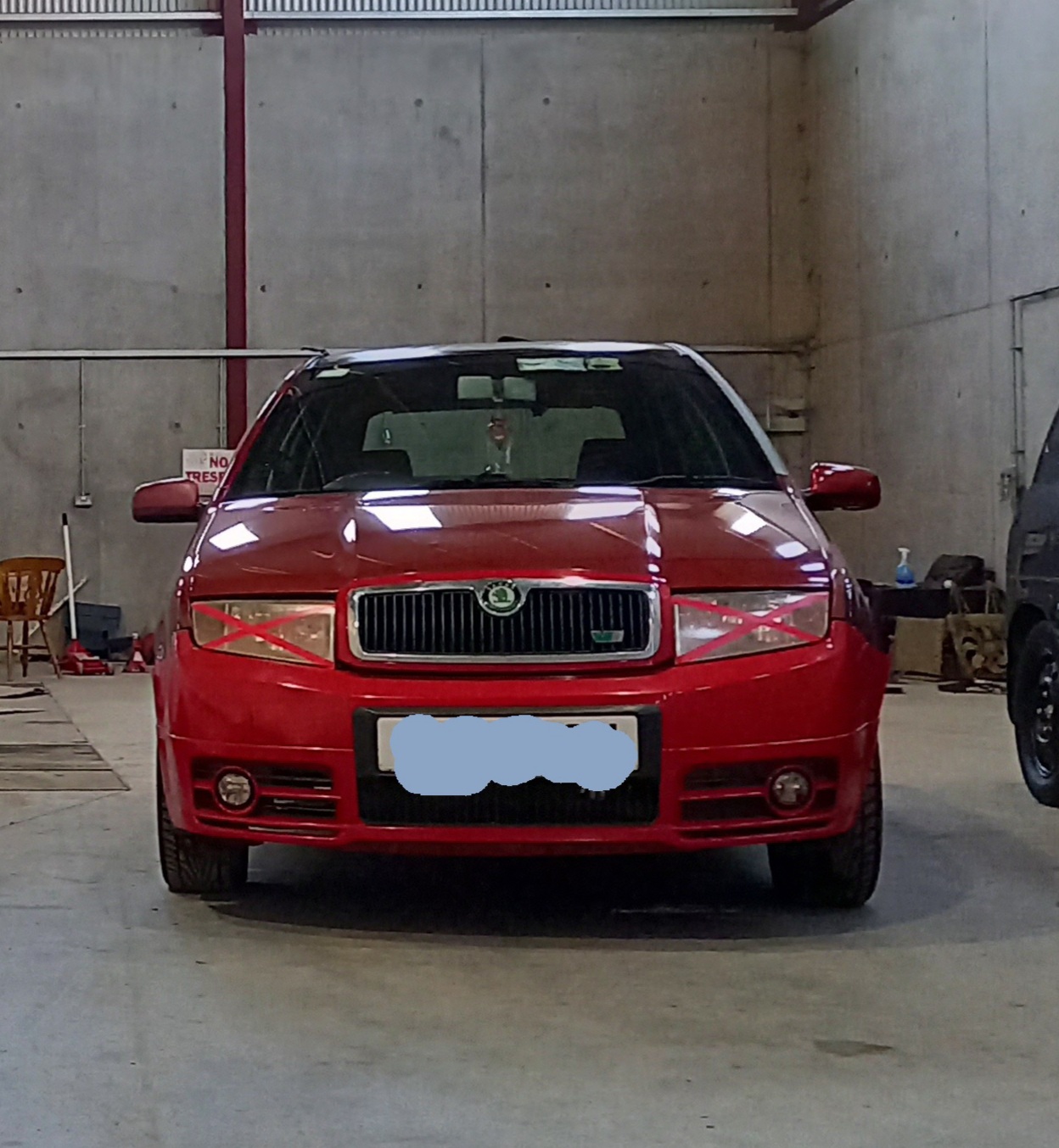

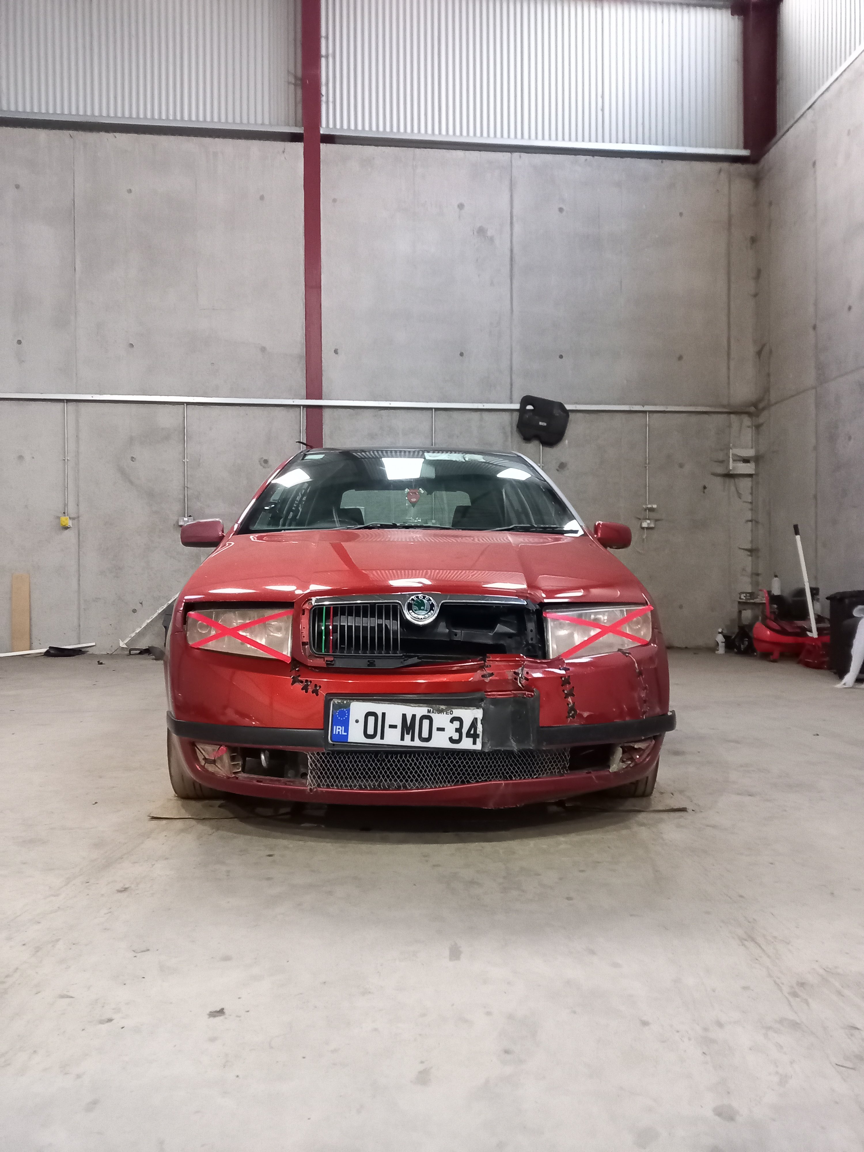

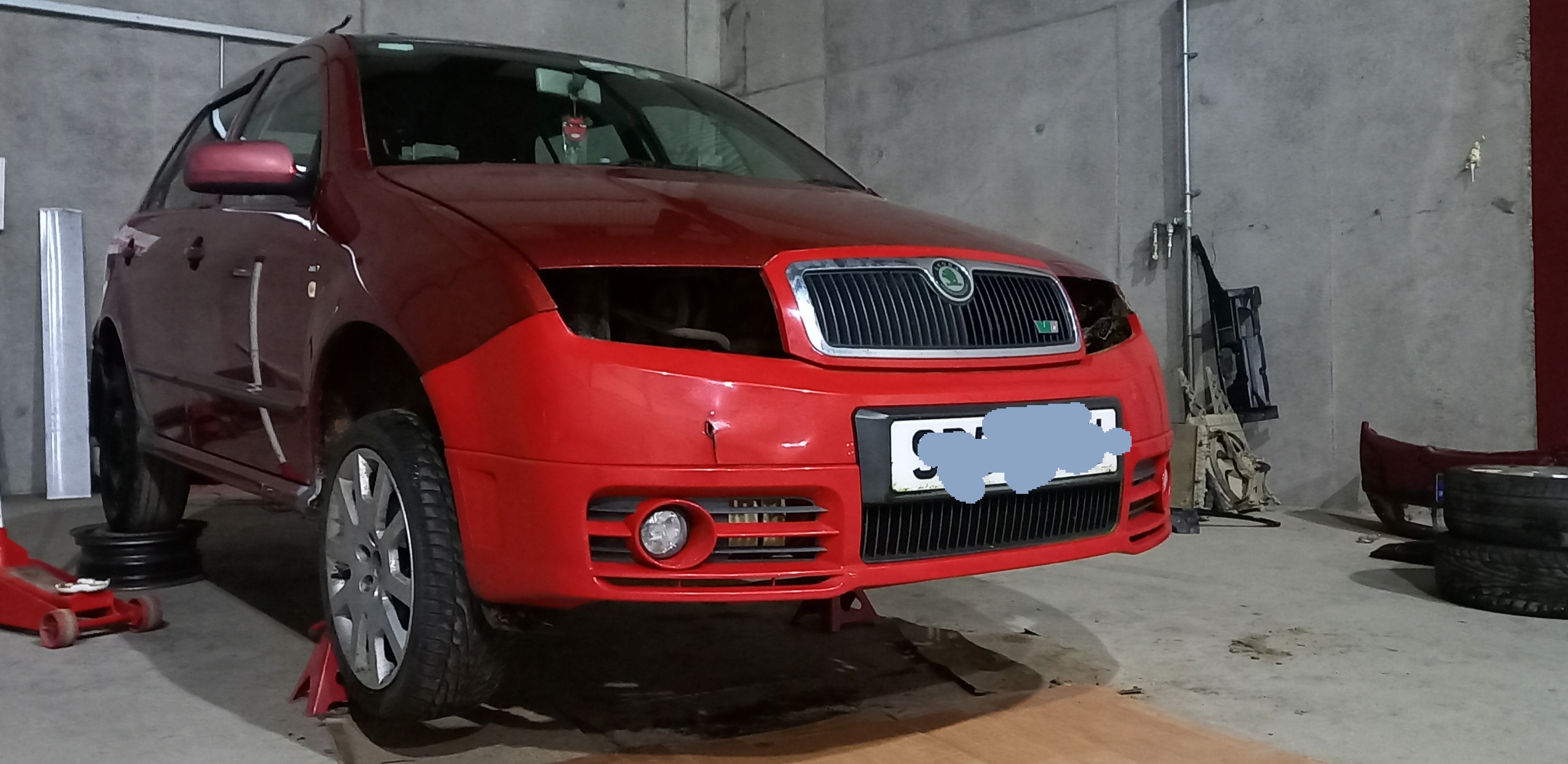

  12. Managed to find most of a front end from a vRS to replace my Mad Max front end on the Fabia. Not the prettiest mind, but considering I got it, a dash, Vrs steering wheel,handbrake,Gear Knob and a full set of vRS alloys for decently cheap I am over the moon. Have the plate obscured as its the one from the car I got the parts from, not my car. Not that it really matters either way but still. I can now proudly say that my car is the slowest vRS in the world!

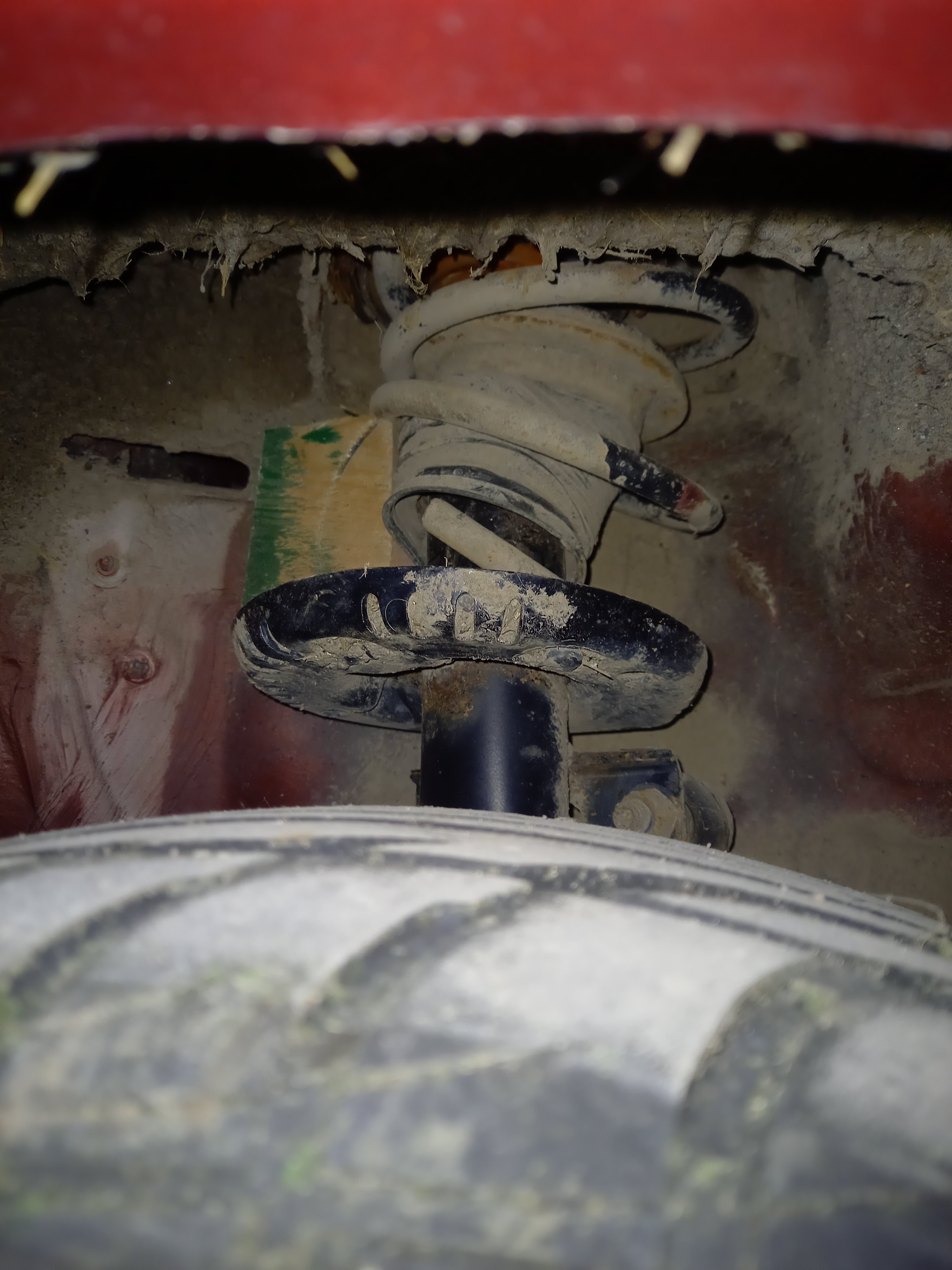

  17. I have Accelera Phi-R tyres on the Front of my Monte Carlo, one of our lovely Potholes wrecked the old front left tyre so I replaced them both. Honestly a great tyre for the price, considering they are just a summer tyre. They took the snow and non gritted, ice ridden roads like a champ over the last few days. From what I've experienced with them over the last 1000 miles, they grip well, are quiet, are comfortable and are very predictable when they do start to slip. I went for a spirited drive the other night and came across a lot of Ice, much of the road was frozen over. I did slide once or twice, but the car was remarkably predicable and stable when it slid. All things considered, for tyres that were €65 a corner I cant be dissapointed. The large rim protectors are also a nice addition, not that I am terribly prone to using my wheels as curb feelers.

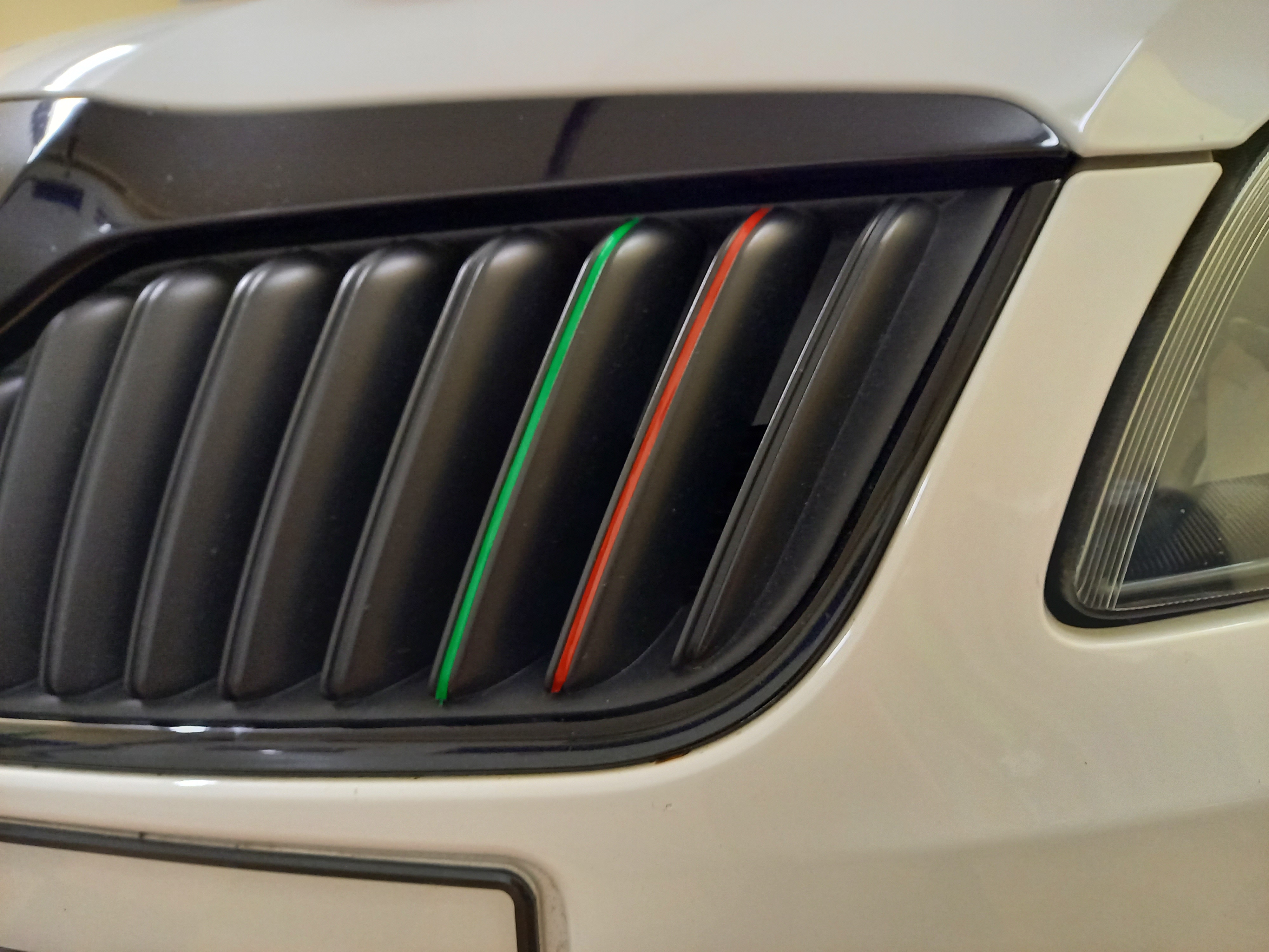

  18. I doubt it looks as bad in person, I only noticed the overhang about a month ago on my car. It wouldnt be very noticable I suspect.
  19. Stock grille badge overhangs by a bit anyway,at least, thats how it looks on my car.
