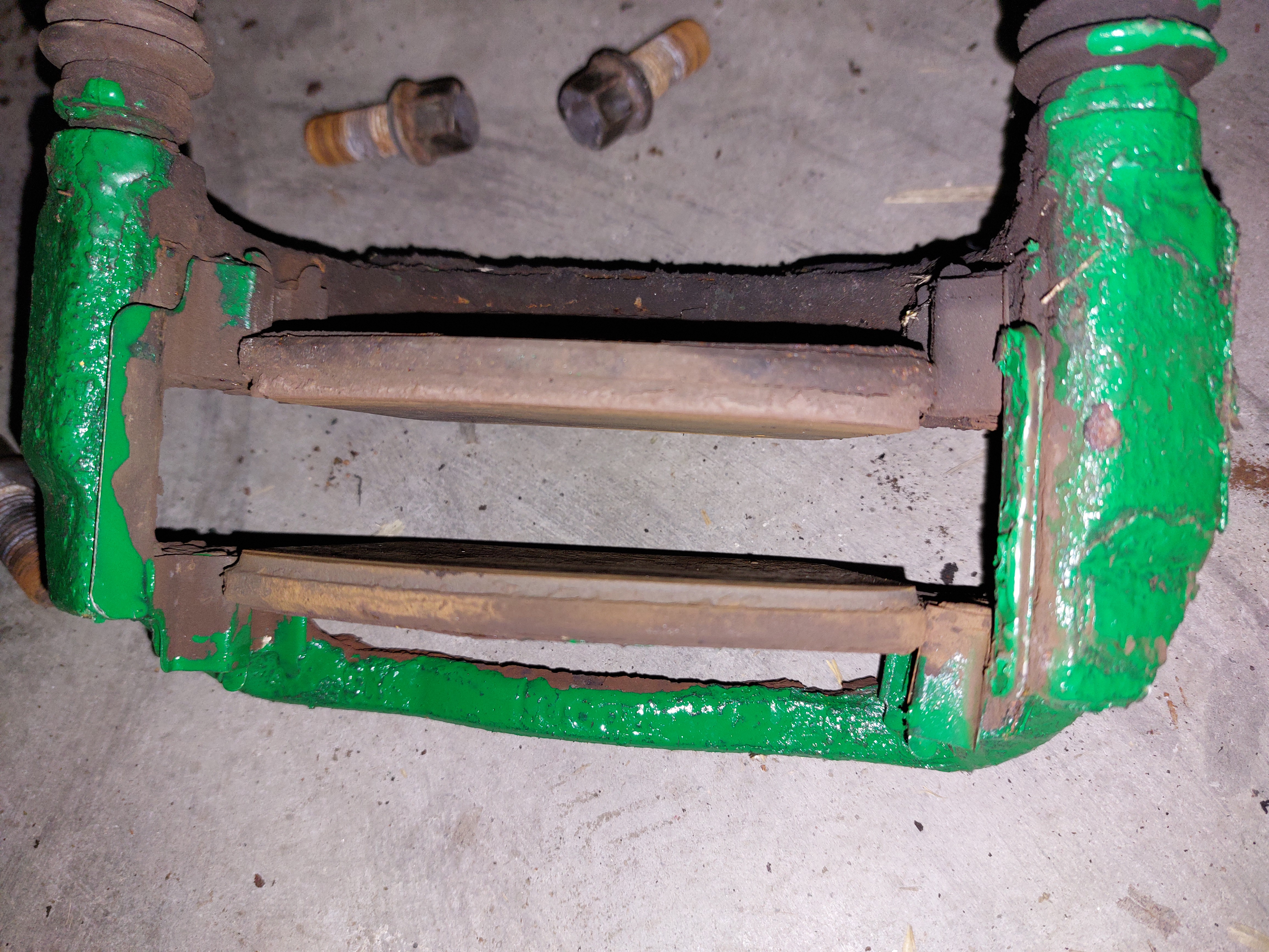

More Work done. Rear brakes were getting very low, so ordered new pads. Ordered front and rear pads from Mtec, I think it was £50 for both. I ordered them at 11am and they were delivered the next morning. Extremely impressed. Front discs were ordered and were meant to be here last Monday, tracking last updated on the 16th so almost certainly lost. Left is the new Mtec ones, right is the ones that were on it. Swapped discs too which was a bit of an ordeal, but they needed changing. Lucky I never returned the discs that were meant to go on it when the axle was done. All fitted. So far so good. Noticeably more bite in the rear now. Have noticed a bit of squealing about town, whether that's down to them needing to bed in, or them being a bit more aggressive of a pad I'm not sure. If it doesn't get any worse I can live with it. Also noticed the drivers rear wheel bearing is a bit rough, so starting to go. No play in it, yet. Worth noting I used the wheel bearings that were on the vrs axle so all things considered I did well to get 20k+ miles out of it. Other side is fine. Its a fairly straightforward job to do and the bearing itself is pretty cheap so I'll do it myself at some point. Had a bit of an oh **** moment when I saw this sticking out of one of my pilot sports. Very luckily it came out and is not losing air. Ordered and received the timing belt kit too. Gates kit. Checked the belt and from what I can see it's "alright". I could, probably will stretch it to next service. Which at the rate of driving I'm doing will only be another few months. Lastly I've ordered all gaskets needed to swap that turbo. Genuine of course. Will be in sometime next week hopefully.

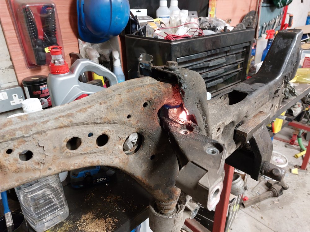

So subframe is assembled ready to go back on. Had to cut a notch to make the non vrs passengers console work. I'll never be a surgeon but its good enough for this. Especially since the cut won't be seen. Reused the drivers console too. Suspected I somehow stripped the threads but chased them out in the vice and they seem fine. Have the vrs one spare just in case anyhow. Built up with all the poly stuff from the sdi. And the psb arb bushes I took out of the Monte. They'll do for now. Mondeo links from the sdi too. Used the vrs arb of course. Sdi one is 17mm and the vrs is 19mm. Not really noticeable in a photo. Turbos back on too. Hopefully no more leaks. Hopefully. Made some progress making the hole for the a/c. Didn't have anything on hand to make a nice neat cut, so I improvised. Used the rubber gasket as a template for the sdi. Drilled some small holes just inside the template. Figure I can enlarge the holes until they all go together. Far from the best way to go about it, but once I get the hole finished I can clean up the edges and make it look like less of a hack job.

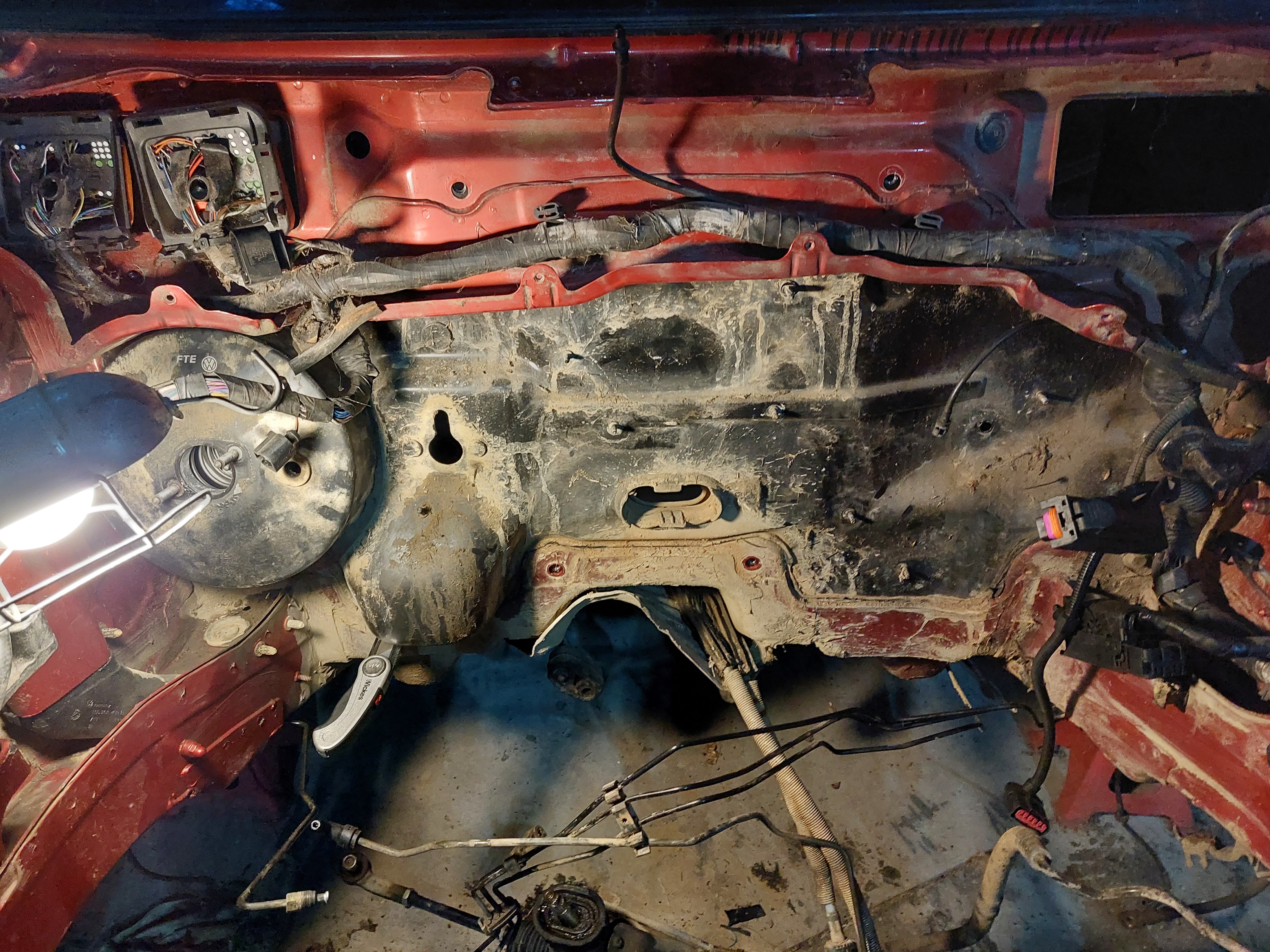

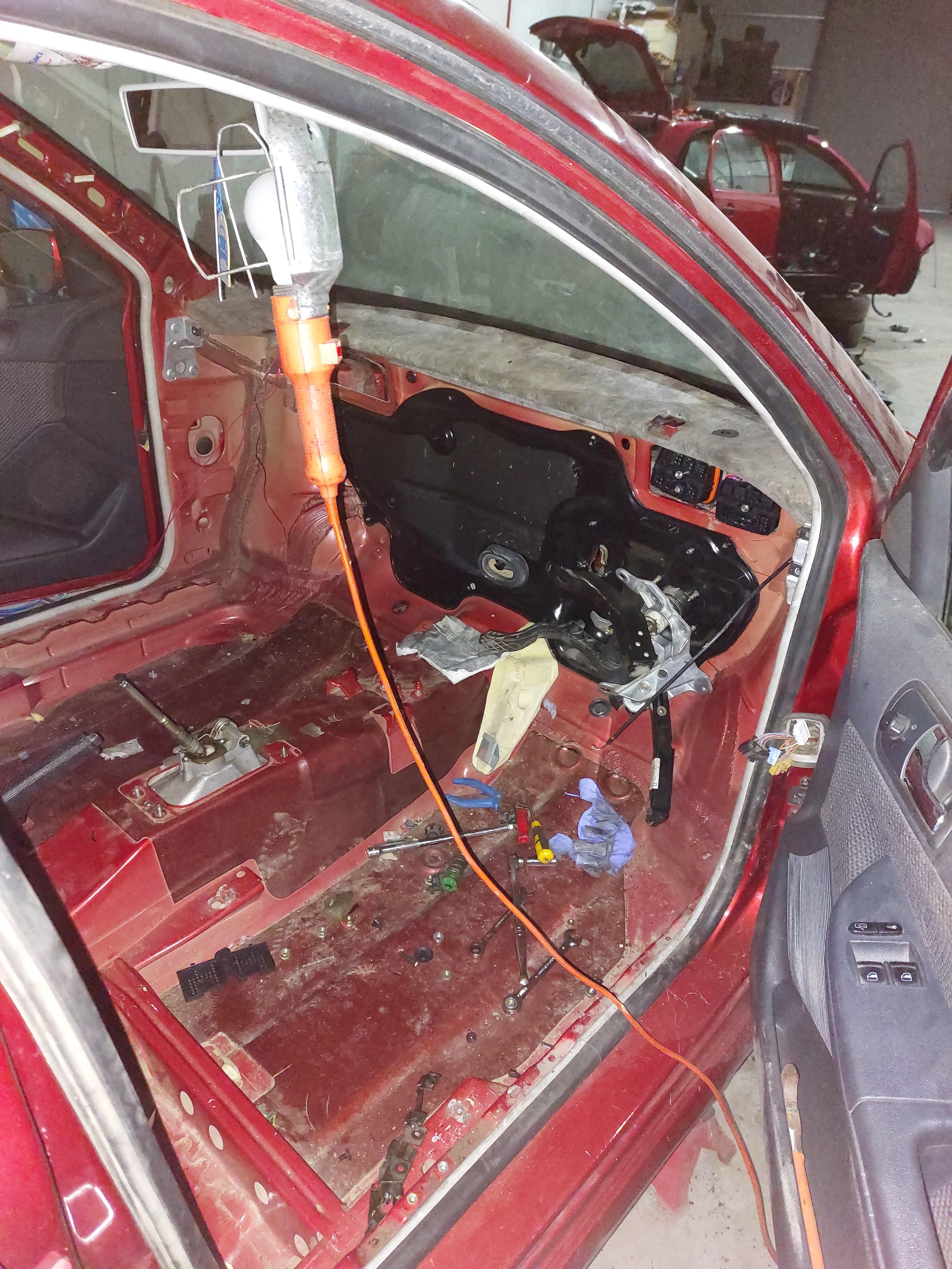

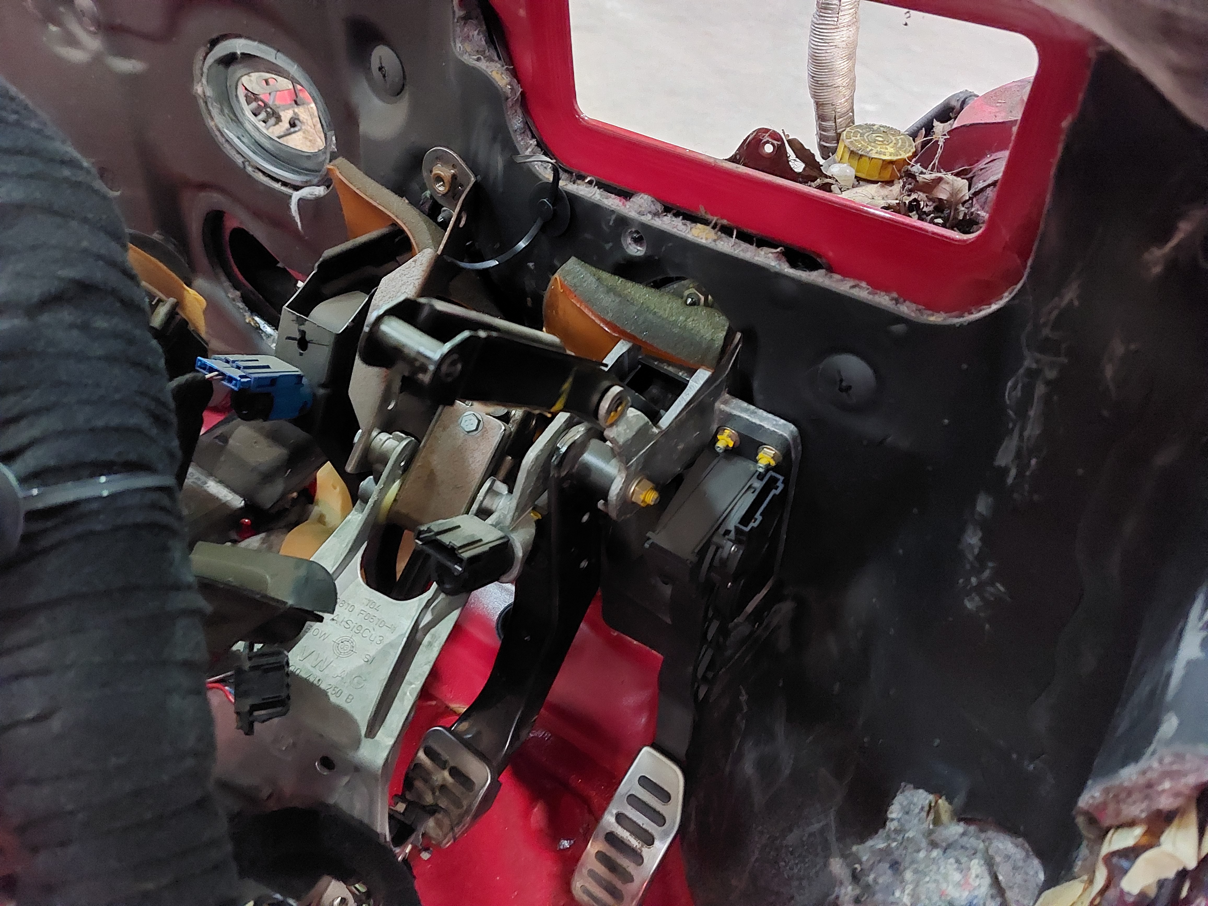

Well just about given up on swapping the firewalls over. After breaking lots of tools and barely making a dent in it that is. I'm now intent on just making a hole in the one in the sdi. Put some dubshed stickers to good use. Good for hiding windscreen cracks. Cleaned up the subframe and Arb off the vrs, they were rough. Coated them in Kurust and then some hammered black same as before. Noticed one of the arb collars are missing, I'll just find something to wrap around it for now. Lot better than the scratched up, rusty subframe it was a few hours before. Using this subframe as it still has the dogbone nut intact. Had some hammerite left so wirewheeled and Cleaned off the knuckles and painted them in situ. Bit more presentable. Cleaned up the bores where the shocks go into and coated them in copper grease. They were a bit rusty inside but Cleaned up well. Went to paint the carriers and found out my tub of pantone 348 had gone off, so sulked and painted them silver instead.

Good afternoon everyone. I'm in the midst of reshelling my vrs into my sdi and decided to swap the firewalls over, as the vrs one has the hole for Aircon and I'm intent on swapping EVERYTHING over. It's held in by 6-7 13mm bolts which I have removed, however it's also held in with some of the strongest seam sealer I've seen. I've tried heat, which didn't do much. Used cutting wheels which just destroyed them and made enough smoke that I'm glad there isn't a smoke detector in the shed. Used a Stanley knife to try cut away at it bit by bit which did nothing but destroy the blades. And even went so far as to try wedge a chisel in between the firewall and the chassis which only served to break the chisel. Surely someone's encountered something like this before and can give me some help? All else fails I'll drill the required hole in this firewall and do it that way. Thanks.

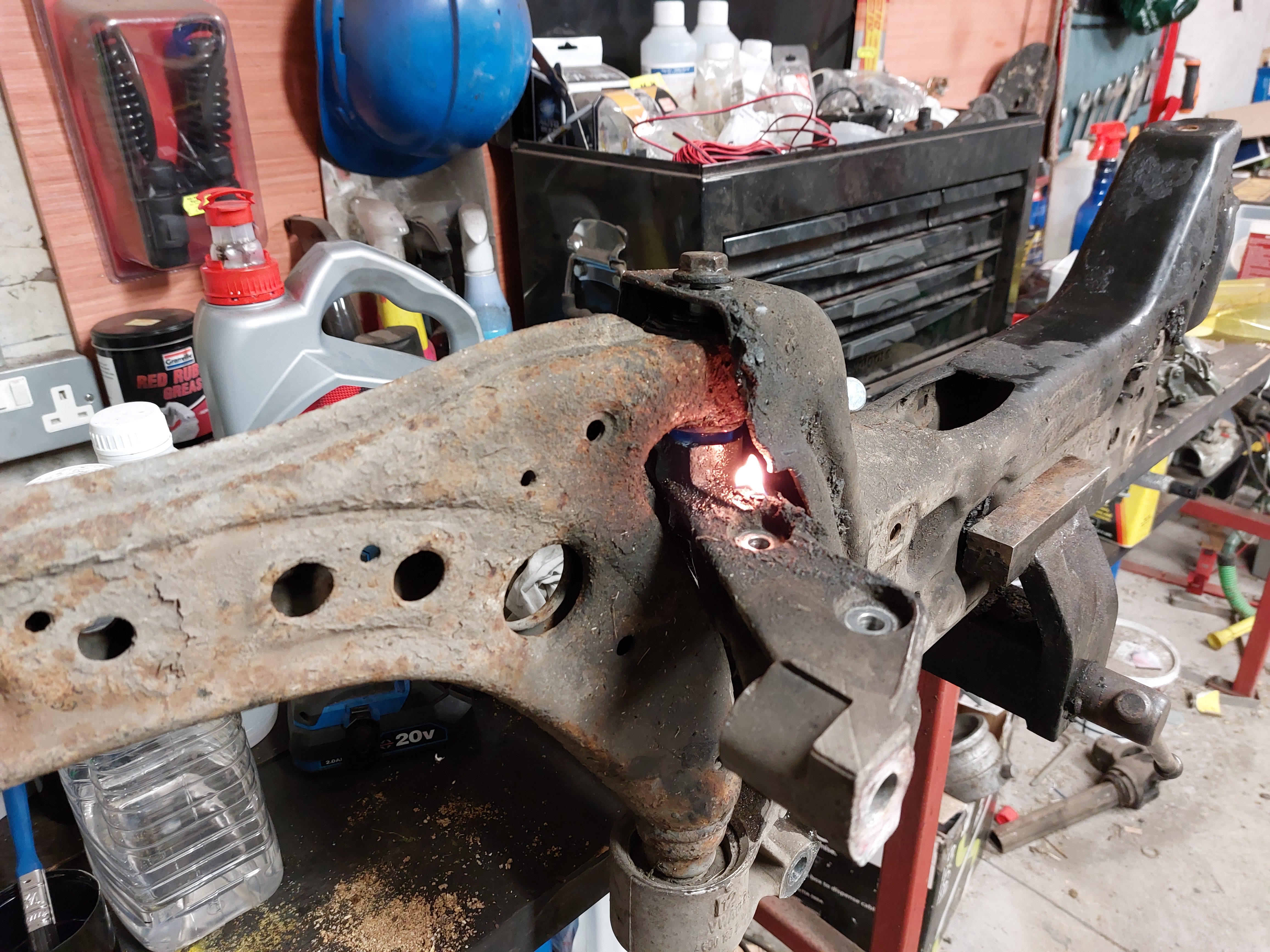

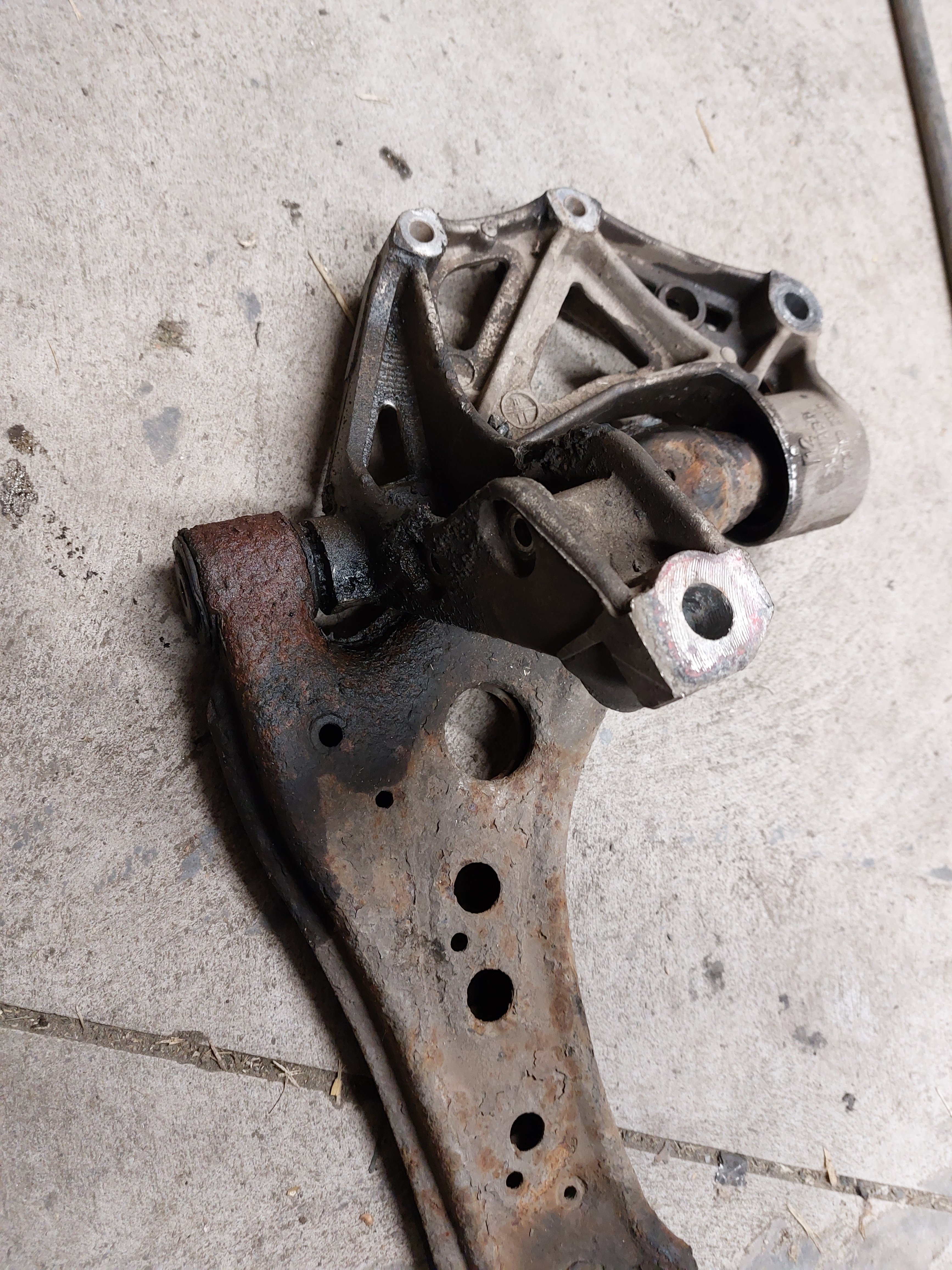

Stripped away at the vrs subframe, drivers console came out like butter, passengers side though... It did not want to play ball. And in typical fabia fashion, the bolts snapped. Atleast it snapped in a way I could separated it from the subframe. Ill reuse the vrs subframe as it still has the nut for the dogbone welded on, and the drivers console too. I'll use the sdis passengers console and just cut a notch in it for the 6 speed. So may as well use the PSB consoles now for the sake of it. And left some stuff to soak in vinegar for the last day or two. Took the carriers out and got to work on them. Now sitting primed ready for paint. The bolts for the Heatshields on the vrs hubs are very corroded so not sure how I'll get them out. May end up running no heatshields in the end, not ideal. Engine bay and inside is stripped bare so taking on removing the seam sealer from the bulkhead. It's not coming out easy. Will take a long time to chip away at it enough to remove the bulkhead.

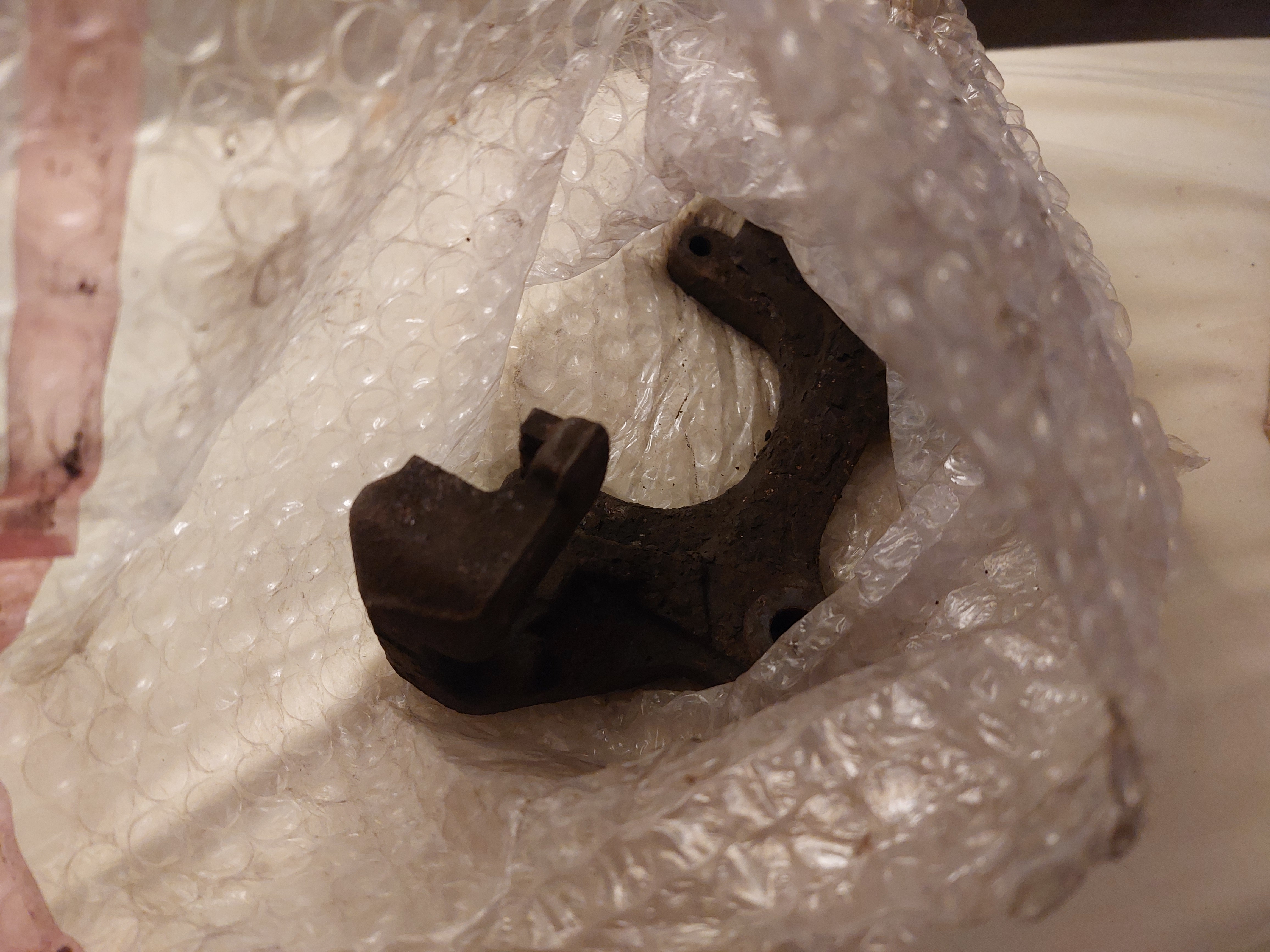

First is one for your vrs no hook Second is the ate ones You've already been sorted but this might help someone in the future

He does Ate calipers and therefore pads are used on mk2 fabia vrs and most montes. Conveniently vw also use the same ate caliper and pads for the 312mm setup.

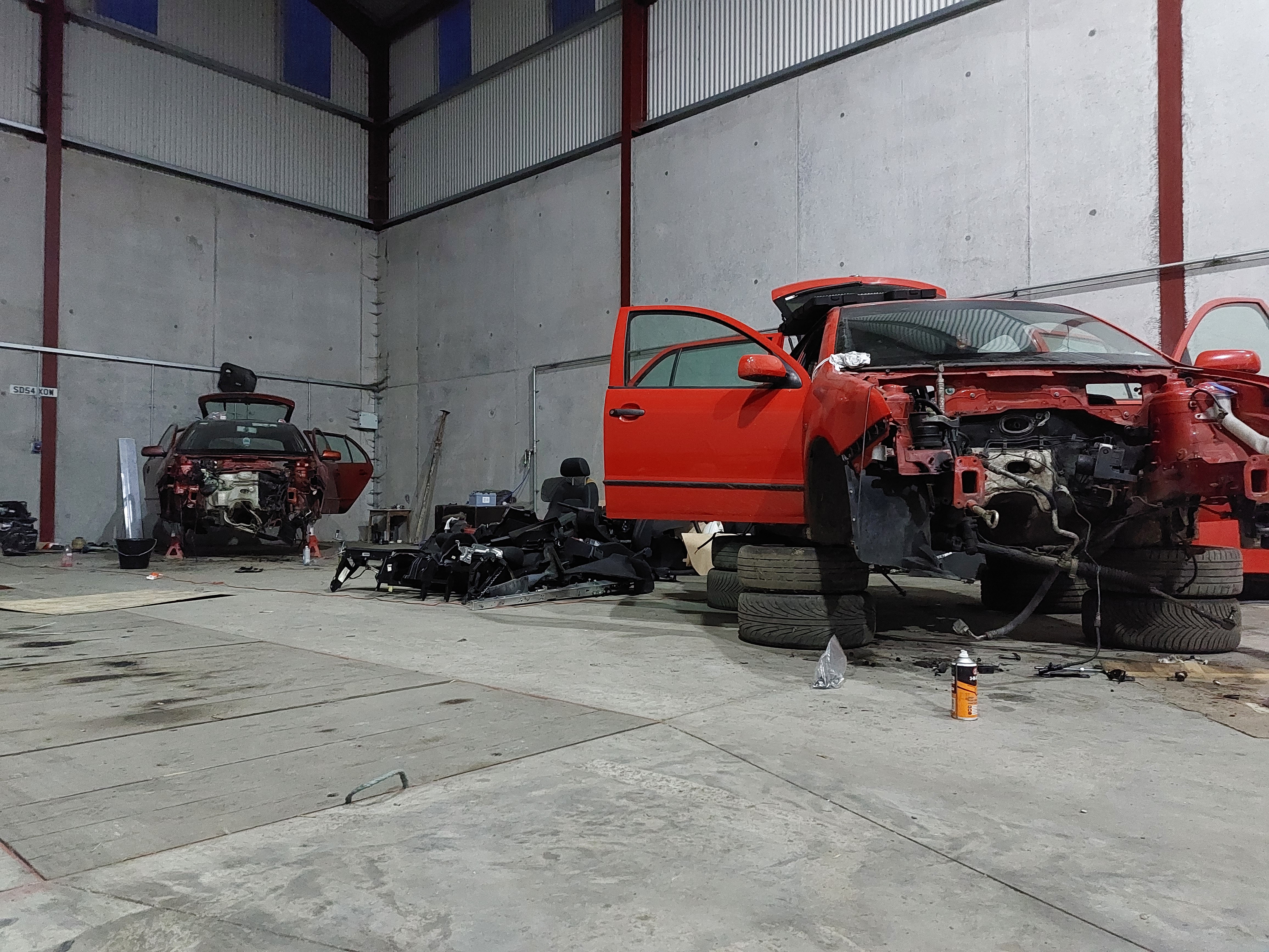

Diesel Monte's 2001 Skoda Fabia "Project vRSDI"

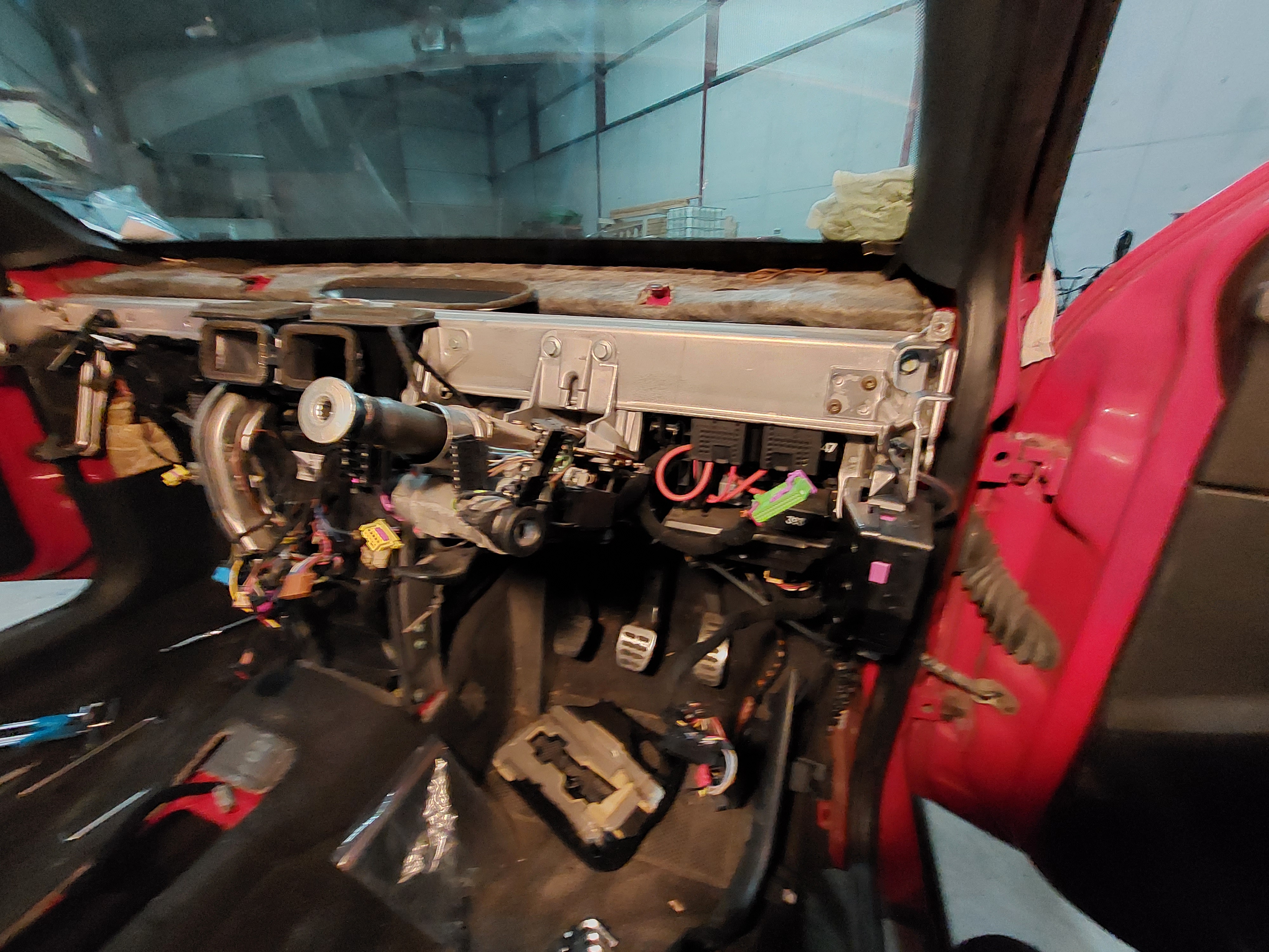

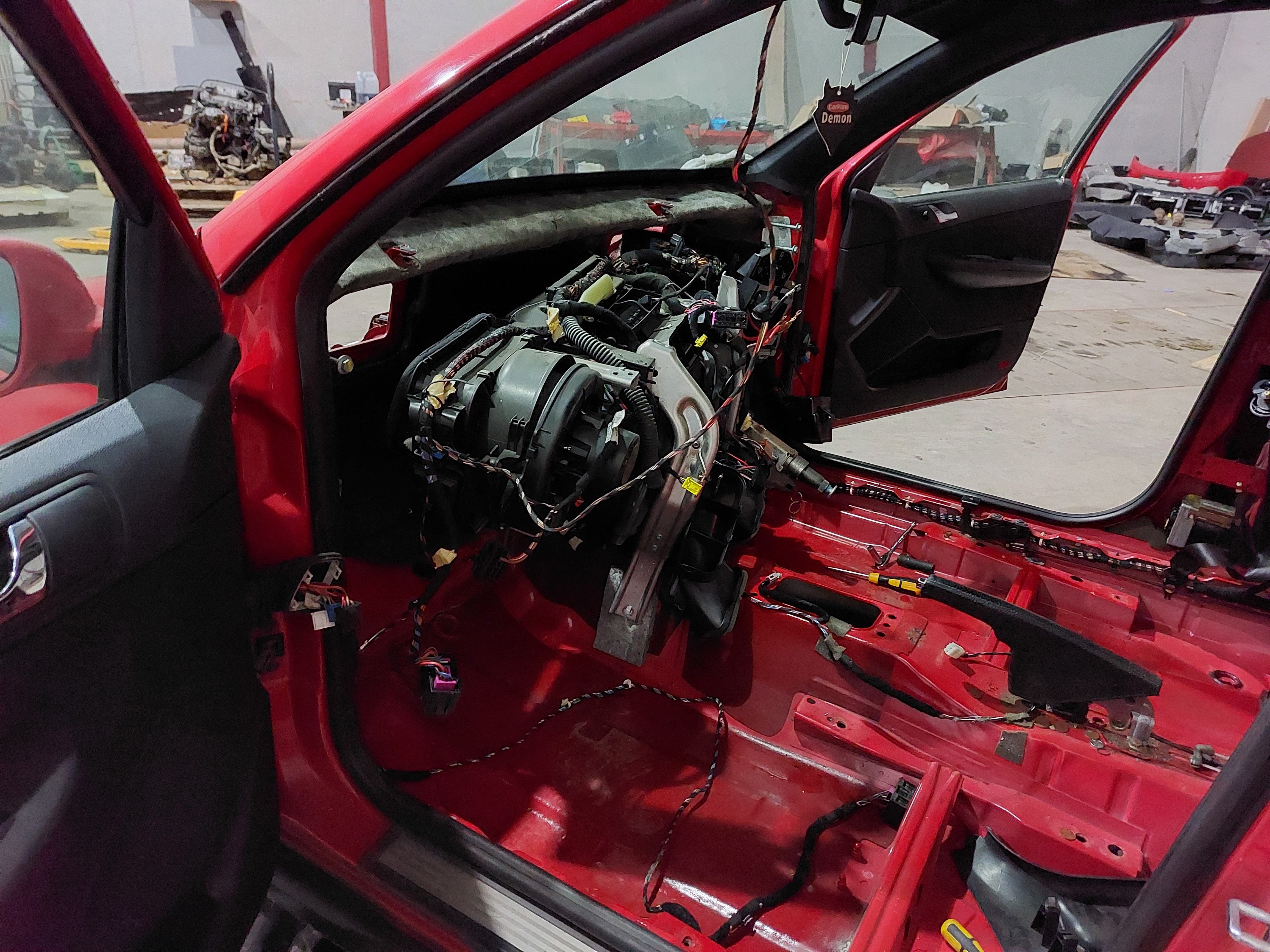

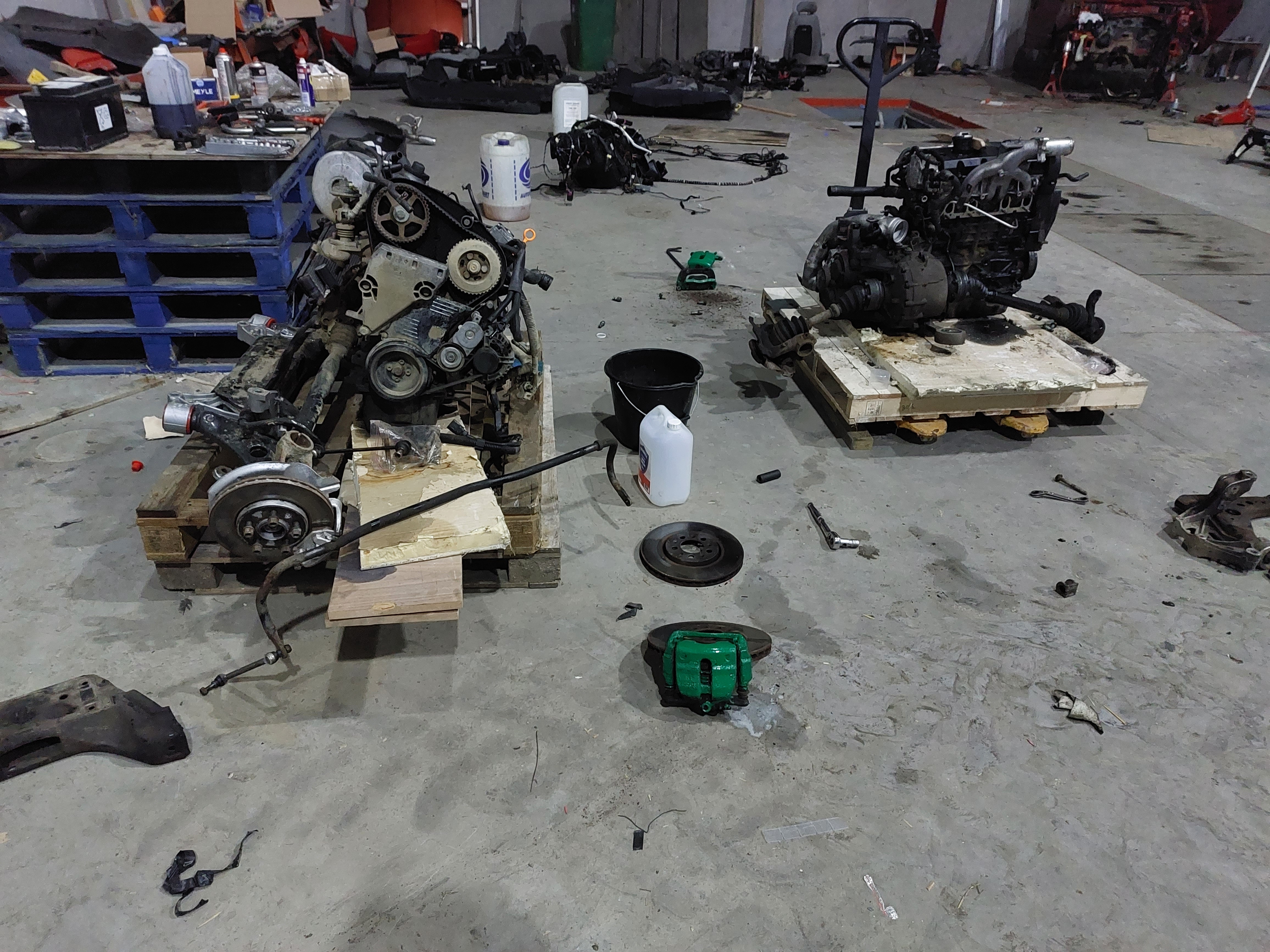

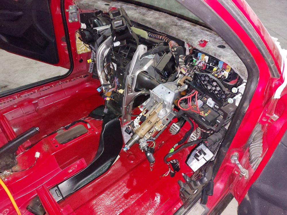

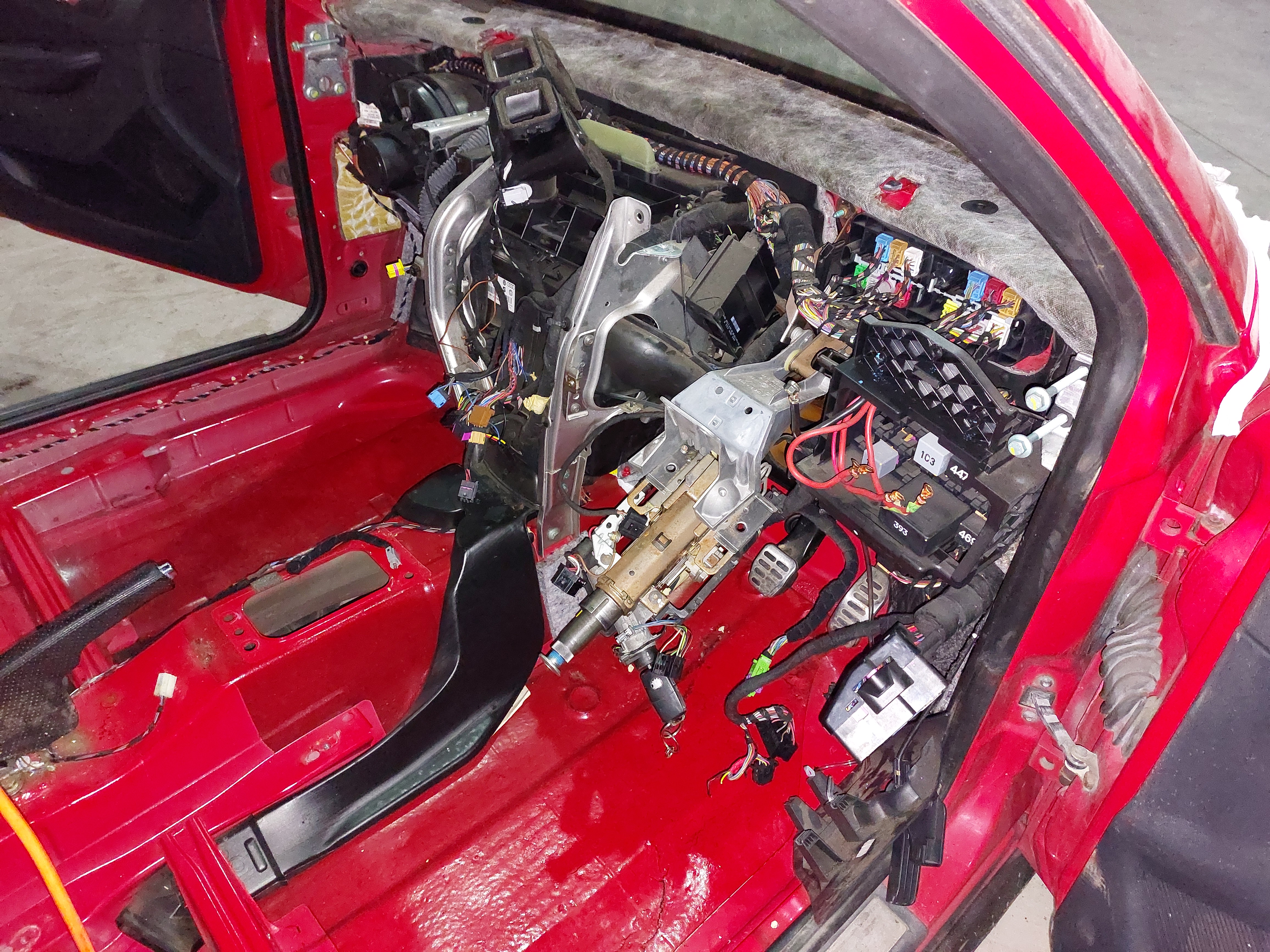

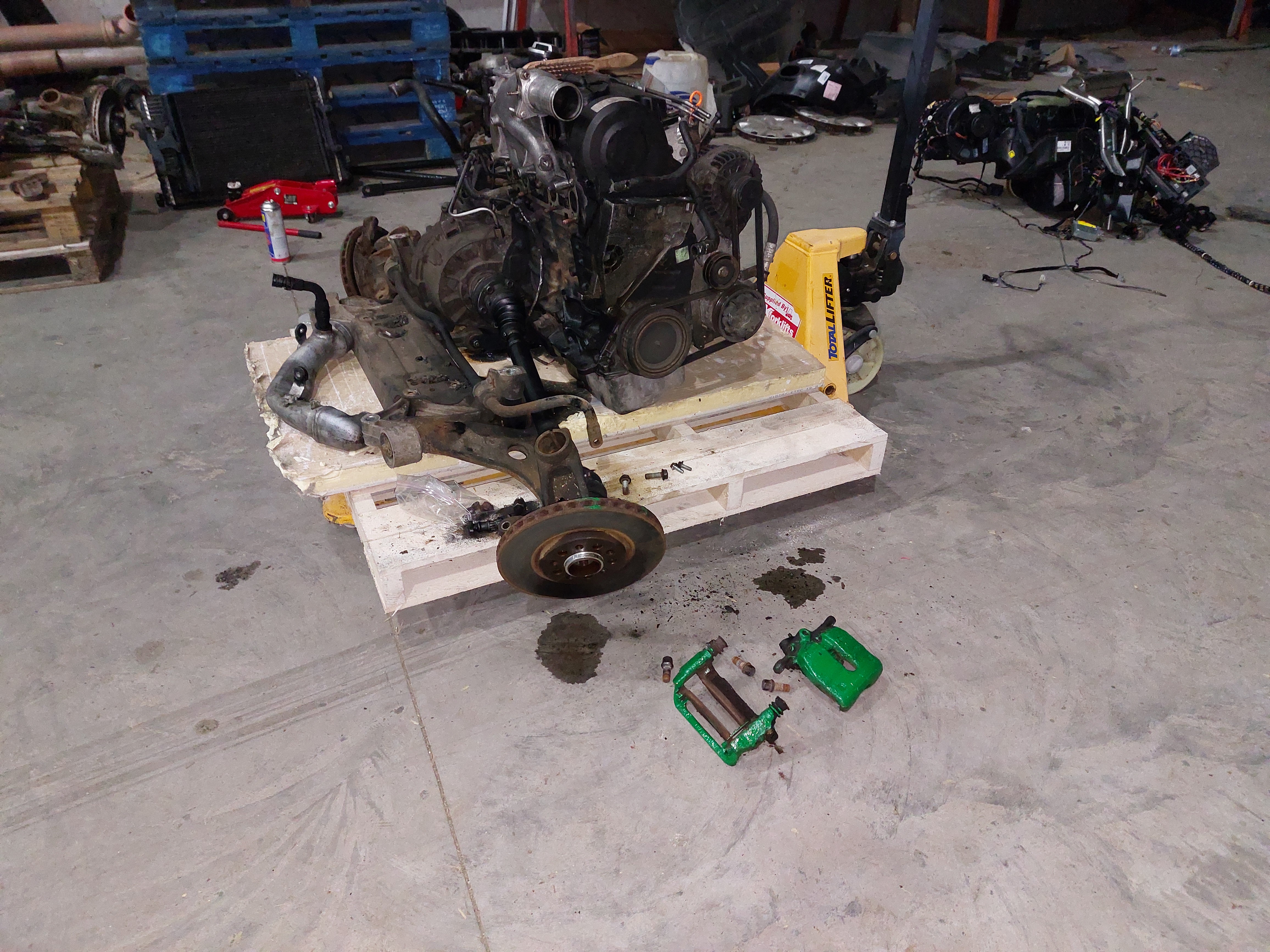

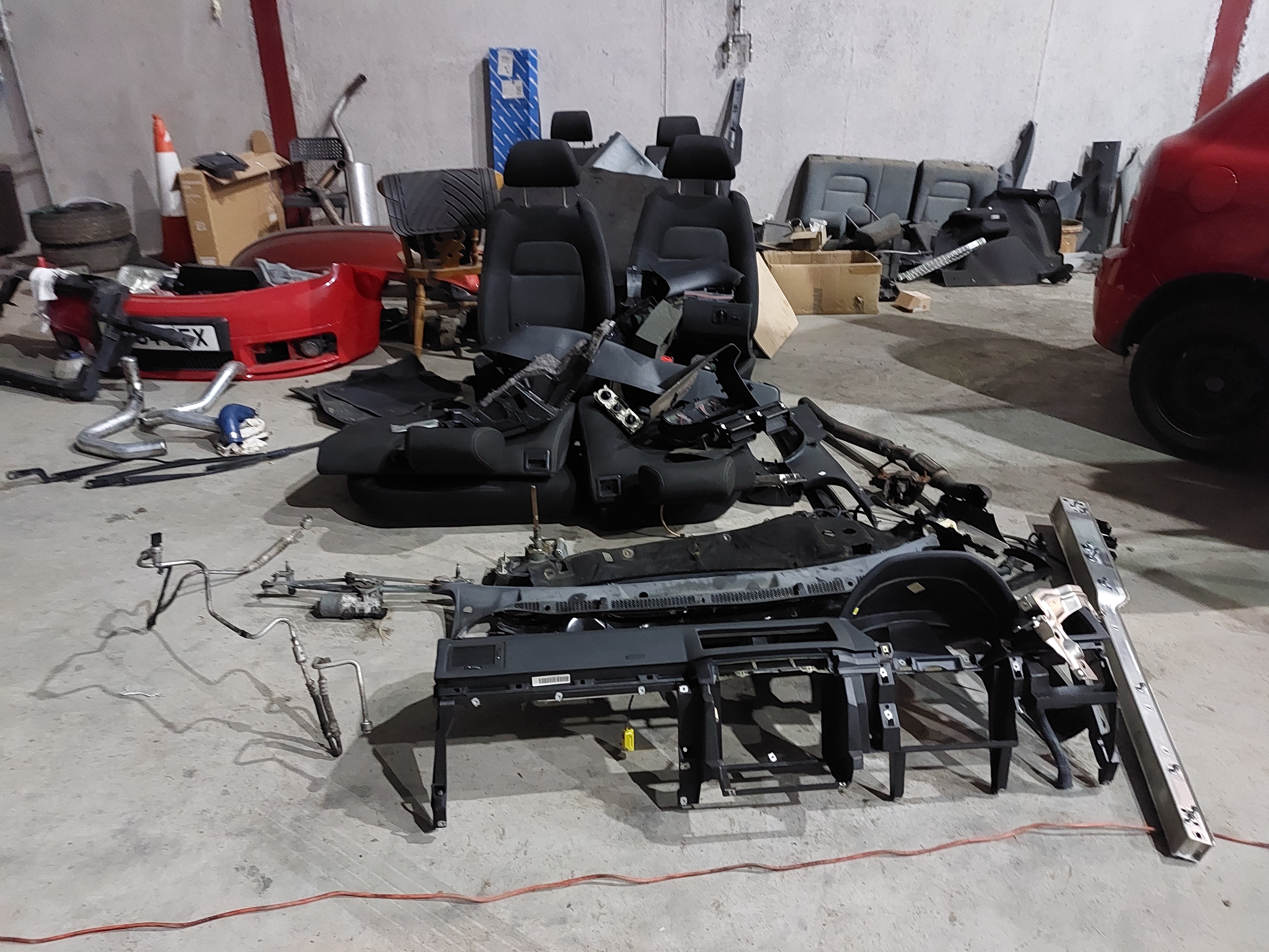

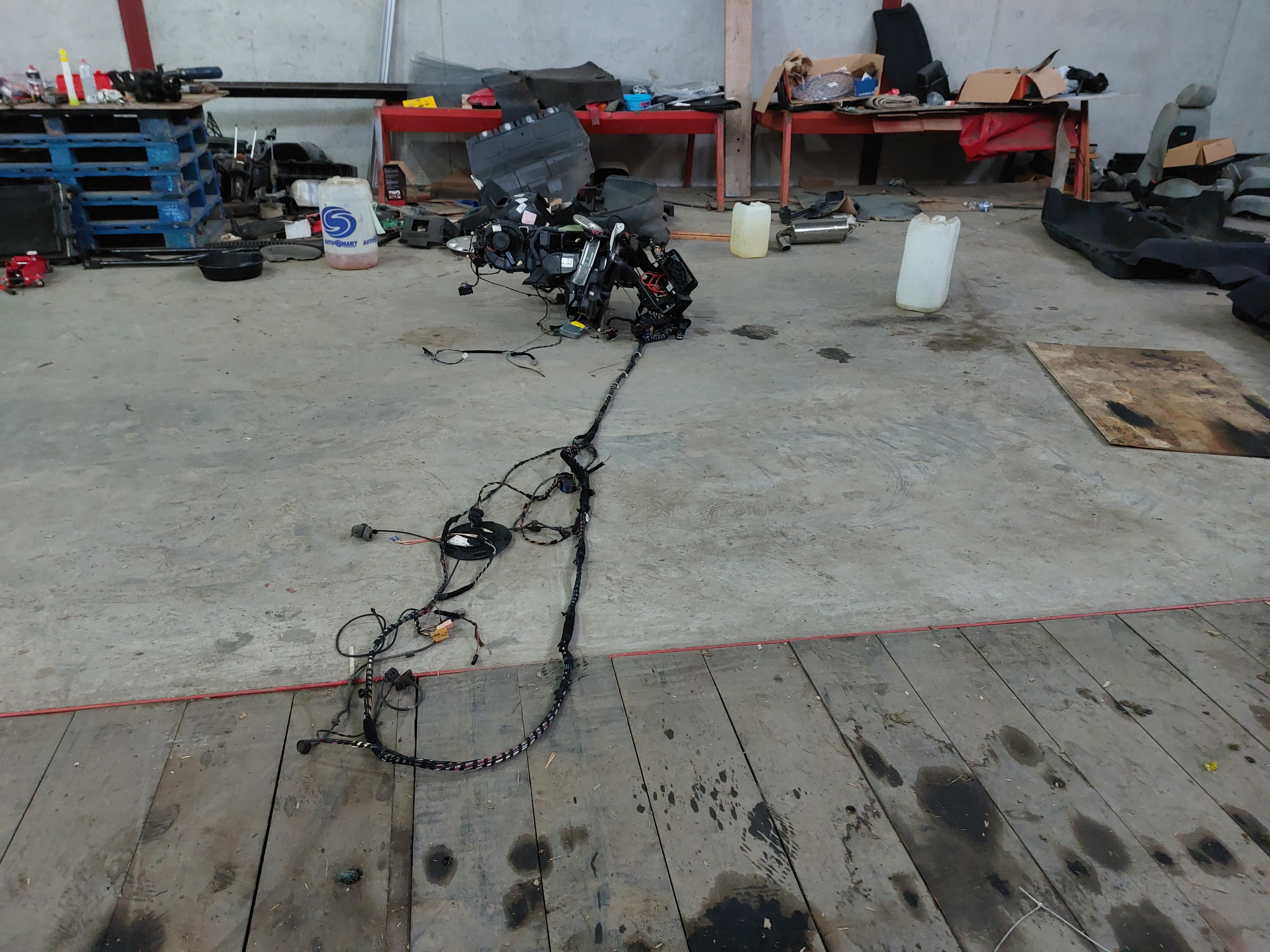

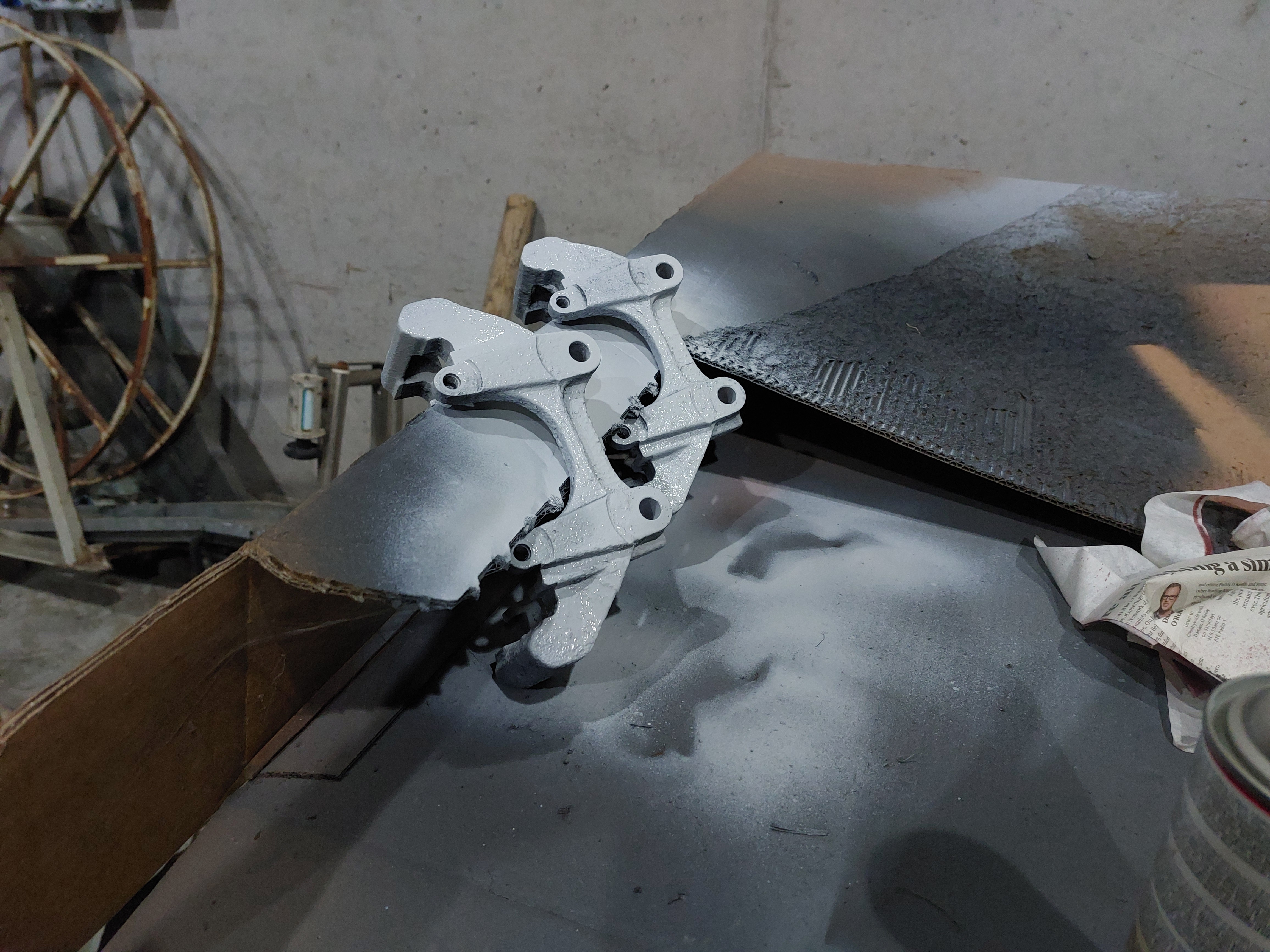

Wiring loom is fully out of the vrs now Came across another obstacle in that the bulkhead is different, it doesn't have the hole for ac. Seems like it's removable so I'll swap it over at some point. Just more work. Also got a new return line And 312mm carriers So of course I've started stripping down the brakes. Plenty of life left in them clearly.

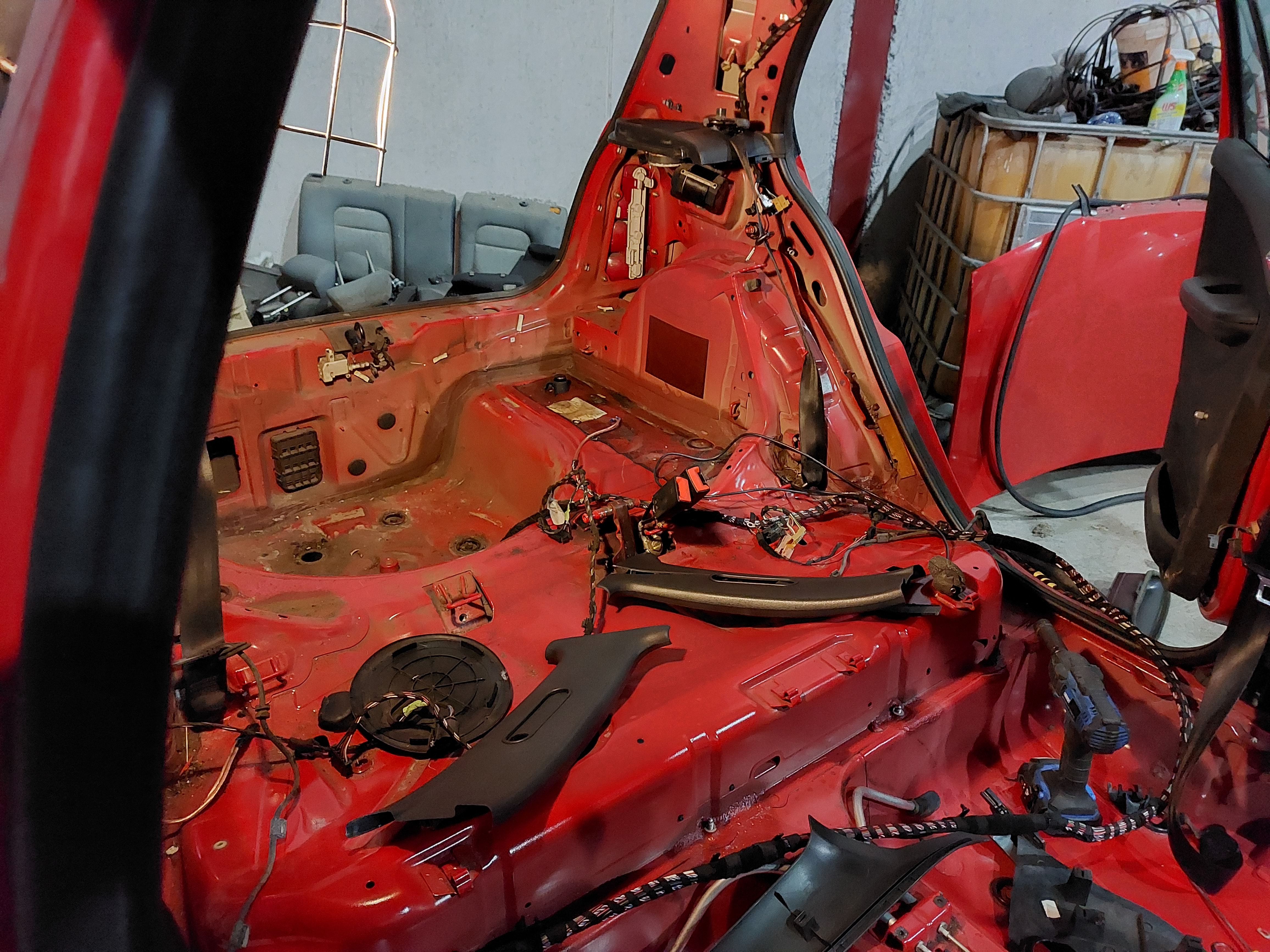

Almost everything out. Only thing that needs to come out is the wiring for the dome light. Pile of parts grows bigger again

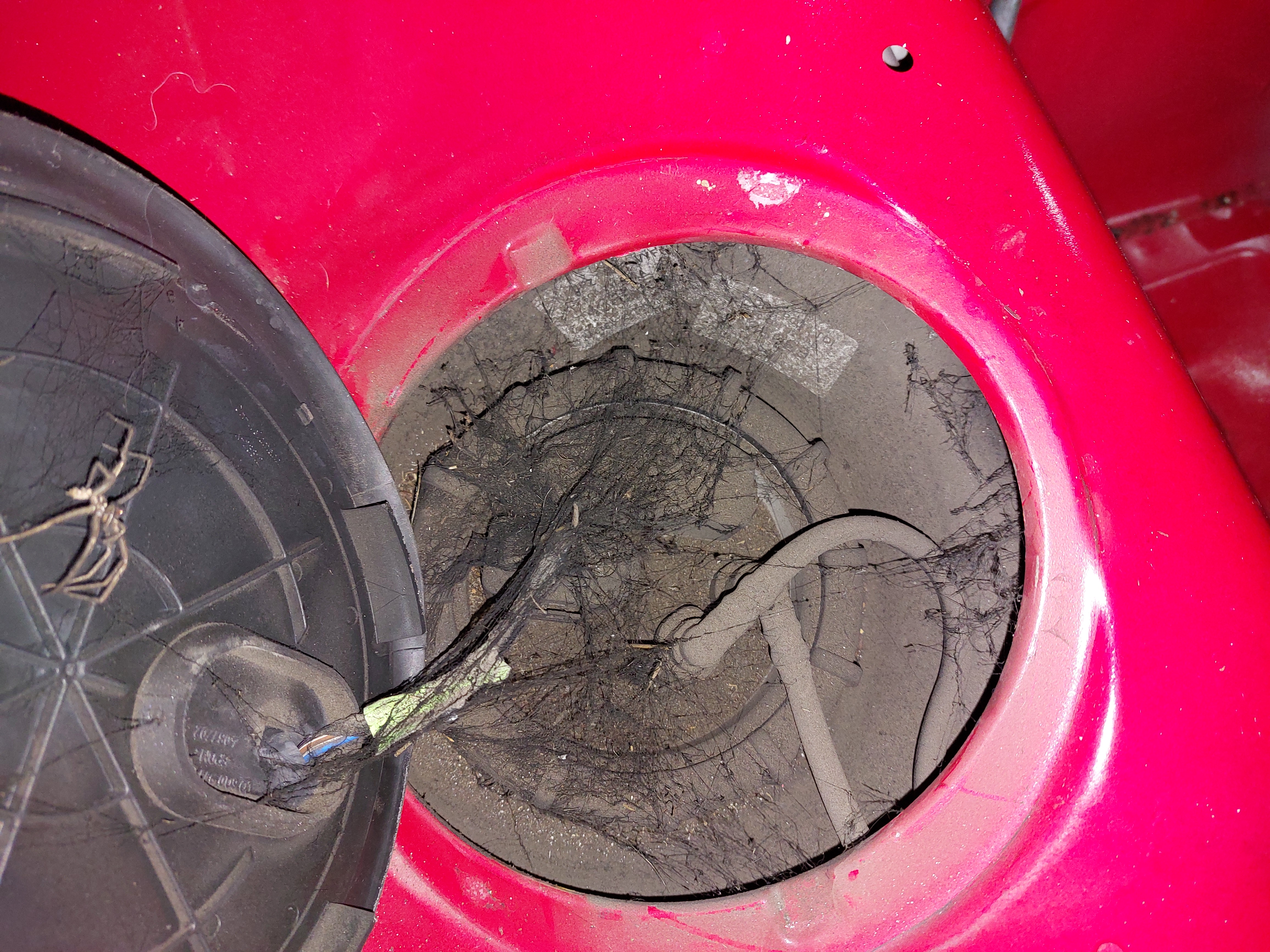

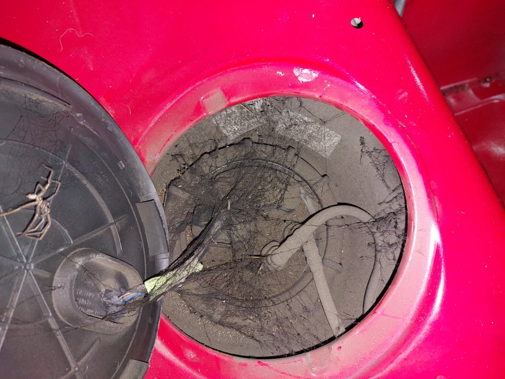

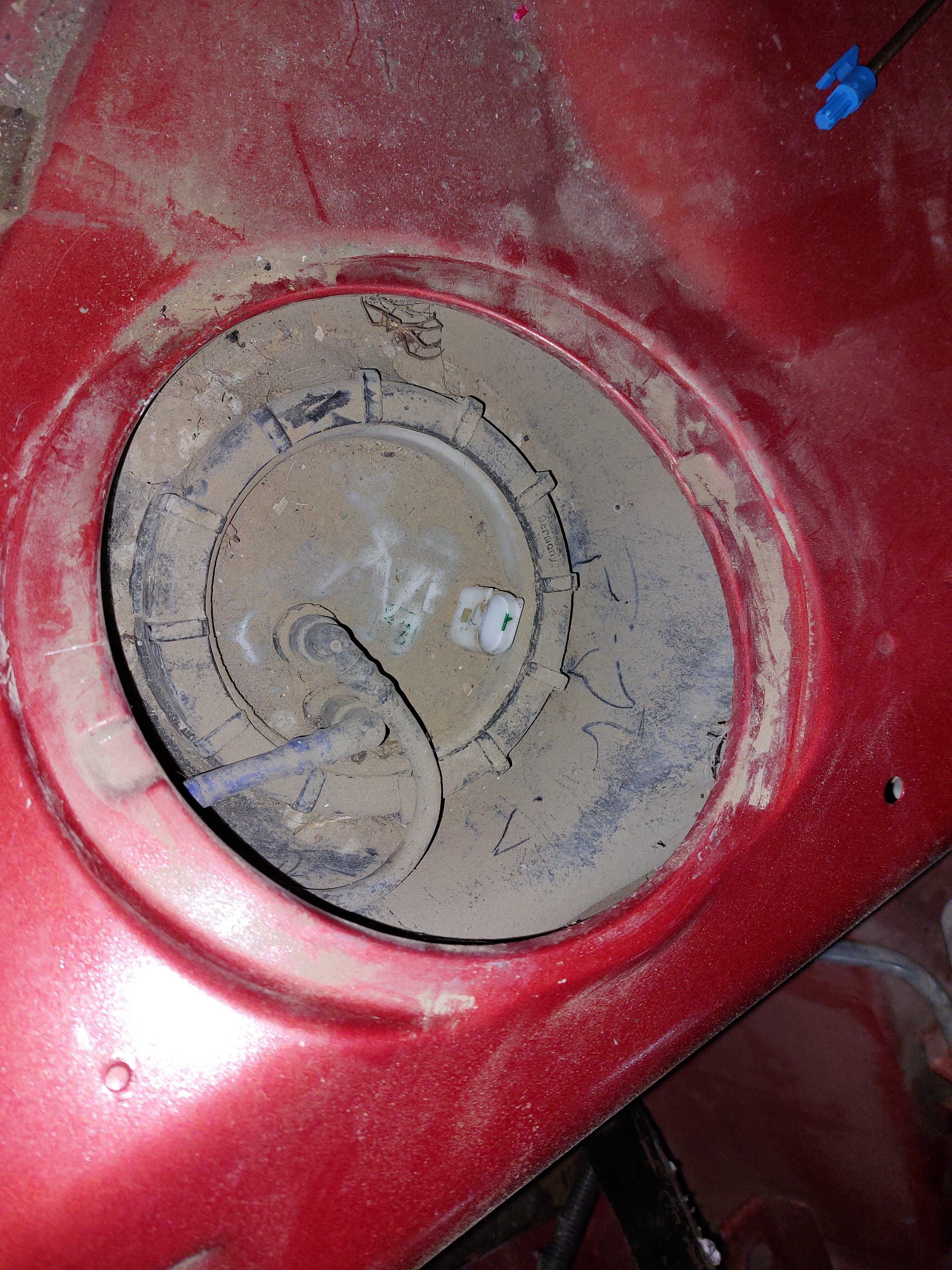

I well believe it, it would explain the different wiring. Whether that's attached to the top or its fitted to the tank I've no clue. Would be very stupid if it wasn't just attached to the tank. I'm hoping whatever happens I can reuse the fuel lines on the sdi. The vrs has a very rough looking fuel cooler, and the way its positioned is just asking for something to shoot up and bust it. I intend on repurposing the black trim and headlining into the sdi. Funny enough I bought some black dye to dye all of the carpets and such. It's good stuff but very strong. Will probably still use it to make everything a slightly darker black. I think it'll look great in my car with the sport (bohemia(?)) seats and door cards I already have. Tell you what though, I've noticed more and more bits of extra sound deadening on the vrs compared to the sdi. It all looks factory. Whether it's a spec thing or a year thing I don't know.
