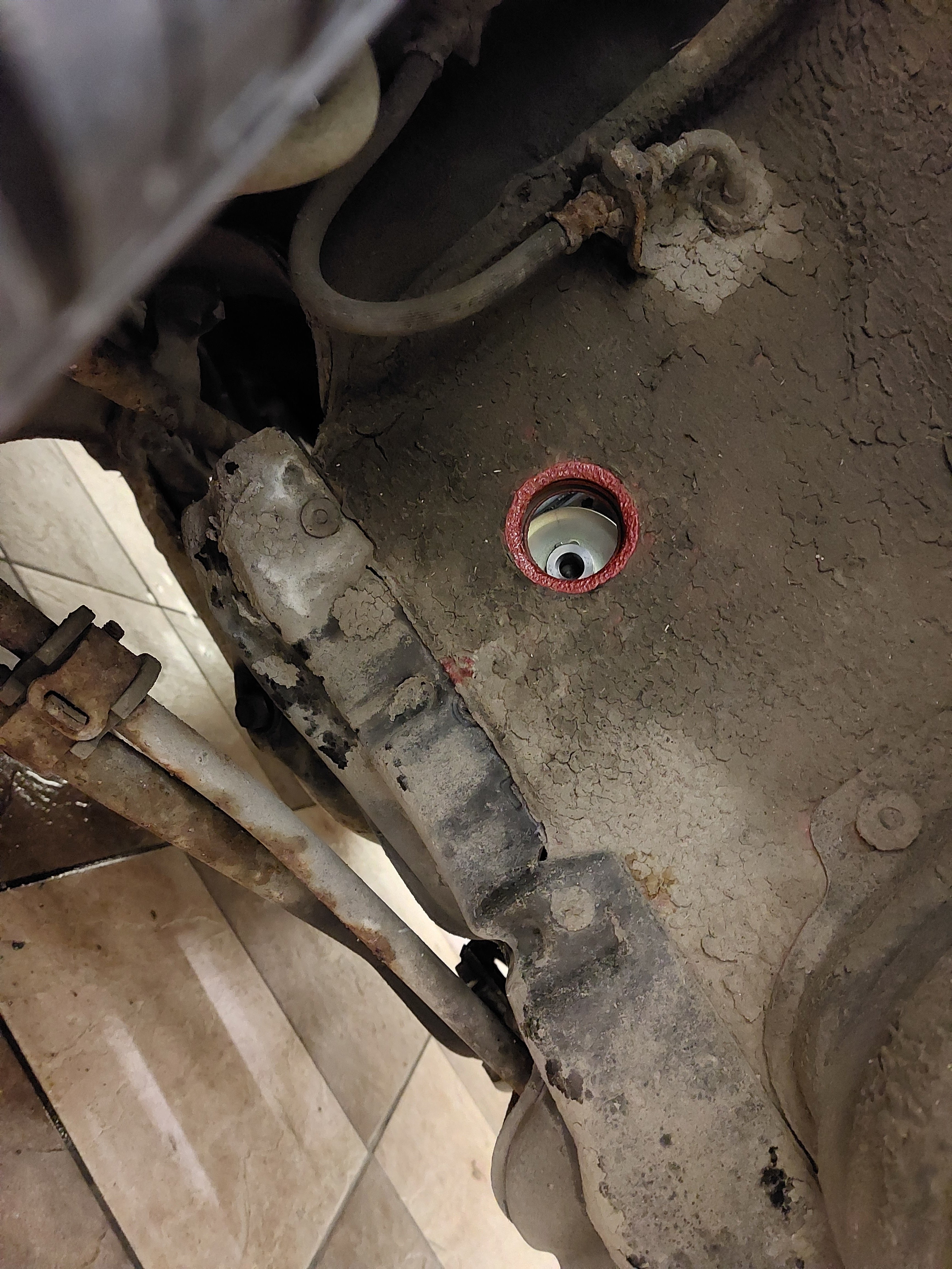

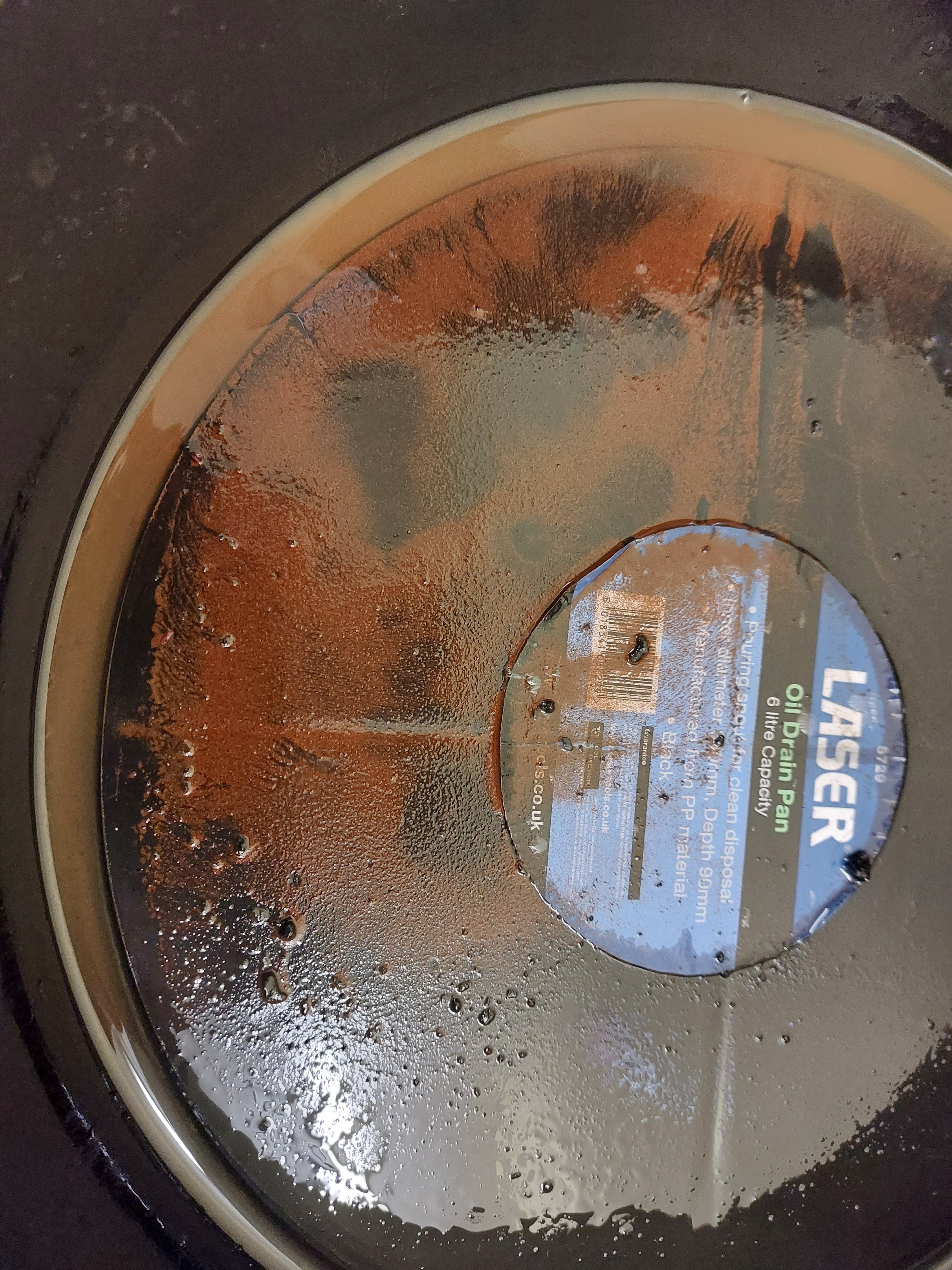

New backbox is here and on Looks a lot nicer All the rubbers are fine so no point getting new ones. Really straight underneath for being 30 year old. Jacked it up on the rear to try drain some out of the tank.

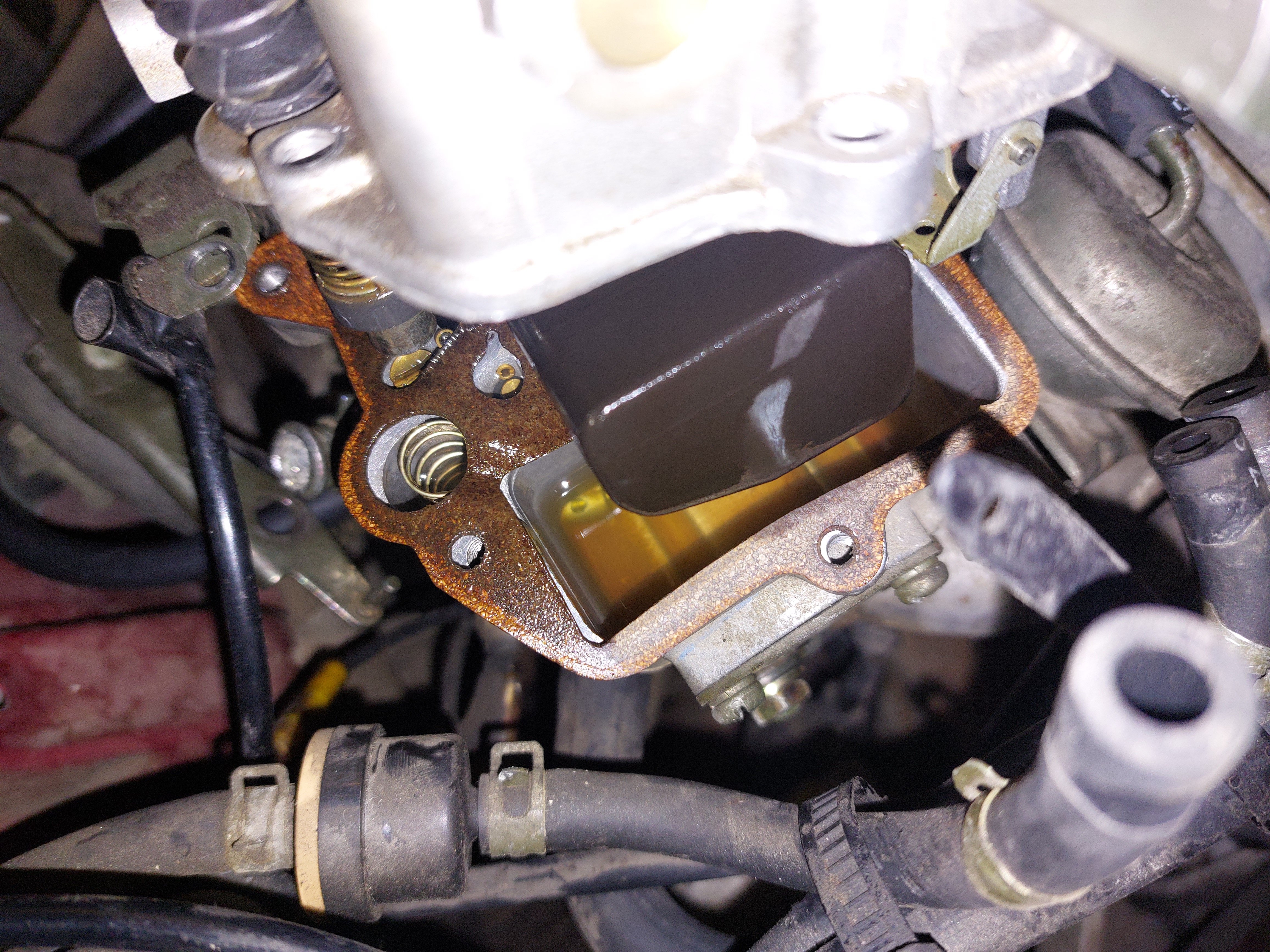

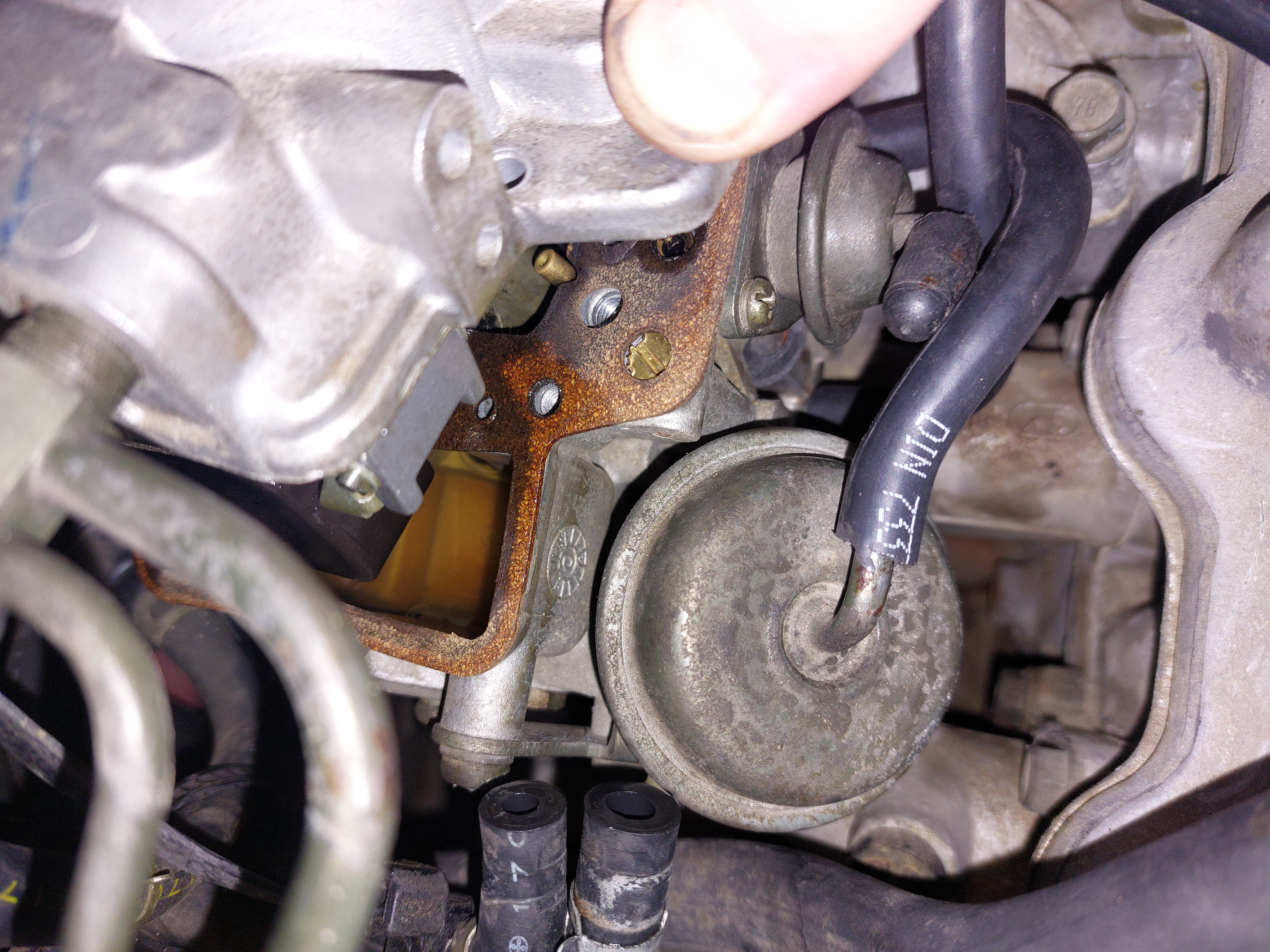

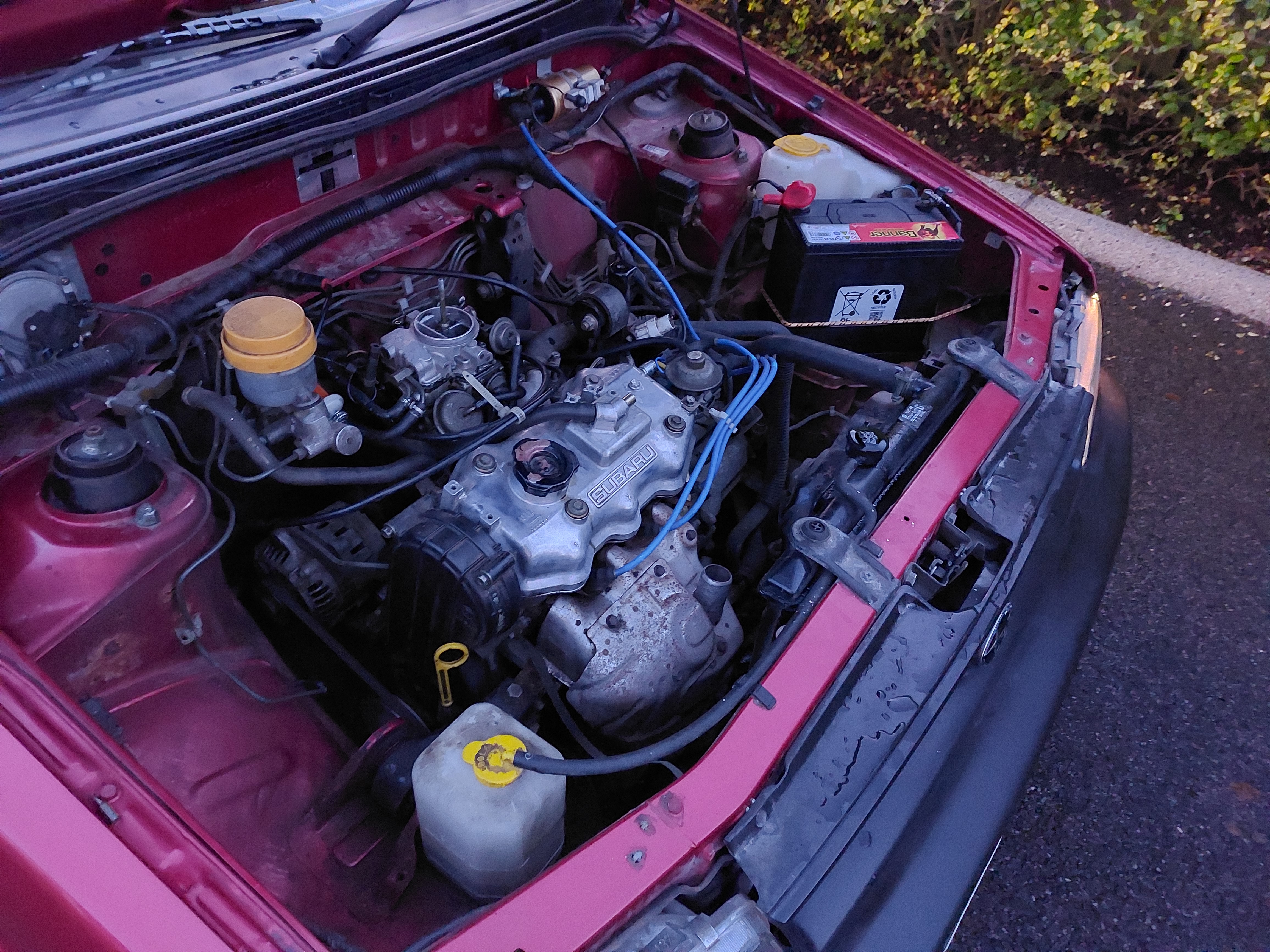

Not much here but enough to warrant a post. Carburetor is off again awaiting another kit. Be getting another float to try, cork gasket and some new jets. Whether they are the correct jets or not who knows. Also Finally got it trailered out to the farm, didn't really want to be pulling the fuel tank at home so. Have finally found a backbox that will bolt up, to save me shelling out for getting the stainless one put on. New standard fit backbox.

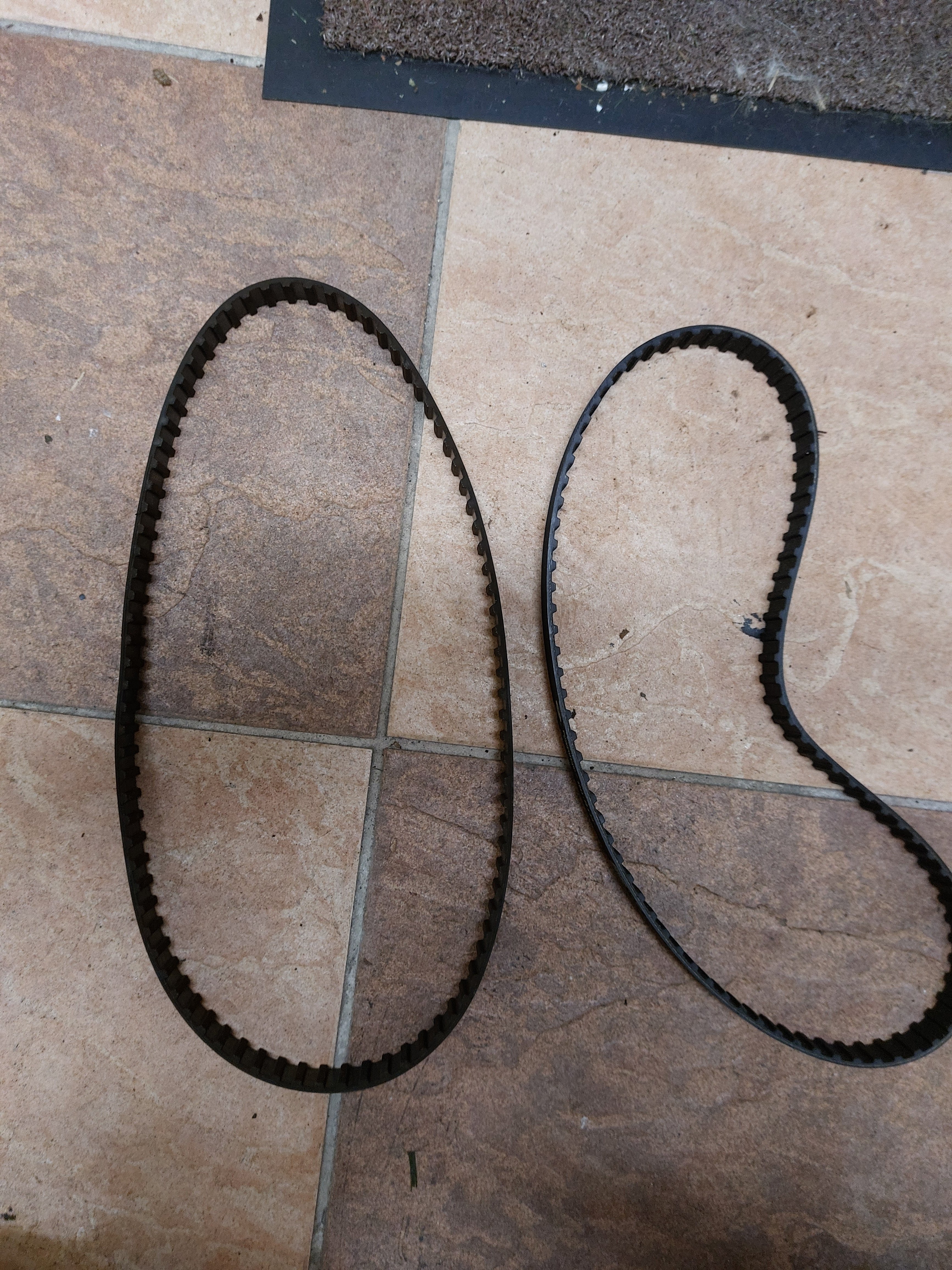

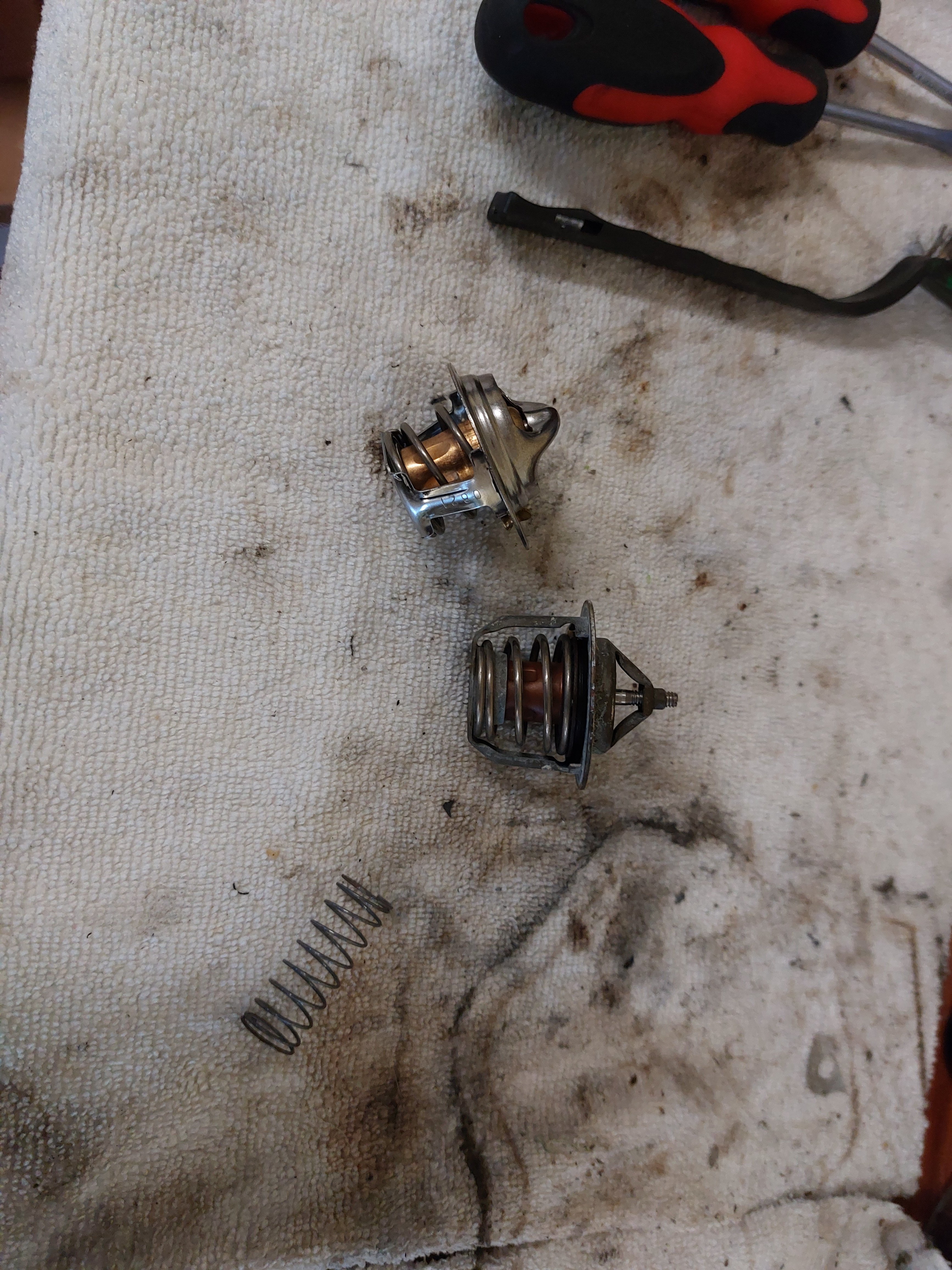

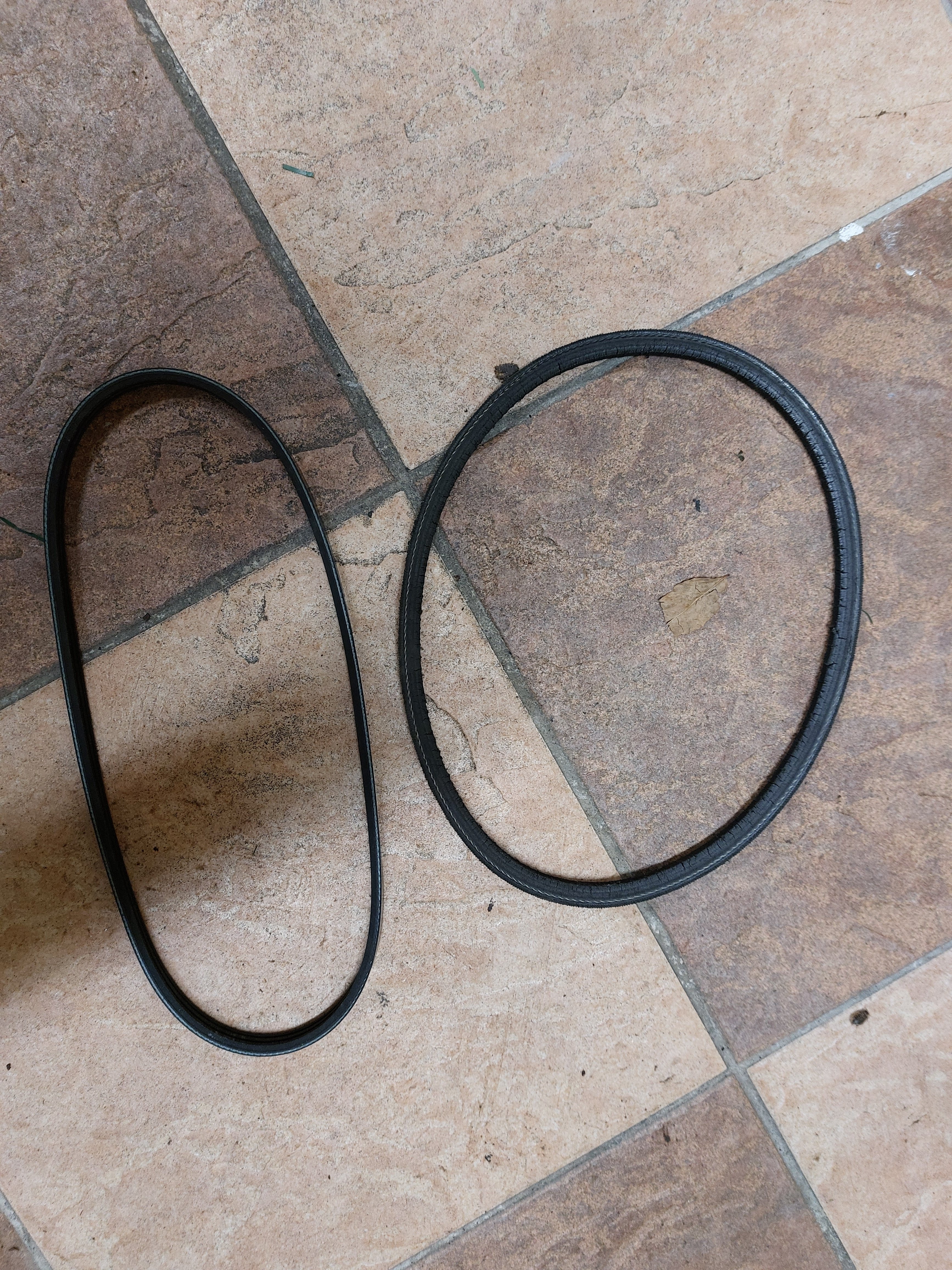

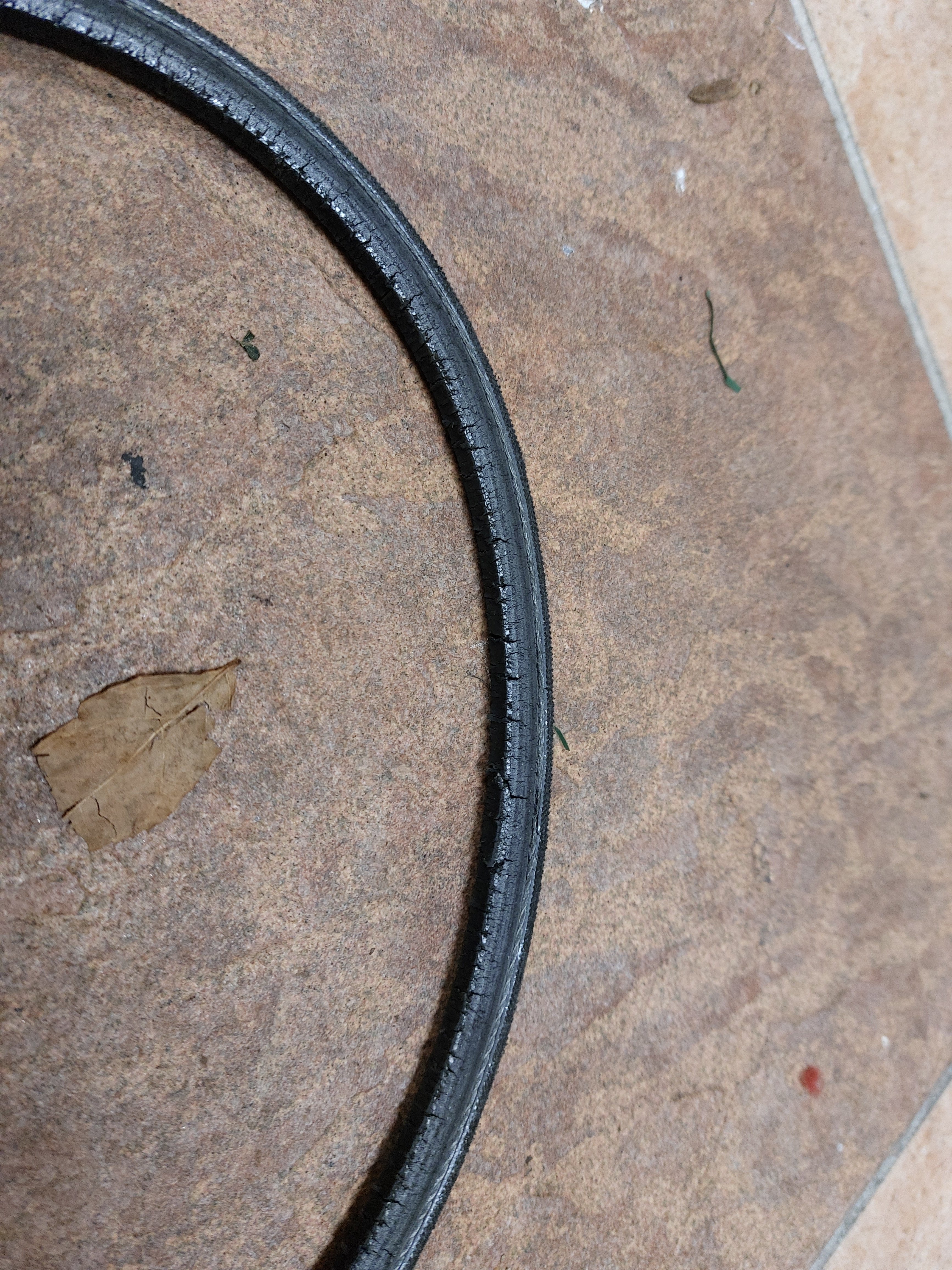

New Thermostat is on. Its a Gates one so hopefully it will be OK. Put it in. Got it running and out of the garage for once. New accessory belt is not the proper one, made a lot of noise first start up and no matter how tight I got it. Kept wrangling itself off the pullies. So it has the old one on it again, for the time being. Tried bleeding the cooling system. Bit of seepage around the thermostat now. Came with new gaskets and I made sure to put it in the same way as the original one. Bit of sealant should take care of it. Aside from that. It seems the thermostat itself works fine. "Sealant around the edge of the carb" job seems to have done the trick for now. Don't mind the high idle. 20221230_164533.mp4

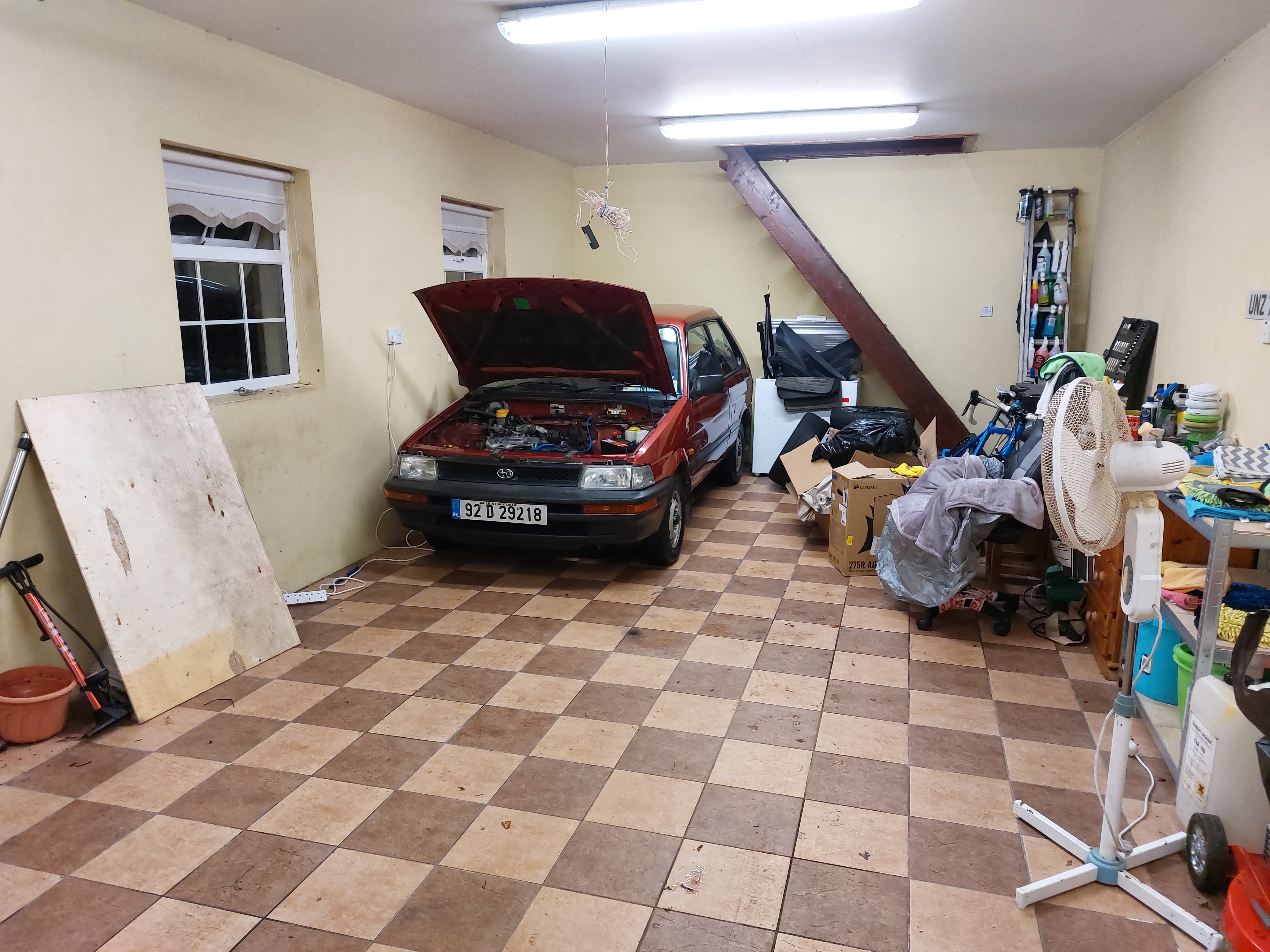

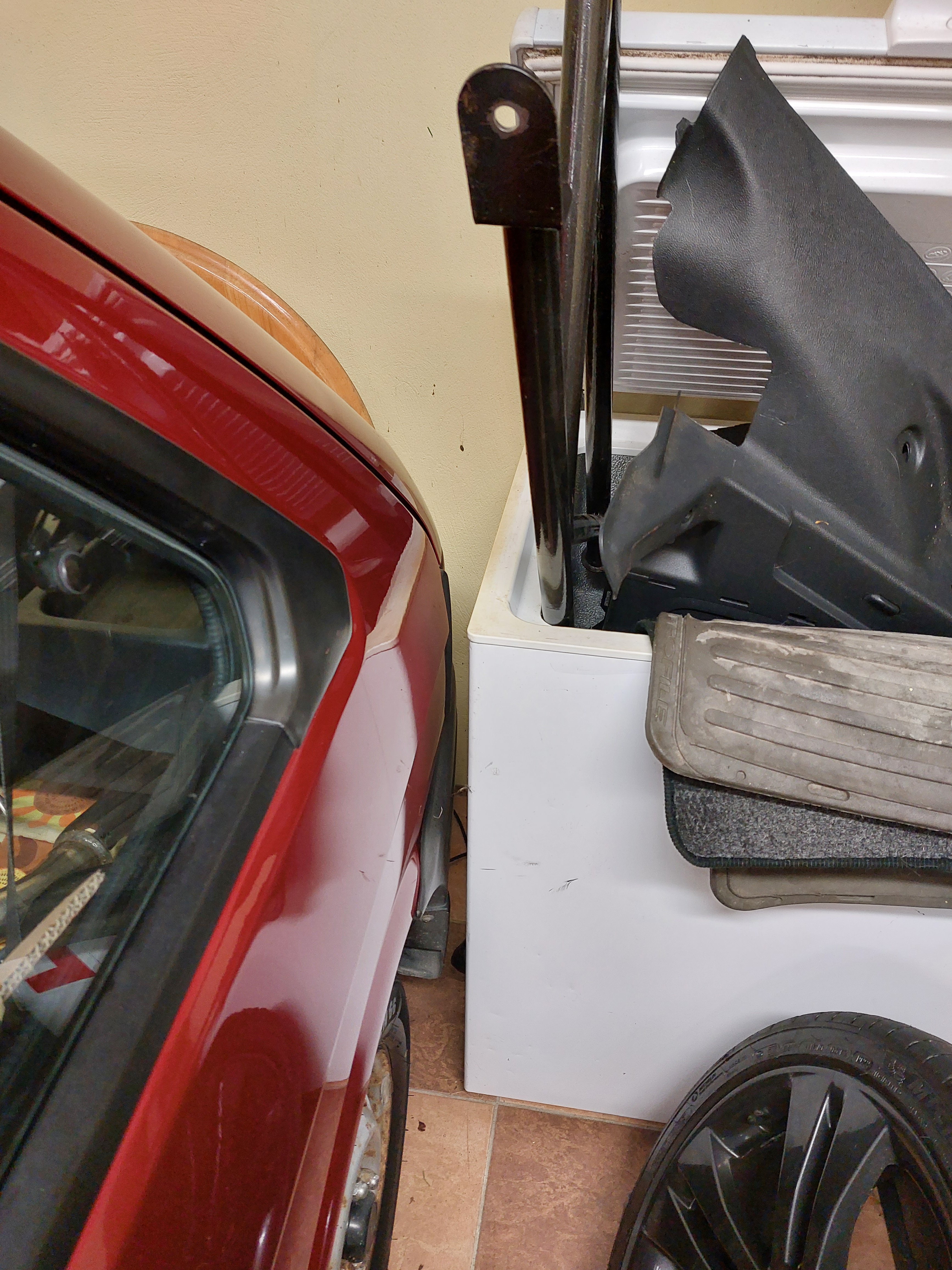

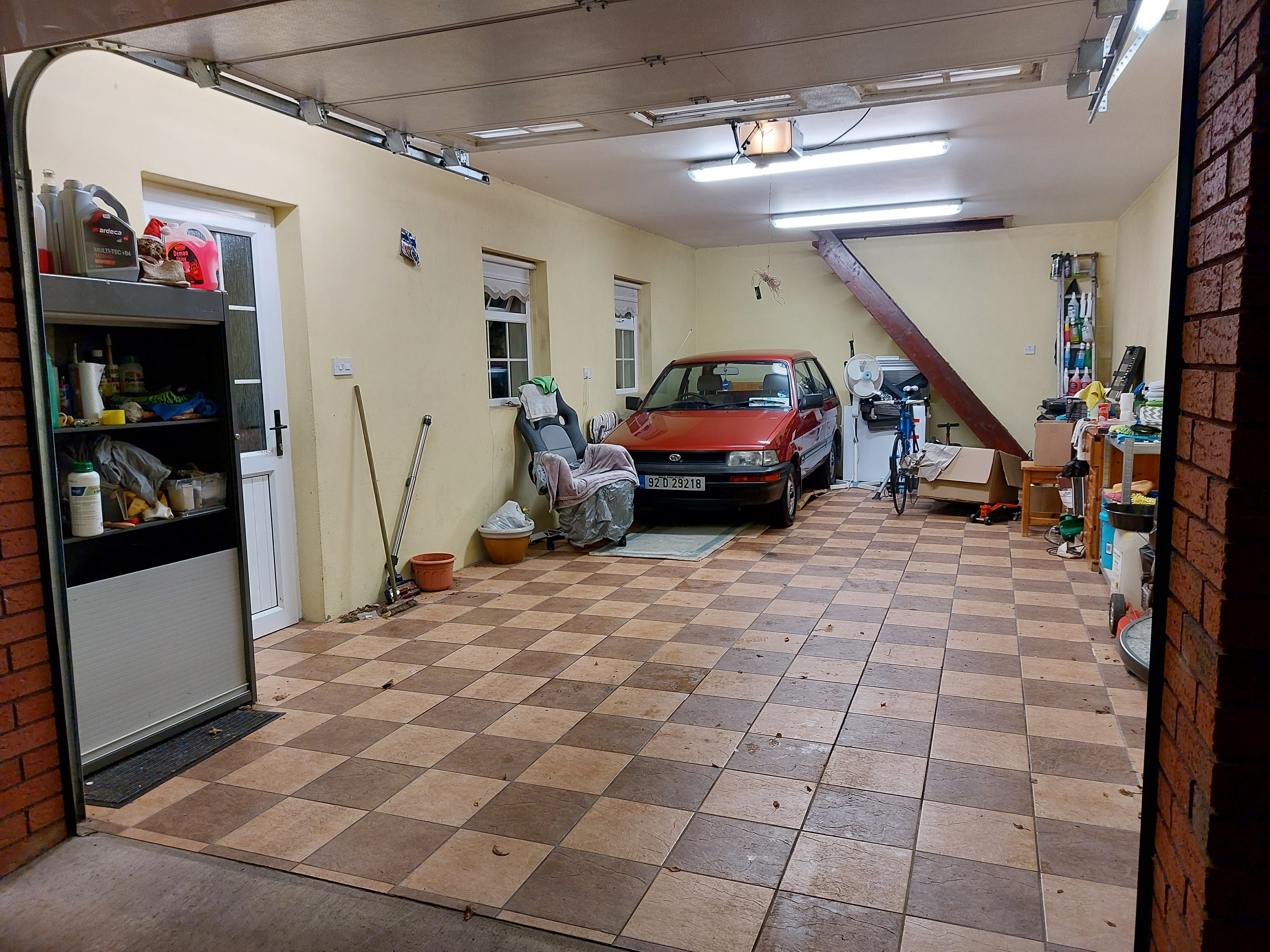

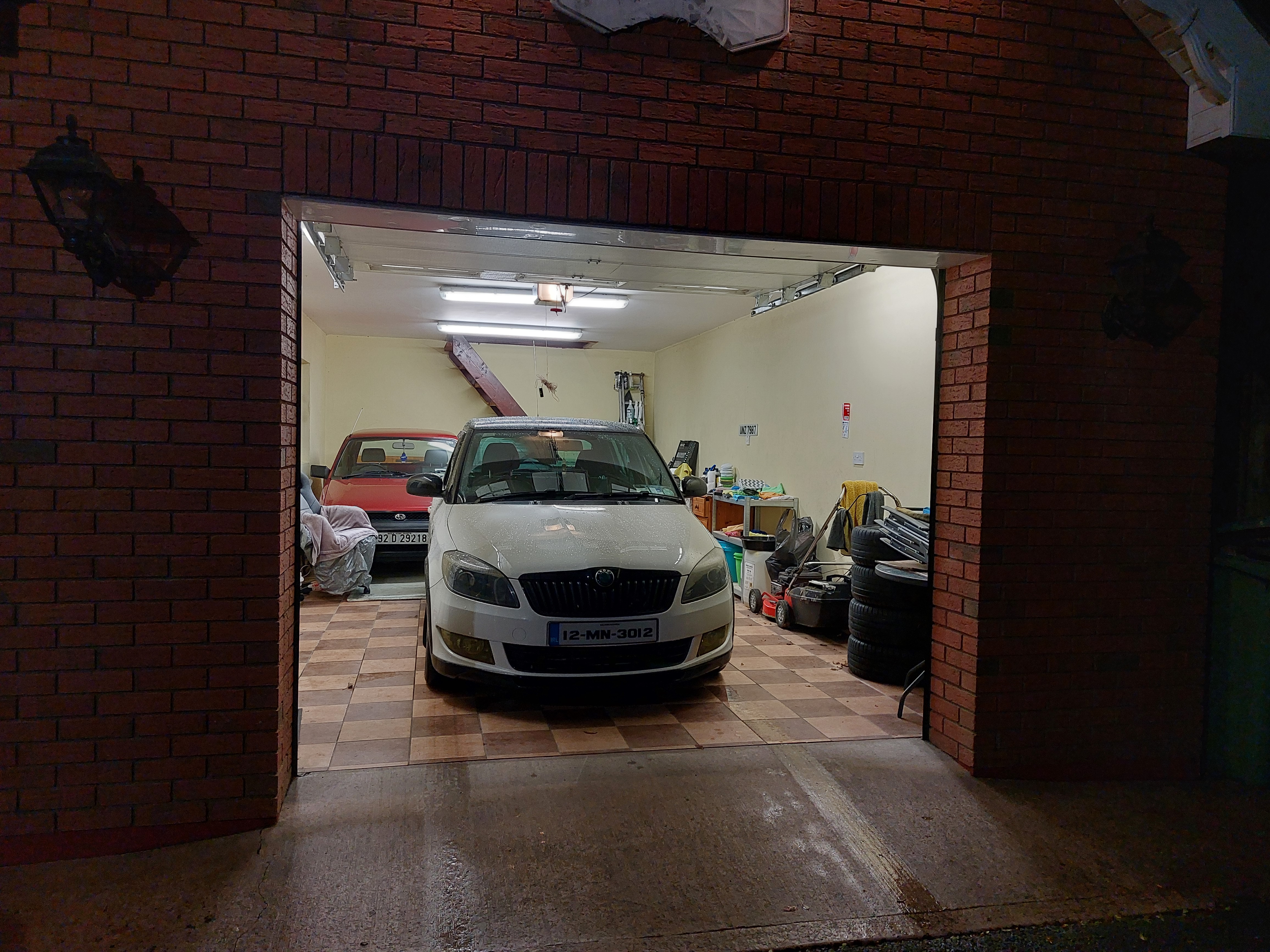

I've been needing more shelving here for ages. But if you think that garage is bad then you'd need to see the shed where the other fabias reside. Everything's just sort of laid out on the floor. That garage it wasn't much of a problem until I got the justy. All I used that garage for previously was storing a car after a wash, or for polishing. Think it'd be a good job for summer to take all out. Paint the walls and put up some racks. The attic is a mess too but I know as soon as I touch it someone will come along and mess it up again. Best of luck with the renovations.

Not really anything progress related but I'll post anyway. I have since tried (carefully) putting gasket sealant stuff onto the mating surfaces for the cork gasket, as a way to secure it properly and stop it slipping. It needs to cure so can't do any more there. Did take out the thermostat too to have a look, seems stuck solid. Dumped it into some boiling water and nothing happened. Will have to track down another it seems. With that out of the way, someone was up looking at the justy the other day and pointed out to me that if I moved some ****e about, I might be able to stuff it into the back of the garage and fit another car in. Wasn't doing too much so decided to try that out. Did create a fair mess moving stuff around. But it did seem possible. It's really jammed in though. The freezer isn't being used but I had to keep it in the garage. So I shove some bits of the Monte into it and pushed it deep under the stairs. Next problem is this old table top, I can't move it myself so it couldn't go anywhere either. With it out of the way I could get another few inches. Left myself some space on this side. Just in case. Slowly taking shape. Final test to see if all this hassle was worth it. It fits, just. Have about 6 inches from the front of the Monte to the garage door. I can't fit anything bigger than a fabia, but considering that's all I have, it doesn't matter. An hour or so spent but happy with the result. Can't complain about turning a 1 car garage into a 2 car garage for free.

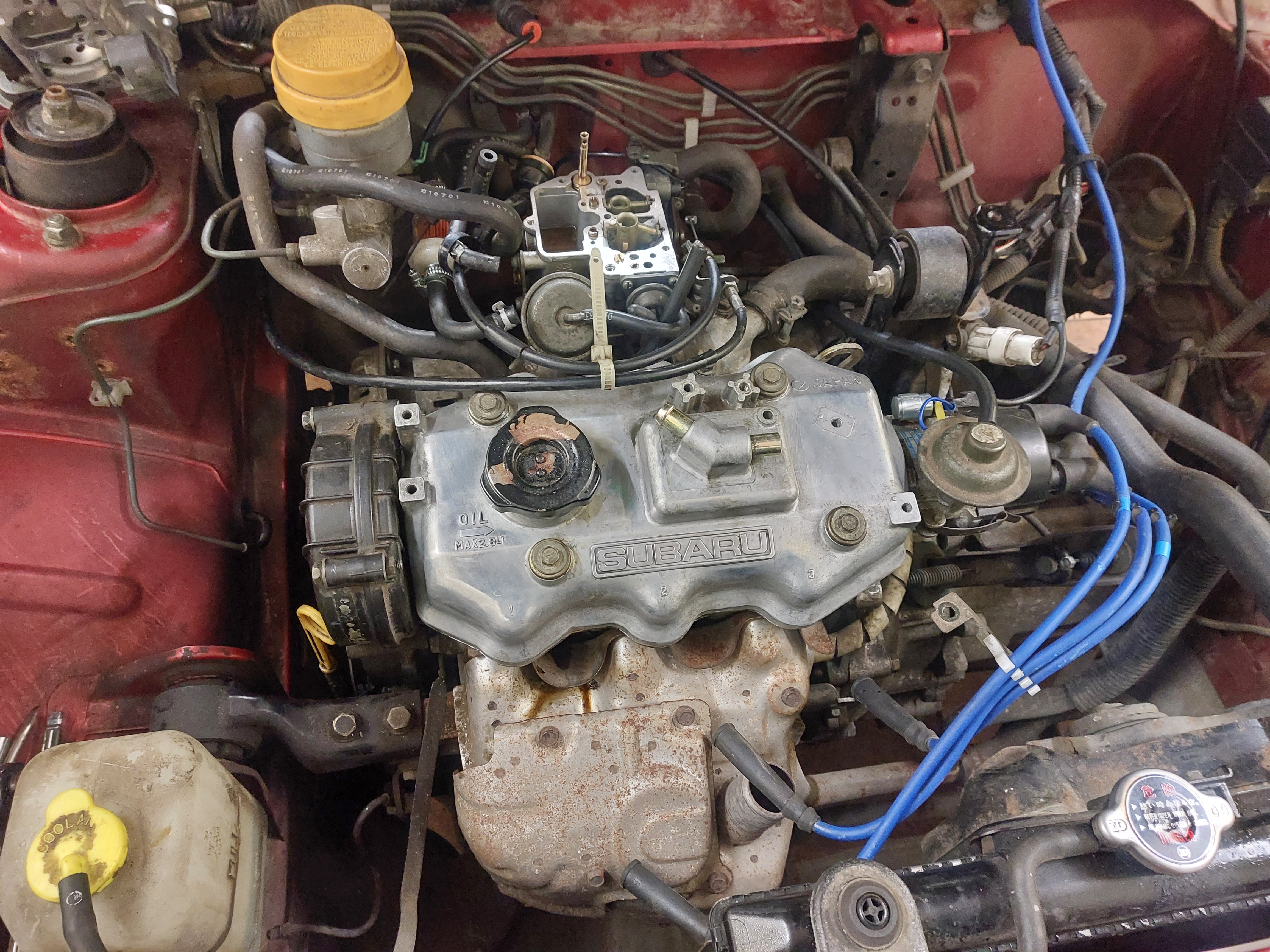

I probably could clean up the alternator with a wire brush. It's really not too bad though. For a car that was built to be disposable, it was really well built. It's a stout engine aside from a weak oil pump design. Think a lot of the reason this engine looks so healthy is because it would have never been neglected maintenence wise. I wonder if my work would have any records of it, considering they sold it new. It still has the original dealer sticker on the back, and a keytag with works name on it. Really debating putting a weber on now. Sort one thing on the hitachi and another problem crops up. For the little while it was going right. It drove absolutely fantastic. I did add another fuel filter just before the carb, to help stop the carb getting gunked up again.

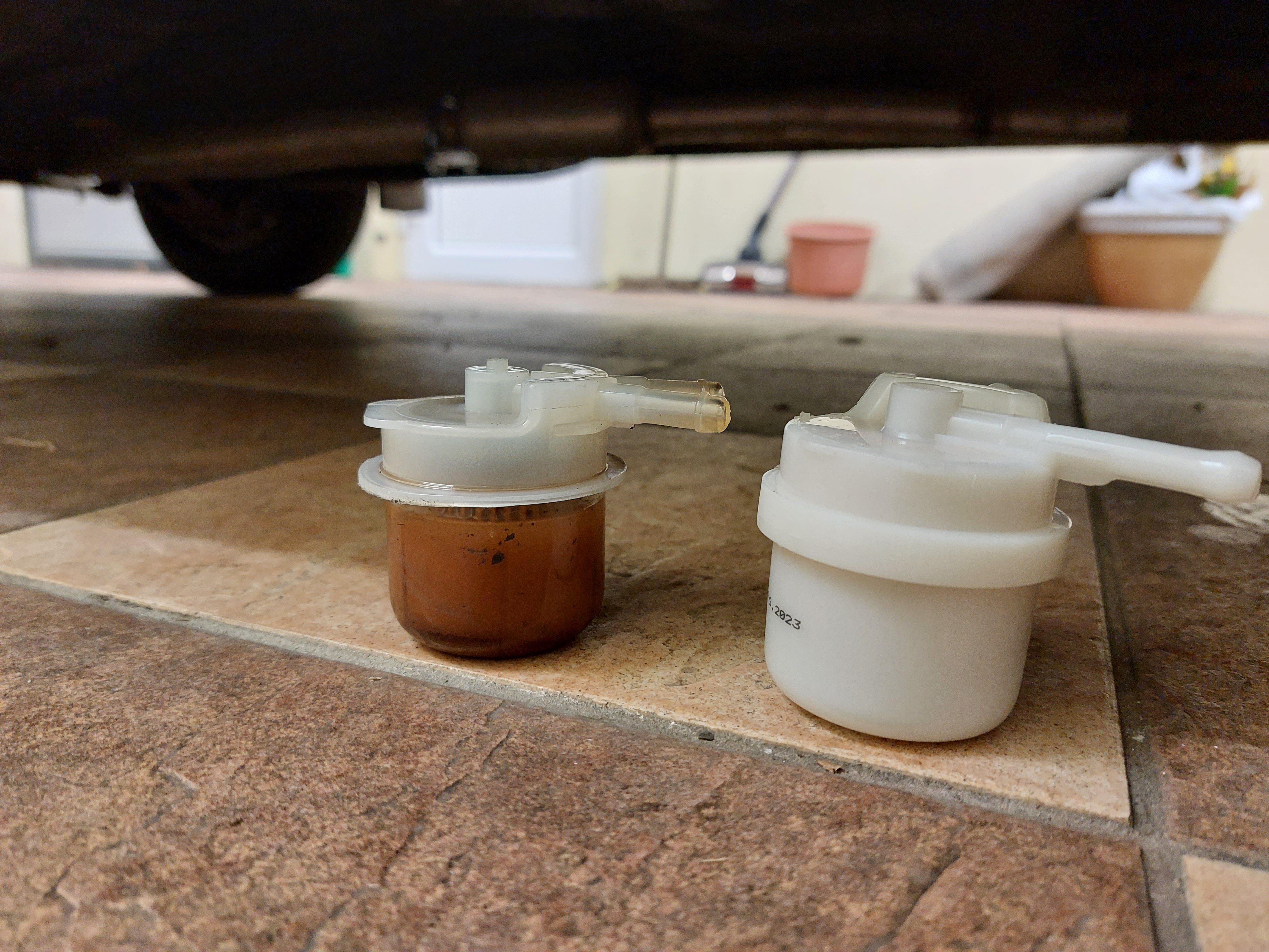

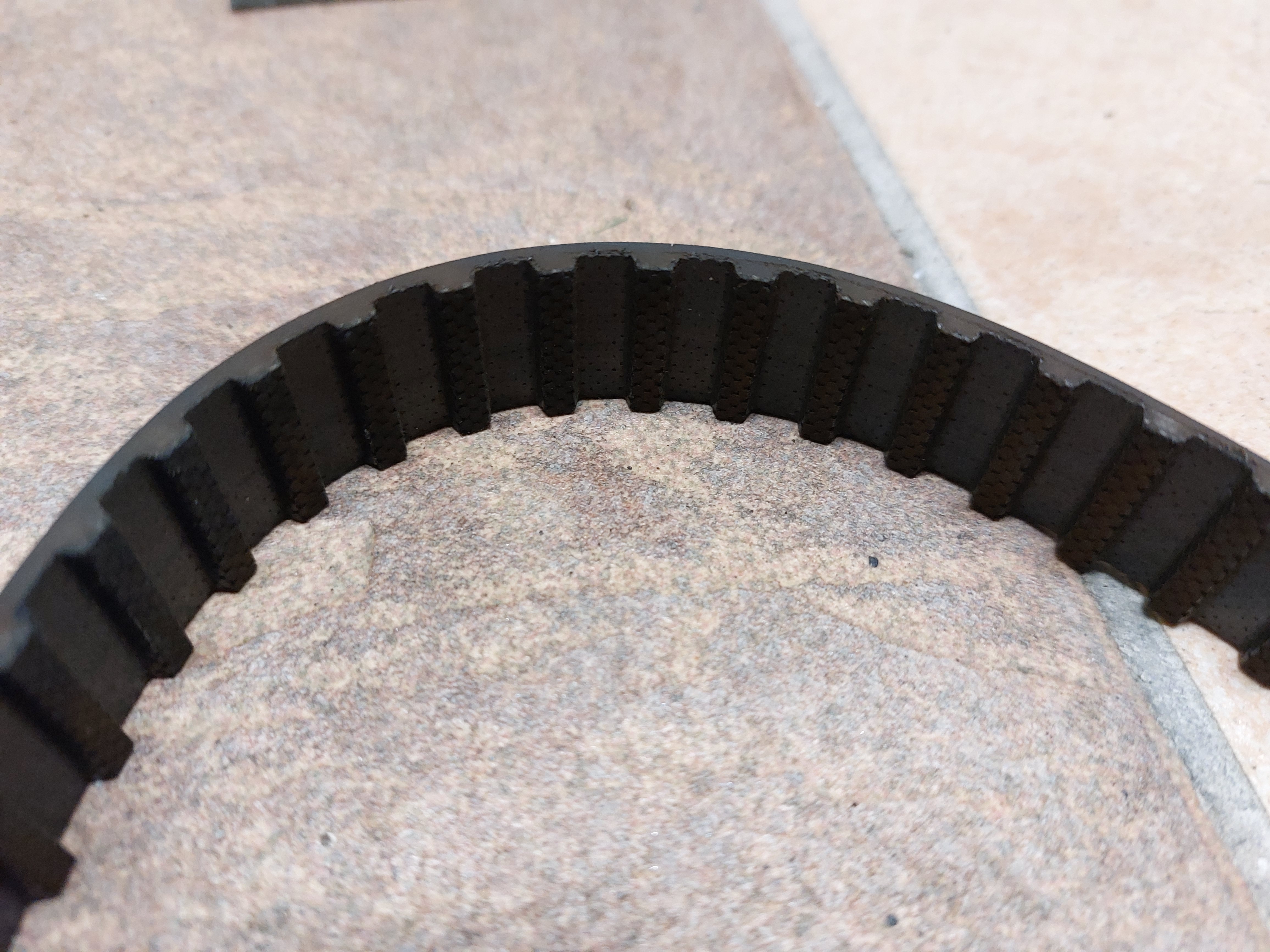

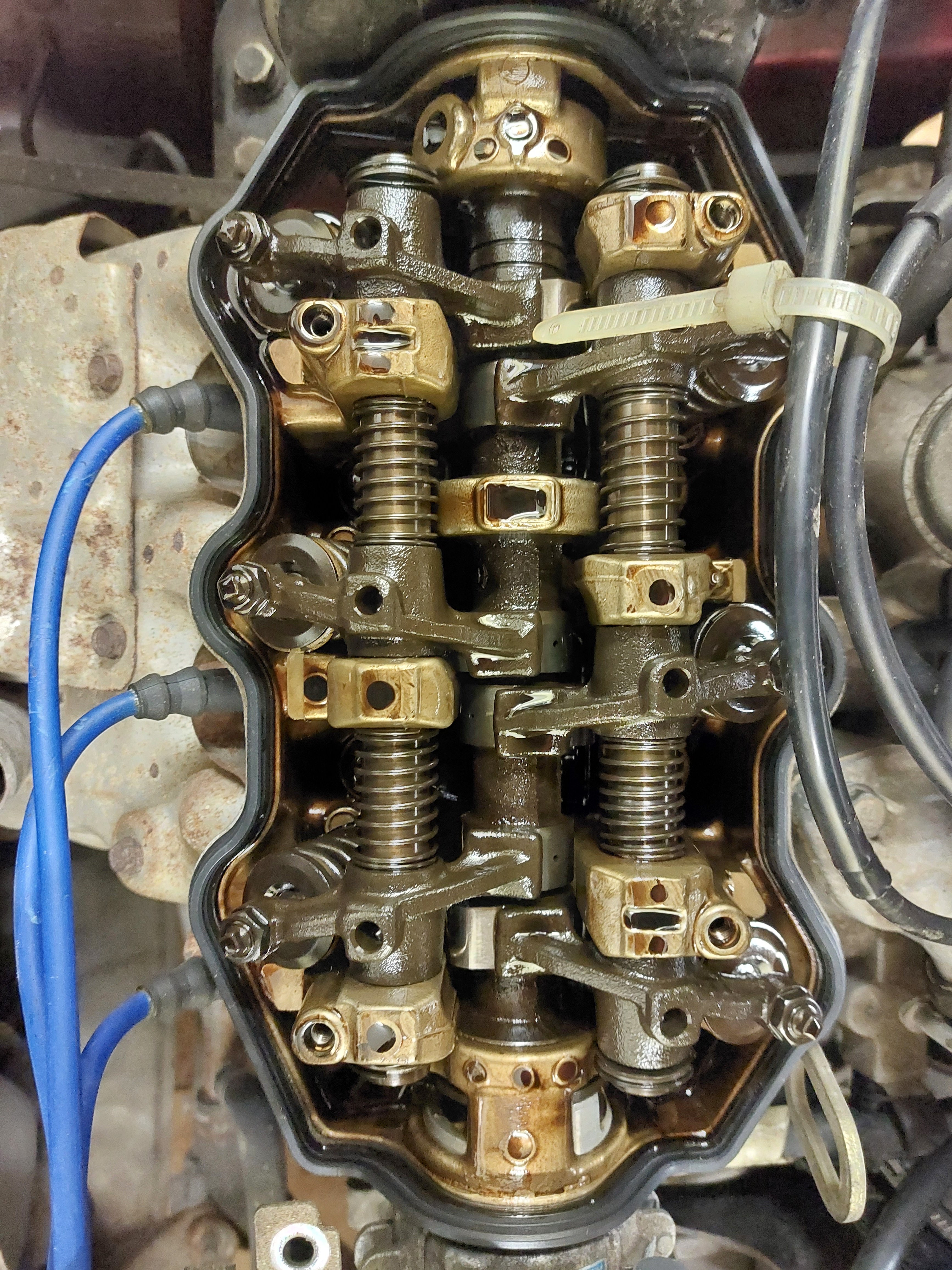

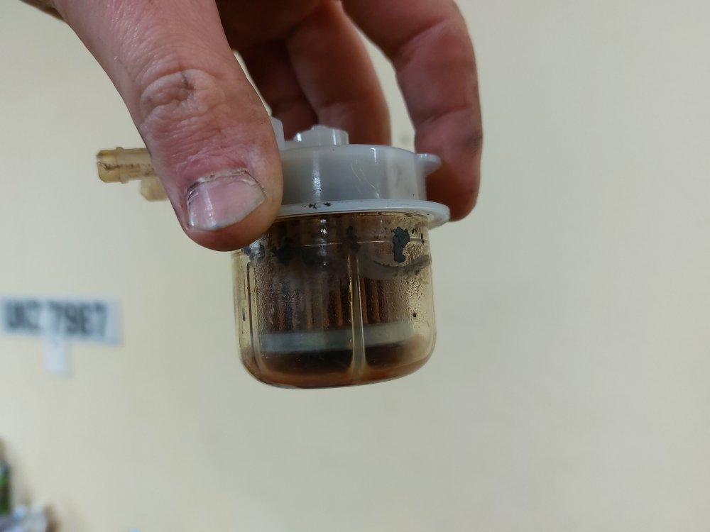

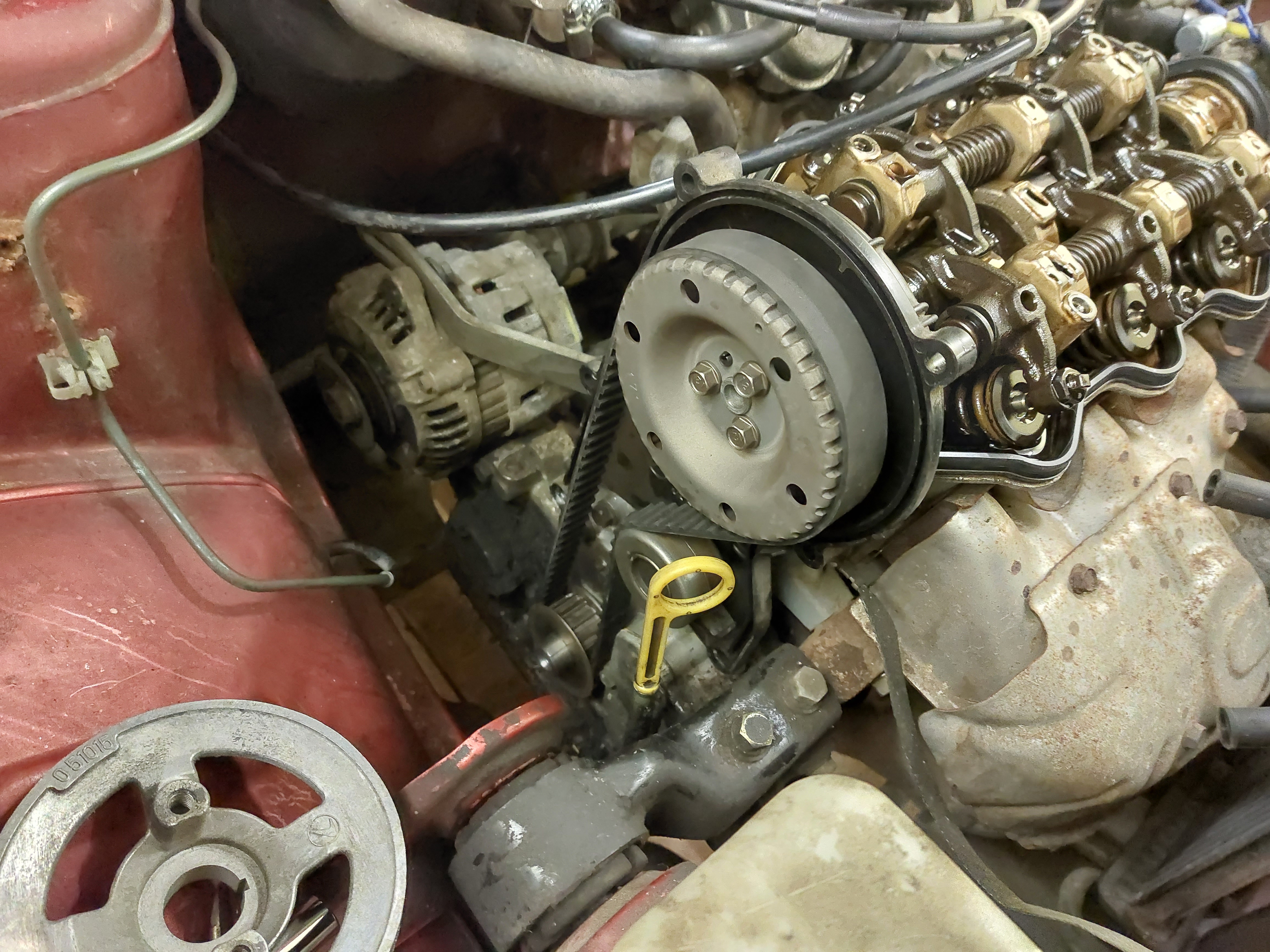

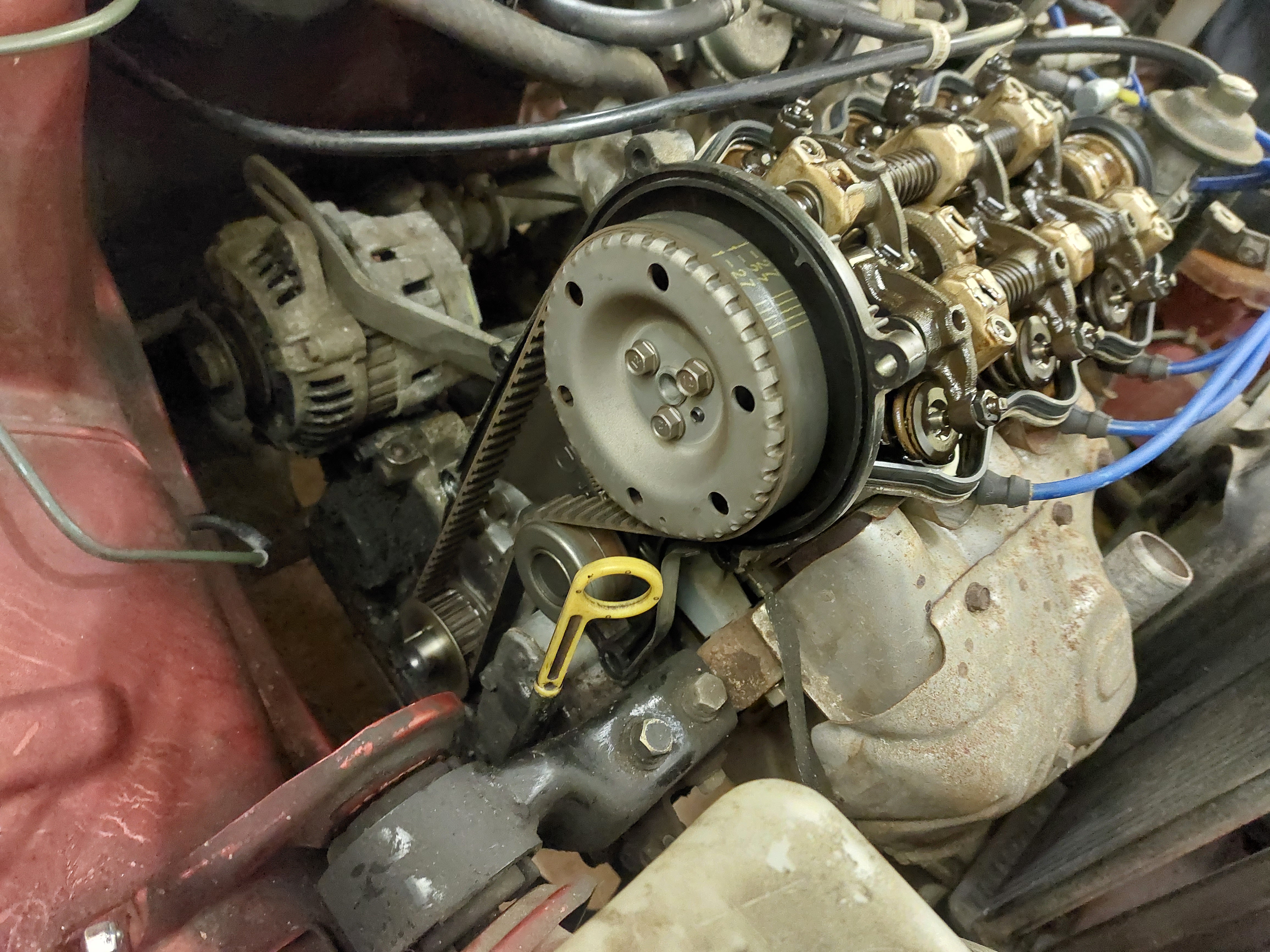

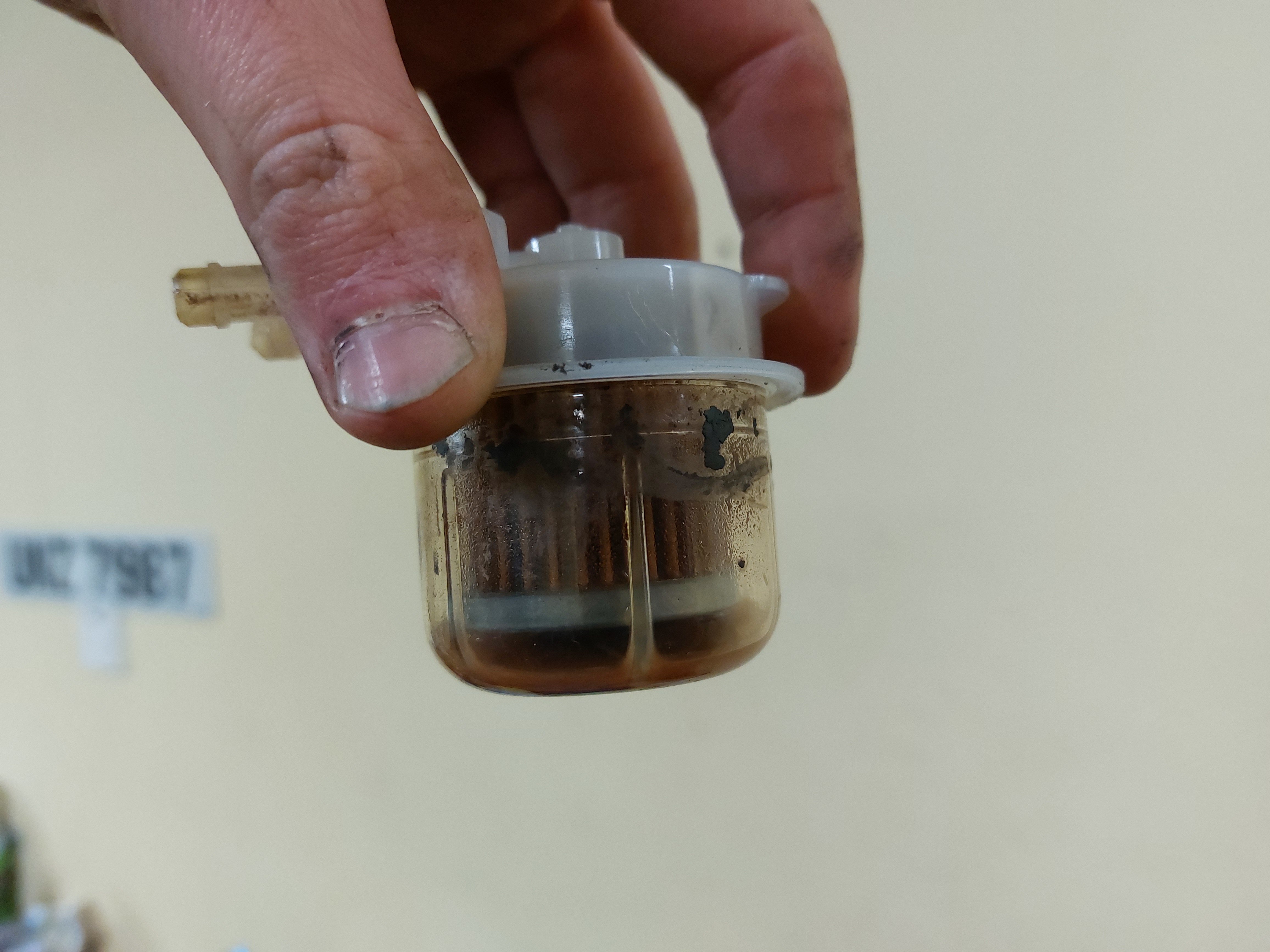

Carburetors still being a ****. If its not filling with crap from the tank its the cork gasket not wanting to seat. On the brightside though I finally have a logbook in my name for it. Anyway. Set about checking the valve lash so popped the valve cover off. Turns out it's the 1.2l Justys that are 3 valve. Even though its the same Engine ""prefix"" for the 2, the 1l is 2 valve. For some reason. All of them were set exactly to the specs shown on the bonnet, so I left them be. Then I started on the timing belt. I took off the alternator belt. Obviously well past due, have a new Meyle one for it. There's an access port you can get to by removing a plug in the drivers side wheel well. Didn't bother removing the wheel, locked it hard and that gave me plenty of access. Pic of the old subaru belt on it. Looked okay. Didn't look like it was going to fail any time soon anyway. Old Belt vs the new Gates one. Didn't bother replacing the idler pulley as it was fine. Really not in bad shape for how long it must have been on there. New Belt on. And done. Only took about an hour. Didn't start it as the top of the carb is off again. One last thing is I was gifted a Cassette to aux adaptor for this. Bit pointless considering. But proved that the cassette player works flawlessly.
