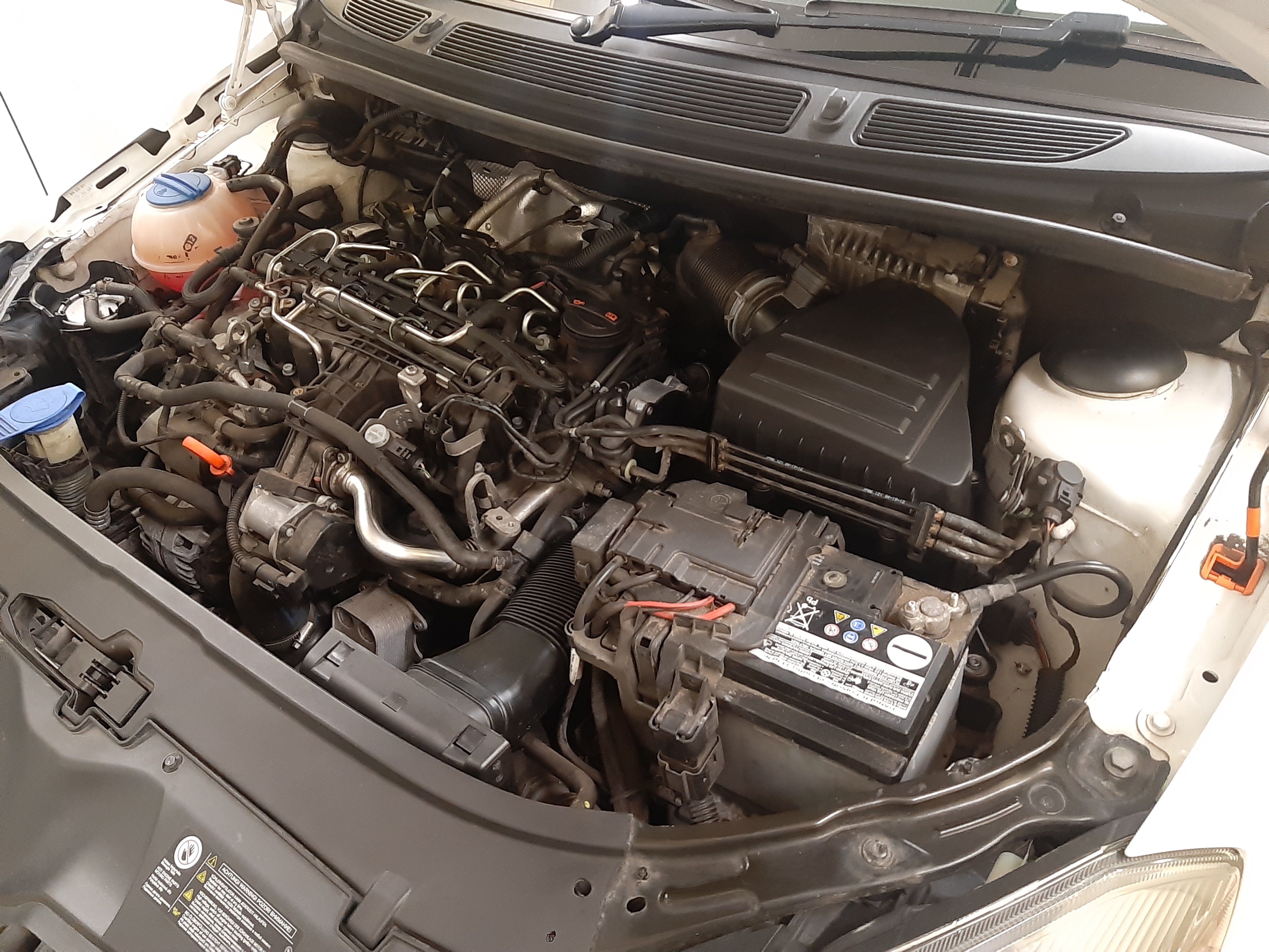

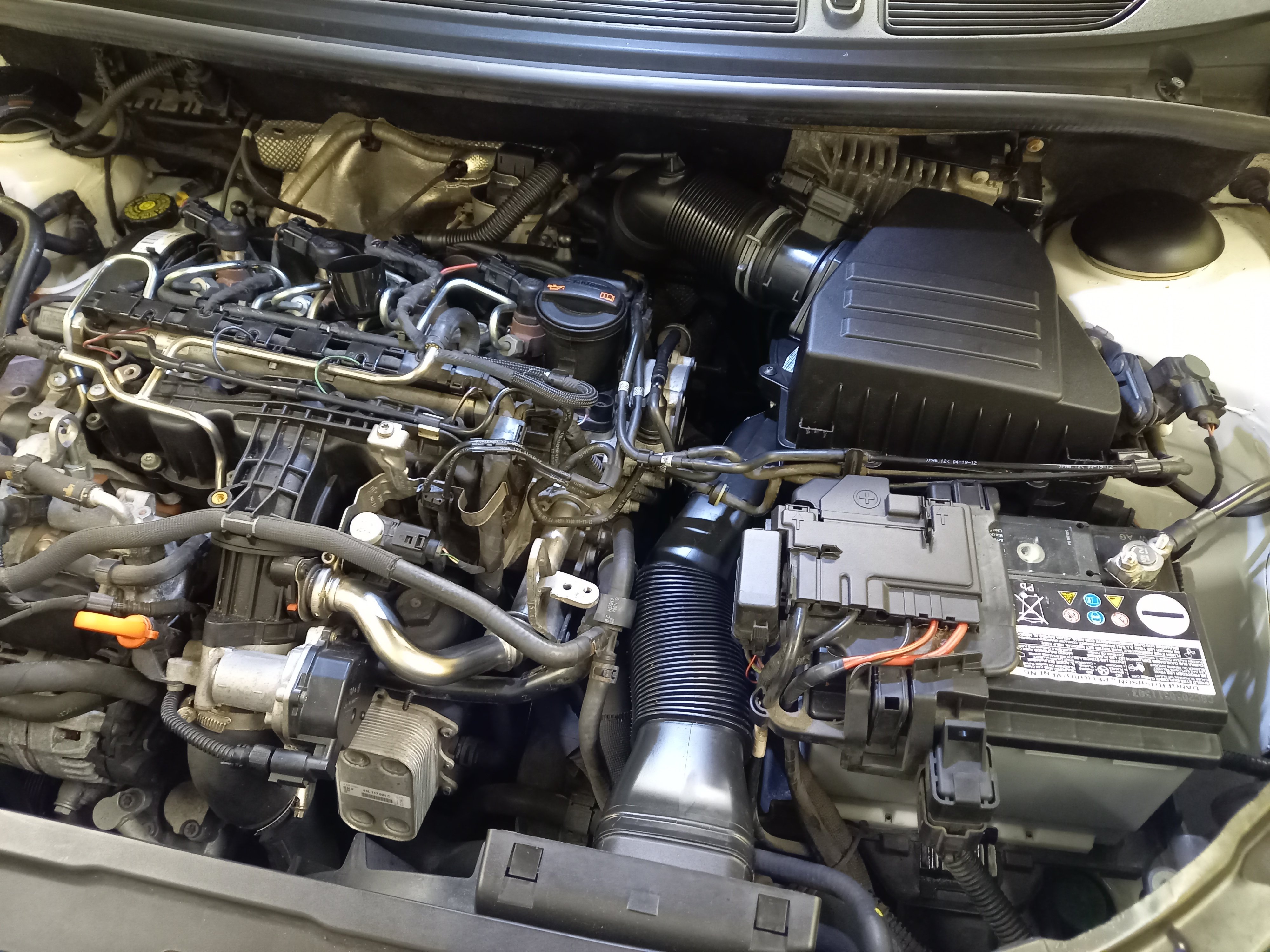

Have done my first few things recently.

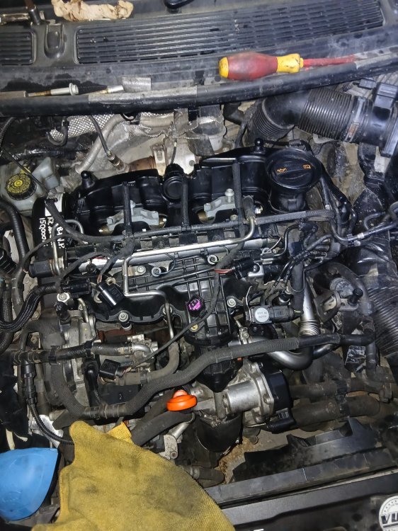

I took off the intake and had a look,when I was in there I removed the Flow transformer that was installed as part of dieselgate. Also, i removed a cotton blanket that was around the air filter, I removed it as I haven't seen any other car of mine use it and figured it was just to dampen noise. I put the intake back together and went for a spin. Happily,it seems as though my efforts had produced some results, the engine feels a little more responsive and I can actually hear the turbo now. I have put money aside for mods but that might have to go towards figuring out the problem thats creeped up with the seatbelts. Essentially,the wont unreel from the mechanism. While it is not completely unusable it would fail its test so i'm as well to sort it now.

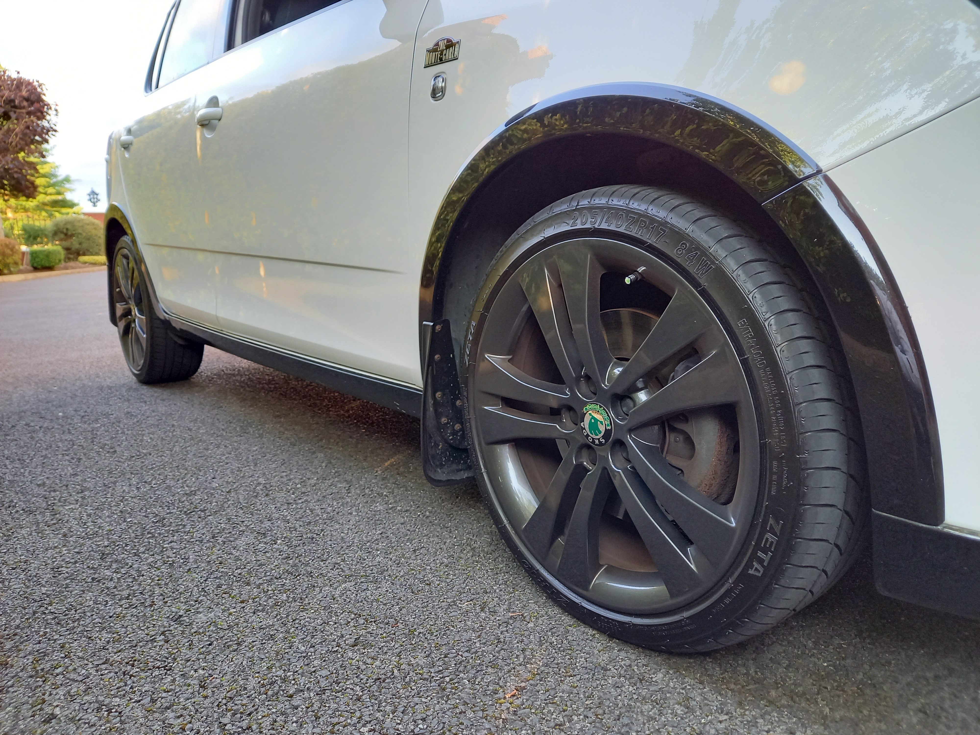

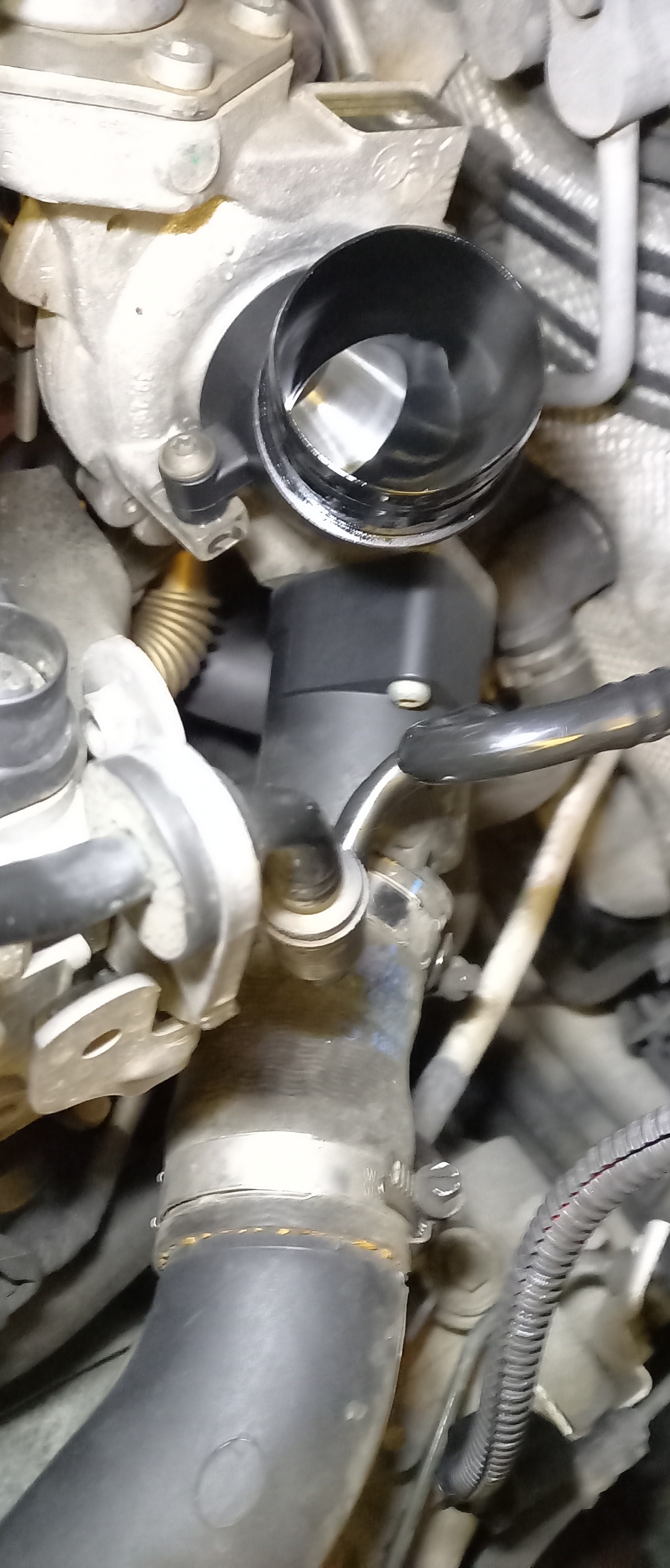

Done some good work on the monte carlo as of late. Installed a a set of mudguards, painted the rear drums,Removed the intake flap and installed vrs intake piping. Not a bad week. It would appear that most of the exhaust from the downpipe back is rotten so I probably should get a new one in time for the cars nct in august.
It would appear that I cant upload photos more than .08 mb so I cant get a compressed enough photo to upload.
Shame.

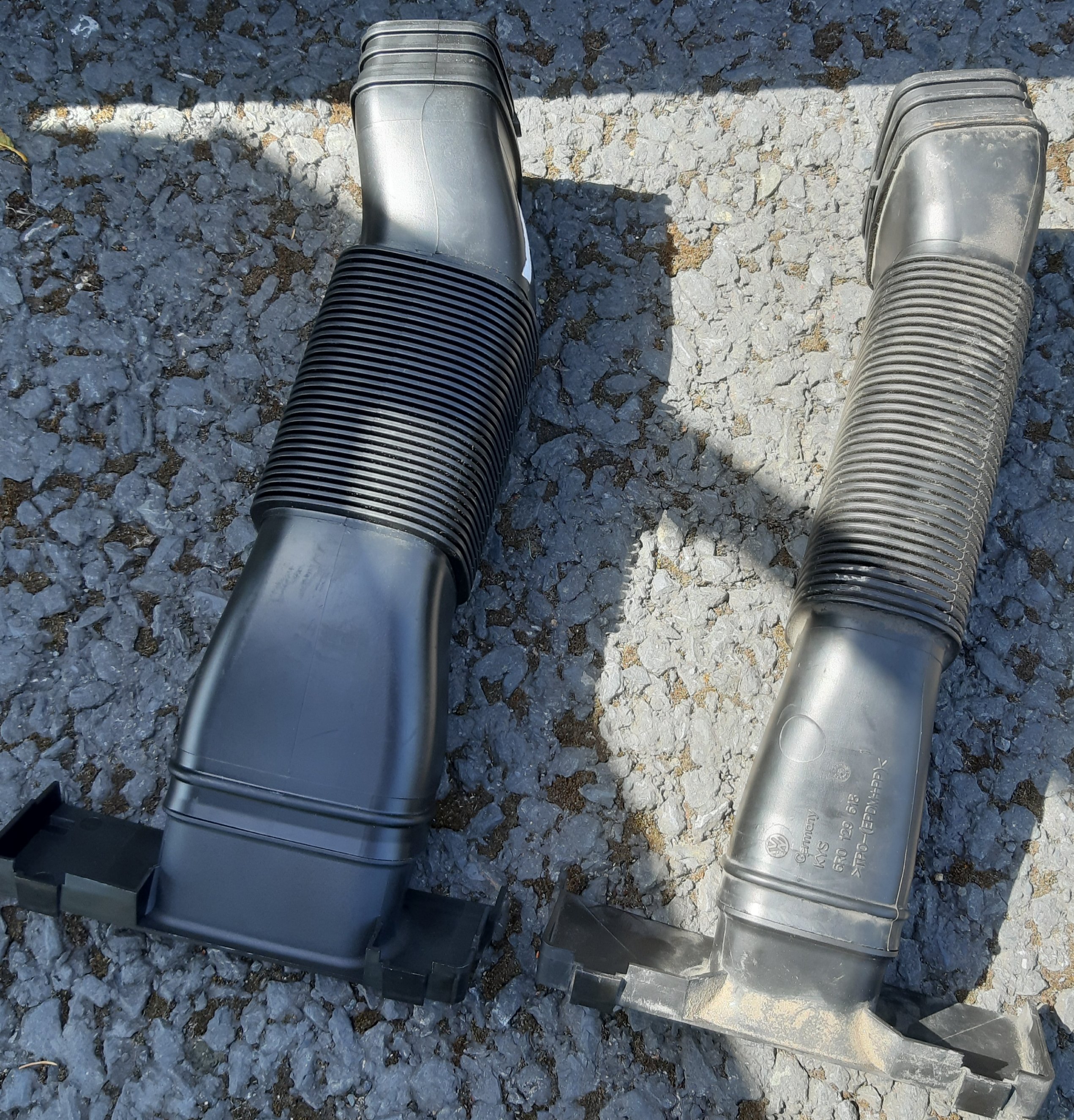

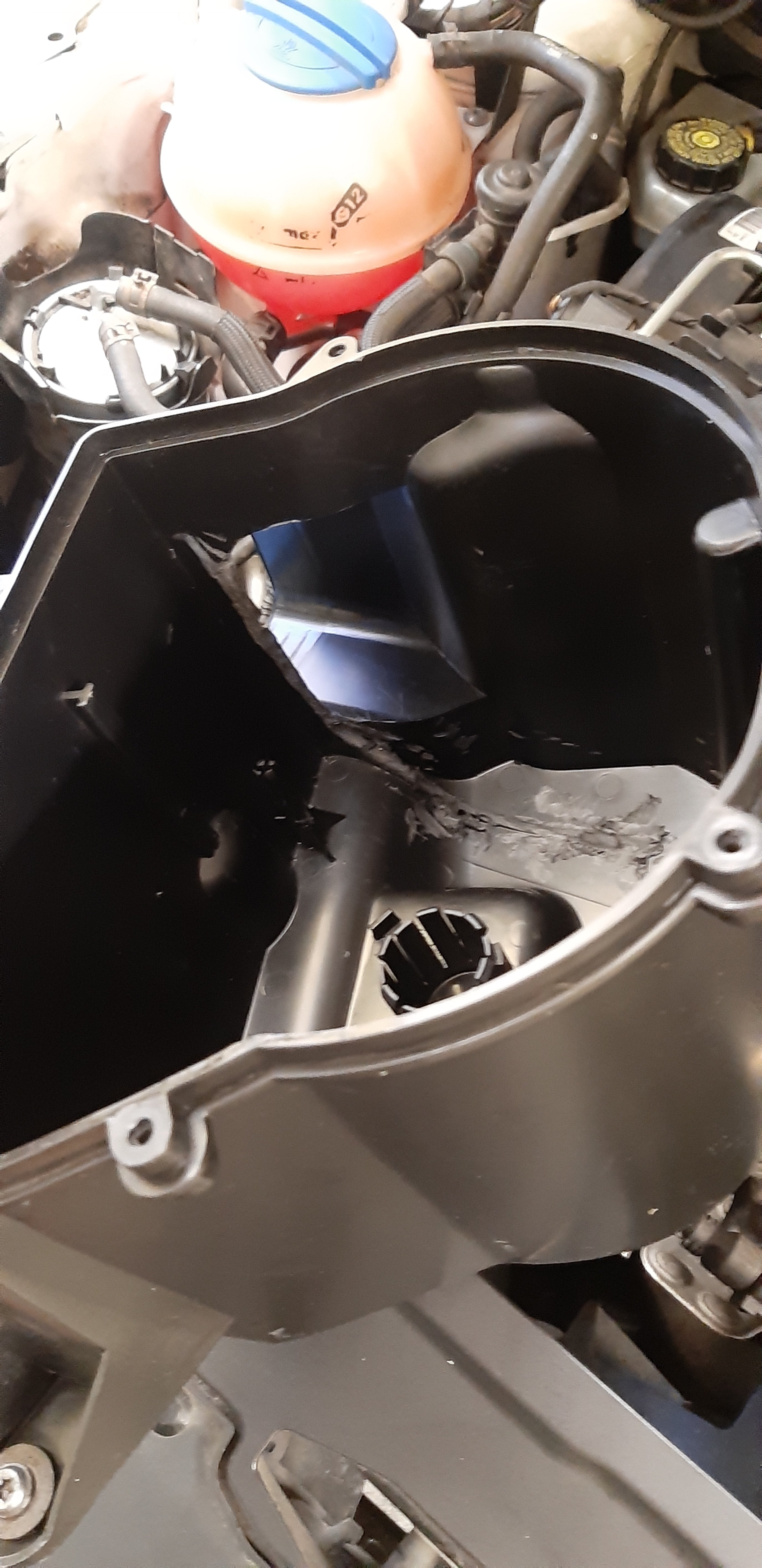

Pic of the sheer difference in size from a standard intake and a vrs one. Was trying to reuse the old intake on my sdi and found that the part that mounts to the airbox is too big on the 1.6 to fit the sdi airbox. Even then,the hole for the piece that goes on the other end of the airbox is the same diameter so It wouldn't make any difference anyway.
I found that while the Vrs one does fit it needs a bit of fettling to get to sit flush.
(I know the pictures shows them in the wrong configuration but This was just a quick side by side before I properly installed the vrs bits. Also have a picture of the flap removal, it came out a lot better after smoothing out some rough edges after the photo was taken.

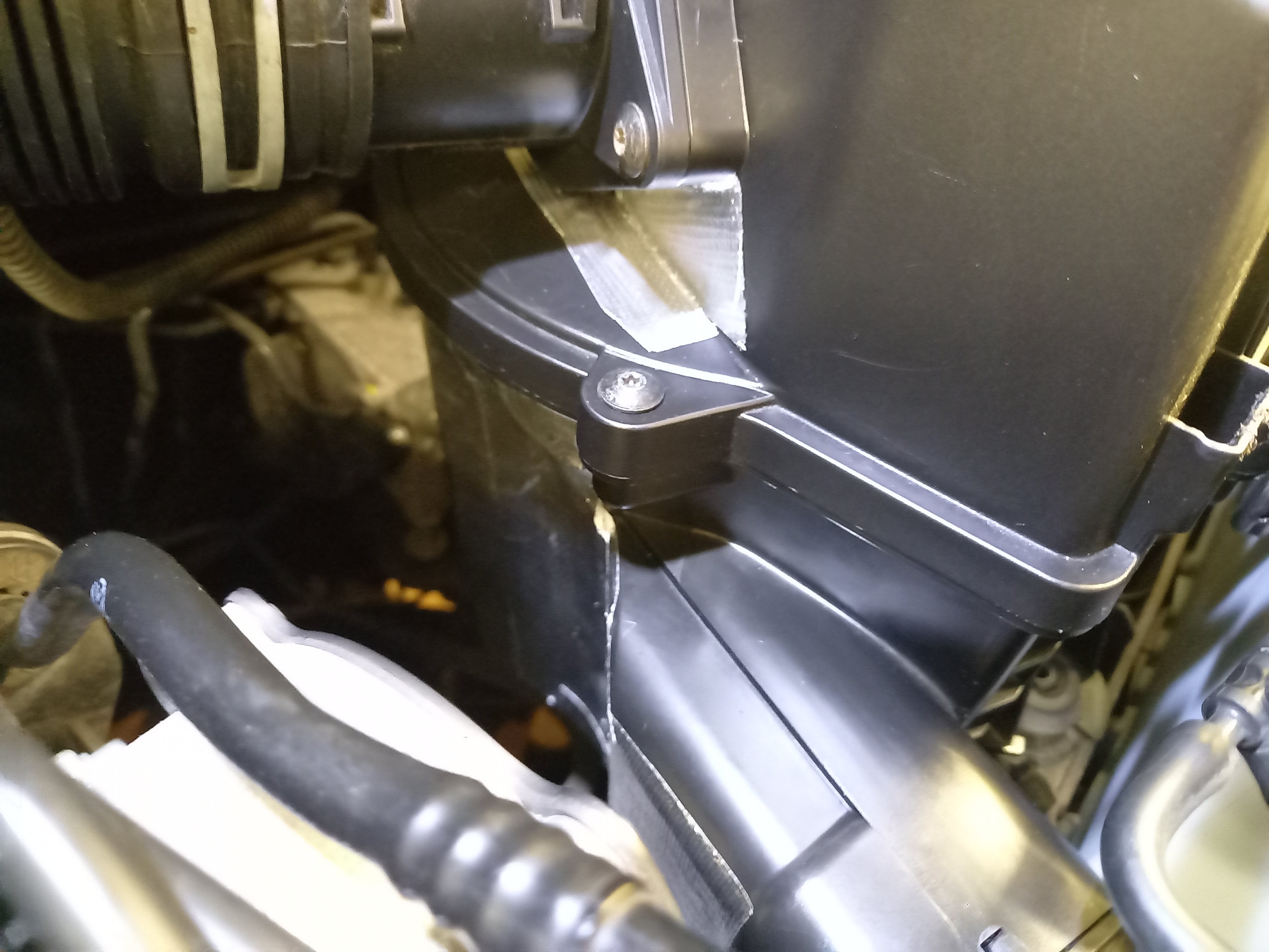

Spent the evening getting the intake piping looking 100% factory. I took it all out and ended up putting a black screw either end of  the front of the pipe where it meets the plastic dirt deflector and put a black screw under the part that joins to the airbox. Also modified the part the dirt deflector clips into so it would hopefully feed more air. After that I took of the rest of the piping down to the turbo and checked all. The Turbo is fine with little play,I realise my car only has 89000 miles but I felt while I was there I should check to be sure all was good. The intake piping however was slimey and gunked up with oil from the pcv ( or ccv) I cleaned it all and put It all back together again but I'm strongly thinking of deleting it and just venting to atmosphere for the time being.

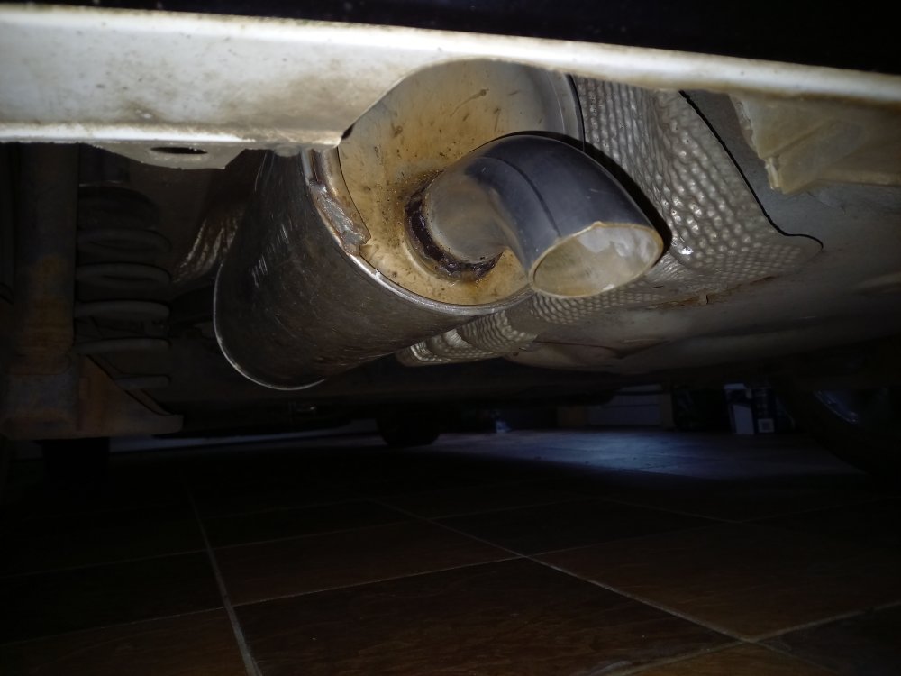

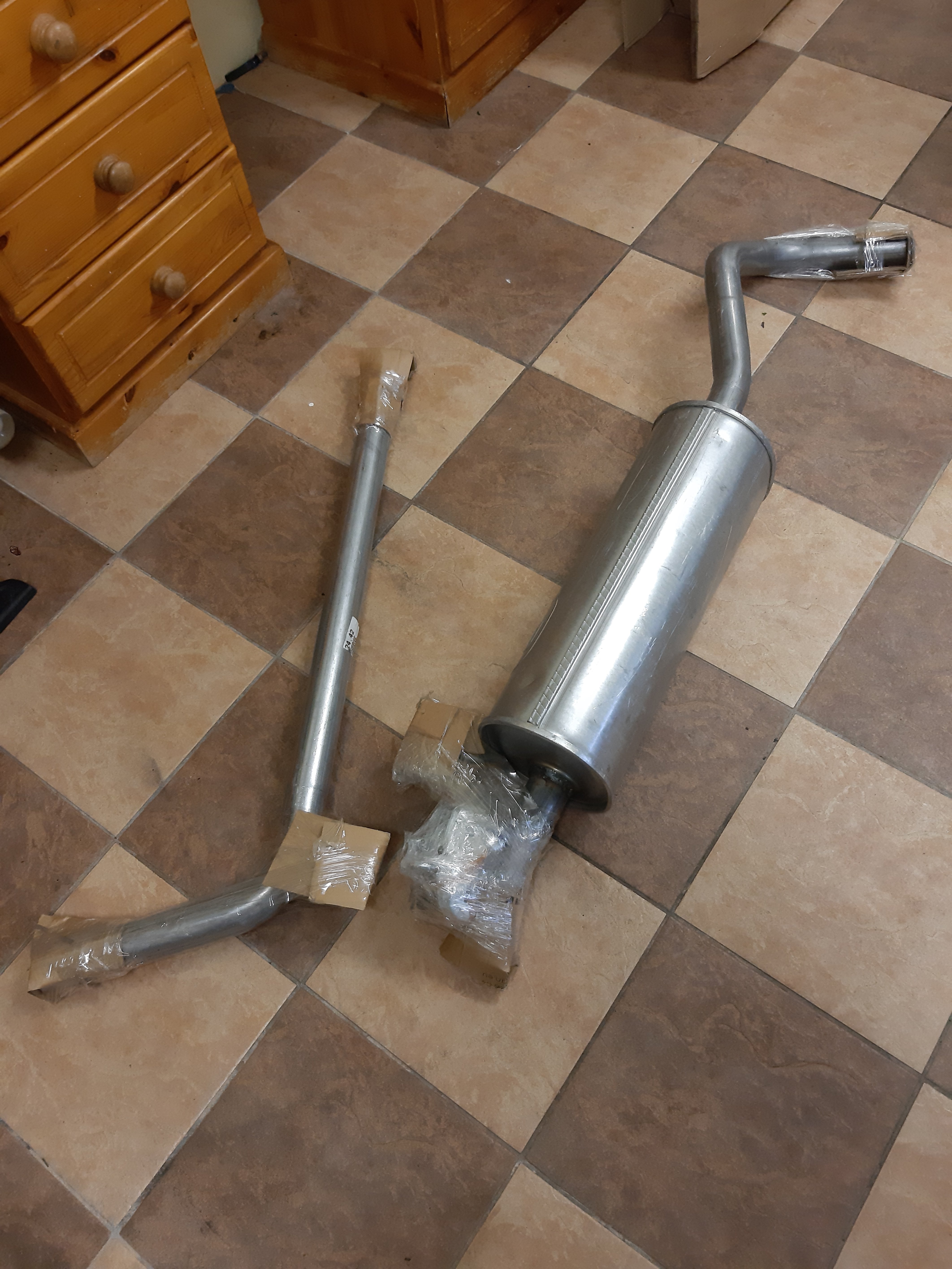

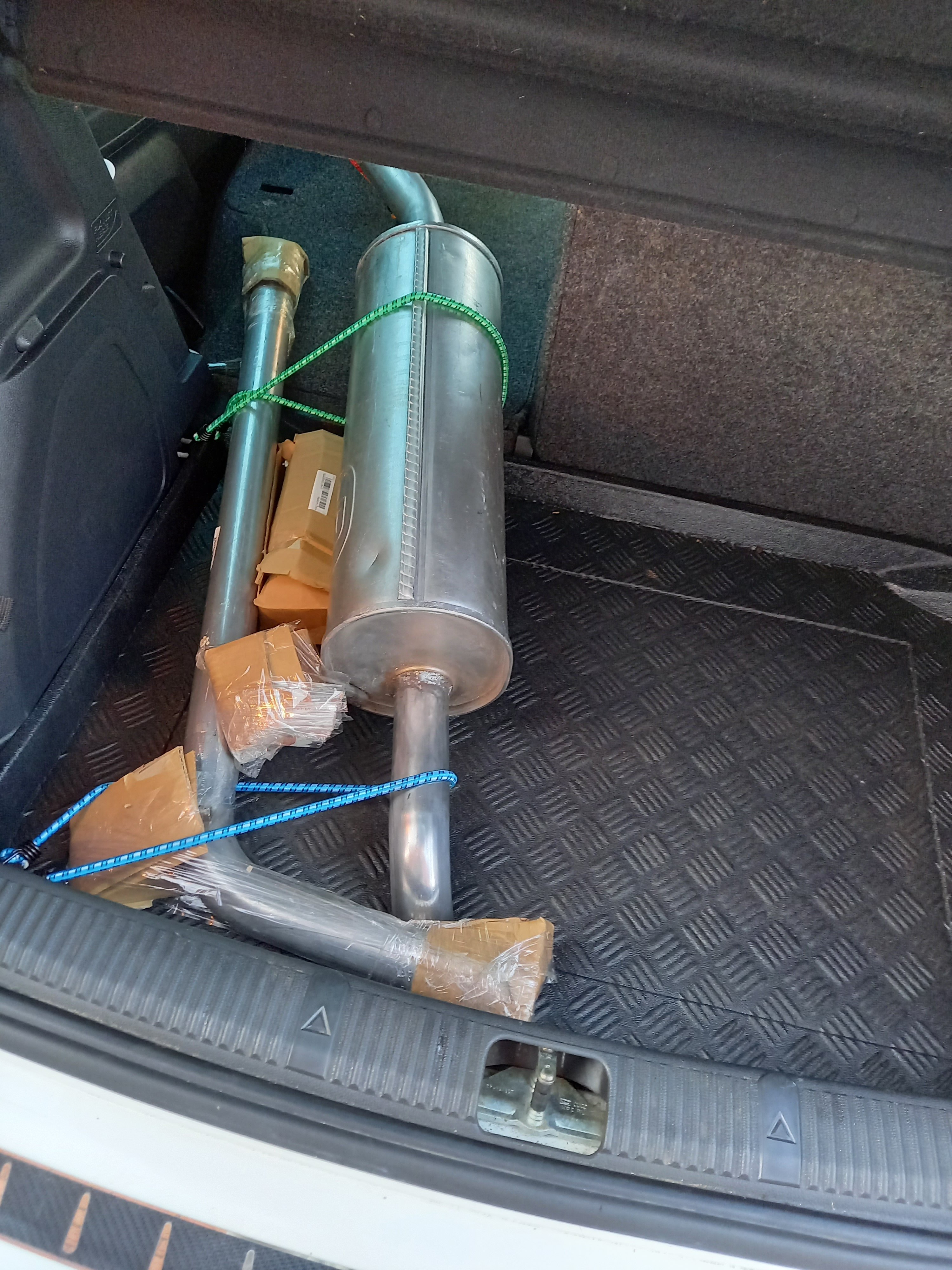

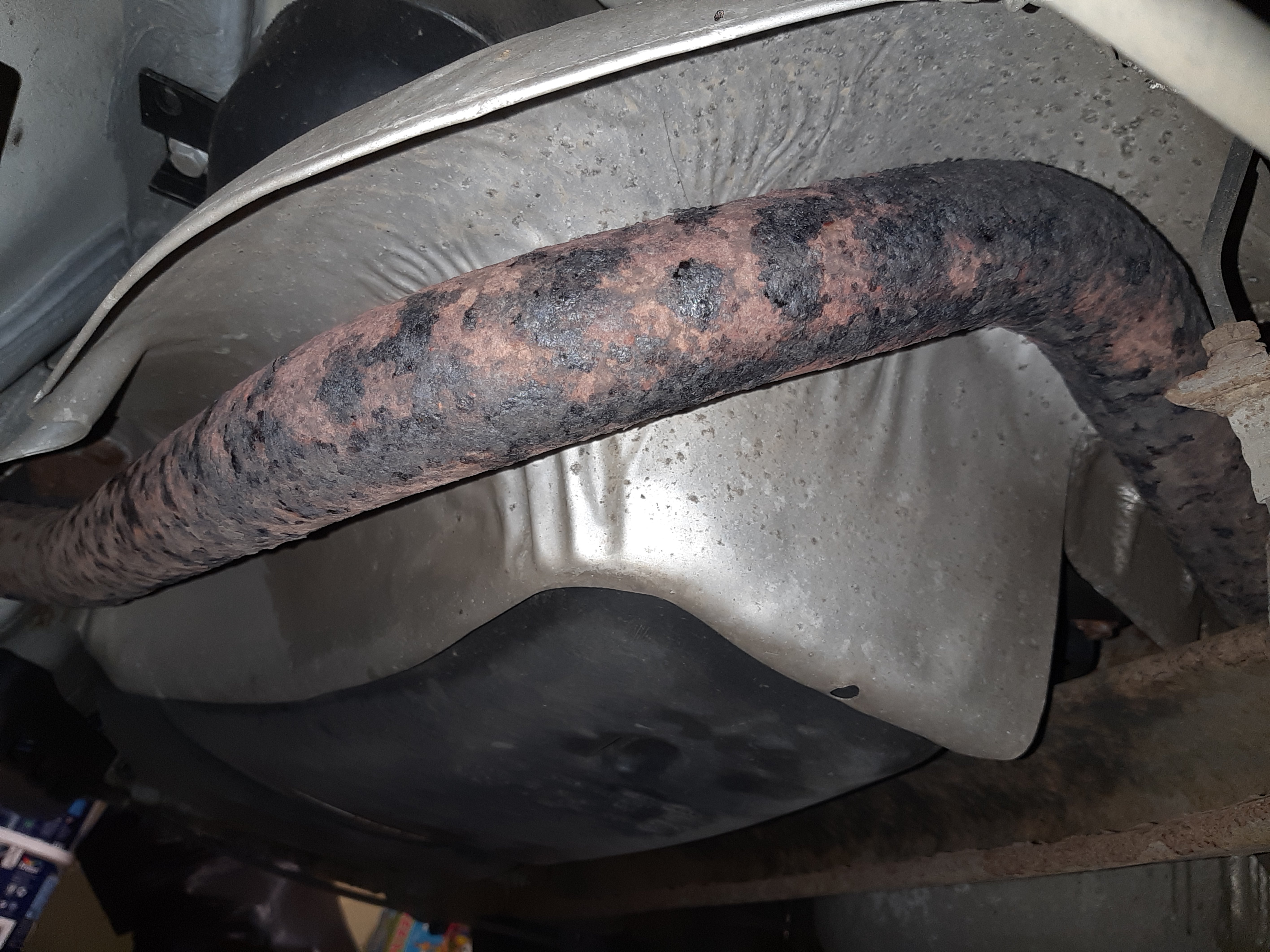

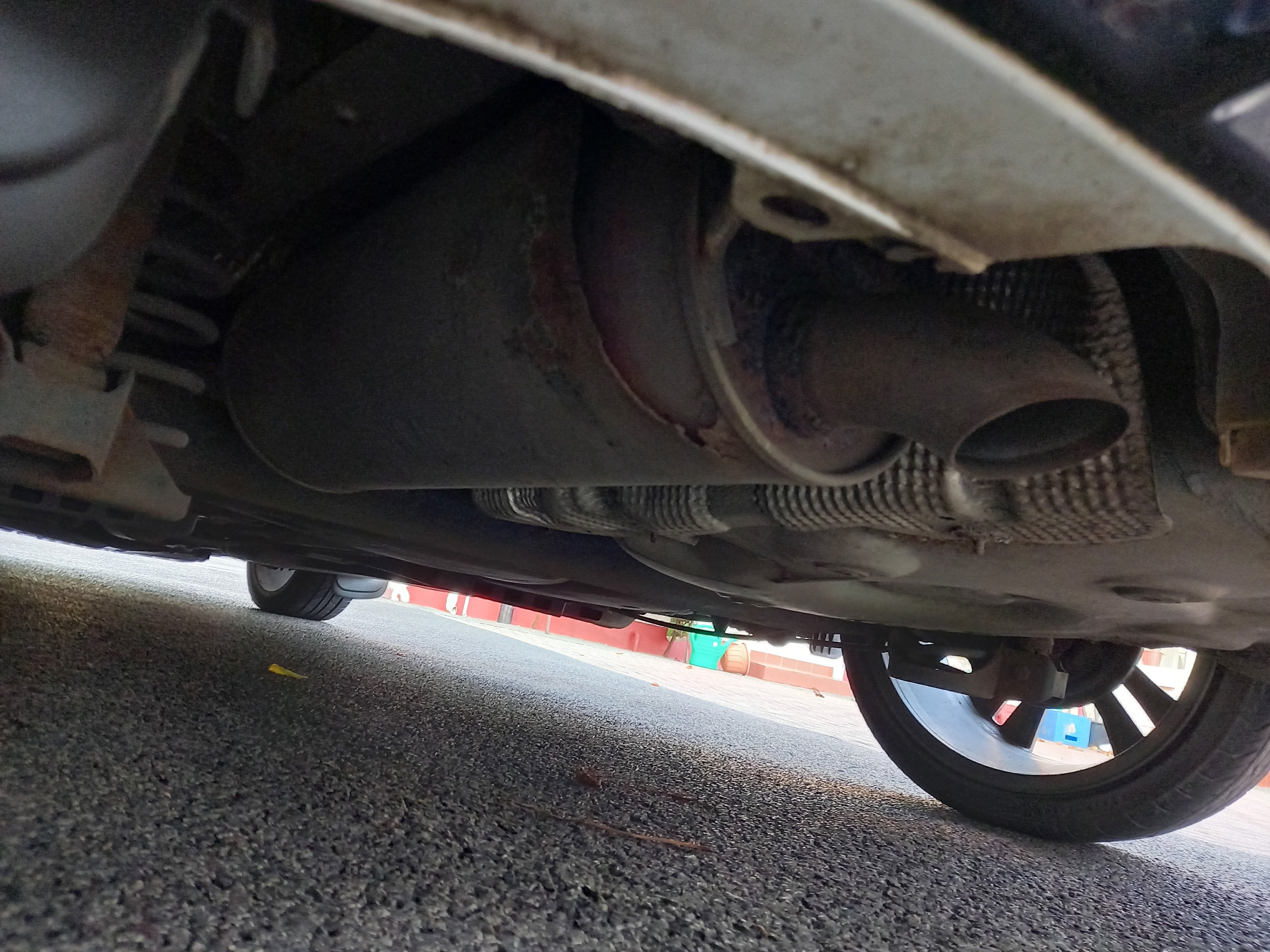

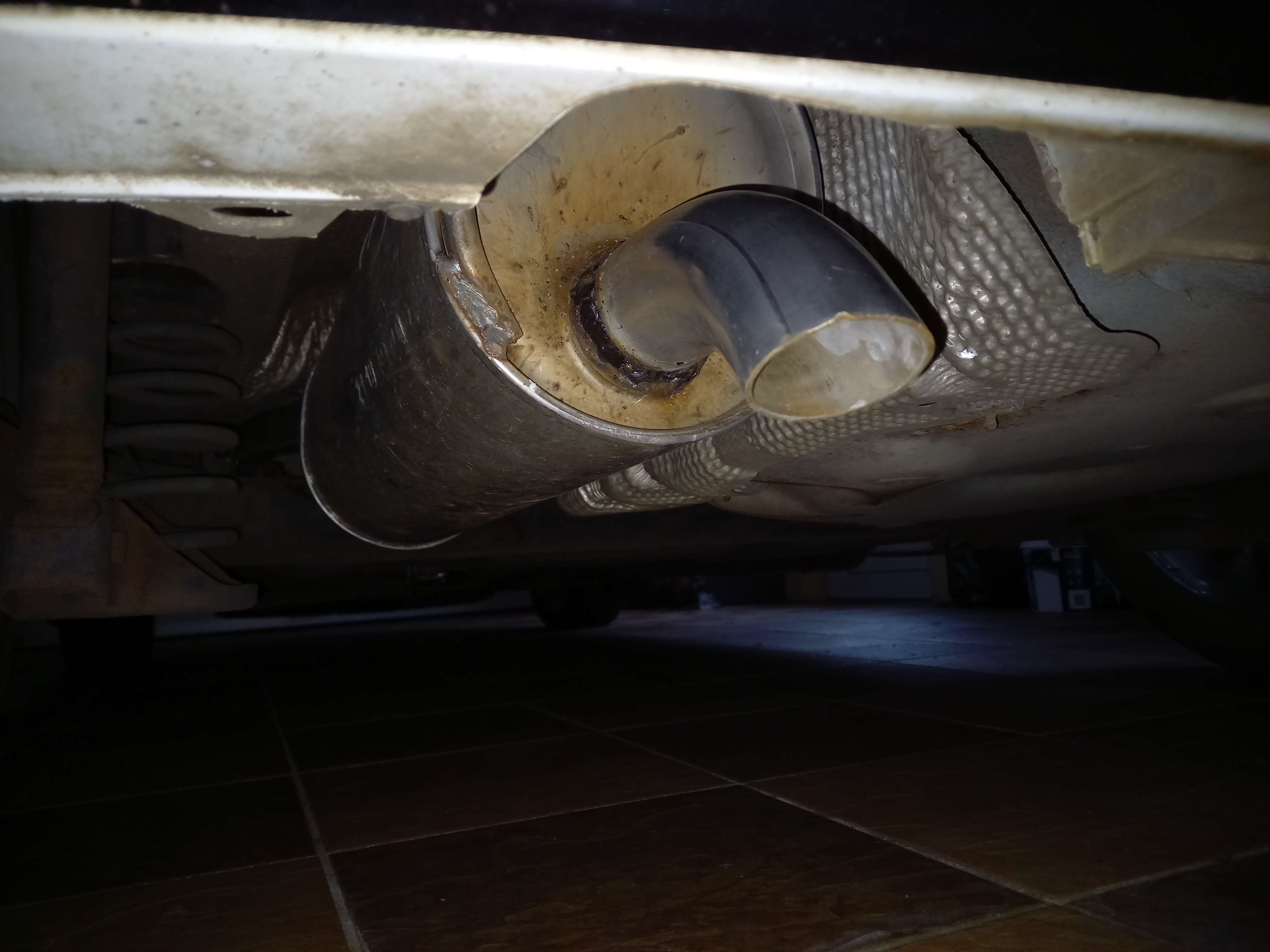

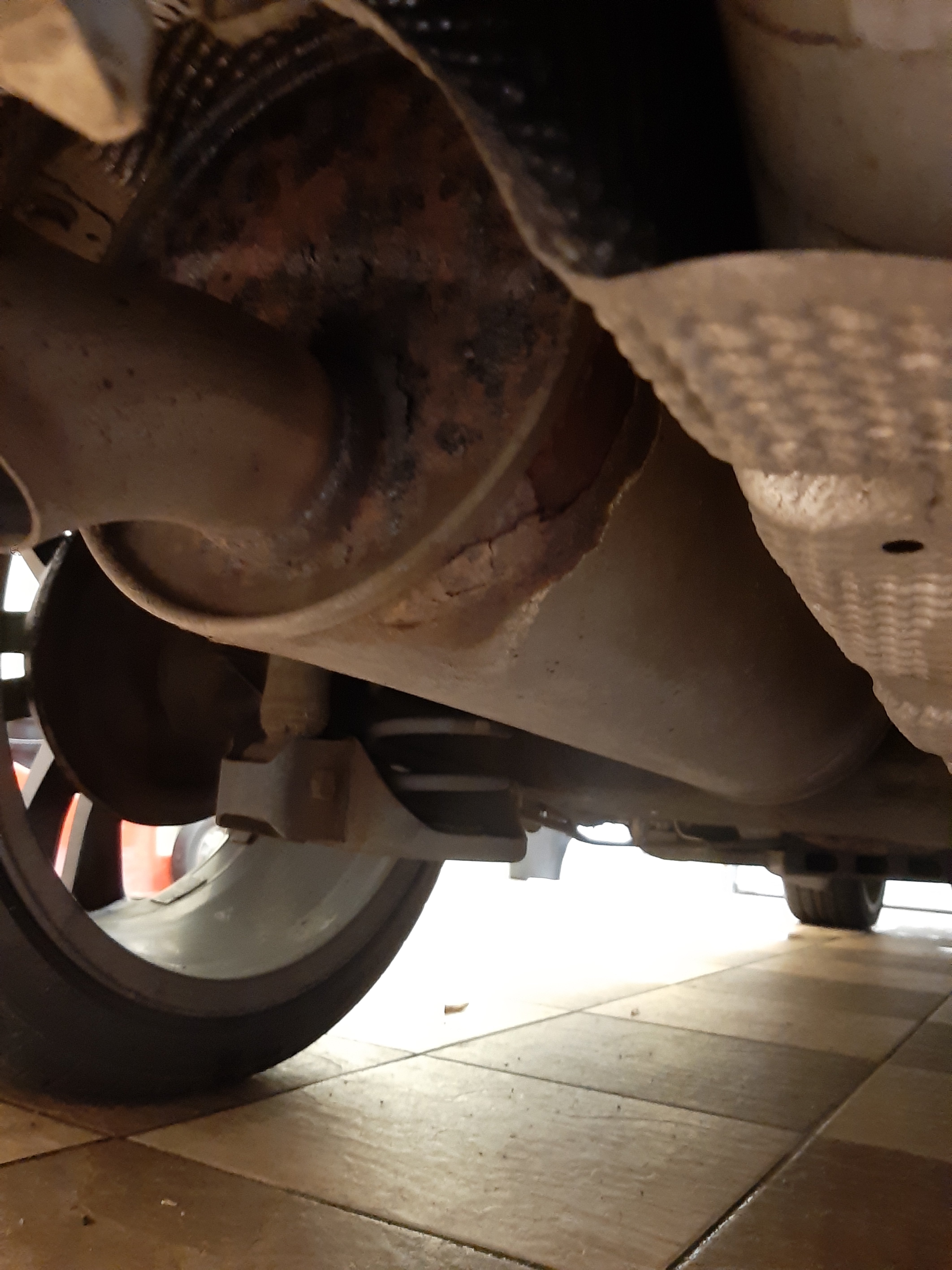

Got a midpipe and backbox off ebay for 80 euro shipped. Its only a replacement for the standard one for now,just to pass its nct come august. After that I'll have 2 years until its next nct so I figure I can mod away once it goes through.
Pics of the new and old exhaust,no way the old one will pass and atleast the new exhaust will clean things up underneath. Plus,it has a 30 month warranty. All things considered, for 80 euro I'm happy with the quality

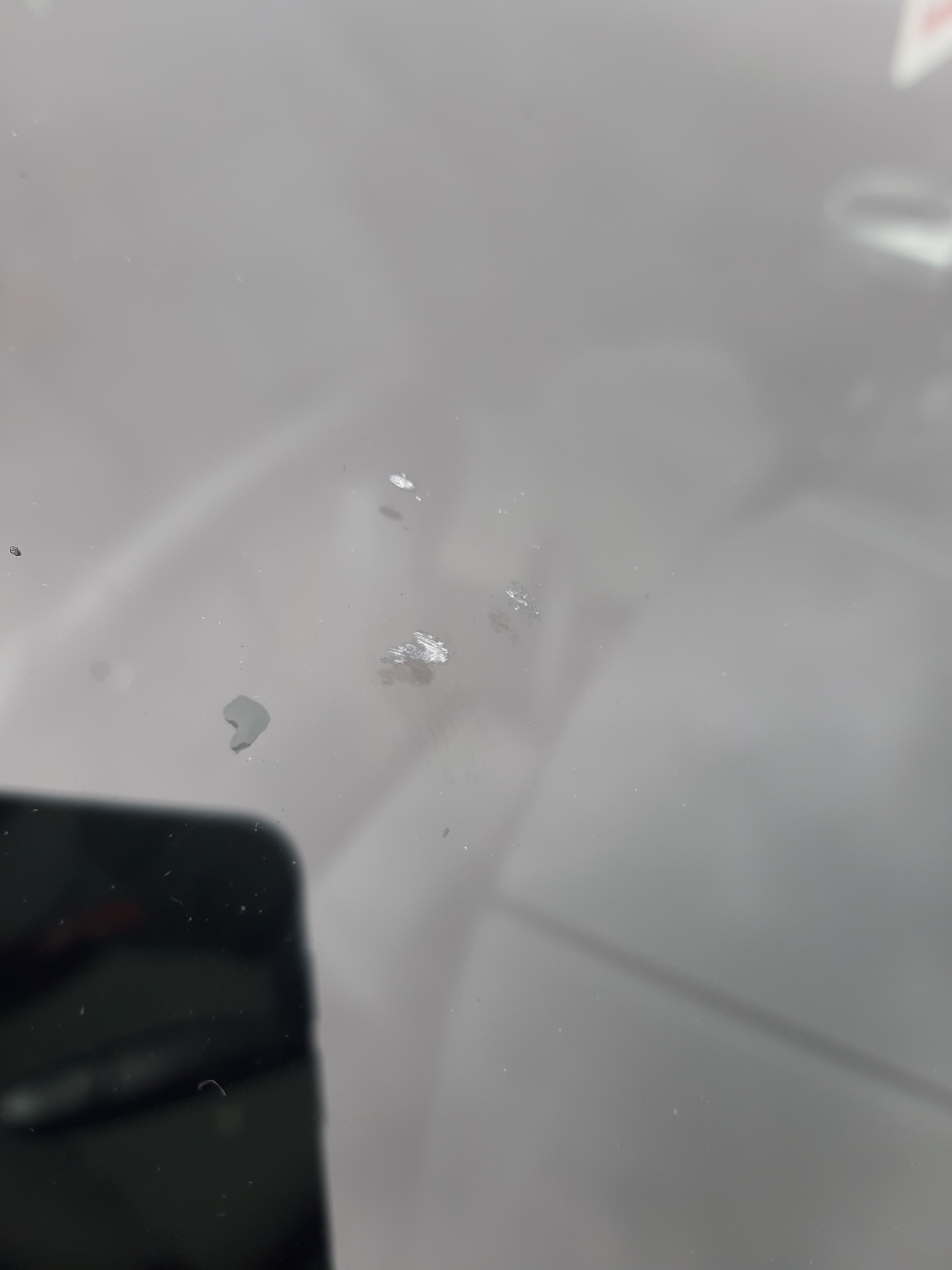

Bit of bad luck today, a truck coming the other way kicked up a chunk of rock at the windscreen. Thought it would go through considering the massive bang it made. Don't know how to go about fixing this. The marks aren't too deep and it almost looks like it could be polished out, or Maybe one of those glass repair kits could work,but the marks aren't actually that deep.
Has anyone got any advice on what I should do?

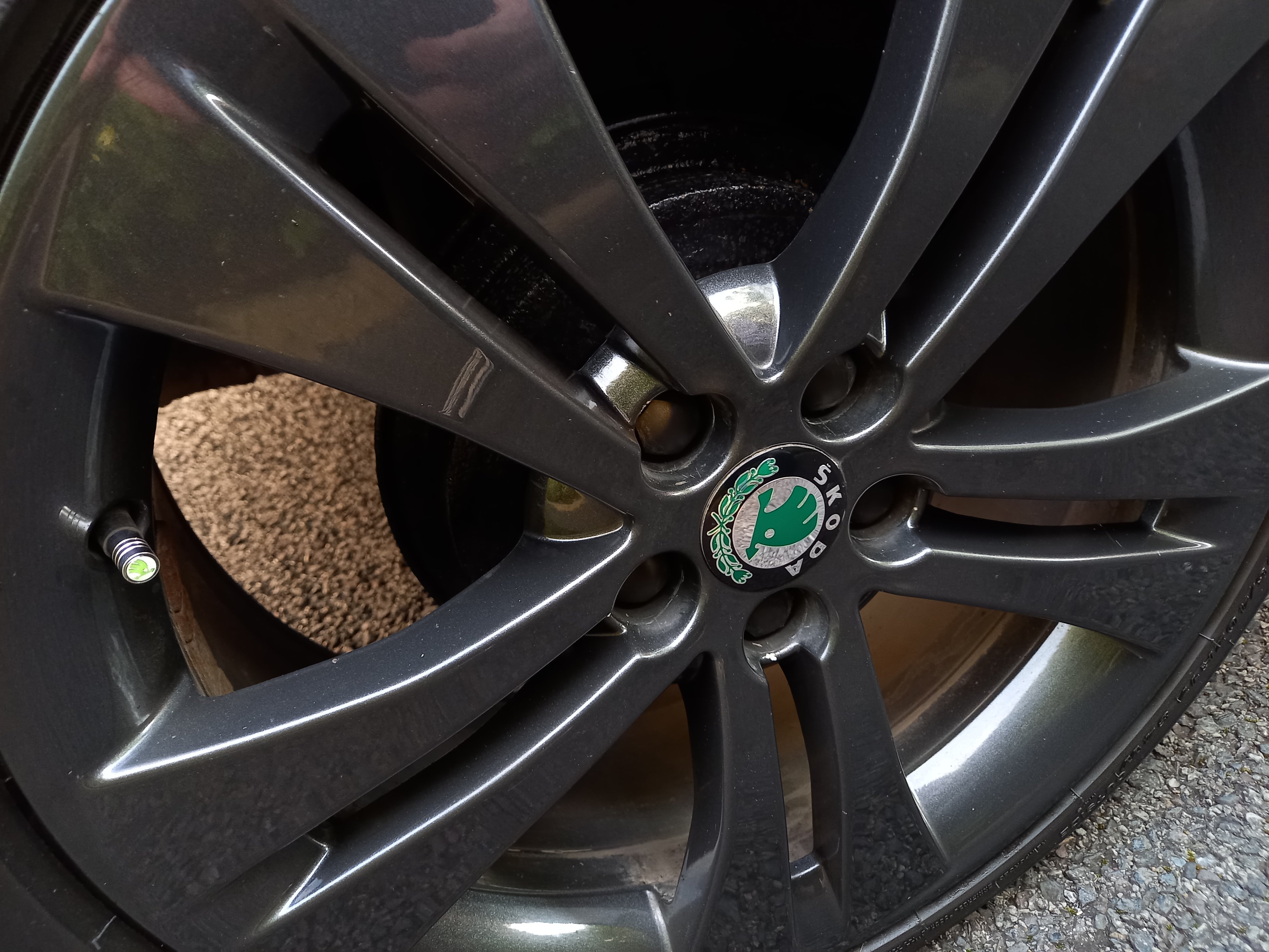

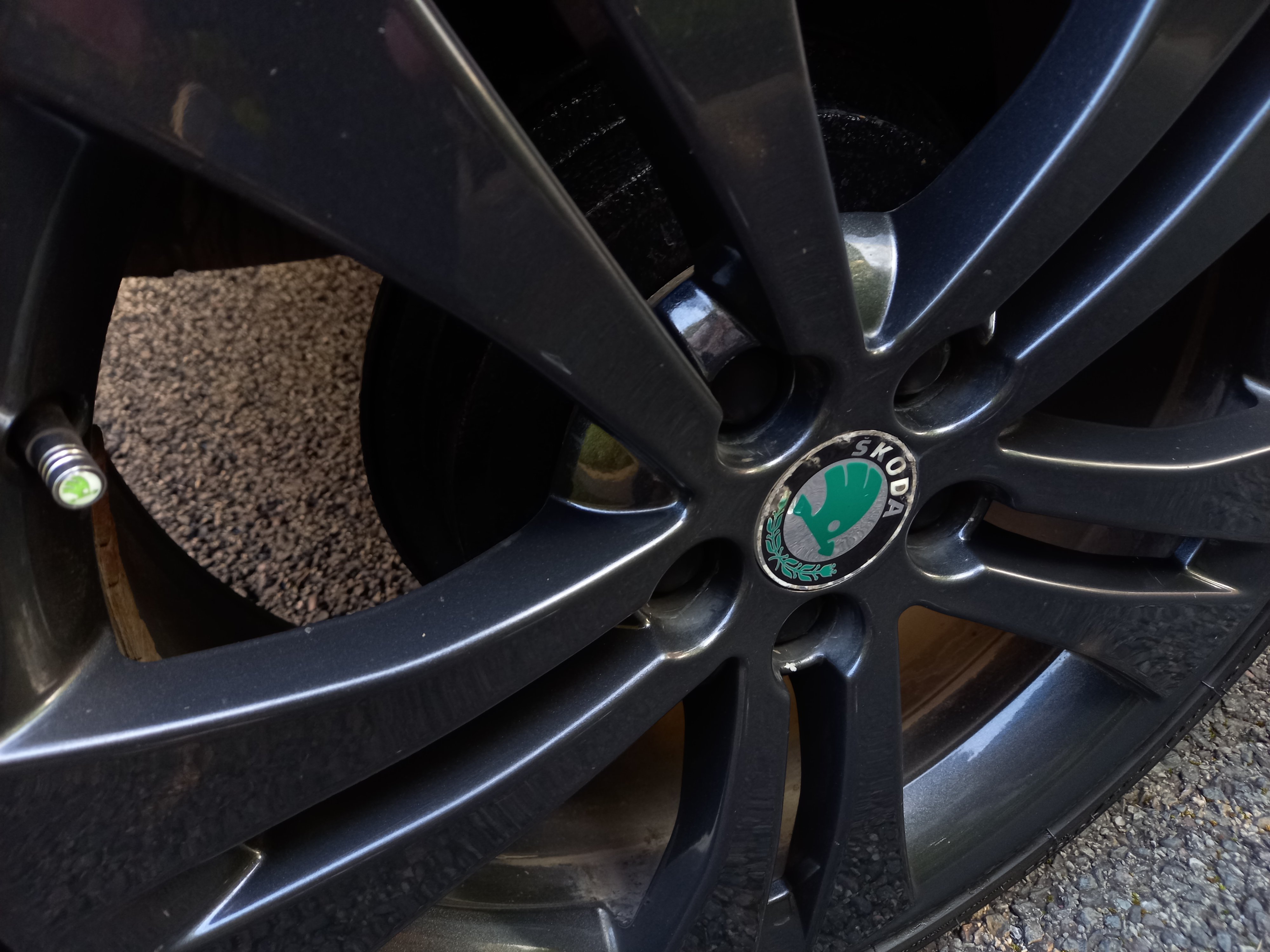

Small update this evening,Got sick of the tatty centre caps on my wheels so I got some stick on ones and put them on.
Tried my best to align them with the valve cap and top lug bolt.

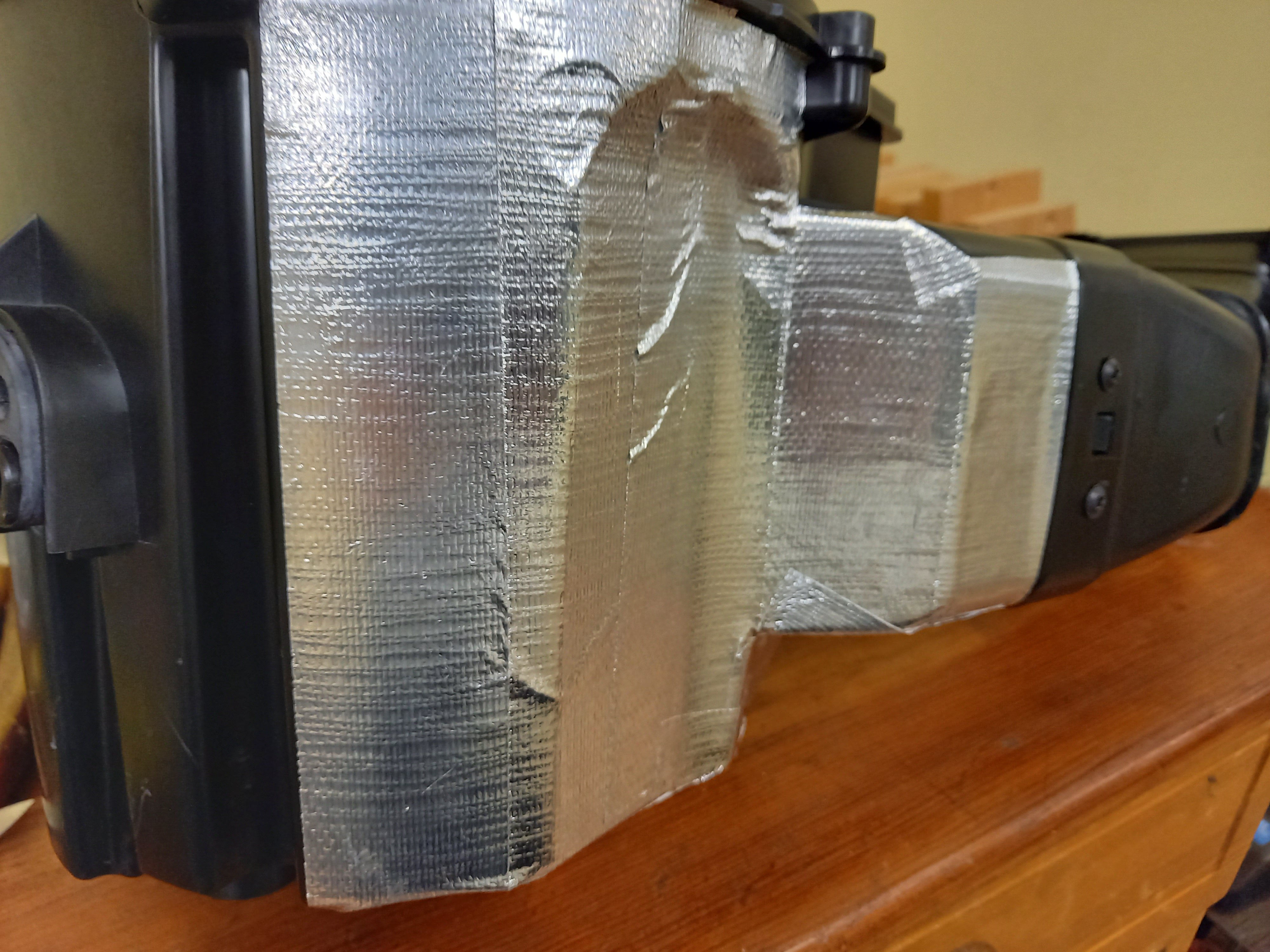

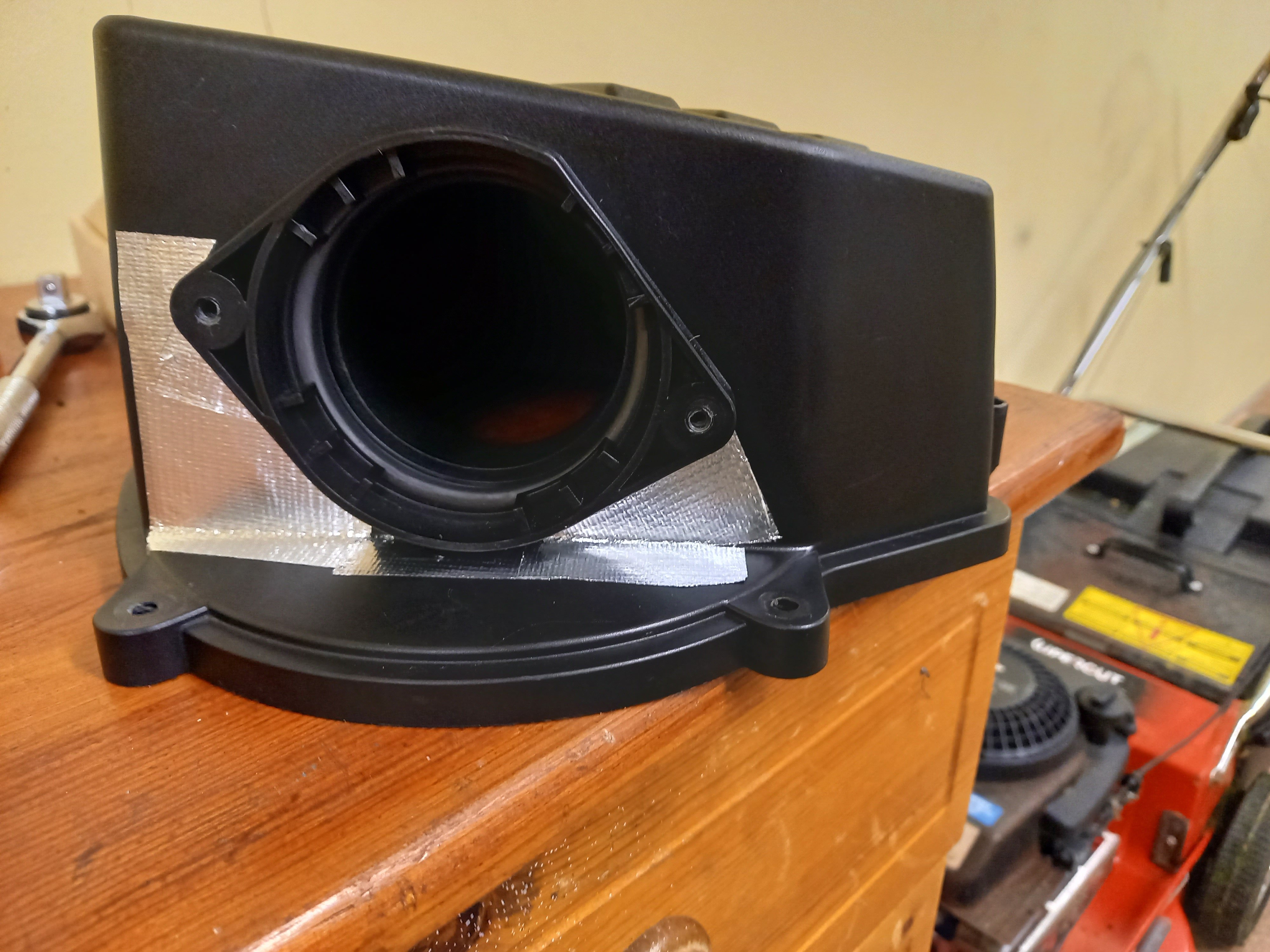

Also took the time this evening to Put some generic heat reflective tape on the side of the airbox nearest the turbo. I want to keep the car looking near standard so I just used silver heat reflective tape instead of gold.Not bad for an hours work,but I doubt it will make any significant difference. Also,continuing on the "near standard" approach. You can see that my Vrs intake is mounted with just a few black screws on either end of the portion near the bumper and two screws into the side of the airbox,aswell as one in the bottom of the airbox to keep it firmly in place and looking standard.

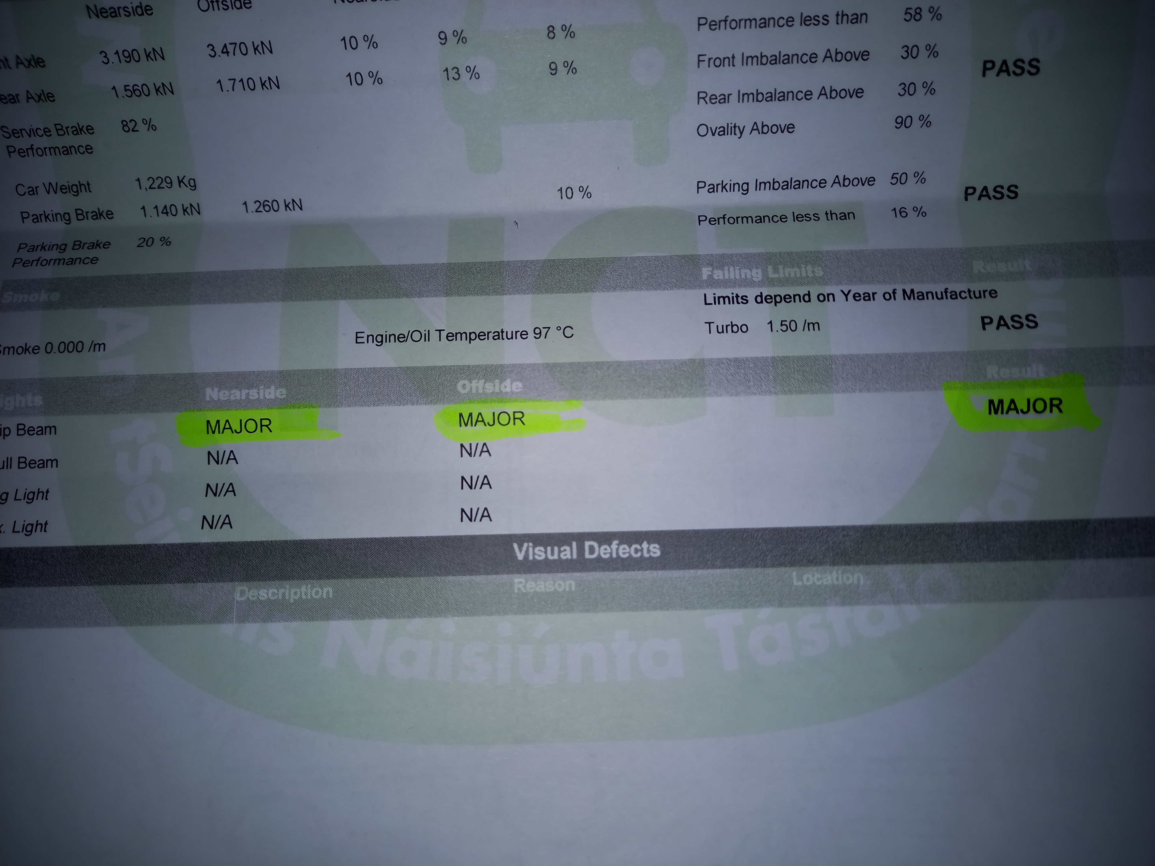

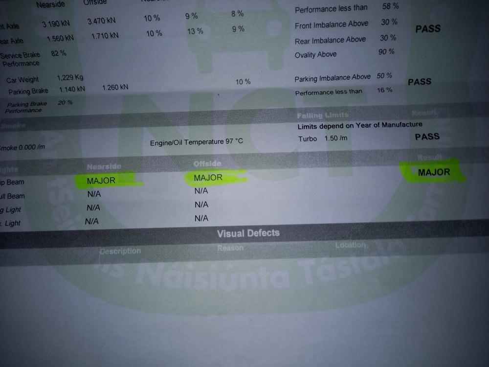

I had it booked for its NCT today, the only date I could get was November 4th as every other NCT centre was booked until February.Not good as my NCT was only extended to December. The car was serviced a few weeks ago, The oil was changed and the exhaust was put on. Apparently the exhaust was completely wrong! The tailpipe was too long so it had to be cut and re welded back on. Also it sits a little too low so you can just see the tip from the back of the car but I actually like how it sits so it'll stay that way.
It actually failed but only on the headlights. Everything else it passed with flying colours,even the stiff seatbelts. Apparently when the headlights were adjusted they were set when they were in the lowest setting on the dial so when they were raised for the test they were way too high! I checked them but I thought since they were level they were fine, I never adjusted them because they were level when I got the car. No wonder I keep getting flashed! I have it booked for a retest in a week but I'll have it fixed by then.

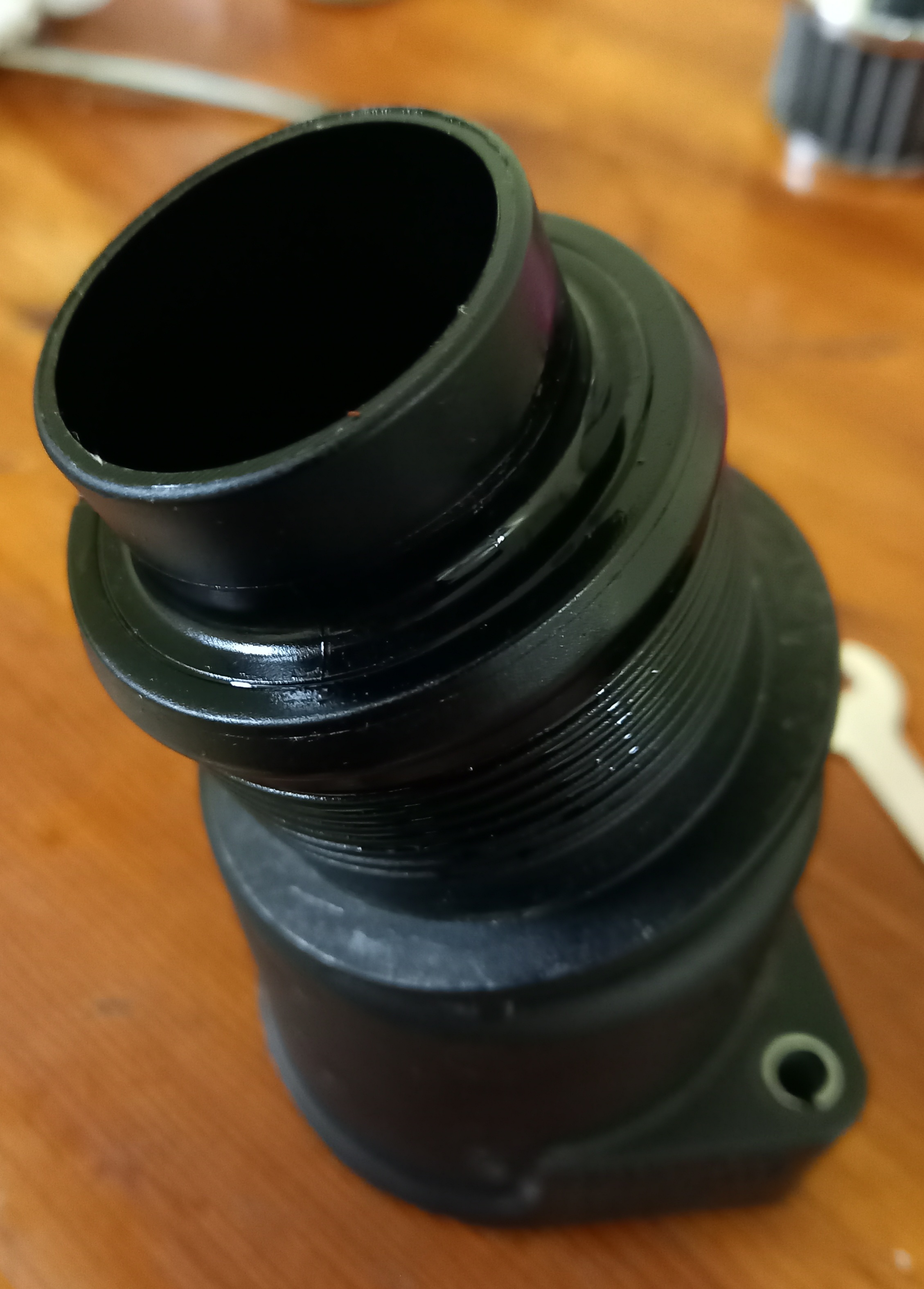

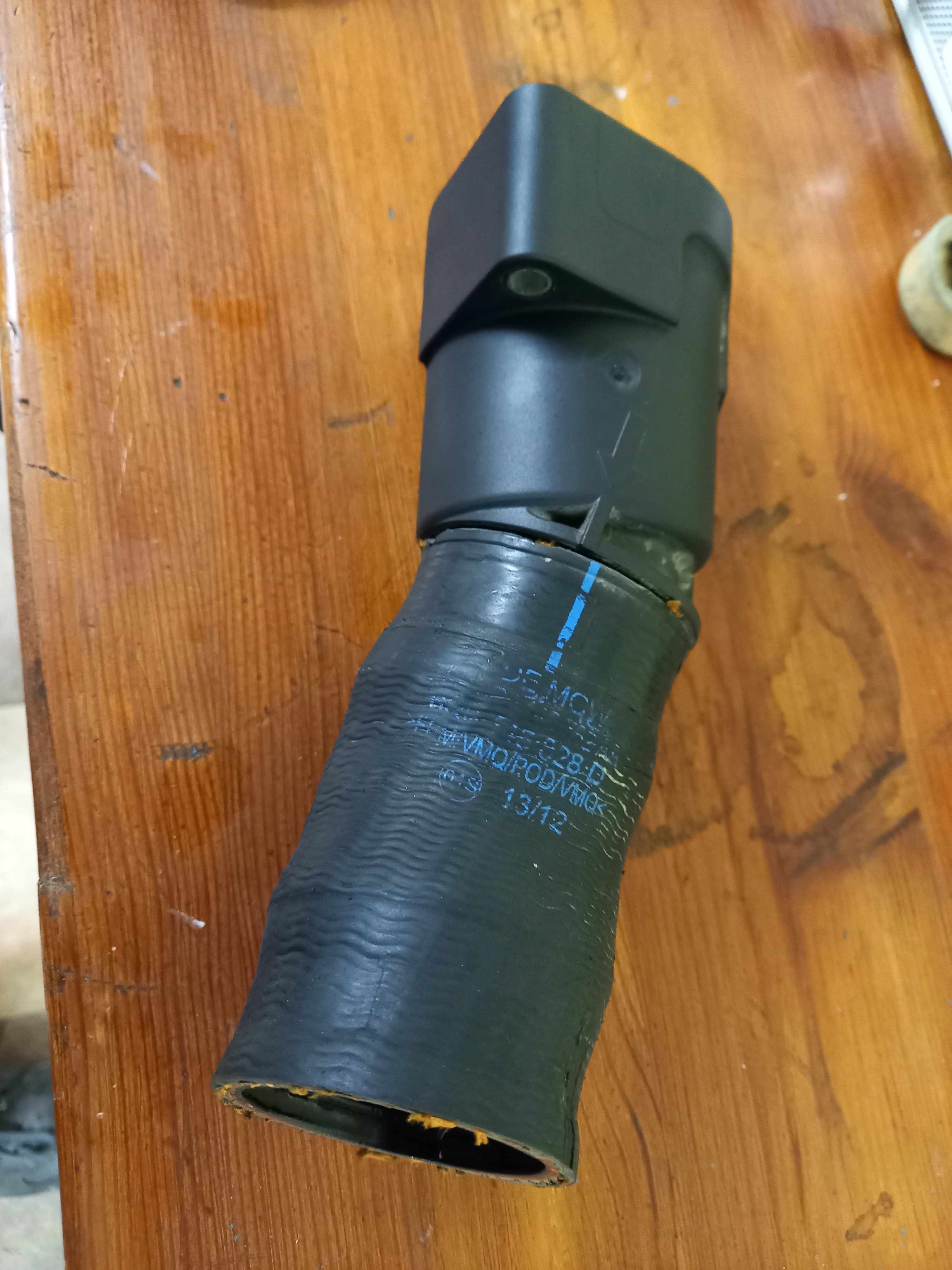

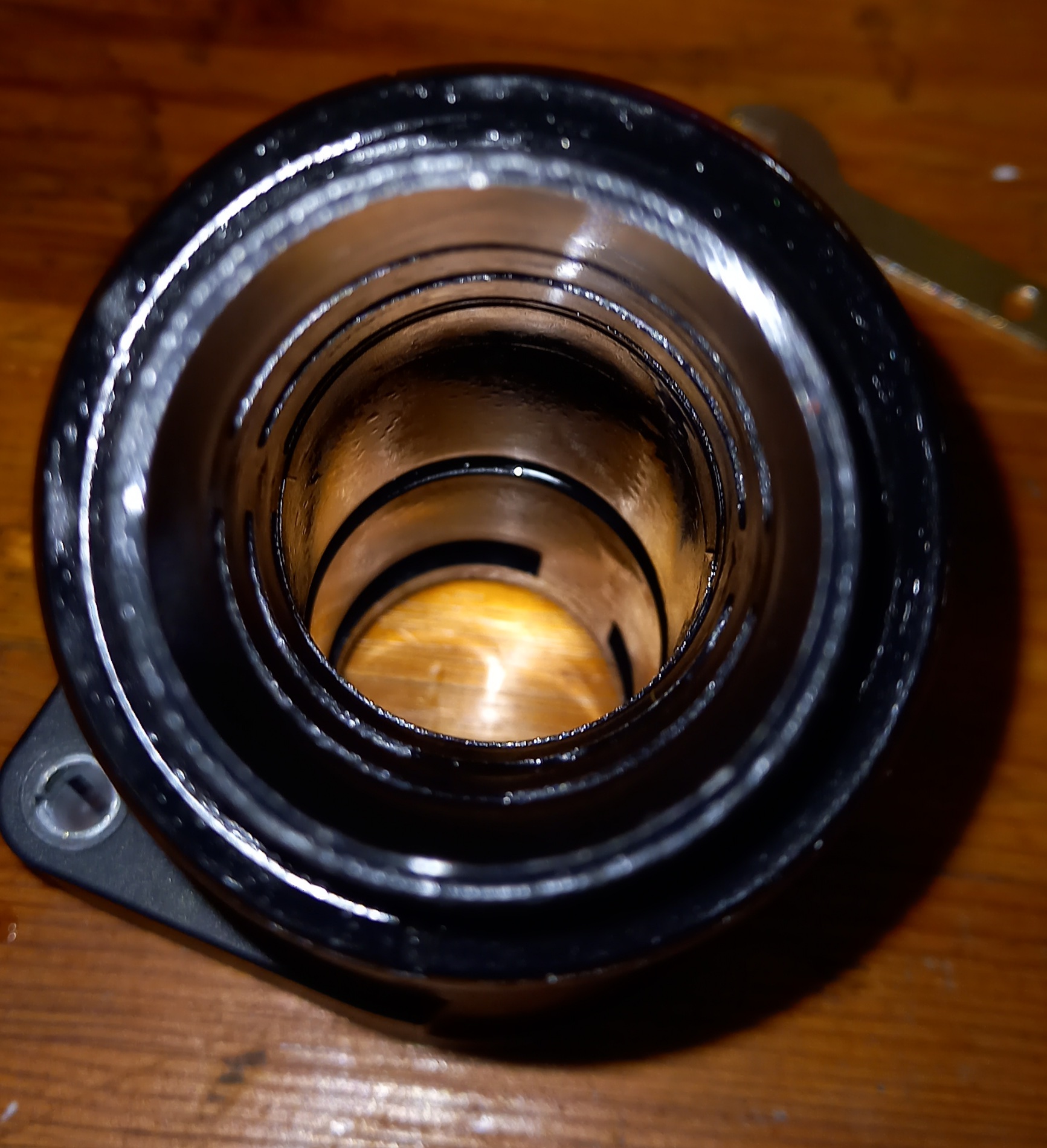

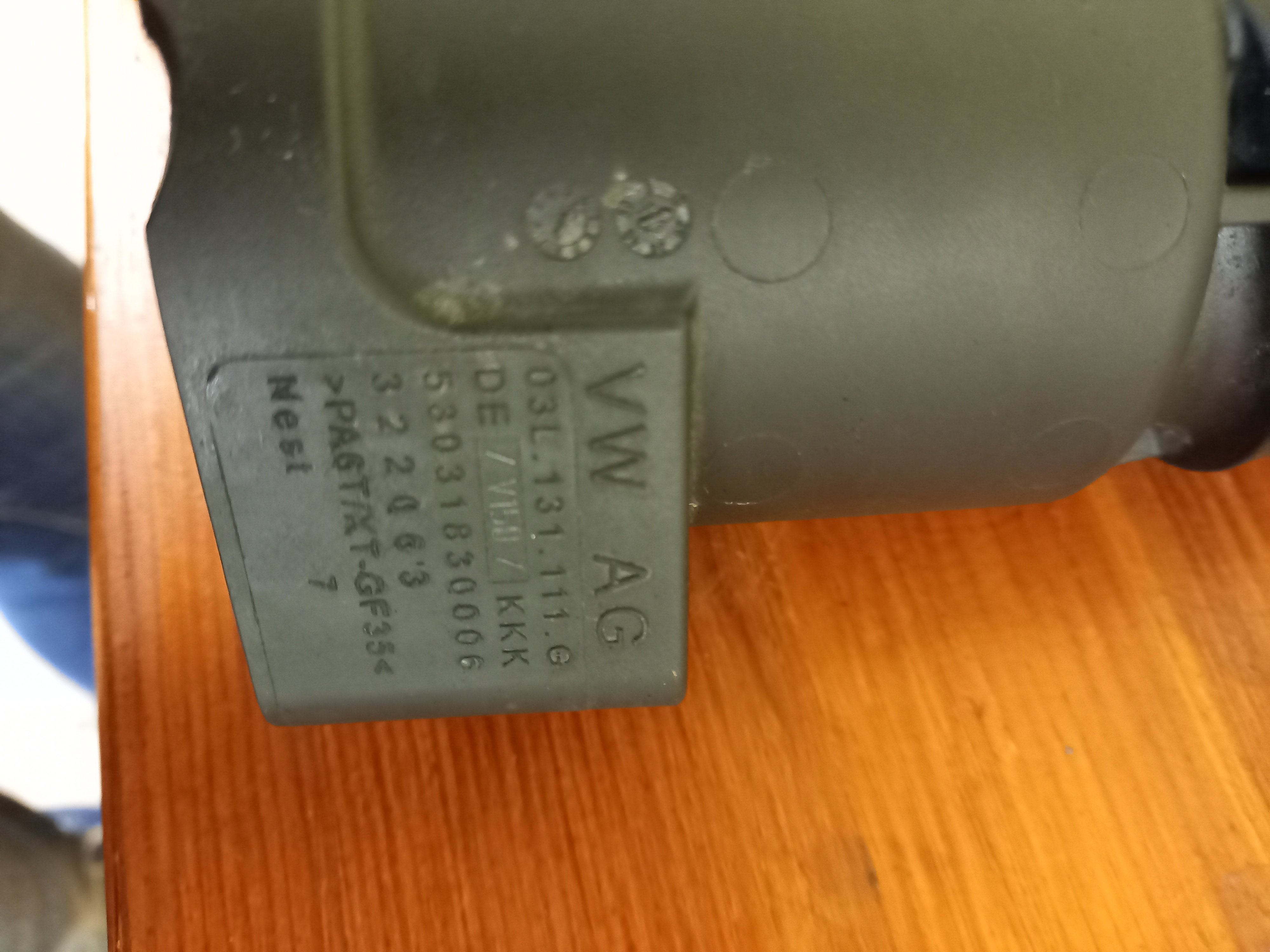

Did a thing the other night.

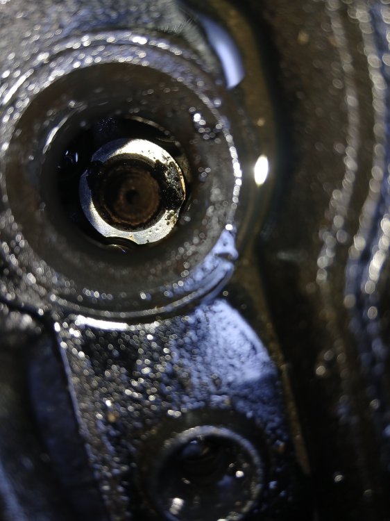

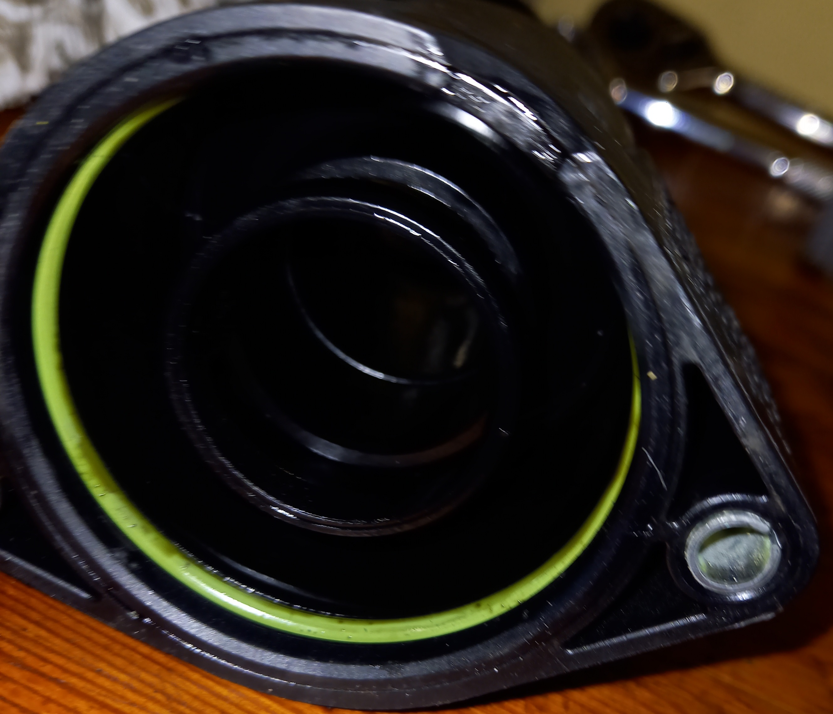

I was going through old threads on briskoda and found one where someone had bought a spare turbo damper to modify and replace with the stock one. I researched futher and found that darkside makes a replacement piece, about £50 iirc. I also found that people have done this mod on tdi golfs. So I decided to do it myself. Pic related is the damper in question, just on the outlet into the intercooler.
Pic of the damper off of the car. Hose was a MASSIVE pain and took an hour to get off of the car and then damper without breaking it. I ended up using a tool to remove bike tires to separate the hose without breaking it.
Pic of the damper off the car with part no. You can see that the hole is much smaller than what it could be.
These pics are showing the inside of the piece.
