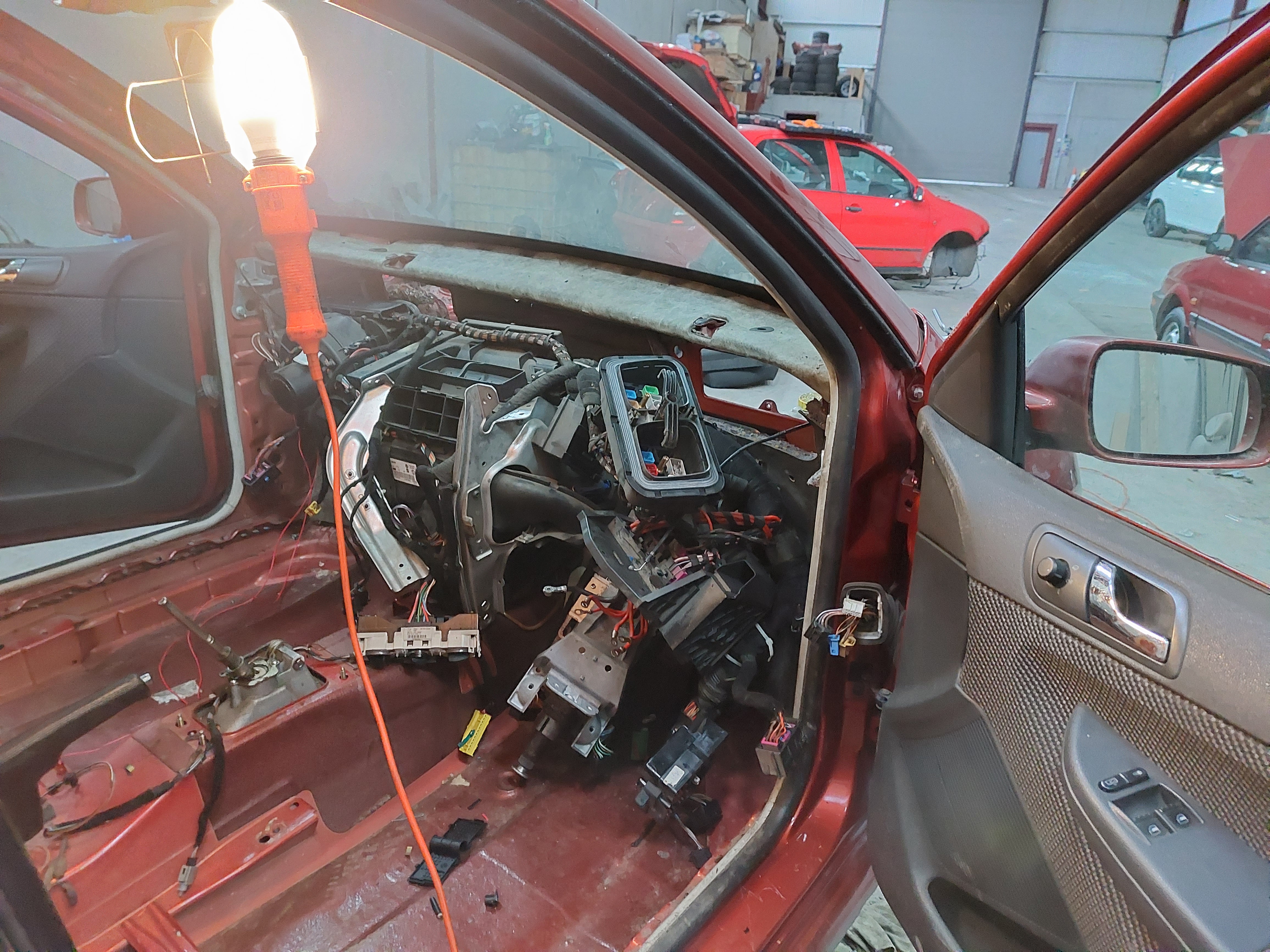

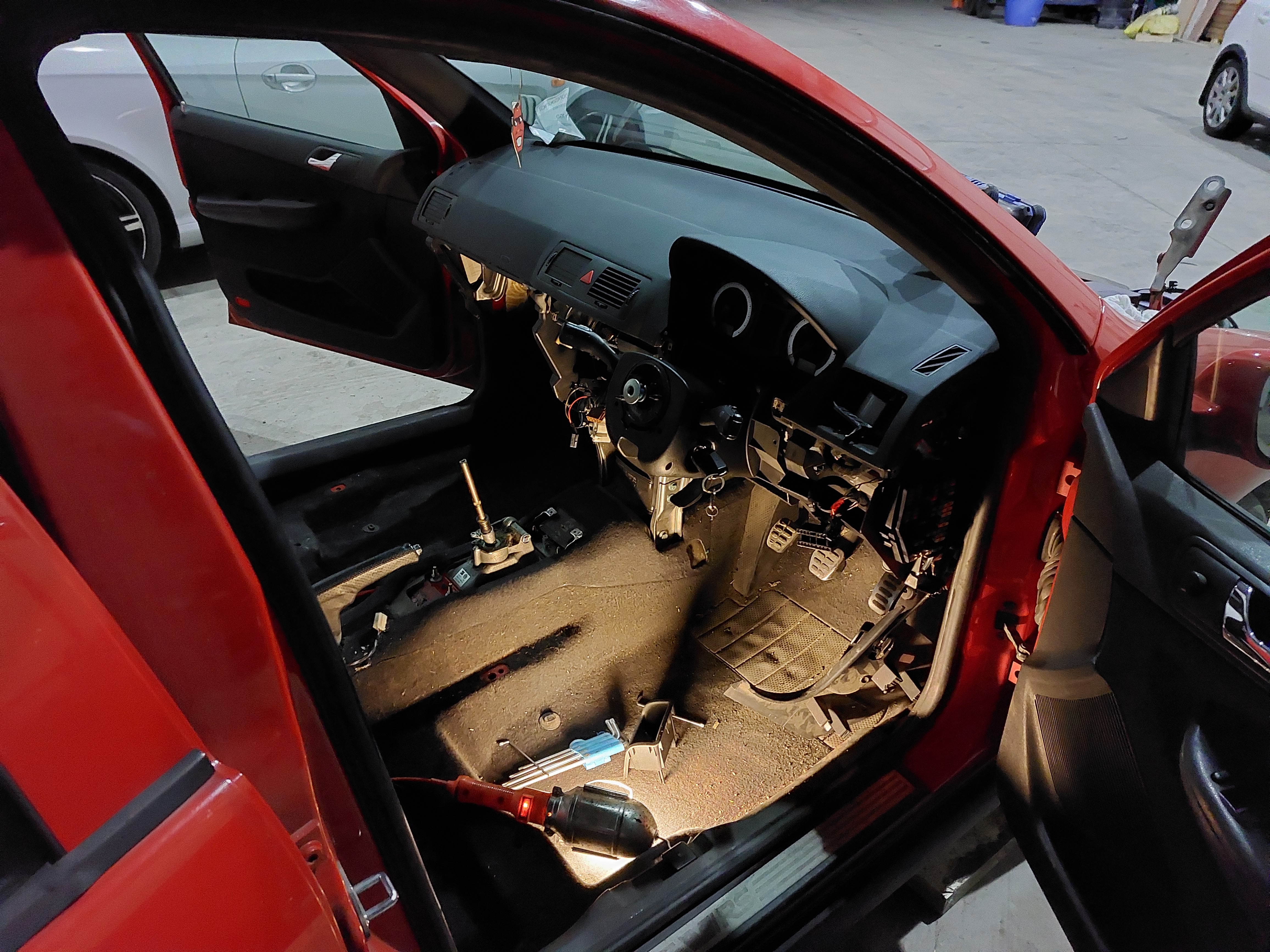

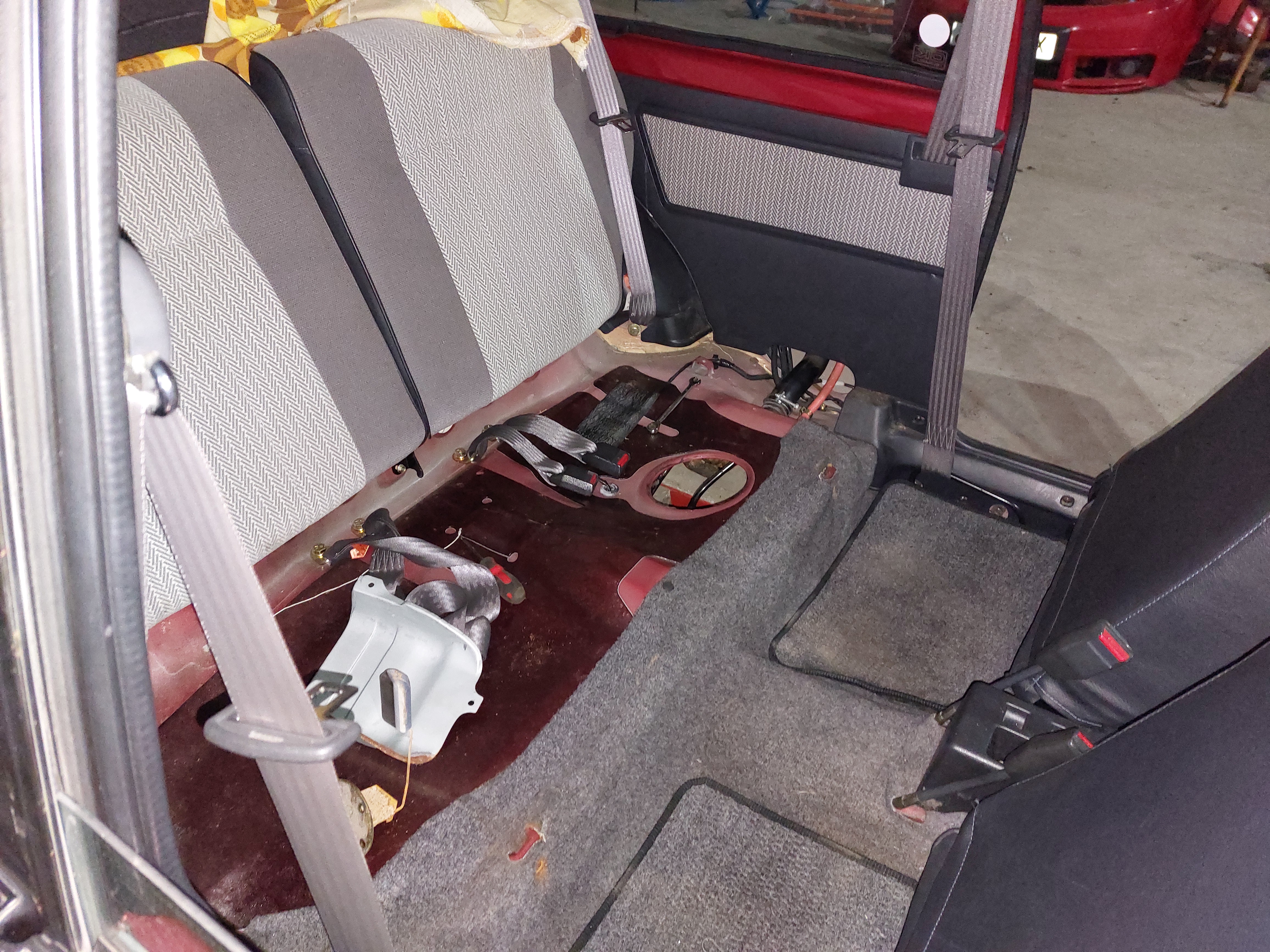

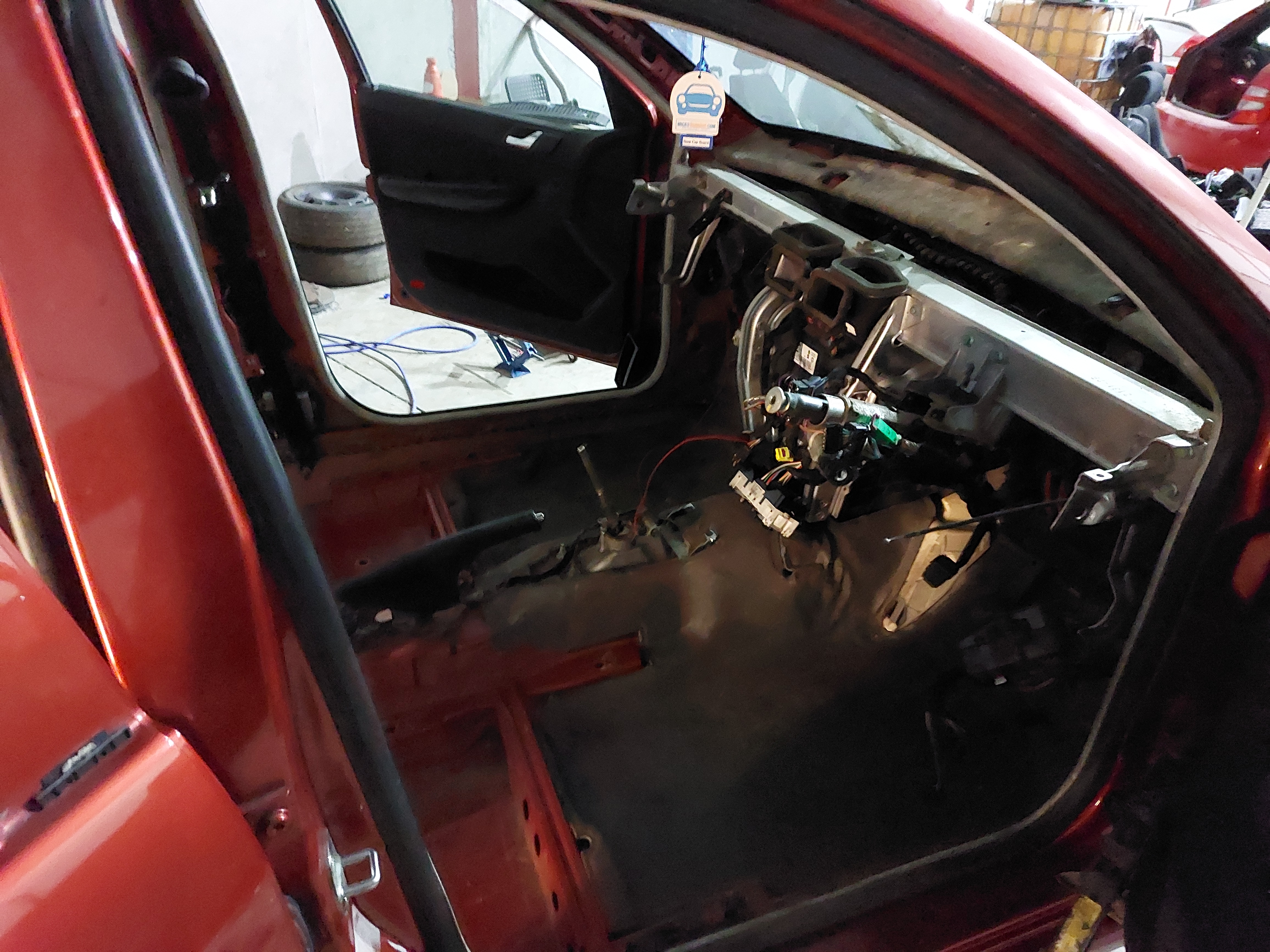

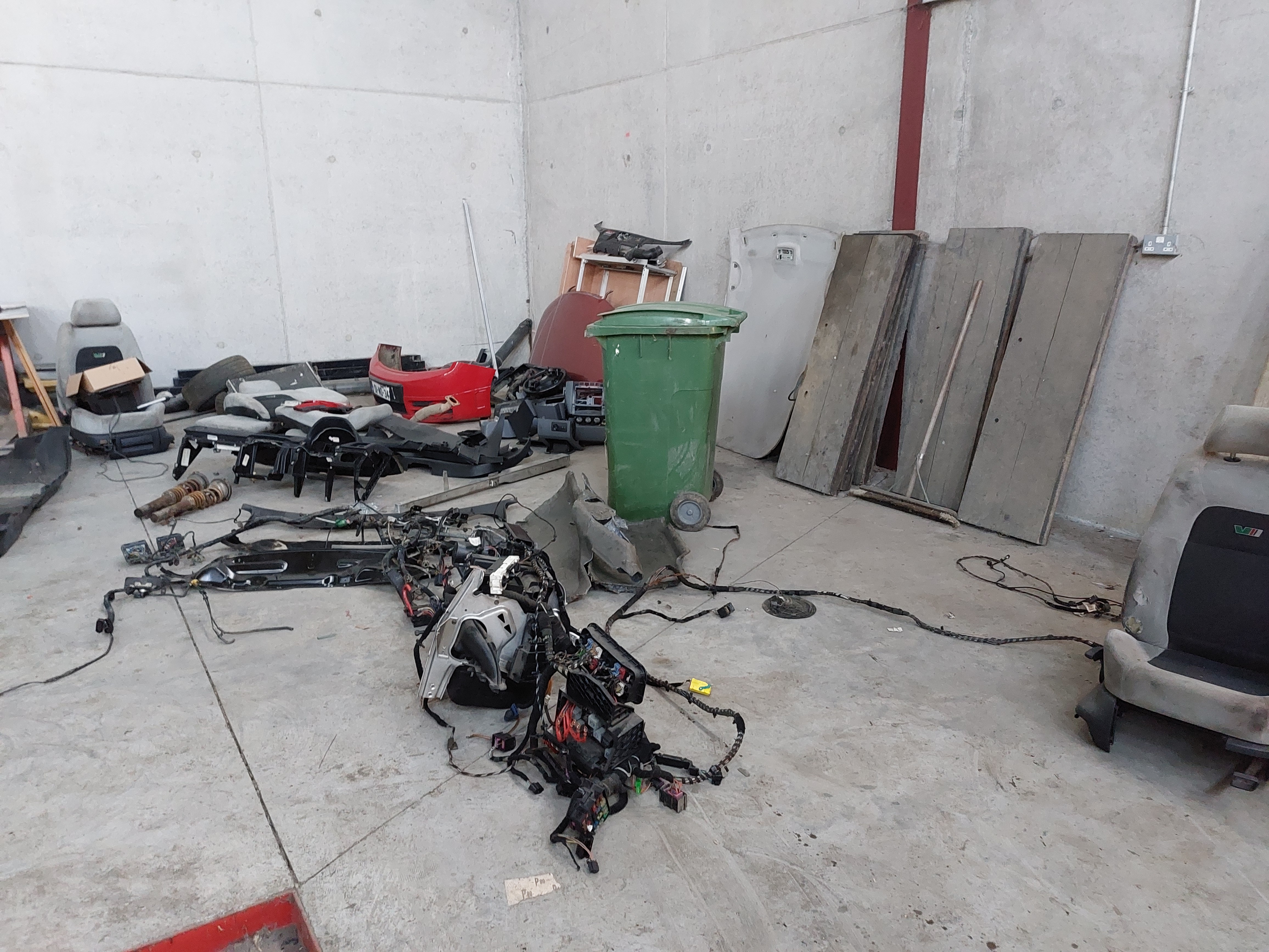

  1. Dash and carpets are now out of the vrs Noticed the wiring on the fuel pumps are different. Might be able to just swap the tops but might swap the entire tank, not sure. Kind of crazy how dirty the sdi is inside as a result of being a farm car for so long.

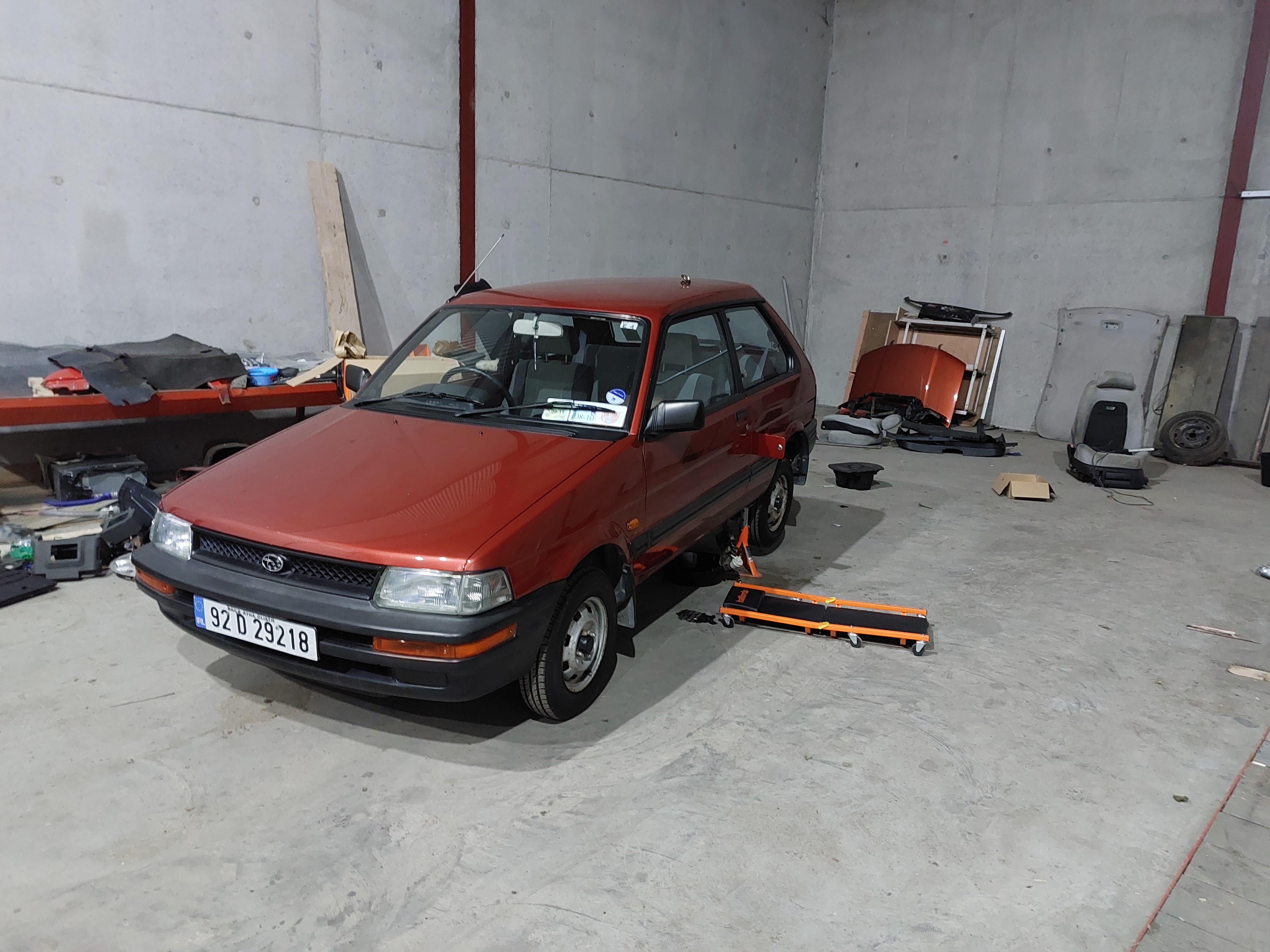

  9. Spent some time on the justy this evening but still made some progress. Cleaned the bay down, which It desperately needed. Blew out all the crevices (which made a mess) Then primed some dodgy areas with rubbed through paint And used a spray can of cayenne metallic to spray it in. If you don't look too hard it looks all the same colour and it should prevent any rust from forming. Be hidden behind wiring and piping soon enough so just needed to be presentable. As much as I want to do some huge strip down and respray of the bay, and make everything look better than new. I'd end up chasing my tail and it'd sit for another 5 years. Have the engine loom in place now too. Small steps

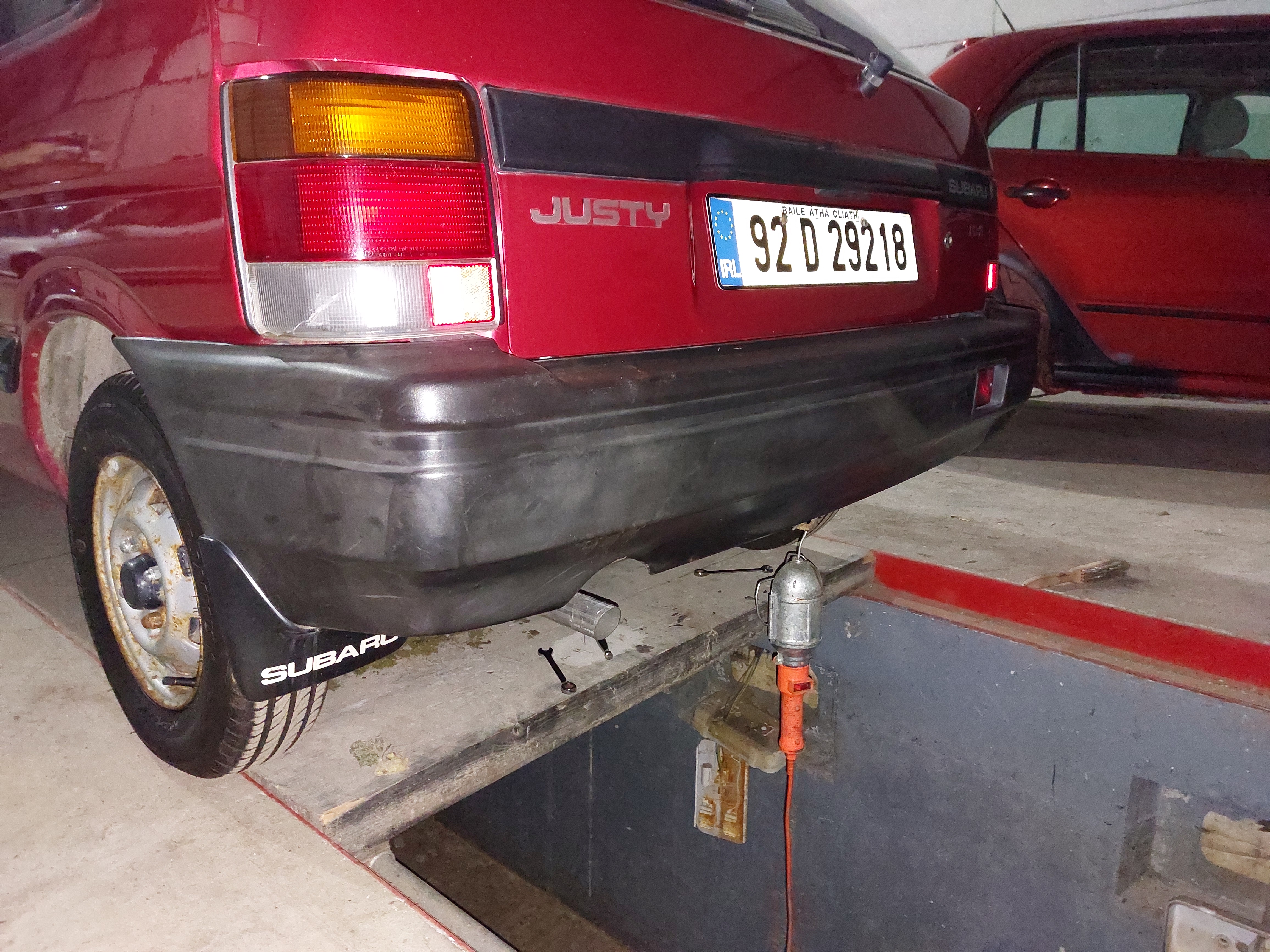

  10. Don't worry it's off the pit now and hopefully won't need to go back on for a long long time. I ran some petrol in and around the tank, shook the life of it and drained it out. Turned a shade yellow but compared to before, I don't think I'll have any trouble for another while yet. Also note the fuel pump/filter dragging still. New filter is slightly different to the old one so it's gonna take a bit of fettling to put in. Done enough on it this evening to be happy.

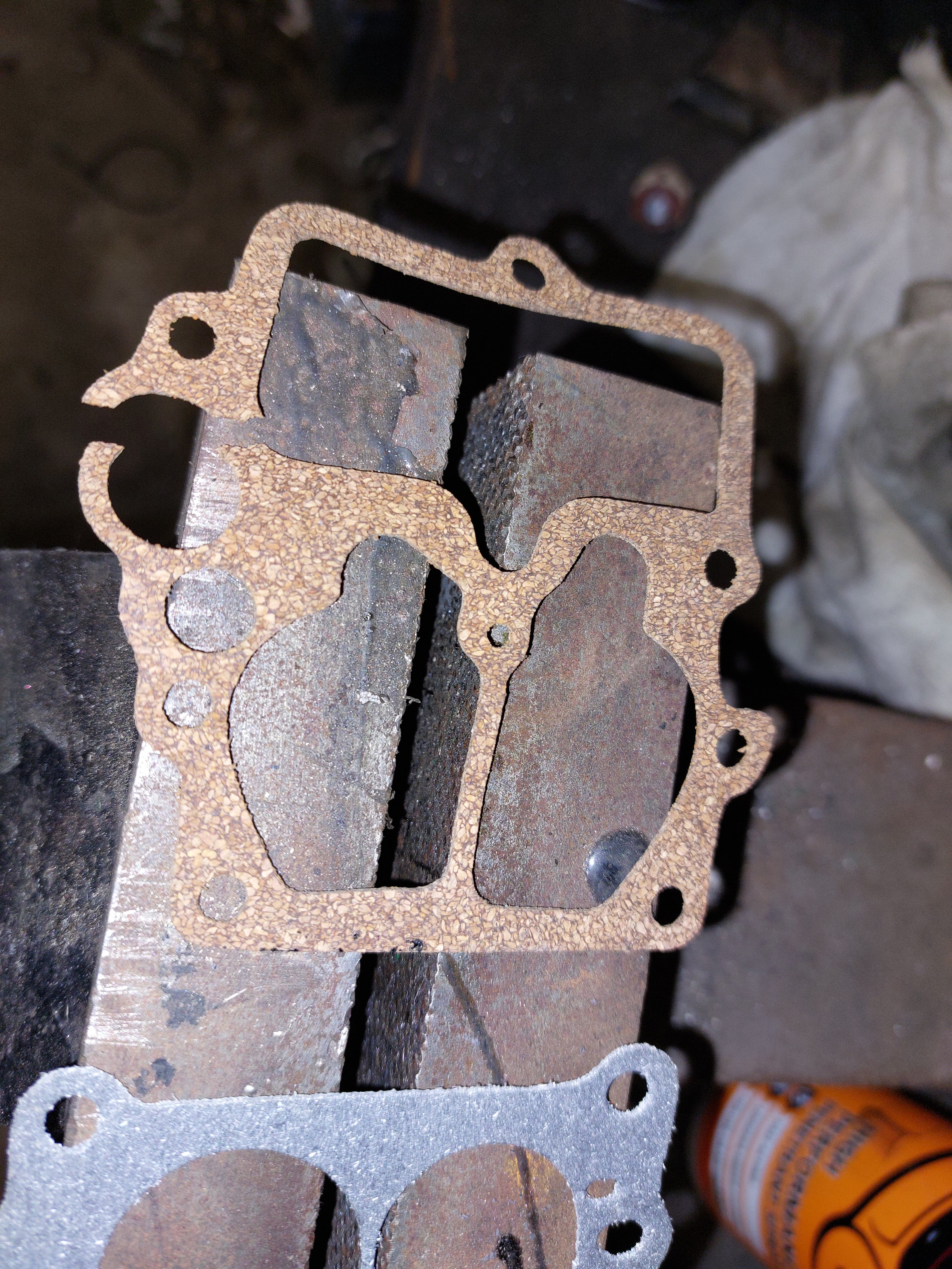

  11. Fuel tanks back in and plumbed up All I'm waiting on now is a gasket for the carb. So close and yet so far Wouldn't mind but I did order gaskets and waited a month for them, only for them to arrive ripped. From a different seller mind as the seller I bought the first kit from is out of stock.

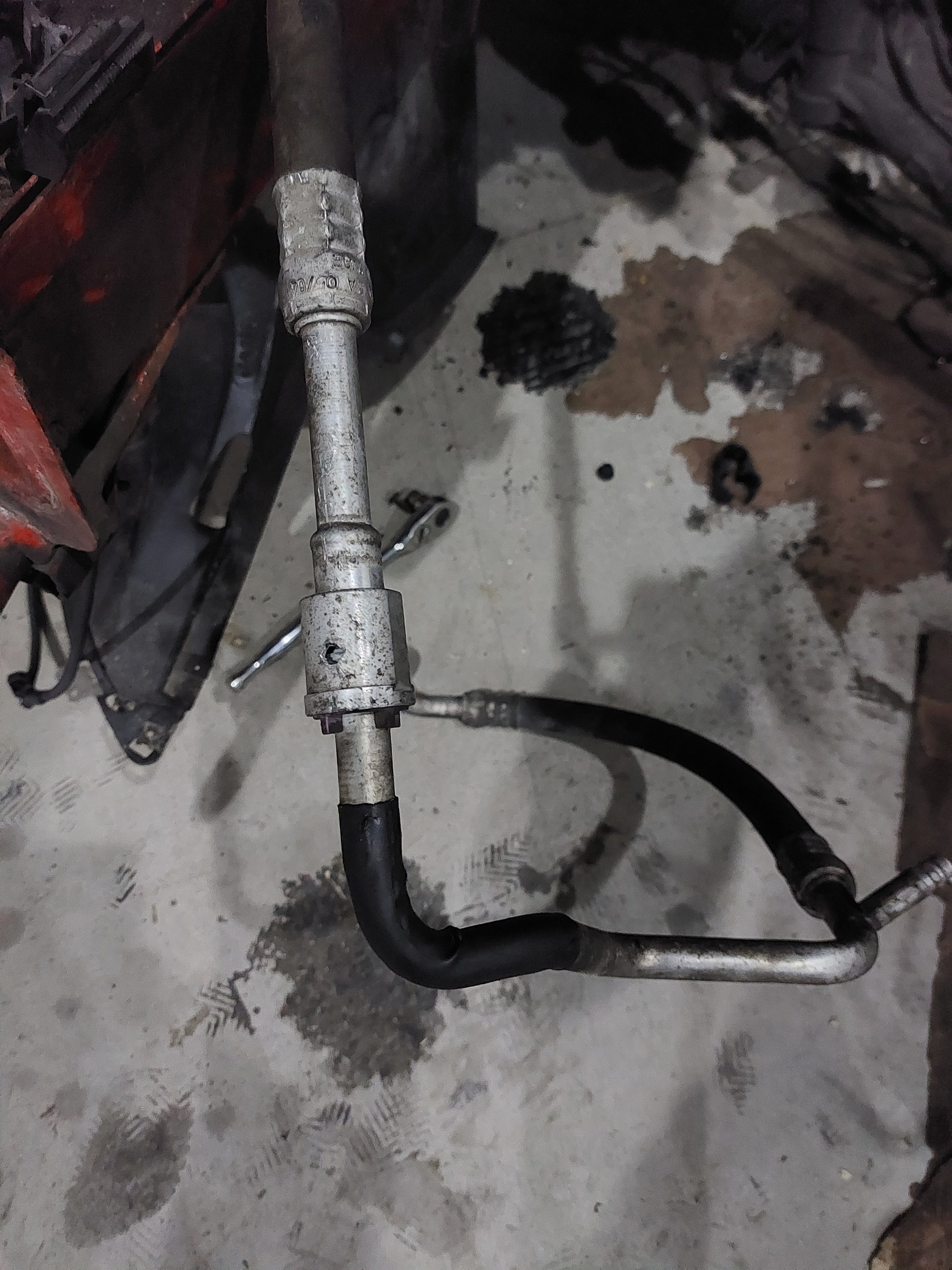

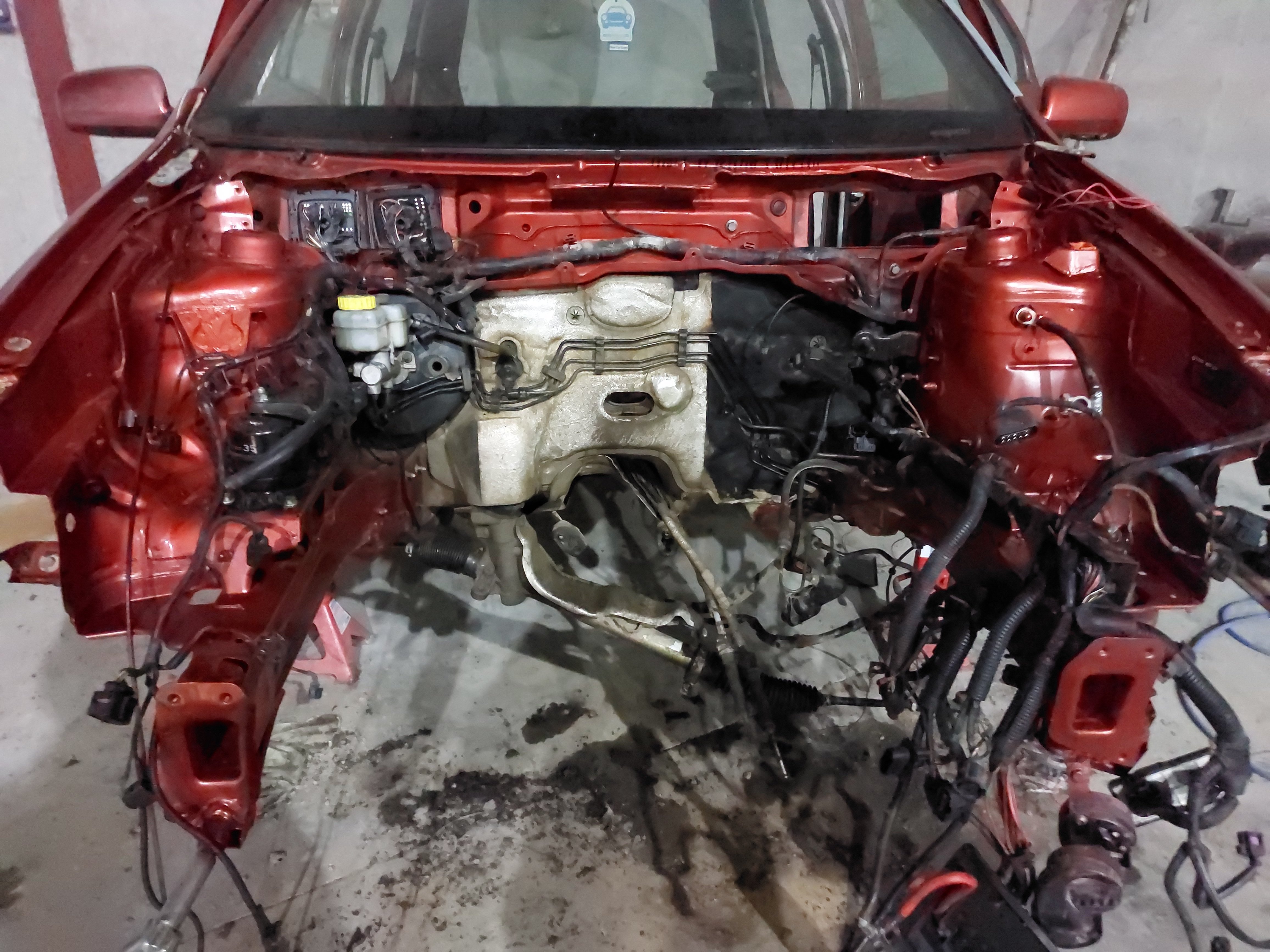

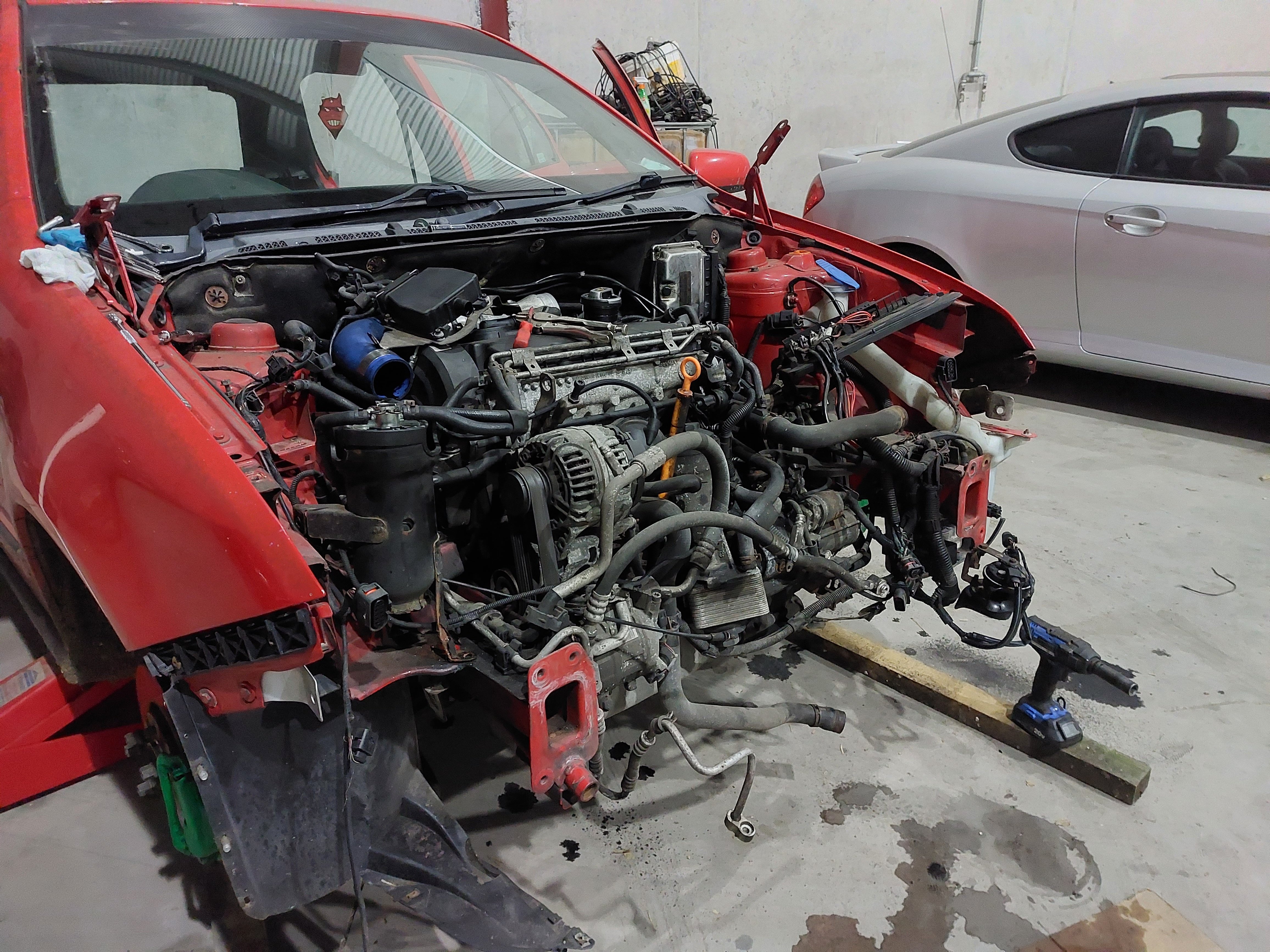

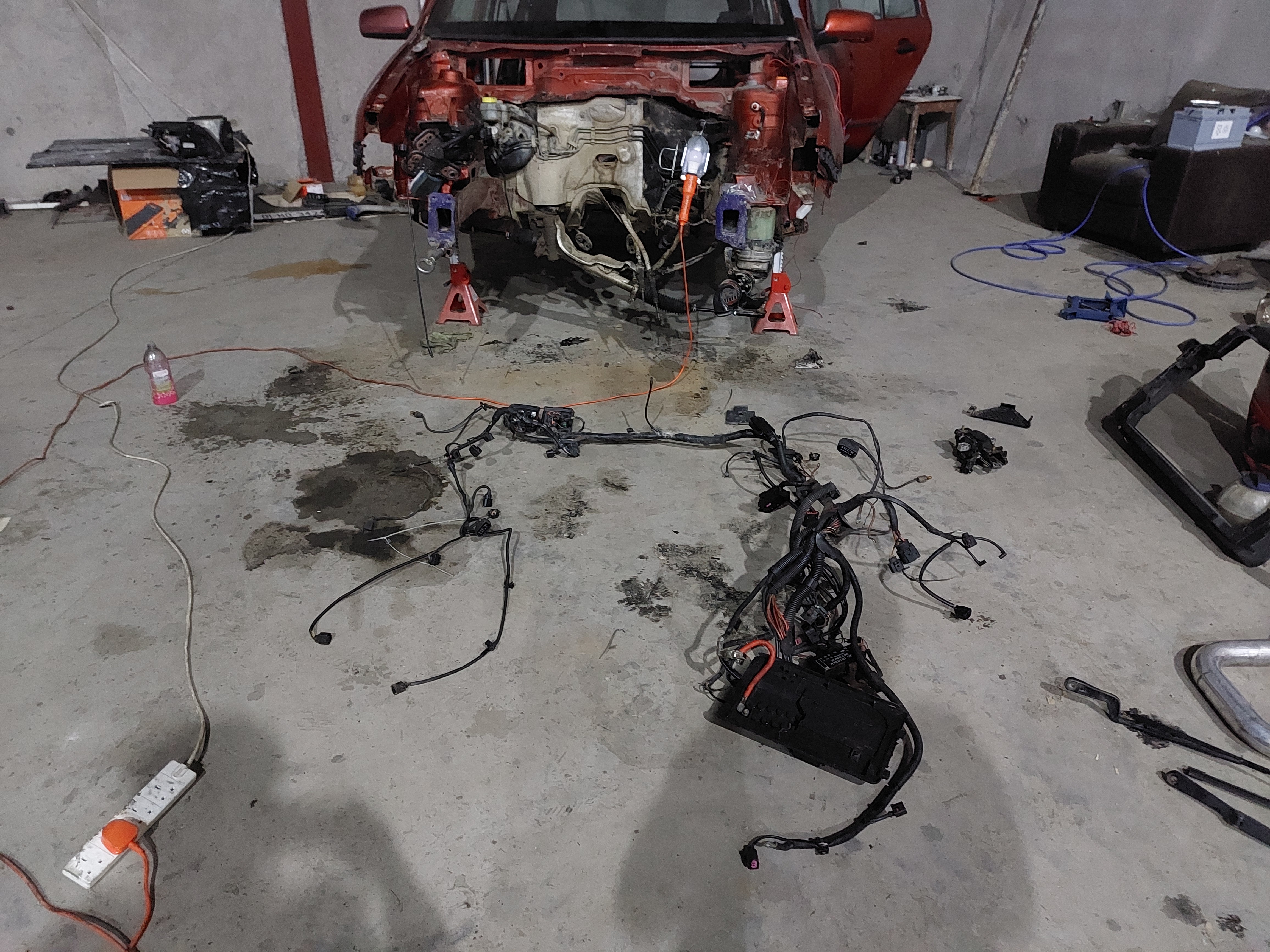

  12. Vrs engine loom out and ready to go in after some cleaning. Struggling a bit with this connector for an ac pipe but I think I've a solution figured out to do next day

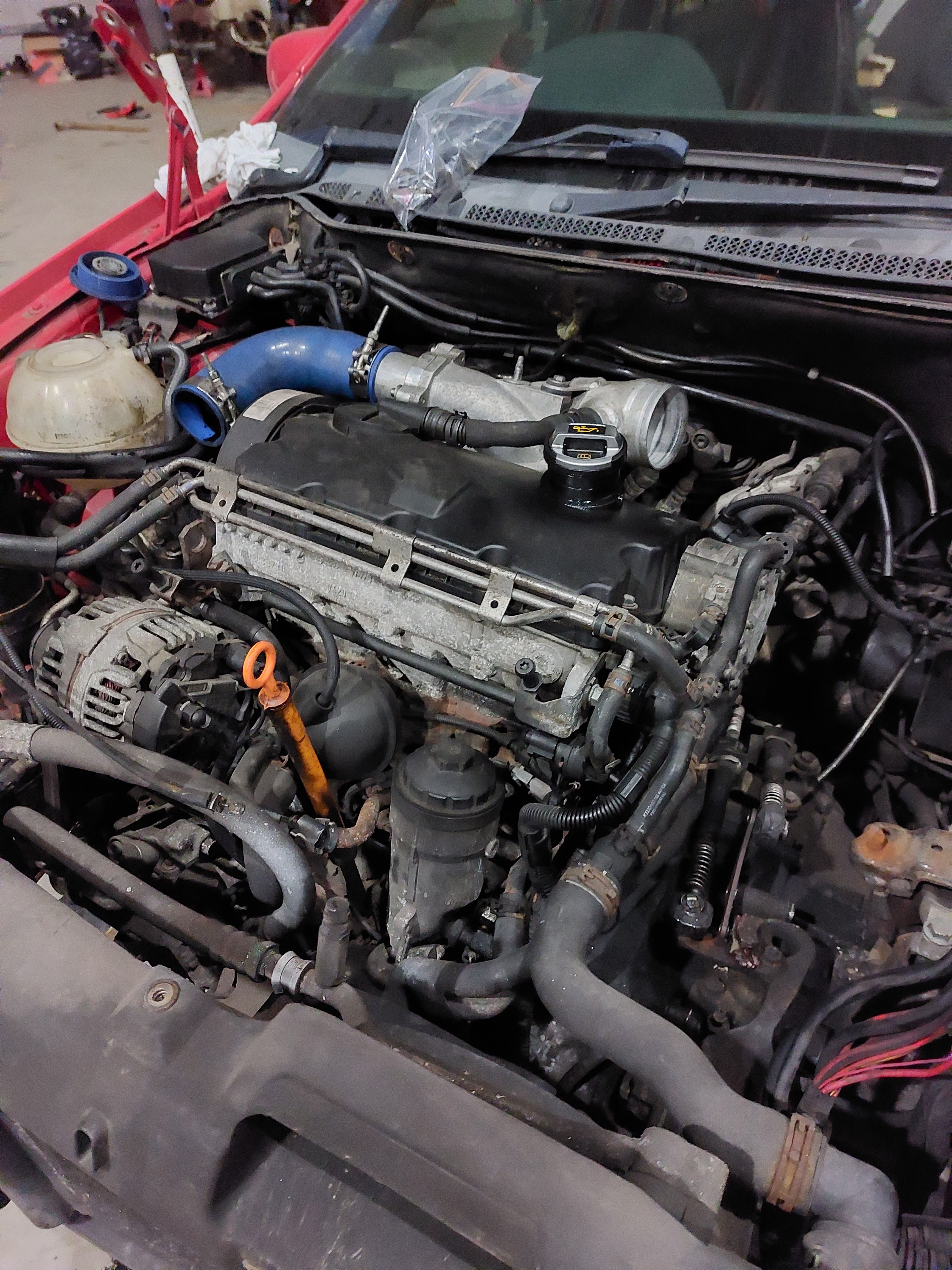

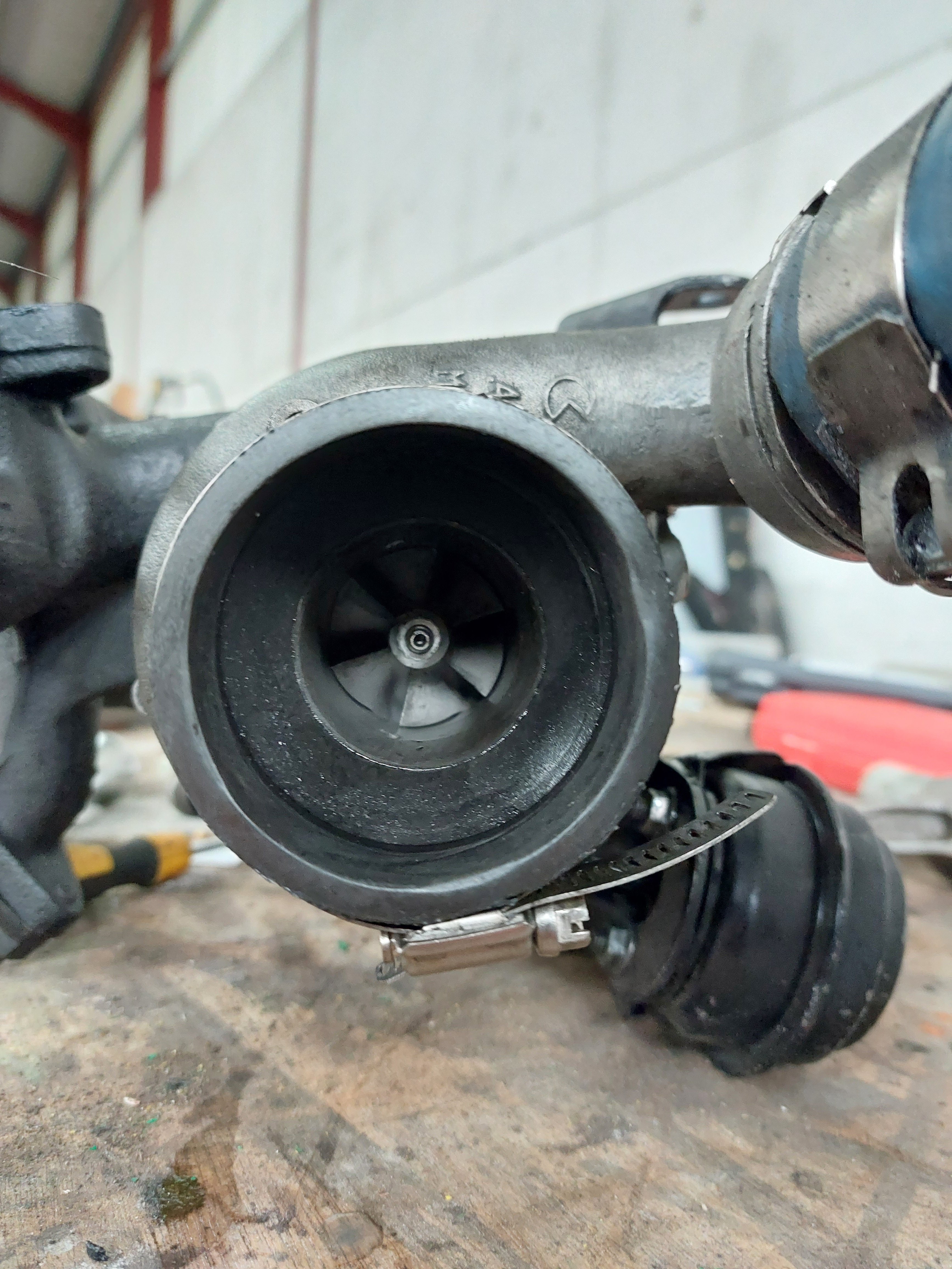

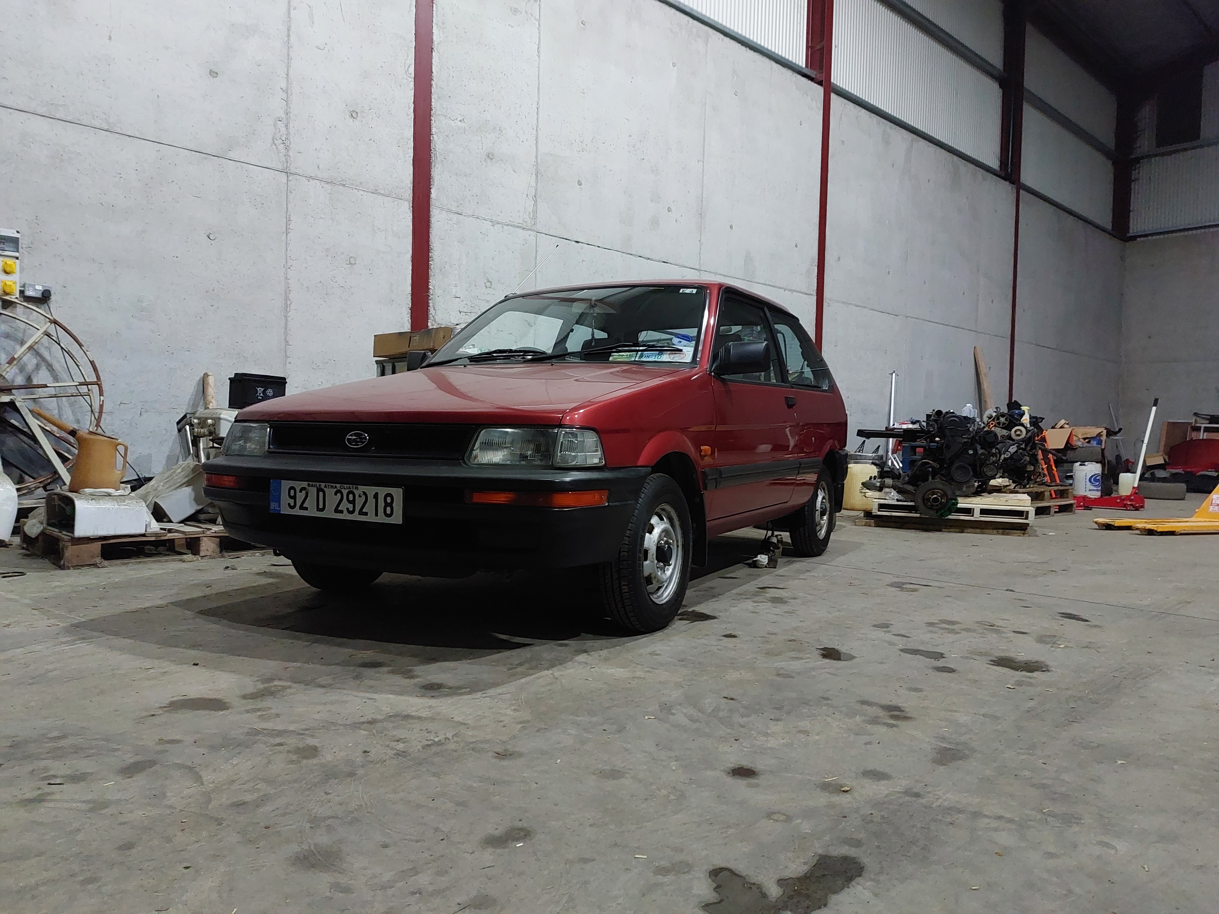

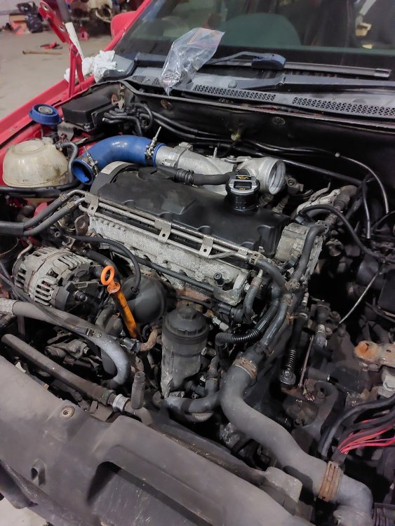

  14. Also took the turbo off the vrs to check why it was passing oil. No play in it and everything seems OK. Guessing the return line was the issue. Will get a new return pipe and gasket. Atleast I should have plenty of parts to sell afterwards which should cover some of the cost. Although I'm still not much into this. Still cheaper (so far) than buying a nice vrs let alone importing one so I've got that going for me. Which is nice.

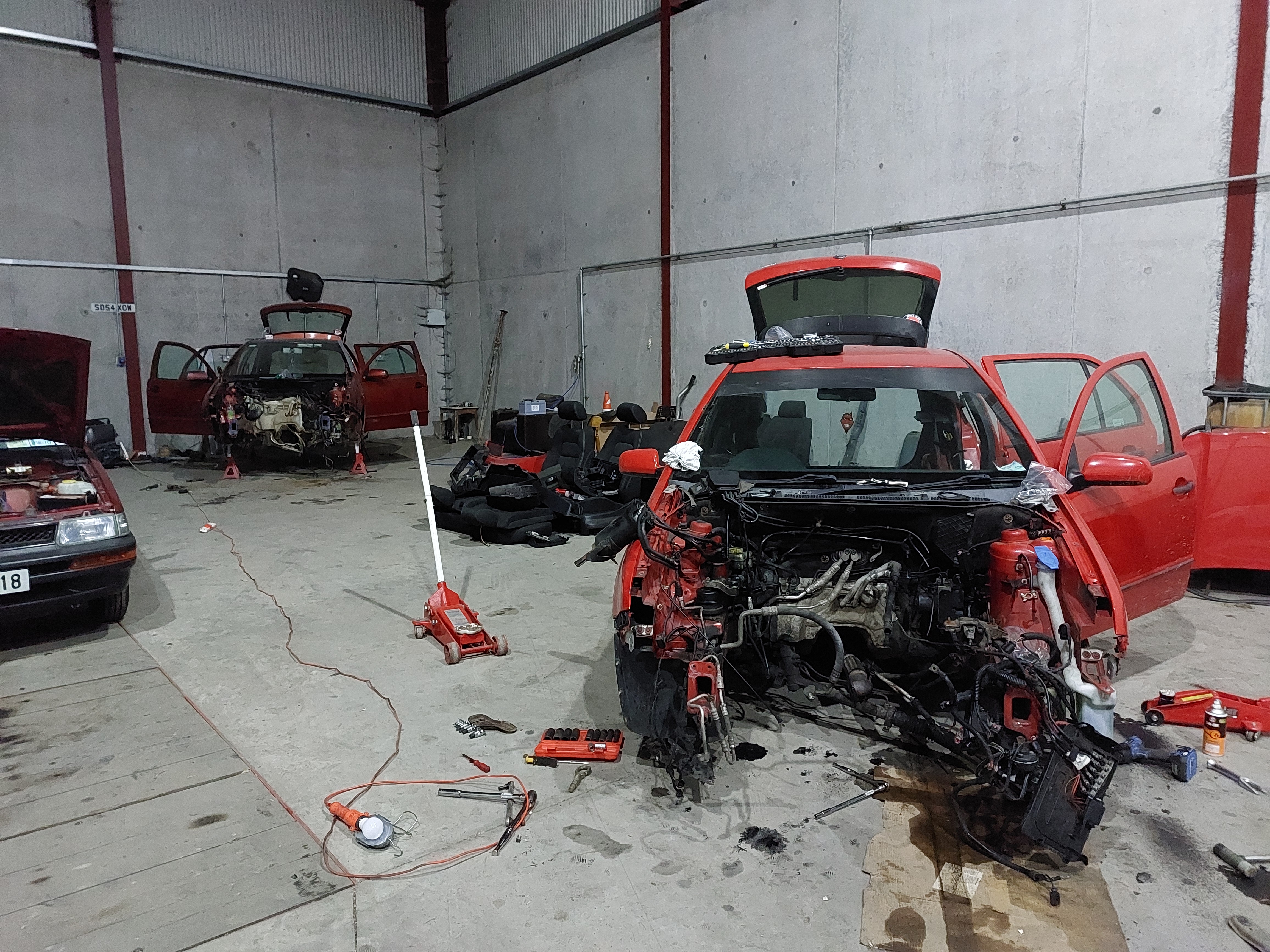

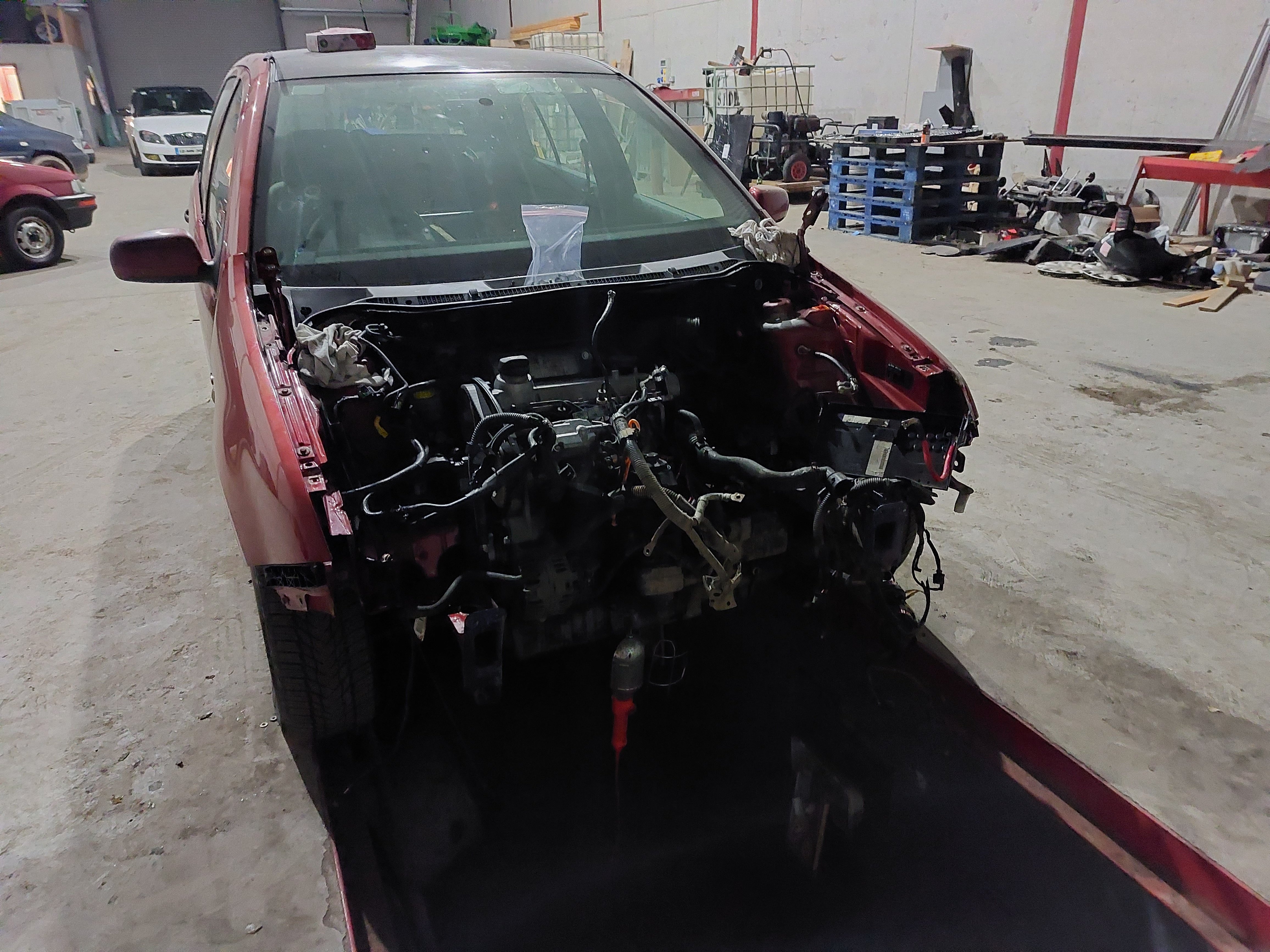

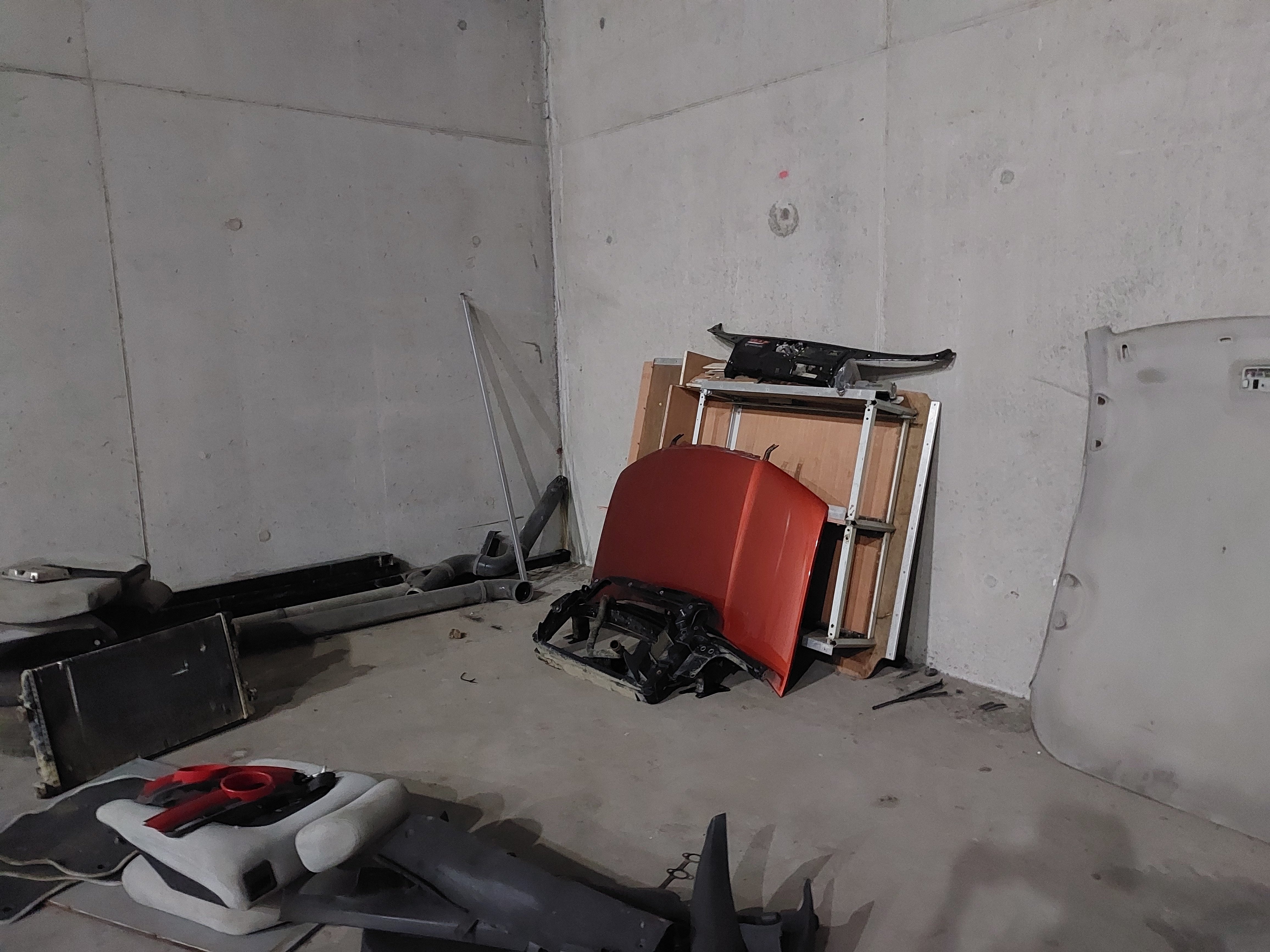

  15. The sdi is now completely stripped of its wiring looms, engine bay and body loom. Need to remove brake lines next, Imagine I'll have to buy some new lines but AFAIK they'll be available from the dealers. Left the wiring in the doors in as I don't think I'll need to change them. If I need to I will but both cars have crank rear windows and such so should be the same. Stuff removed from its taking up more space than the car itself now.
  16. More filler. Finally got some proper use out of those snow tyres. Only took a year. Didn't stay covered in slush for any longer than it needed to be. Changed the wheels back since. Was feeling very dead lately so cleaned the maf, which helped a lot but it still felt off so ordered and fitted another n75 which seems to have it back to where it should be. Swapped out the battery too for the one on the vrs as the new battery that was in it didn't like holding a charge overnight. Been fine since. Also blew another chunk out of the right front splash guard so ordered another one, new genuine ofcourse. I still have the passengers side one yo fit so I'll fit that at the same time. Pretty sure the rear ones are cracked on the bottom just in front of the wheels, may order them at some point too.

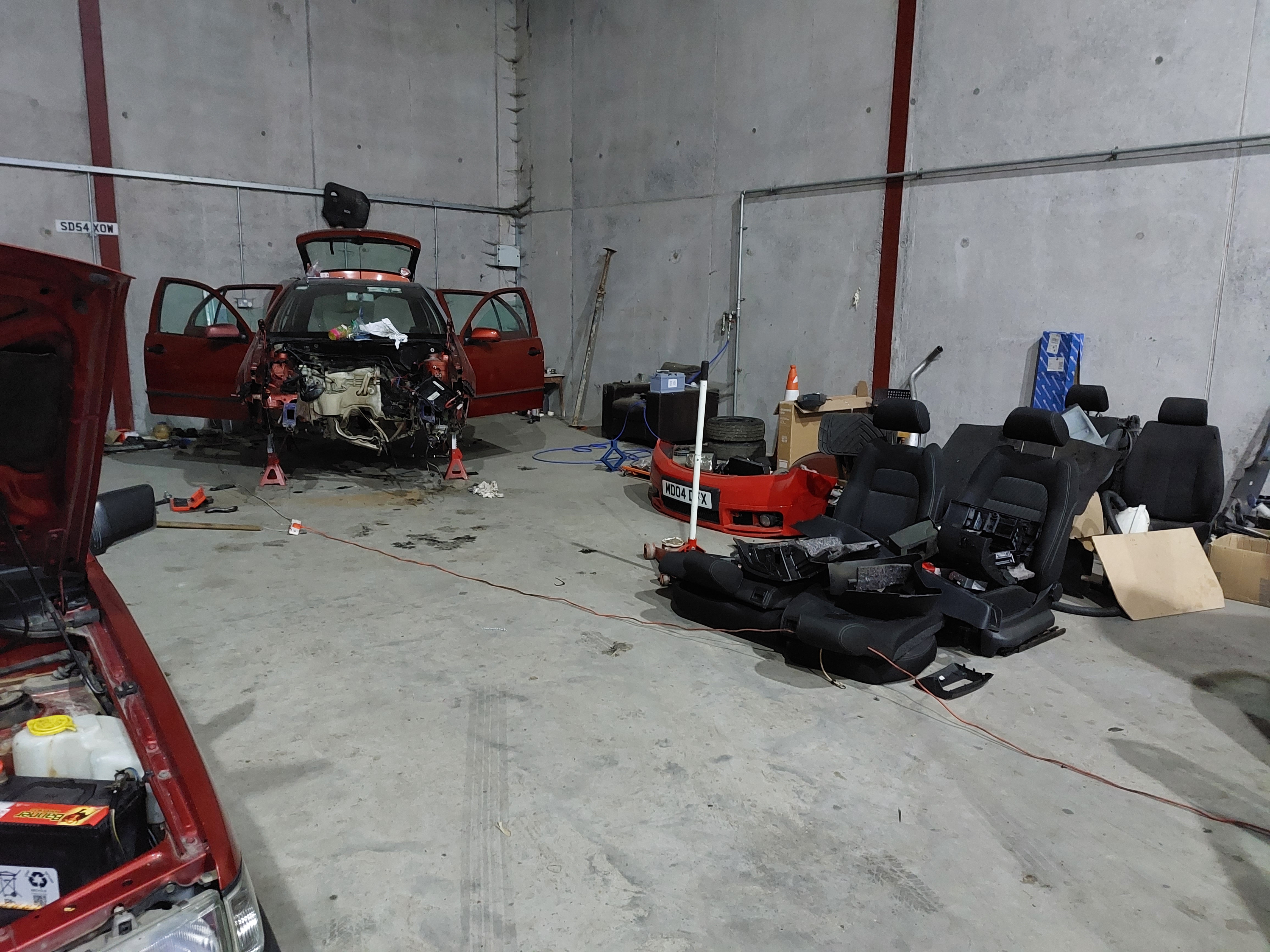

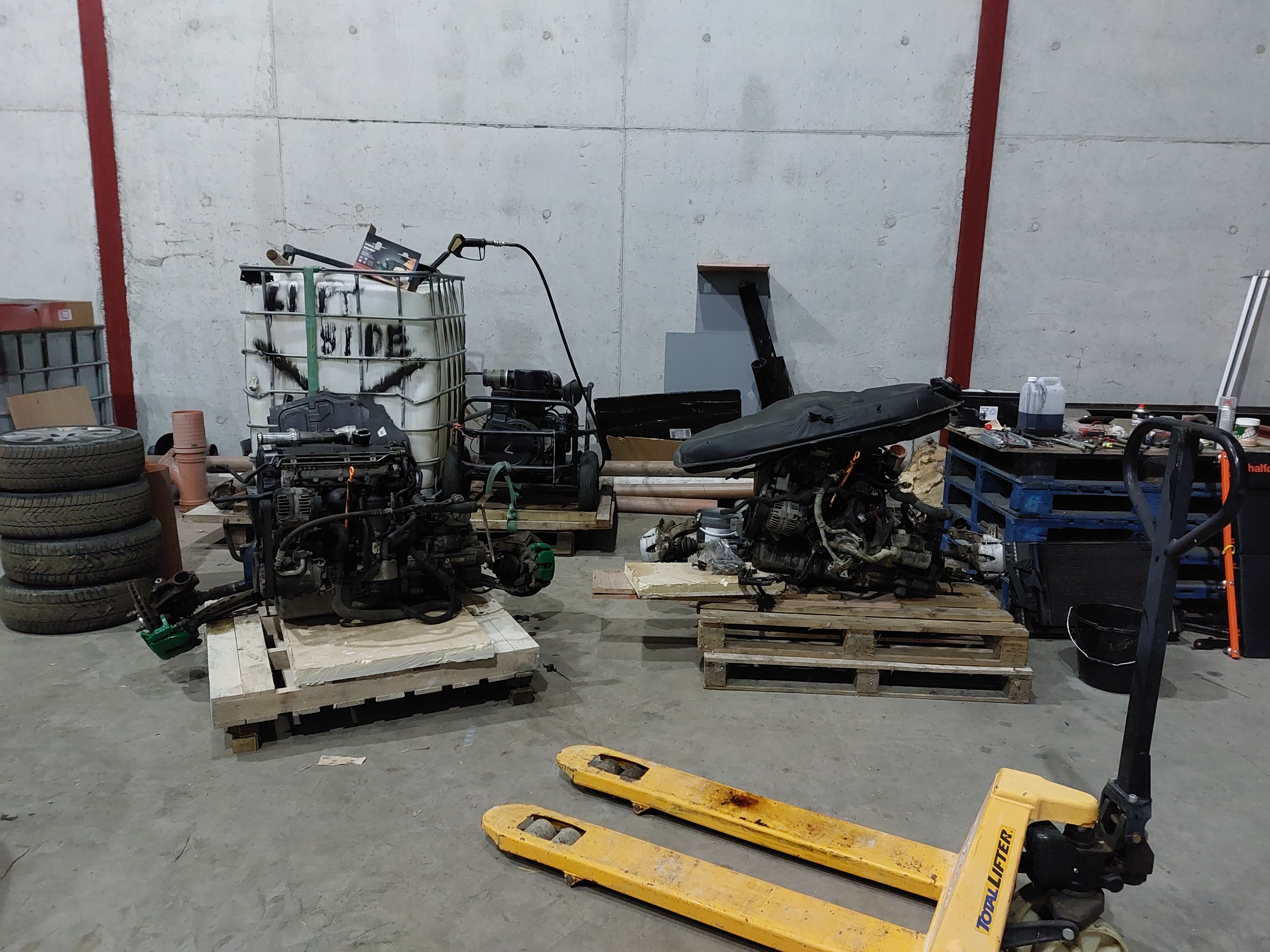

  17. Been pretty cold of late so I've not been able to do much. But the weather is warming up slightly so I can work on my stuff without freezing. Both cars are basically stripped inside now. The sdi a little more so than the vrs Then set about getting the pd lump out of the vrs. Was done an hour or so at a time until this evening Engines officially out, was a lot more stuff on this engine than the sdi, air con, extra wires etc. Sat next to each other From here it'll be swapping bits in the engine bays over and ofcourse the wiring behind the dash. If I want to make the air con work (and I do) ill have to rip everything out of the vrs it seems. Looks like the vrs had a new blower motor put on at some point and an air con condensor too. Both genuine VW bits to boot. If I could have the engine in by the end of the month it would be brilliant. It won't happen, but I can hope

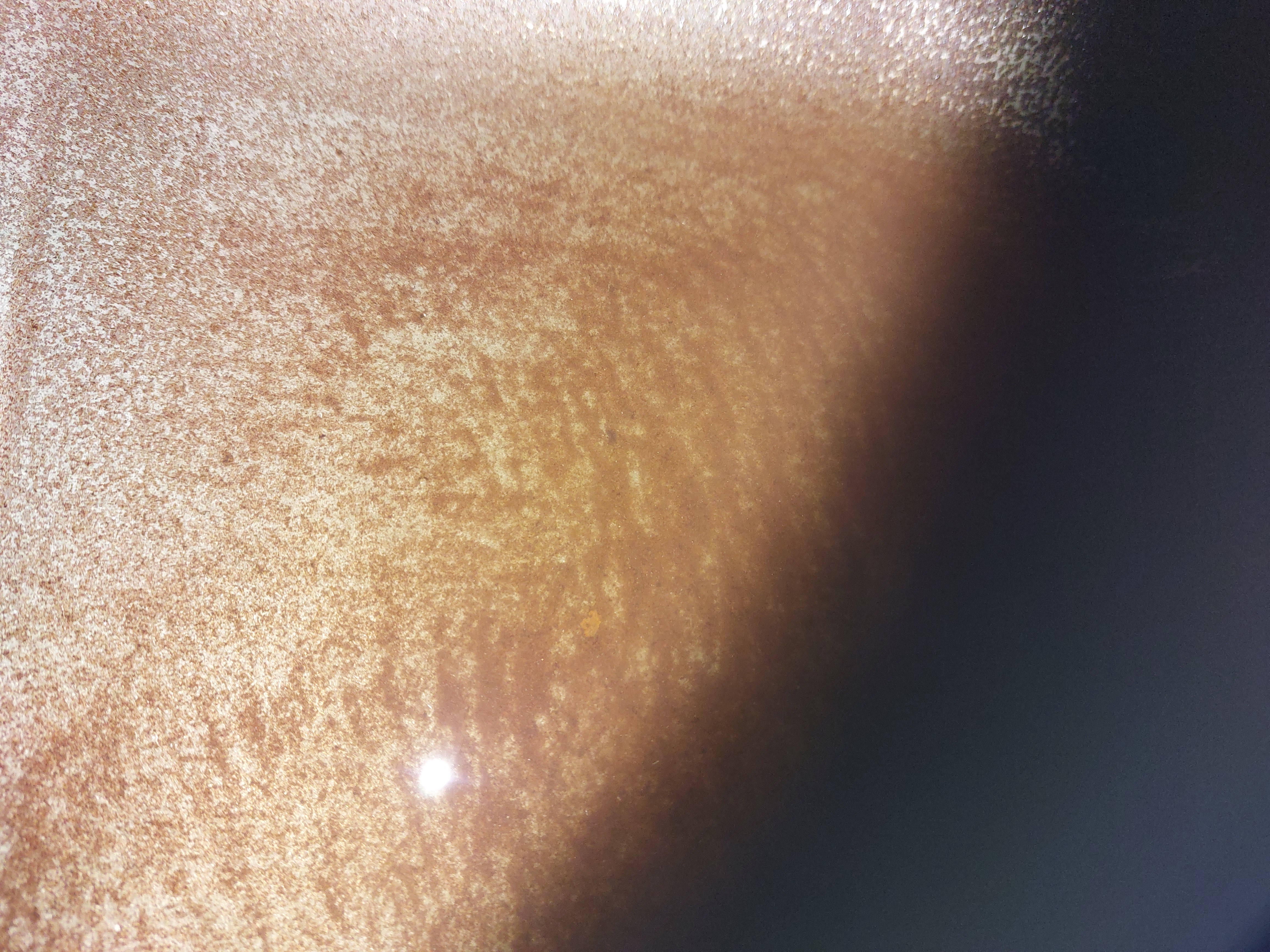

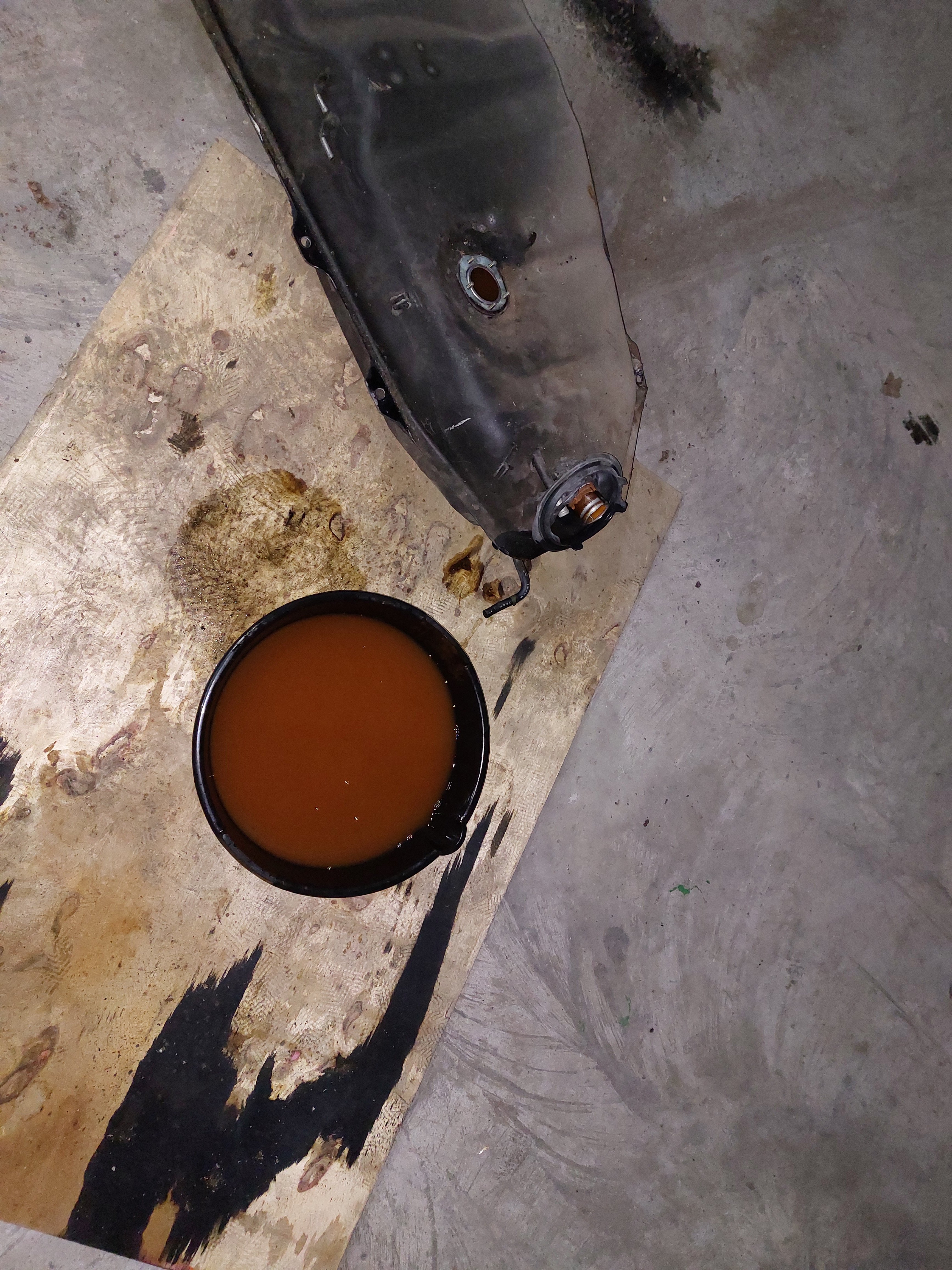

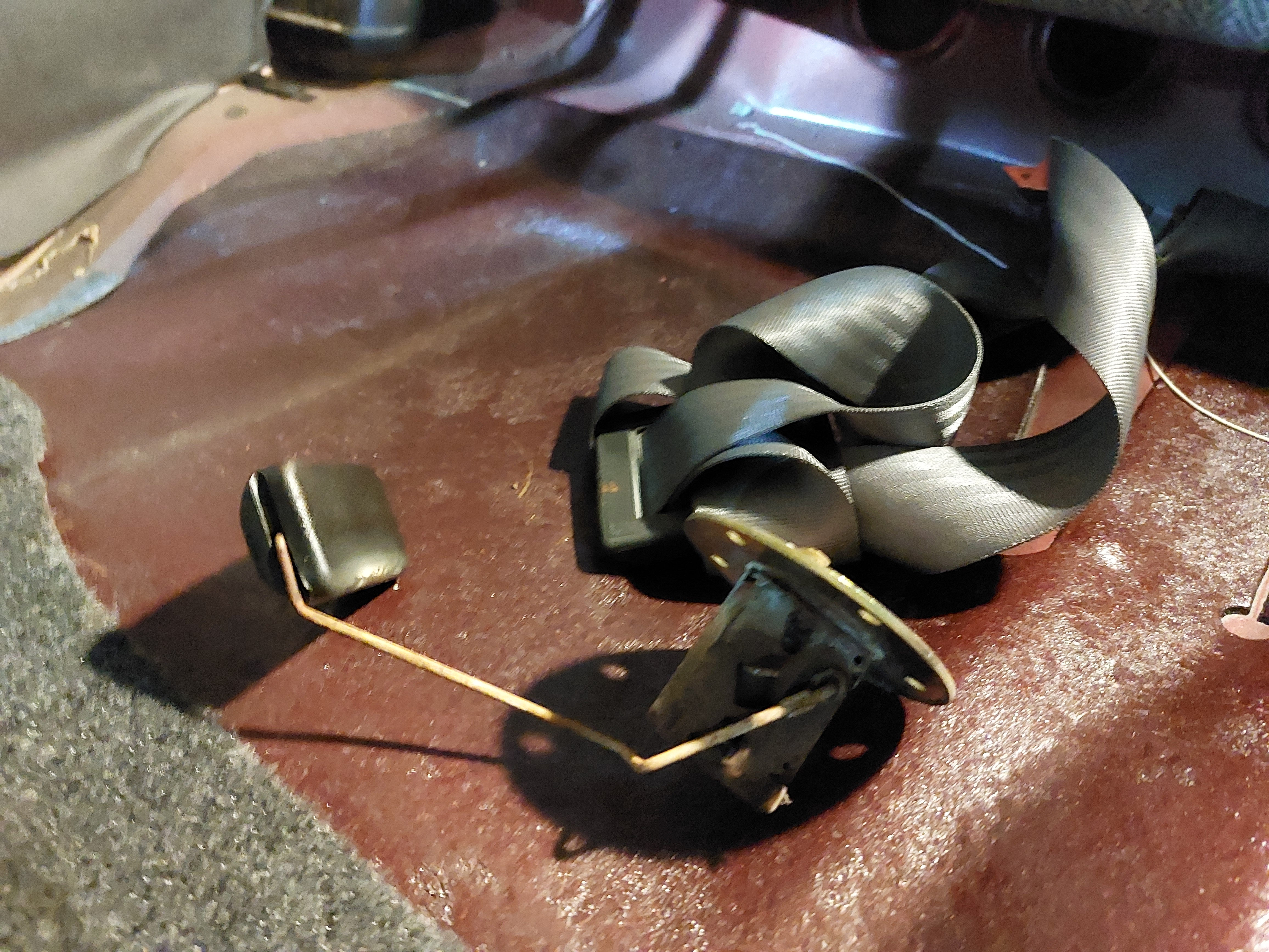

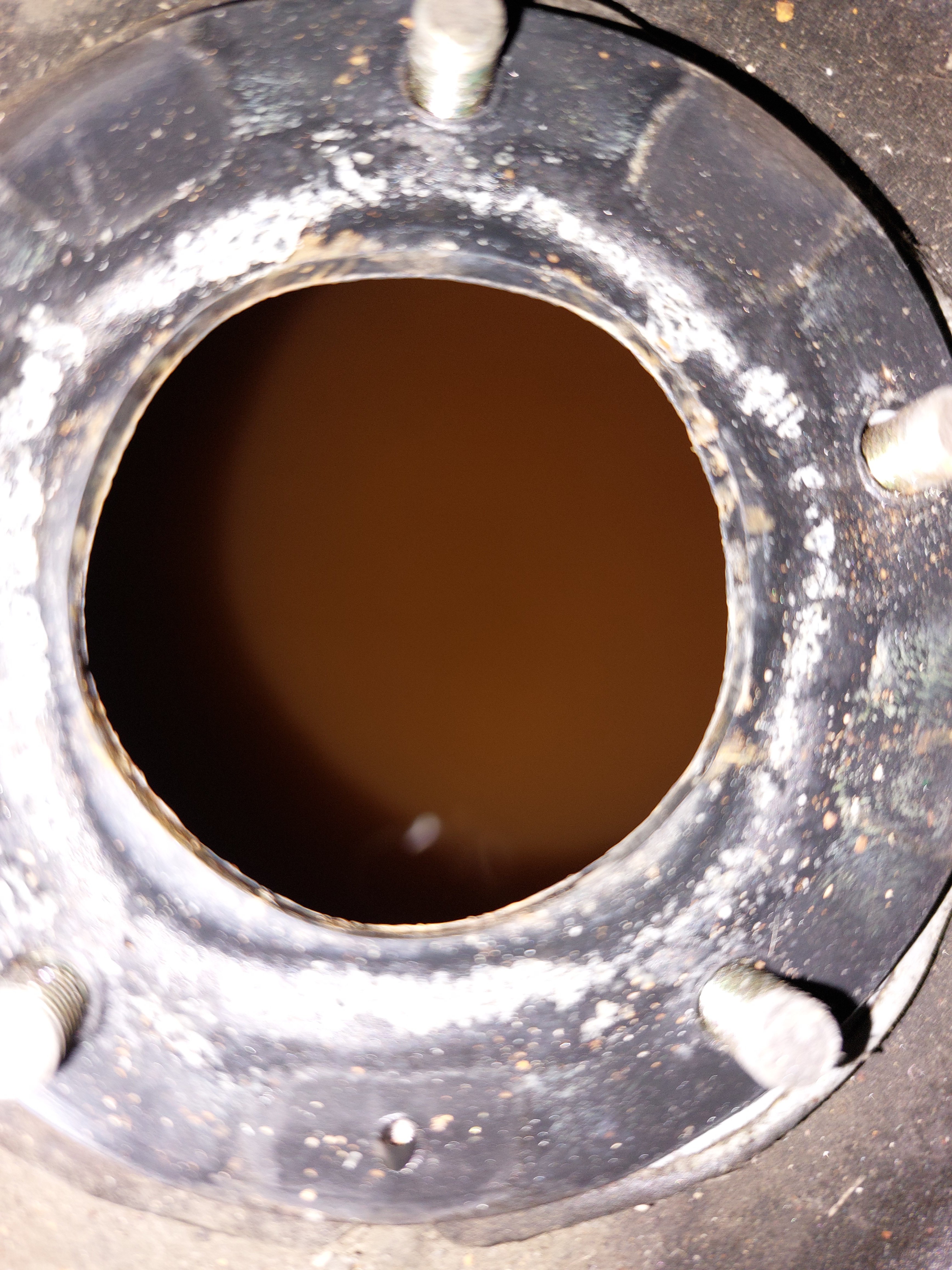

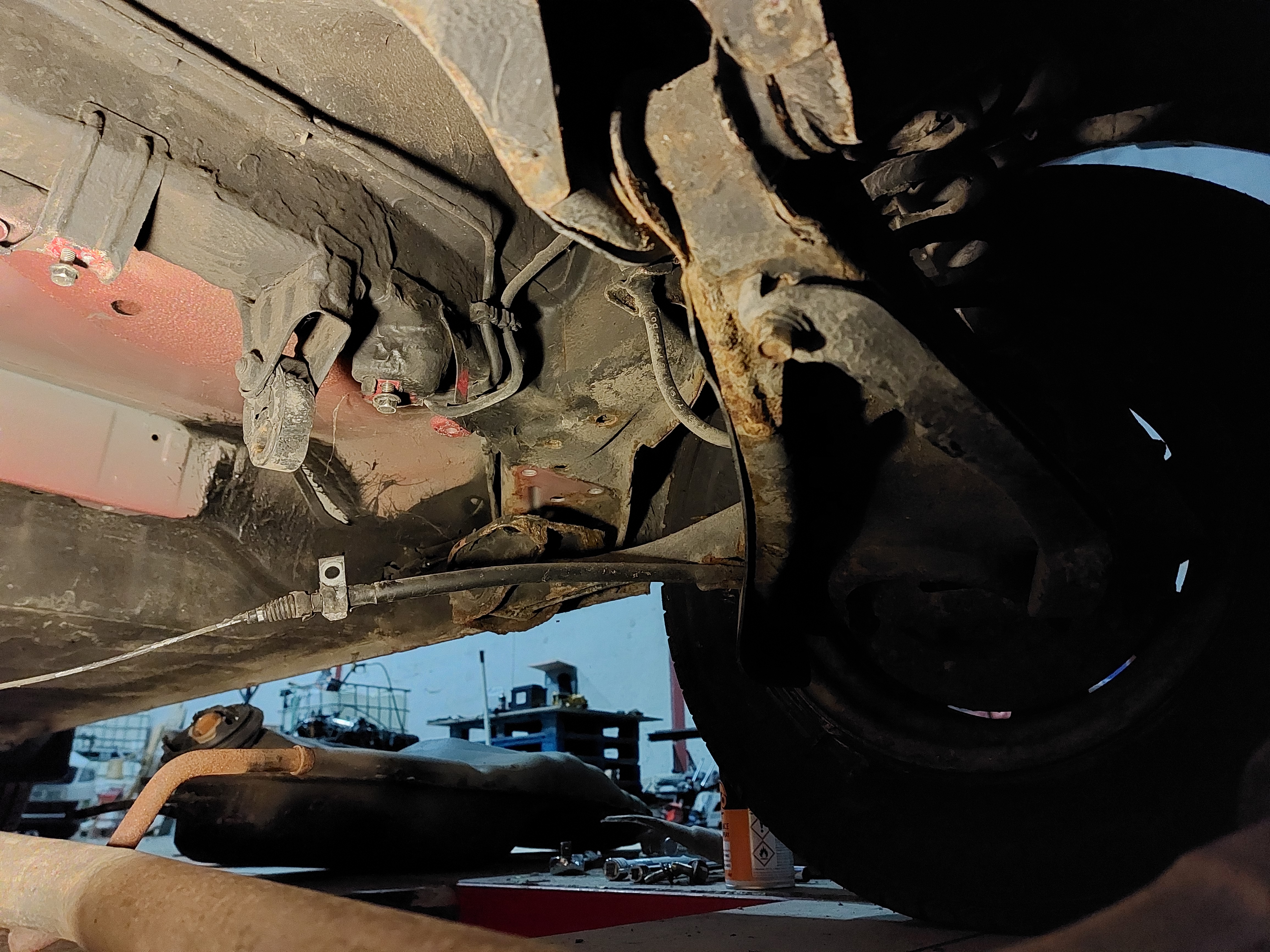

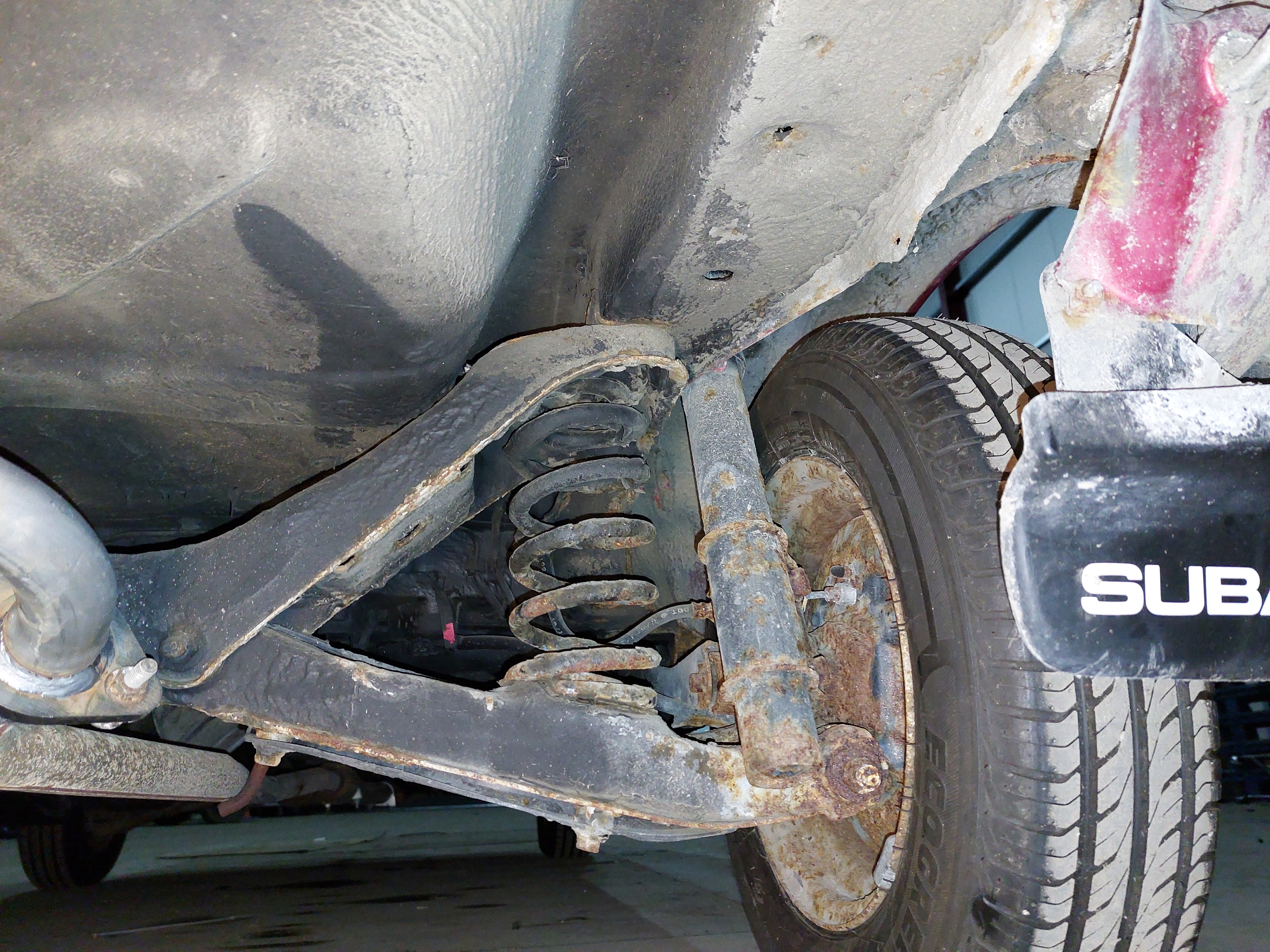

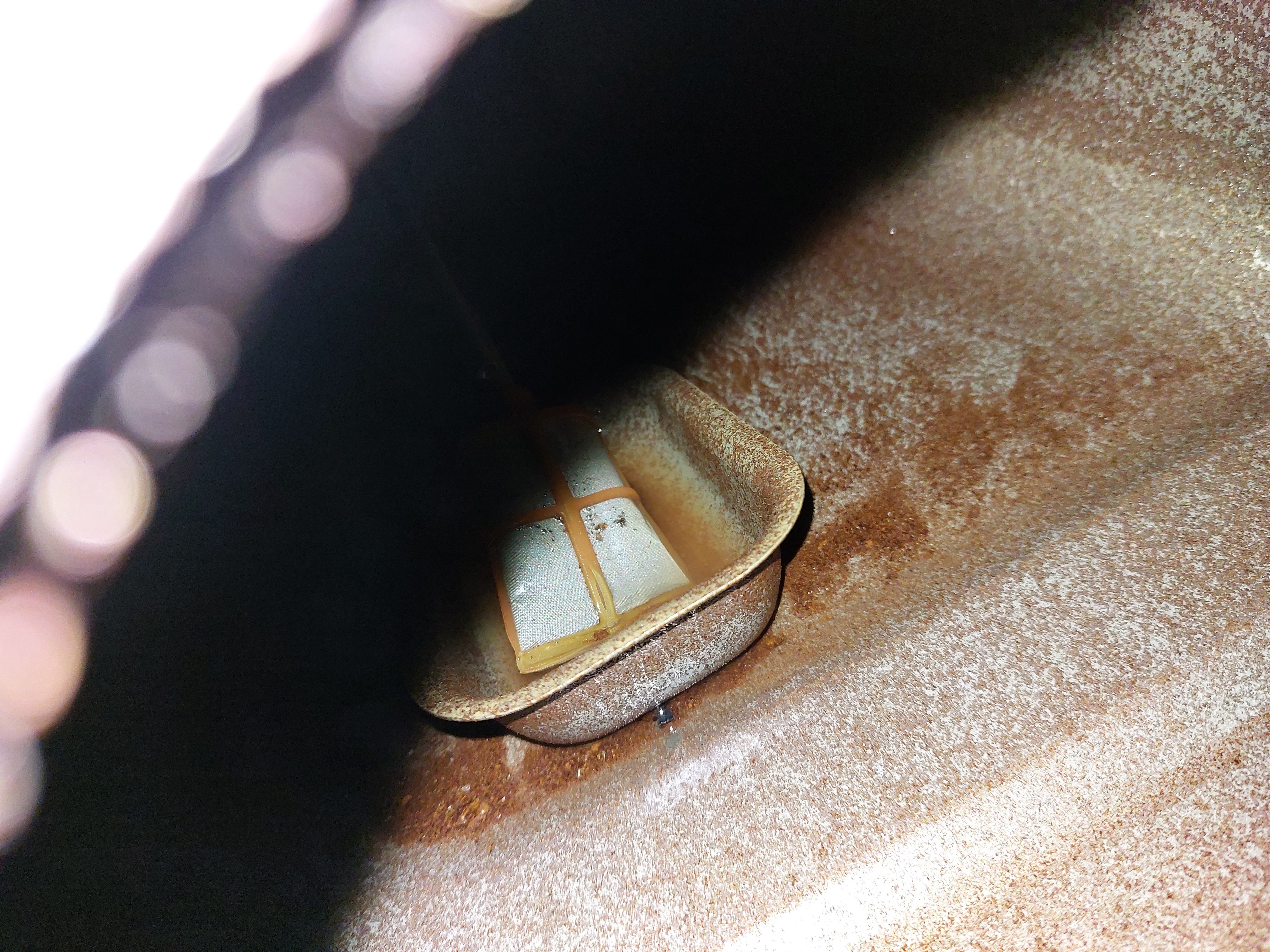

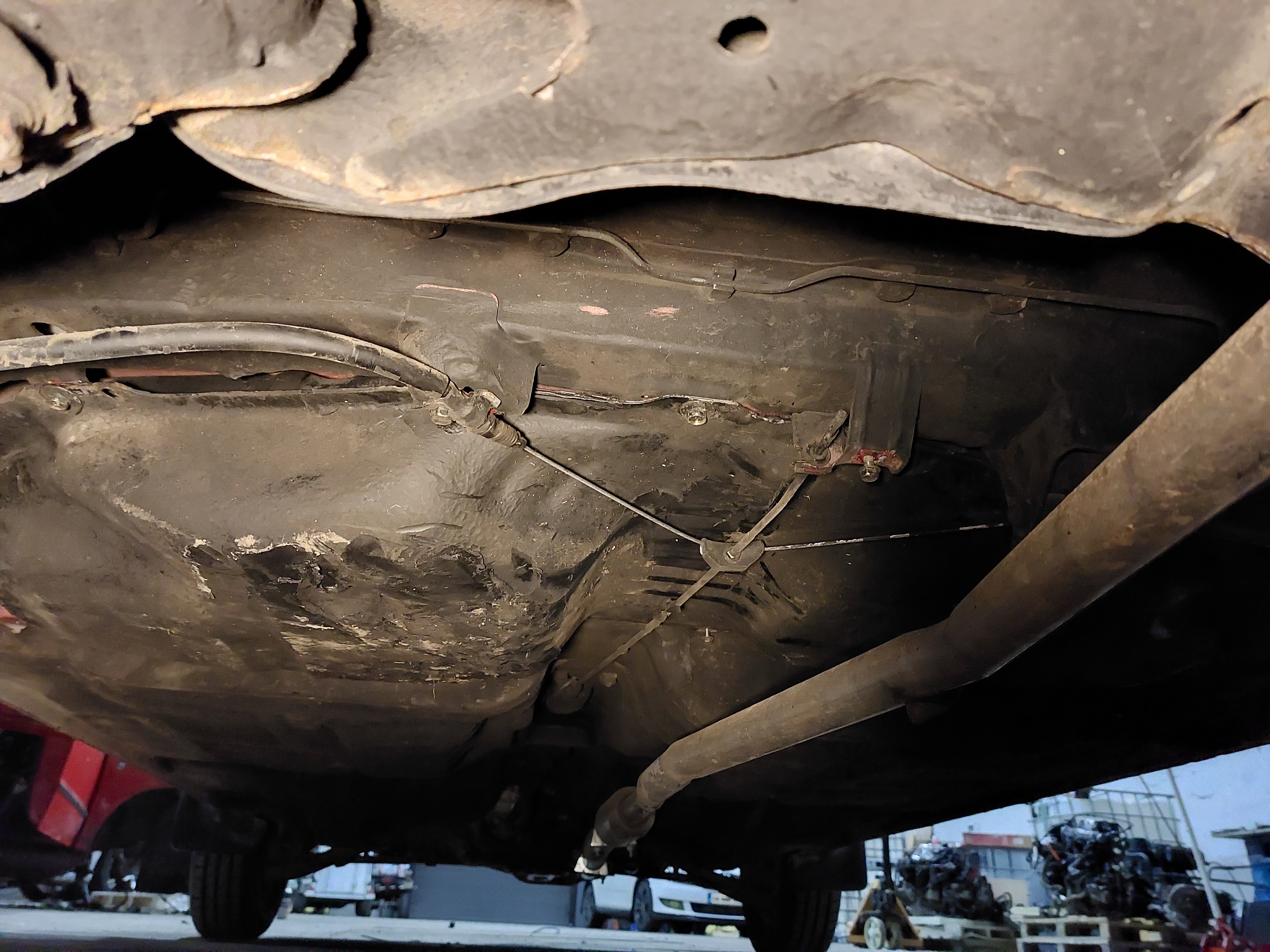

  20. Big job this evening, getting the tank out. First I pulled the sender to check if it could still work Had to remove the backseat which was just 2 bolts. Pic was taken after everything was out. It's rusty as anything and was stuck in place, a little bit of wiggling saw it moving free. Plugged it back in and confirmed it does work perfectly. Then the tank. Was not a fun job but would have been much harder if this was a 4wd one Had to unbolt the trailing arms to let it down, thankfully every bolt came out very easily. A look at the fuel left in the tank, feral. Drained all out and this is what was left It just seems to be surface rust and sediment. Confident this will clean up easily.
  21. Engines out Started disassembling the vrs and noticed oil seeping around the exhaust, and from the looks of it it's recent. So maybe that rebuilt turbos gone bust already, fun

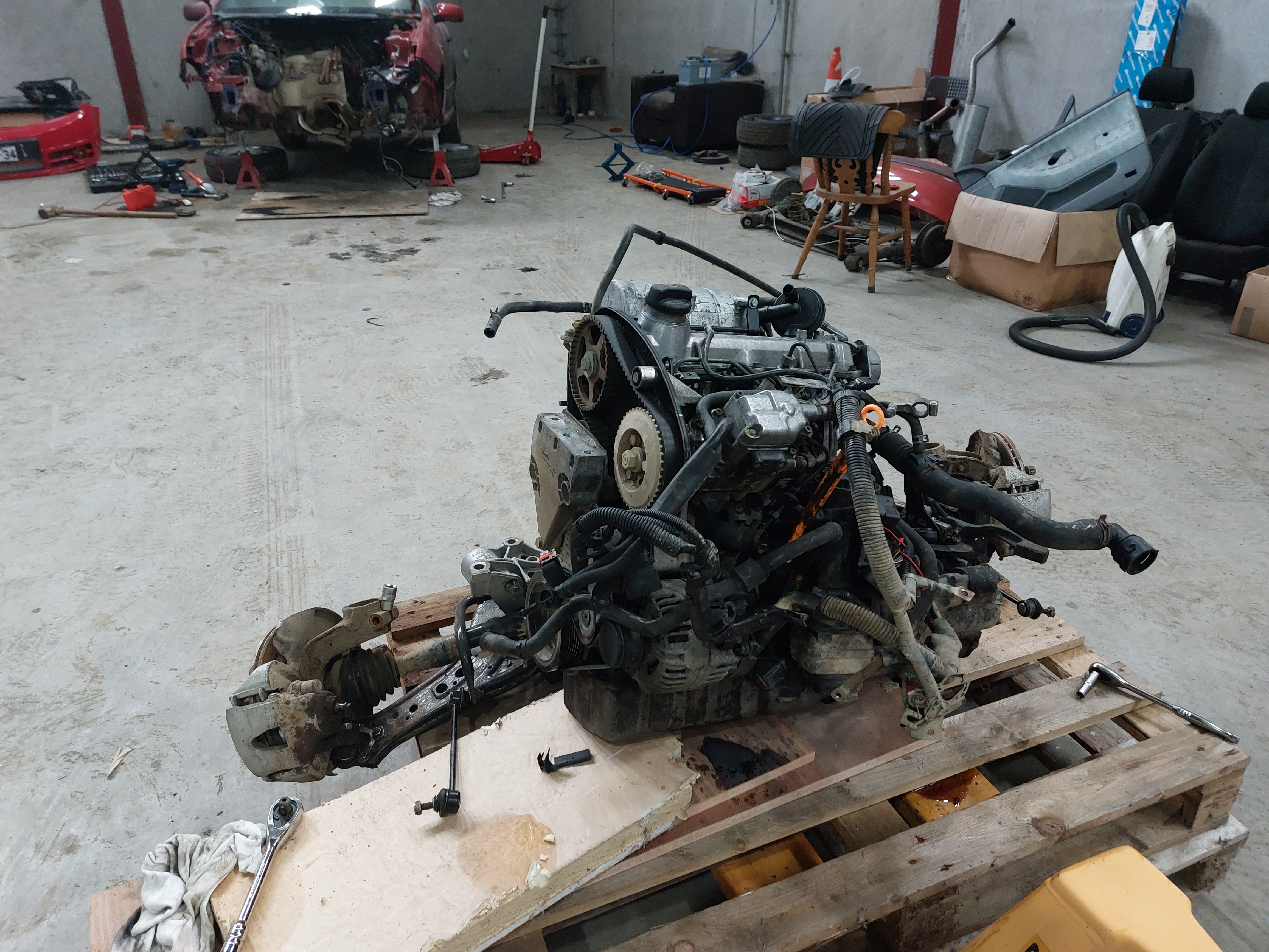

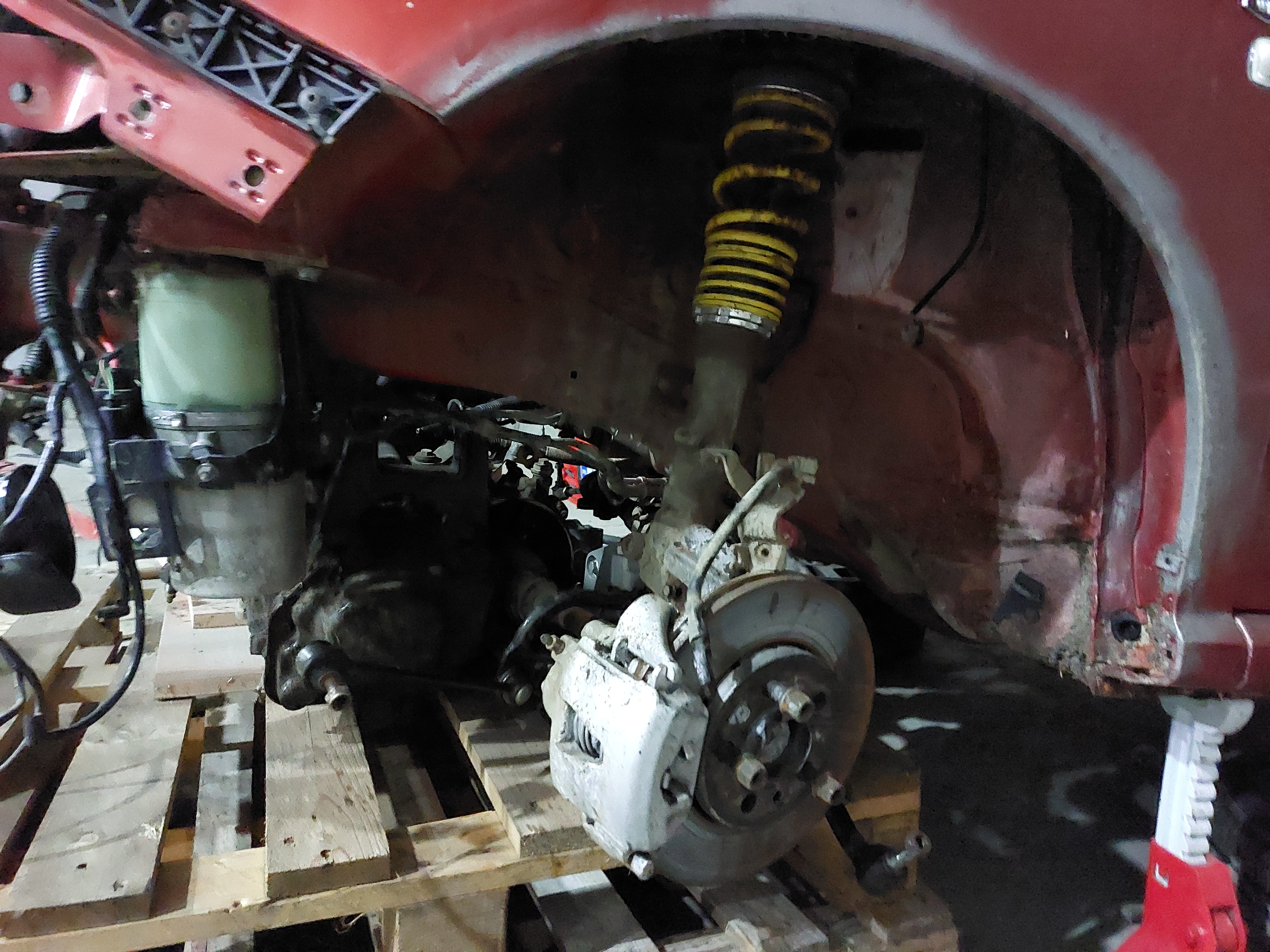

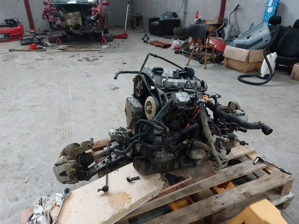

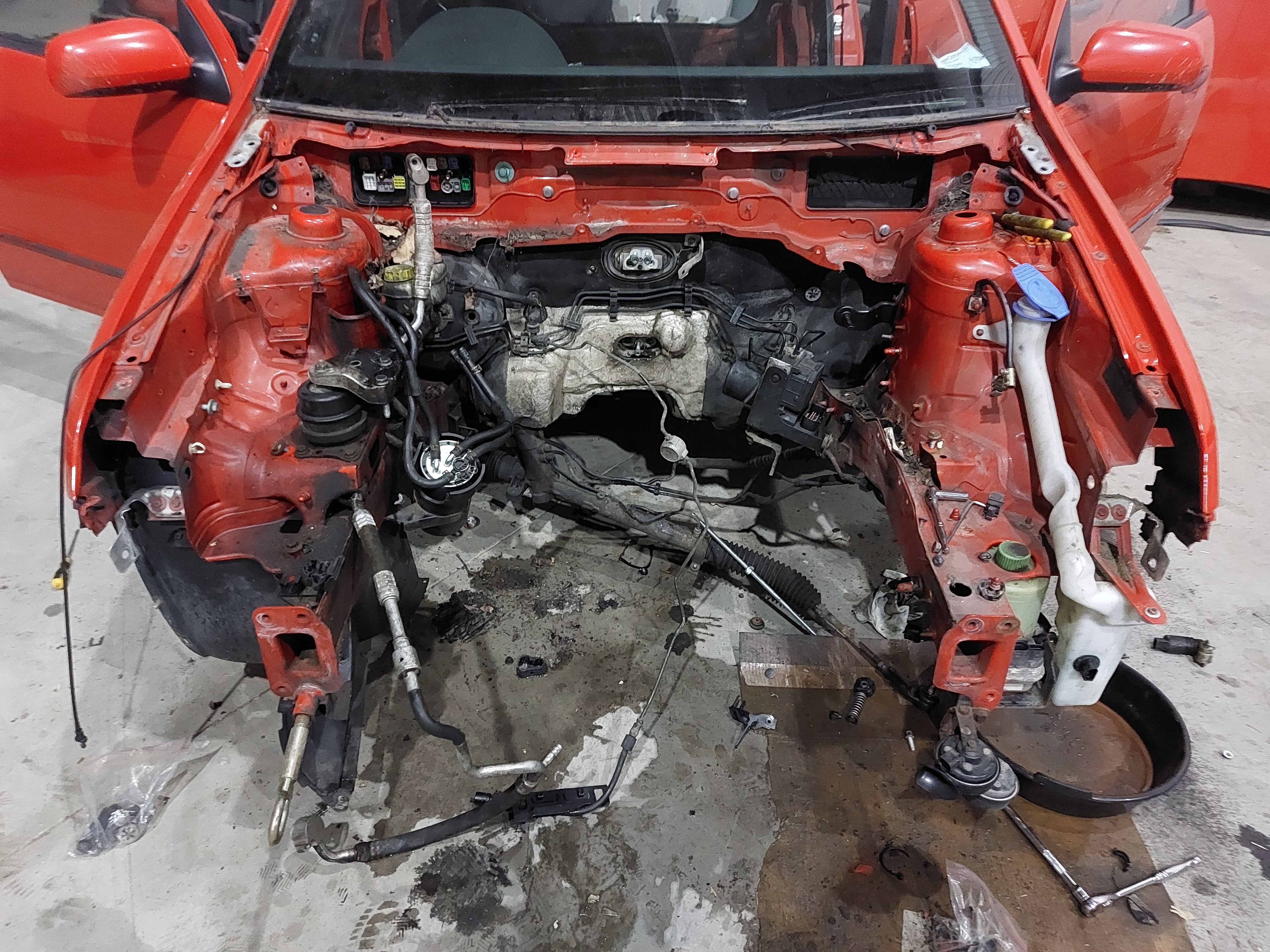

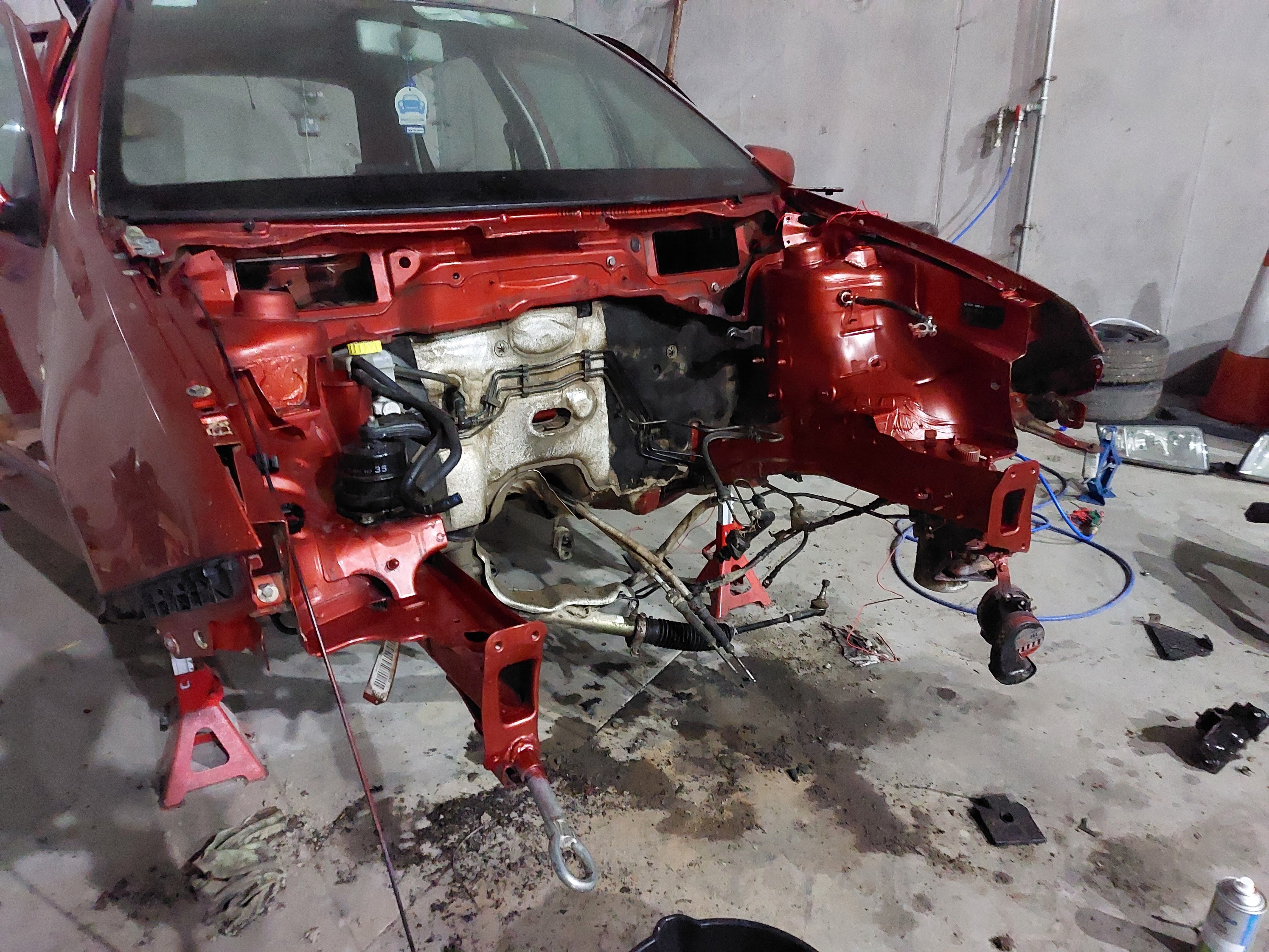

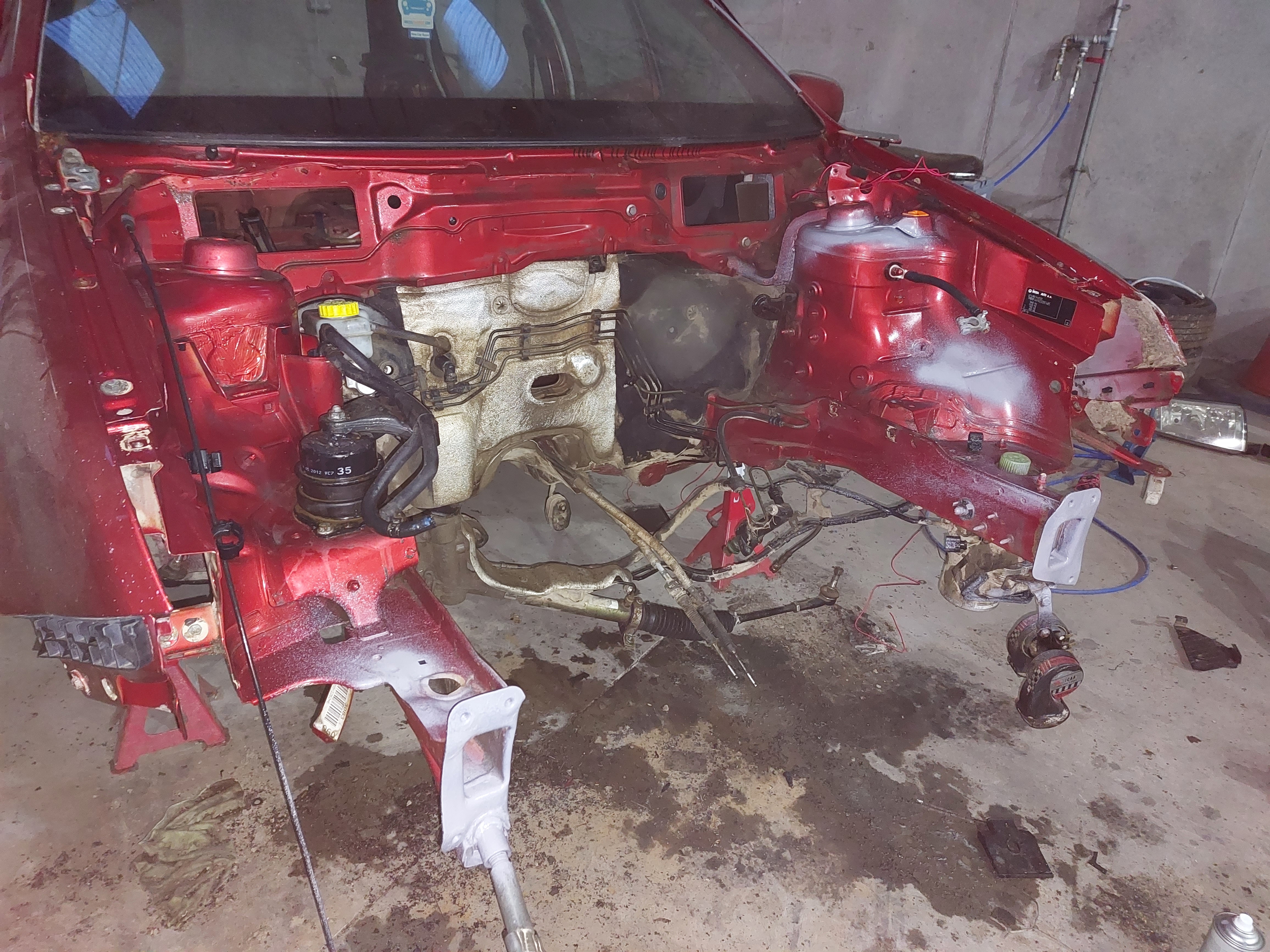

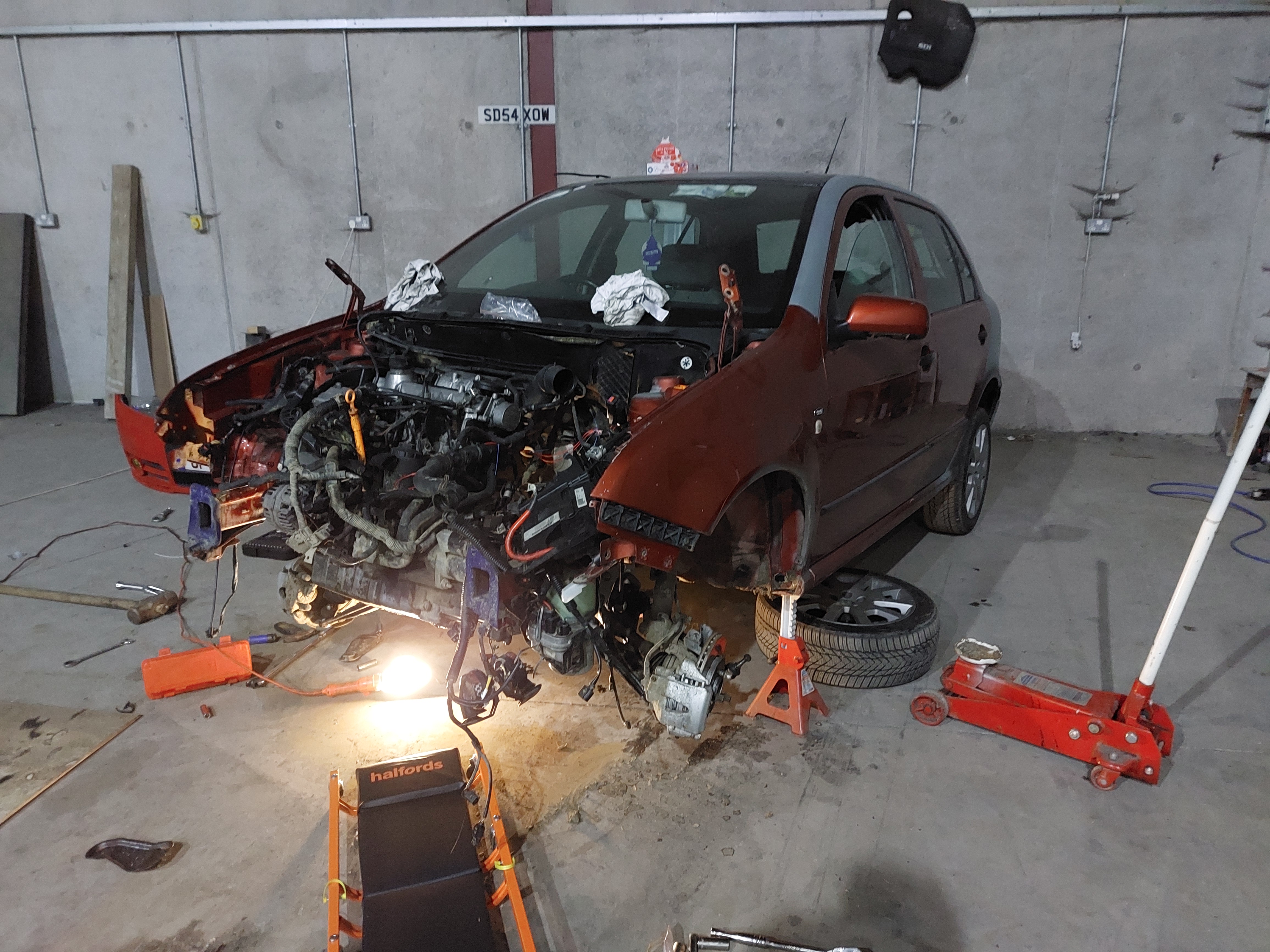

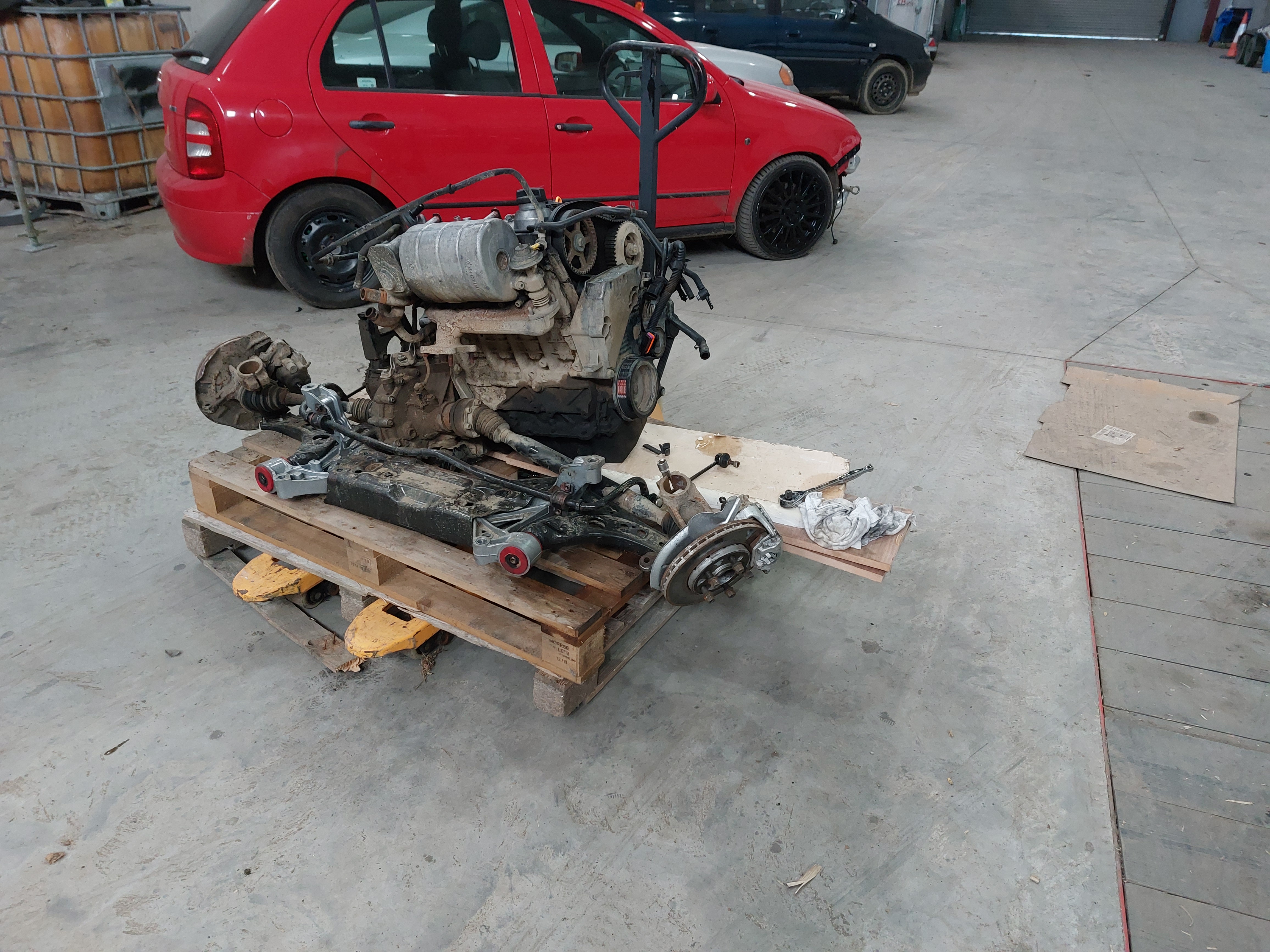

  24. Chipping away bit by bit. Pulled the front end off. Removed the downpipe Then set about freeing the subframe from the car And finally the engine It's sitting on a pallet now It's completely free from the car but the coilovers are getting caught up and that's not letting me pull it all out. Will pull them off next day and see what I've left to do

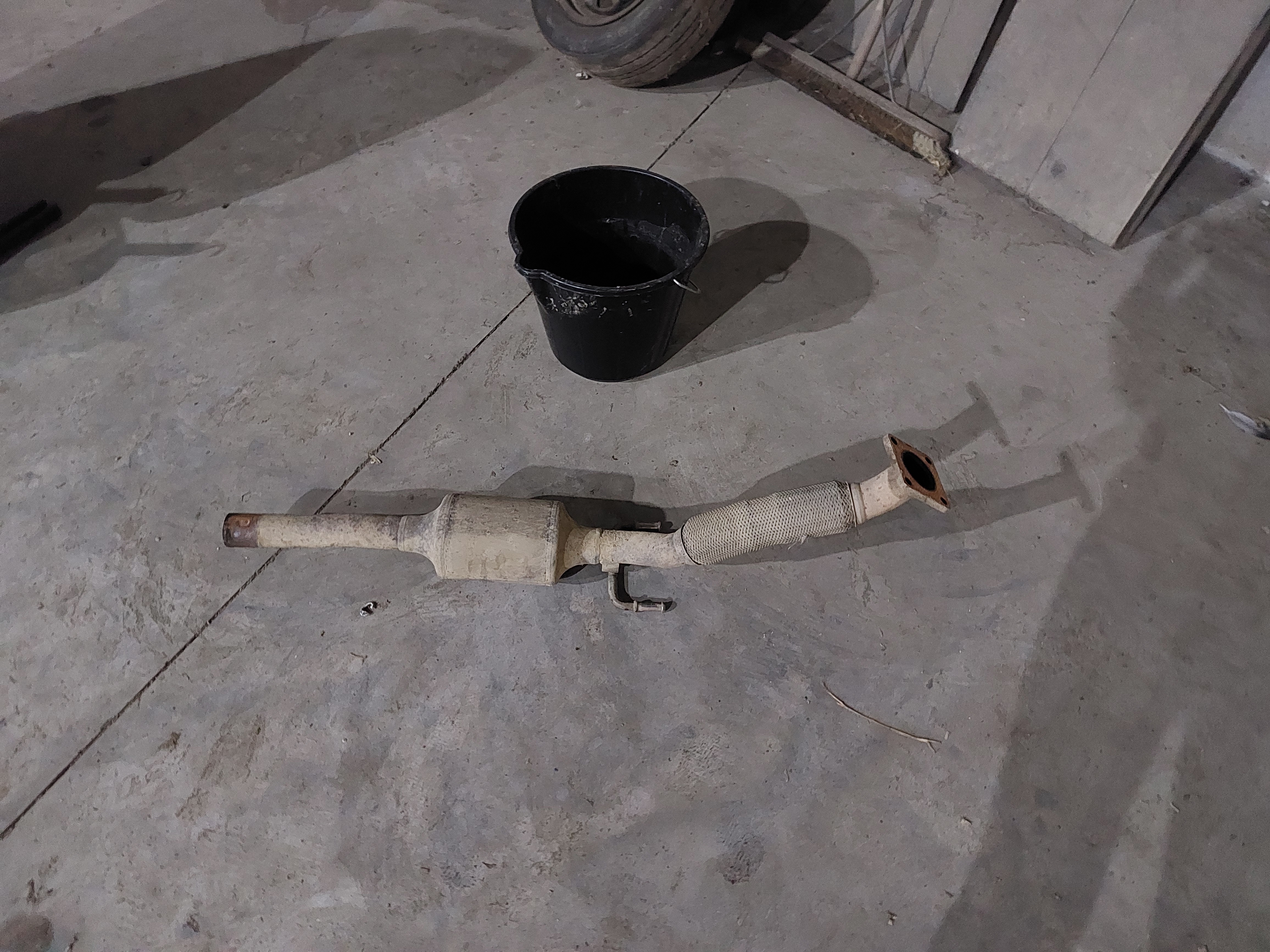

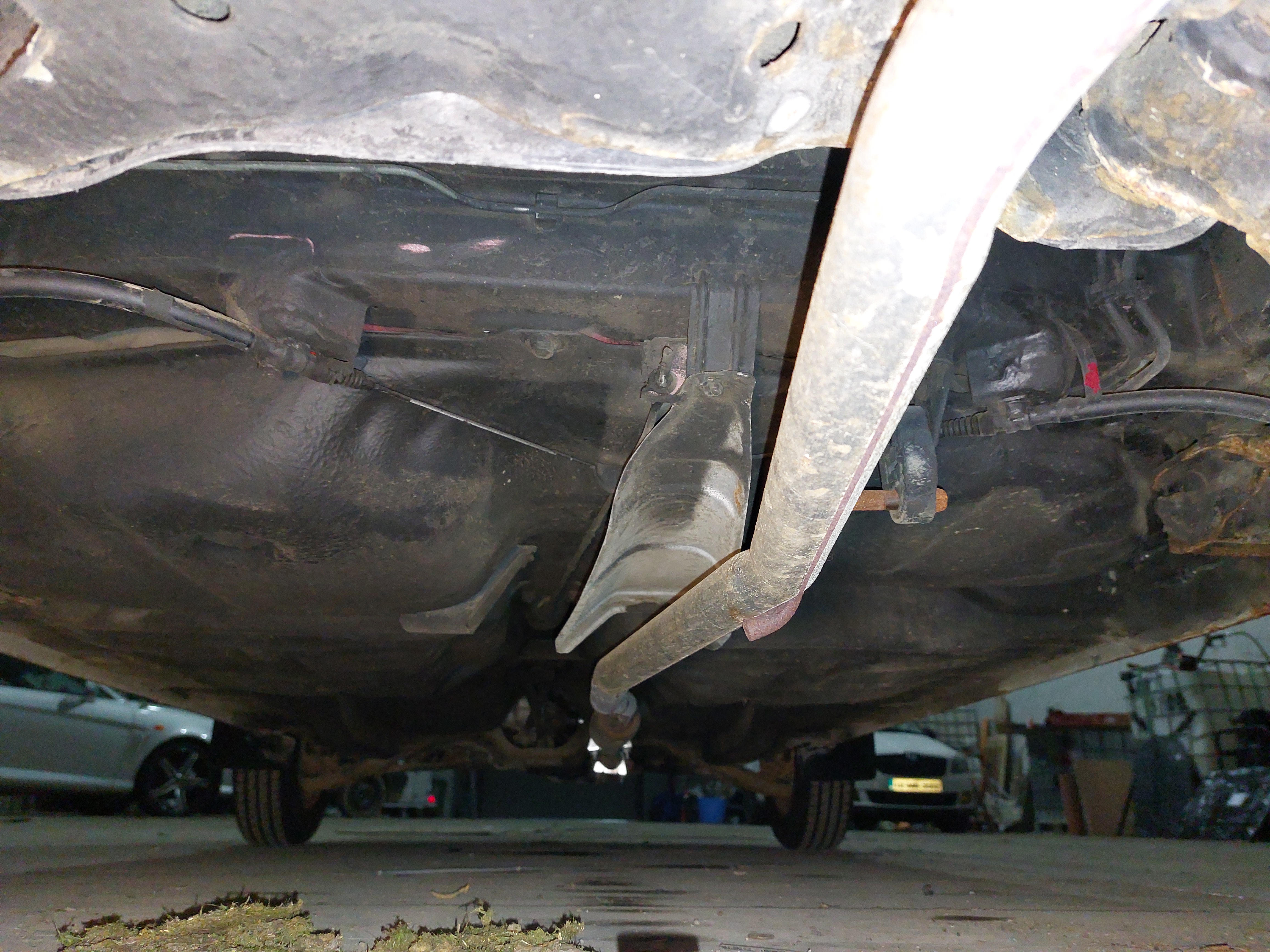

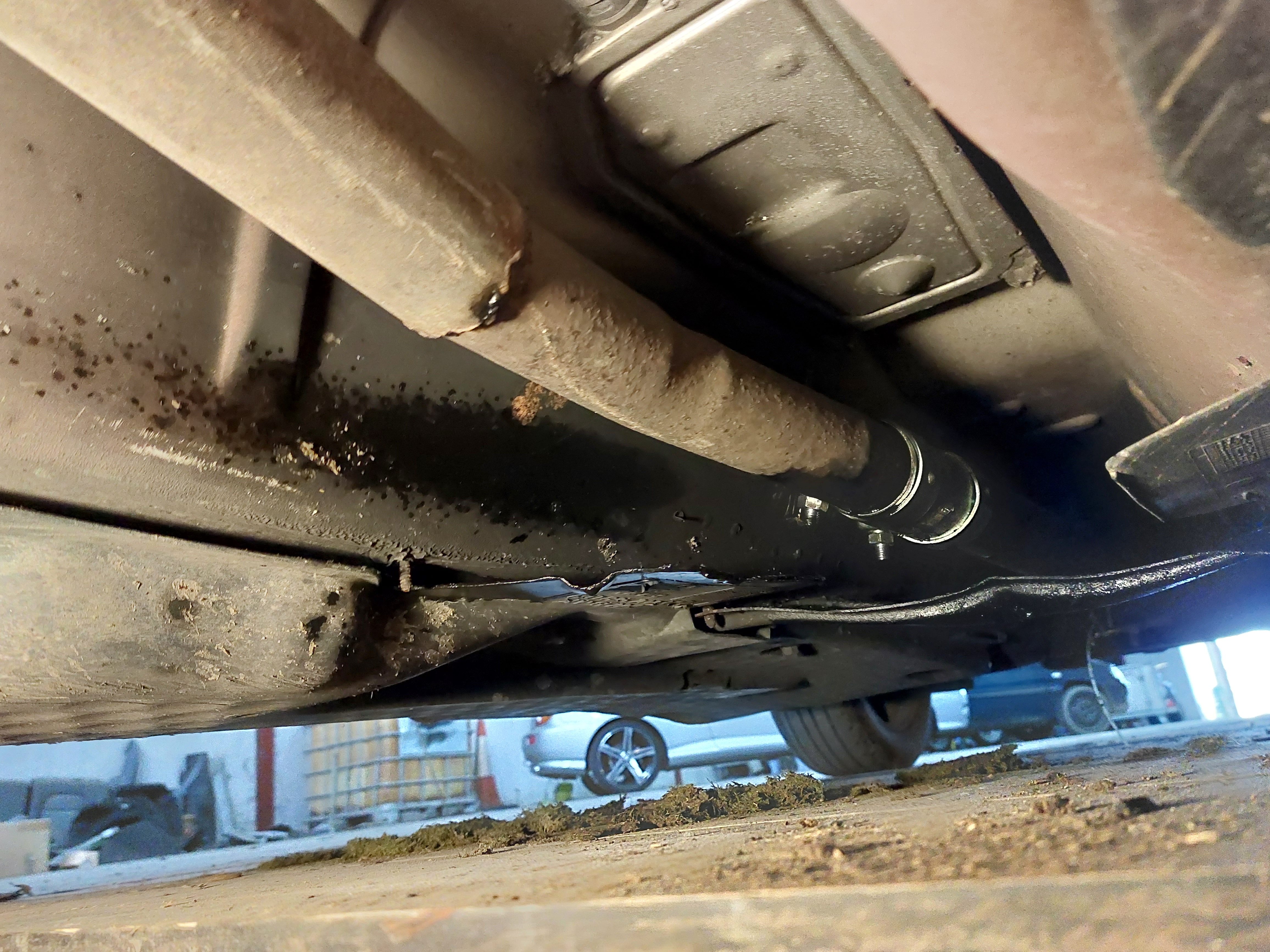

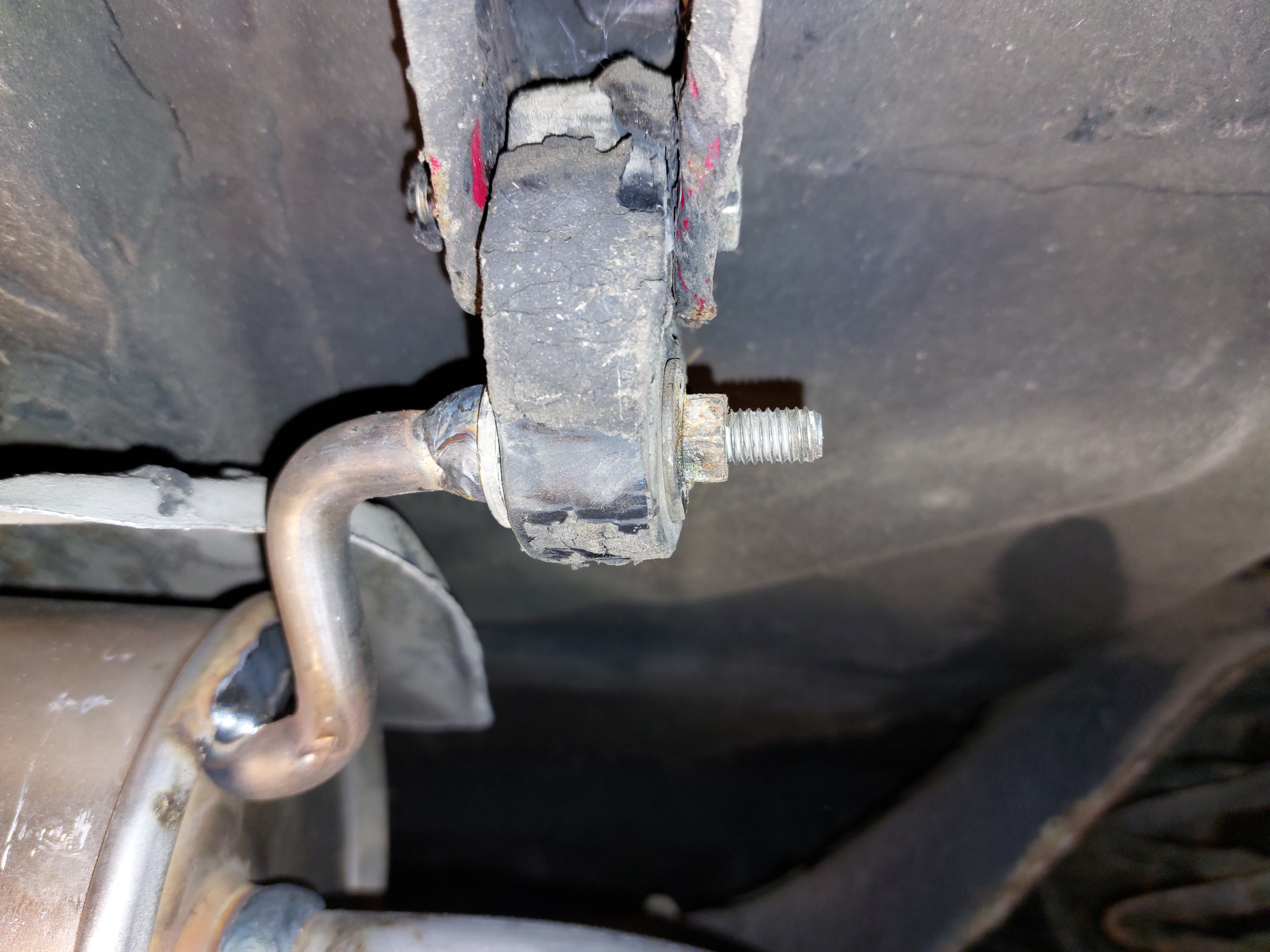

  25. Another nct, another fail Last time it was on the lights being too high, this time it was for the spotlamps not having a fuse. That's it. Free retest and it doesn't need to be booked so I'll wire in a fuse tomorrow and next time I'm near a centre I'll throw it in. Otherwise perfect, everything well within limits. Shocked it passed with the downpipe although I did put some effort into making it harder to spot. Posted it before I think but I got a panel that goes under most newer vws that acts as an extra undertray, sort of. Had it a while but only just got around to trimming it up to make it fit. Made a cardboard template of what Shape I needed to trim it to And voila. Still has a vw part number on it. If you don't look too hard it almost looks standard. Did make it a bit neater after that pic was taken. Was worried about it struggling to pass with all the mods, but it seems I've done well. Not a word was said about any of the mods except for needing to put a fuse onto the spots. It was said to me that one of the balljoints is just starting to wear (and I only replaced them tail end of last summer) but not bad enough to mention on the report. Will order a new pair next time I'm ordering parts.
