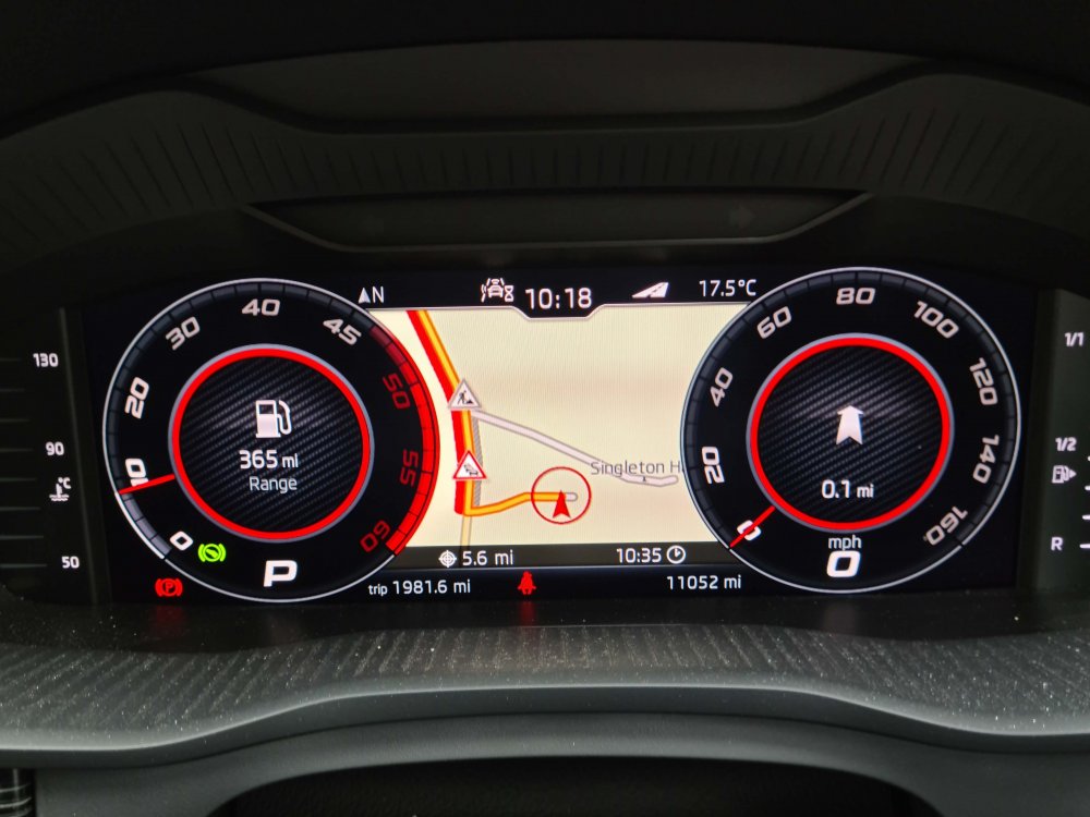

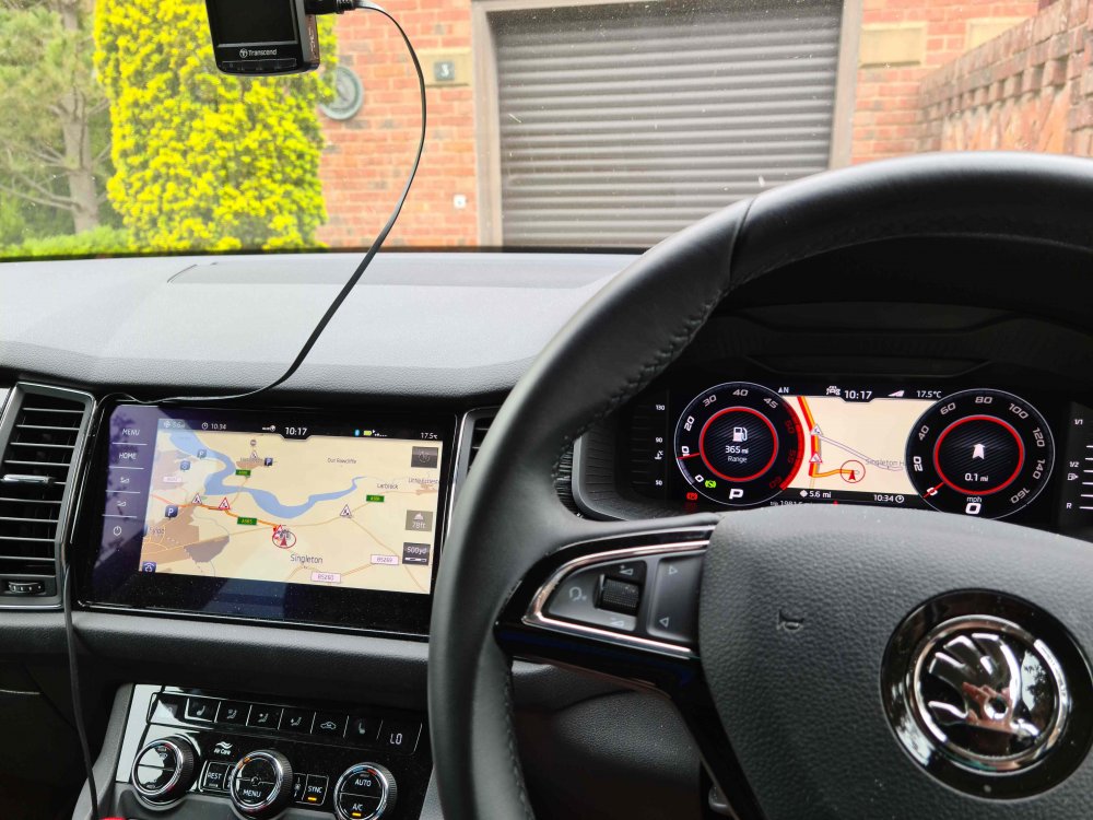

I have the VC and I love it. I played with the various options and finally settled on the setup shown in the photos. I have the two dials showing fuel range and gear (left) with sat nav guidance and speed (right) In the middle I have the map display. I like having the main display in the dash centre set to 500yd resolution (it gives a good overview of the route and potential roadworks, plus view of my chosen POIs) and the VC display set to 100yd (which gives a magnified view useful for complicated junctions). It also shows lane info when leaving/switching motorways). Being right in your eyeline, it's easy to check with a quick flick of the eyes. I had test driven a number of Kodiaqs both with and without VC, and this convinced me it was something I wanted, so it was high on my wish list. I make use of it every day and I'm glad I have it. I have to say that now I've settled on this setup that I really like, I never change it

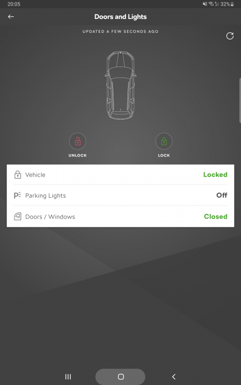

I mean the MySkoda app, not an OBD2 dongle/app. You can check the status of the car (doors, windows, lights) and lock/unlock the car remotely, even sound the horn and flash the lights. Depending on what you can/cannot do via the app, it might help to narrow down the issue.- Driver’s door locks failing to engage with remote (and no, not with the key still in range)
What status does the app say - locked or unlocked? Can you lock/unlock via the app?- Send a journey to a MY21 Kodiak (SEL model)
