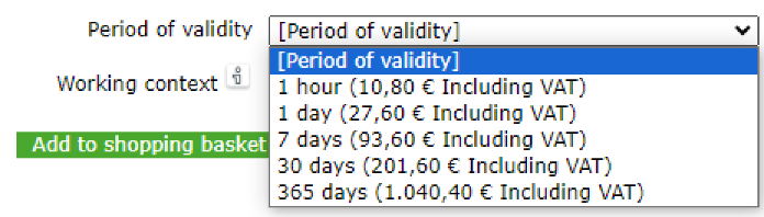

Repair manual sheet is coming from ErWin. You can download all you need after paying subscription. You can choose from:

Yes, you have to create an account and pay a subscription. As far as I am aware, in Erwin you will not find info regarding part numbers. I have no clue about the cost of the parts, sorry.

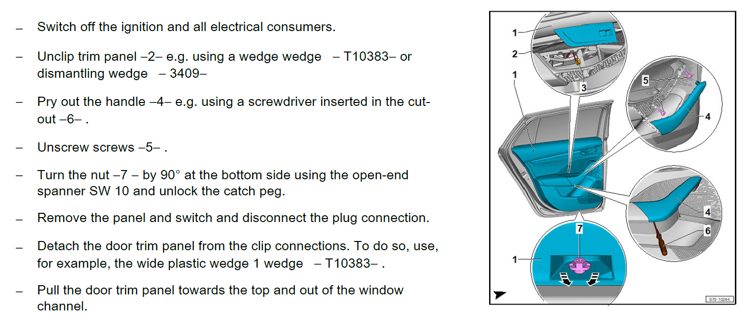

Backseat right door disassemble

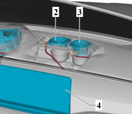

Well, I do not know which is your audio setup, but if it's like mine, without canton and car manufactured from November 2020, I do confirm that, as per wiring diagram, those two speakers are not carrying signal from the center unit.
Has anyone been hearing an annoying buzzing sounds coming from the dashboard area in your Skoda Octavia VRS 2022 MODEL, while driving in the normal and sports mode?
Screenshot is coming from the official maintenance manual that you can find in ErWin (https://erwin.skoda-auto.cz/erwin/showHome.do). With your VIN there you will find all that you need for your car in terms of maintenance and general TPIs. In top of ErWin, you can use as well Partslink24 (https://www.partslink24.com/partslink24/user/login.do) to search for replacement parts. Unfortunately, both are pay per use. And for @Dooge under that perforated panel you have 2 speakers, one for the soundaktor and the other for the SOS assistance.

Hi Sajan, Your issue is coming from the central speaker (2): From factory it was not properly fixed, so under certain circumstances it moves on its housing and it does that particular noise. It's an easy thing to be fixed, just remove the speaker panel carefully and remove, clean surfaces and install again the central speaker.

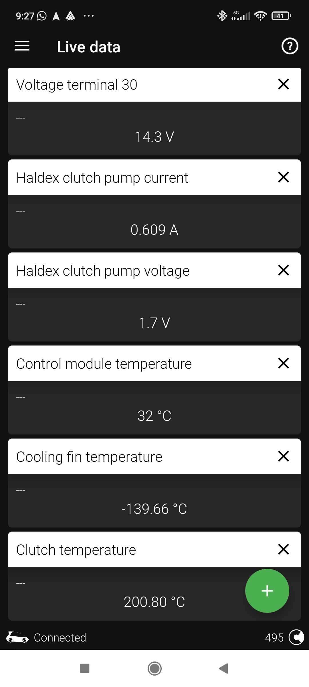

Well ... I have all I need to do the change, hopefully I will have time enough next week to perform the service. Just one curious thing, when reading live data from control unit 32 Lock Electronics I have this: Control module temperature is coherent with the environment when I did the test ... but take a look to cooling fin temperature and clutch temperature, on the paper both are intended to be quite close to the control module temperature but ... wow, those values are completely out of range. I do not see any fault on the control unit so I guess it's working as expected.
