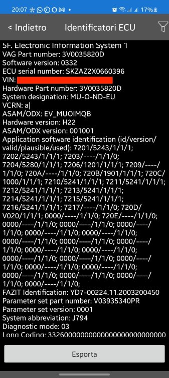

  2. Here's a little update. I updated from 330 to 332 and no longer had the navigation system (the function was unavailable). I applied a patch provided by drive2.ru that essentially reactivates the FEC/SWAP by connecting them to your VCRN ID, but it didn't work (the patch is applied correctly because an OK file is returned on the USB stick). Then I read in some threads that someone had solved the navigation system activation simply by activating the off-road menu via car scanner. So I tried, and once I gave it the OK, the function appeared on the phone, as well as a sport menu (the off-road menu, for some reason, doesn't appear). The only downside: when the navigation system wasn't active, the air temperature indicator was present in the center of the maxidot display. Now it's back to the right, and it disappears every time you activate eco mode, which is when my 1.5 TSI is running on two cylinders. I don't know if there's a way to move it back, but it was really convenient. Anyway, apart from that, I haven't seen any improvements. PS I saw that the OCU version can be viewed via carscanner in the ECU information of the communication module, and in my case it's 143, so it's up to date.

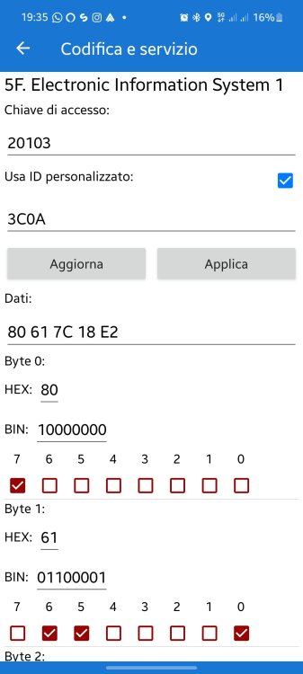

  3. Following this guide, which is the same one found on the Russian site, I can confirm that with the 3C0A code it actually displayed a hex code, which should be my VCRN, after giving me an error ("impossible to apply the command"). The Russian site also says that after setting 3C0A, the VCRN also appears in the ECU Information section of module 5F, but I always see only "a|." The only thing I didn't do was set ATST to "16," but I don't know if that changes anything; from what I understand, it's something you need to do if the first attempt fails. If everything is correct and that's my code, I'd say I can replace it in full.bin and flash. Question: Can I see the OCU version with Carscanner? Because following a problem with the SOS control unit, they updated my OCU in September 2024, but what I see from the engineering menu is only that OCU3_5WA035284B_ was installed but it doesn't say the version. If I click on the various items for that update it says successfully update from 1.48.0 to 101.48.0 or 101.49.0 but I don't think that's the version I'm reading here.
  4. Did you mean this Mega? Unfortunately, I don't have Odis or OBD11, but I do have Carscanner with ELM. I can try resetting the infotainment system (I'm not sure if I can do it from the screen or by removing the fuse, which should be #12). On drive.ru, I found some topics about a patch that seems to fix the issue and that would work with Carscanner without Odis. I'm sharing it for anyone who might need it, since an ELM dongle is available for a small price: https://www.drive2.ru/b/695890531019930453/ This is exactly my case: FEC/SWaP present but with wrond VCRN number. Basically, you just need to find your VCRN number, replace it with a hex code, and flash it with USB. I'm not sure whether to risk trying the patch; maybe it's better to reset the radio first. Because, again, it's strange. I have the navigation system as standard, and if I look at the FEC/SWaP codes, I see the navigation code, but if I open the details, it shows up as VCRN 1234, which is obviously wrong. And if I go to the dealership, they'll definitely charge me for a realignment.

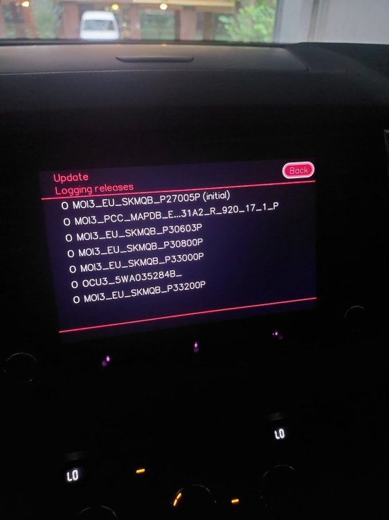

  11. The problem I think is that you updated from 0306 to 0324. While to update to 0324 or 0330 you must first install 0308. Then, once done you must clean the error 1555/B201A with an OBD interface (Obdeleven, Carscanner, VCDS etc)

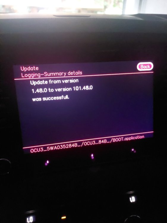

  15. it's right. you cannot update from 306 to 330 (or 324). You must update to 308 and then to 324 or 330. I had 306 on my Karoq, and I installed 308 and then 330. After the last update you need to fix 1555 error (not shown on the monitor but only via obd2)

  19. Just updated to 308. After pushing resume the screen is black. I have to turn on the infotainment or just wait? How much?

  21. Just a question: if I upgrade from 306 to 308 and then to 330, I need to clear 1555/B201A every time or I can clear it only at the end of the update to 330?
