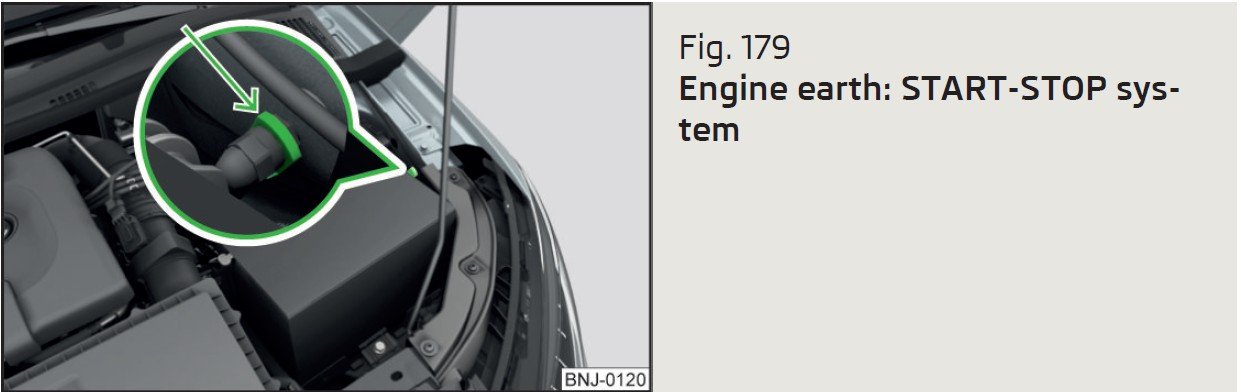

  15. Quick thoughts. Did you test the alternator? DId you clean the battery terminal clamps inside and out before fitting them to the new battery? Have you checked the battery post clamps are securely fitted to the battery posts? Did you check the main battery cable connections are clean, secure and protected both ends? Did you check the new battery voltage before you fitted it to your car? Did you fully charge (to 100%) the new battery before fitting it to the car? Is your OBDEleven Pro fully updated for its programs? Have you checked the coding with your OBDEleven Pro? Have you checked for error codes? The engine should start well with a new battery but will start even with an old battery that is in a low state of charge, do you think you might have some elctrical drain, have you left some car setting on which might drain the battery, far too much potential for this on some Superbs with all the extras, "aids", "assists", conveniences, etc., etc.. If you were accelorating why was the battery showing as discharging what electrical loads were on at the time? When did you get the 12.7v reading after stopping, was that very soon after or many hours later? Try fully recharging the battery (to 100%) with an appropriate battery charger maintainer following the instructions for the charger and the instructions in the car's 'Owner's Manual'. This may take many hours from 11.4v. Then disconnect the stop/start battery monitoring whilst you investigate this. Have you tested the alternator? That's enough for now, no doubt others will have other and perhaps better ideas.
  16. I was thinking of a plain hole and clamping it with nut and washers if it's only for battery charging. If you want the thread size surely its standard micktrick thread and not one of the other two and a resourcefull chap like yourself has stock of micktrick nuts, bolts (probably in the three threads) and washers (I only have stocks of imperial really). I've just tried a spanner on the domenut and its 13mm spanner so accourding to my homemade table (not wood or metal) that usually means a M8 thread.
  17. See my previous post. That 'book' earth connection is fine for battery chargibg, your not trying to jump start the car with it, bit fiddly yes, and why on earth a bracket connector post isn't is strange but the German engineers are supposed to know best. 😄
  18. Yeah fine. as long a the crocodile clip had a good firm connection throughout charging. It's not the washer its the end connector of the main earth cable from the battery to the car's body. I've done preventative charges to my wife's car's battery like that for the past 4(?) years. That is the earth piont as shown in the car's 'Owner's Manual@ (you are reading and refering to the 'Owner's Manual' I hope, if you do then you can know more about the car than many long term owners). In your photo I'm not sure why that bracket wasn't made into the earth connector for battery charging, when I saw your photo I thought I've never notoiced that bracket(?) before and went and had a look at my wife's car and on her car that bracket(?) is painted but that may not be correct or factory original to be painted(?).

  25. Very good piont. I forgot about as I'm so used to avoiding this on my wife's Fabia. The bonnet opening cable can get in the way of being able to see the earth cable strap ring under the painted nut and does get in the way a bit for connecting the charger's negative cable crocodile clip so as well as making sure the clip is actually on the negative cable end you also need to be sure the clip connection is secure and stable. This is very easy to do, getting the positive clip on the positive terminal clamp or its nut can sometimes be a bit more fiddly but again not difficult to do. As with all electrical connections you want them clean, secure and protected (clips have covers).
