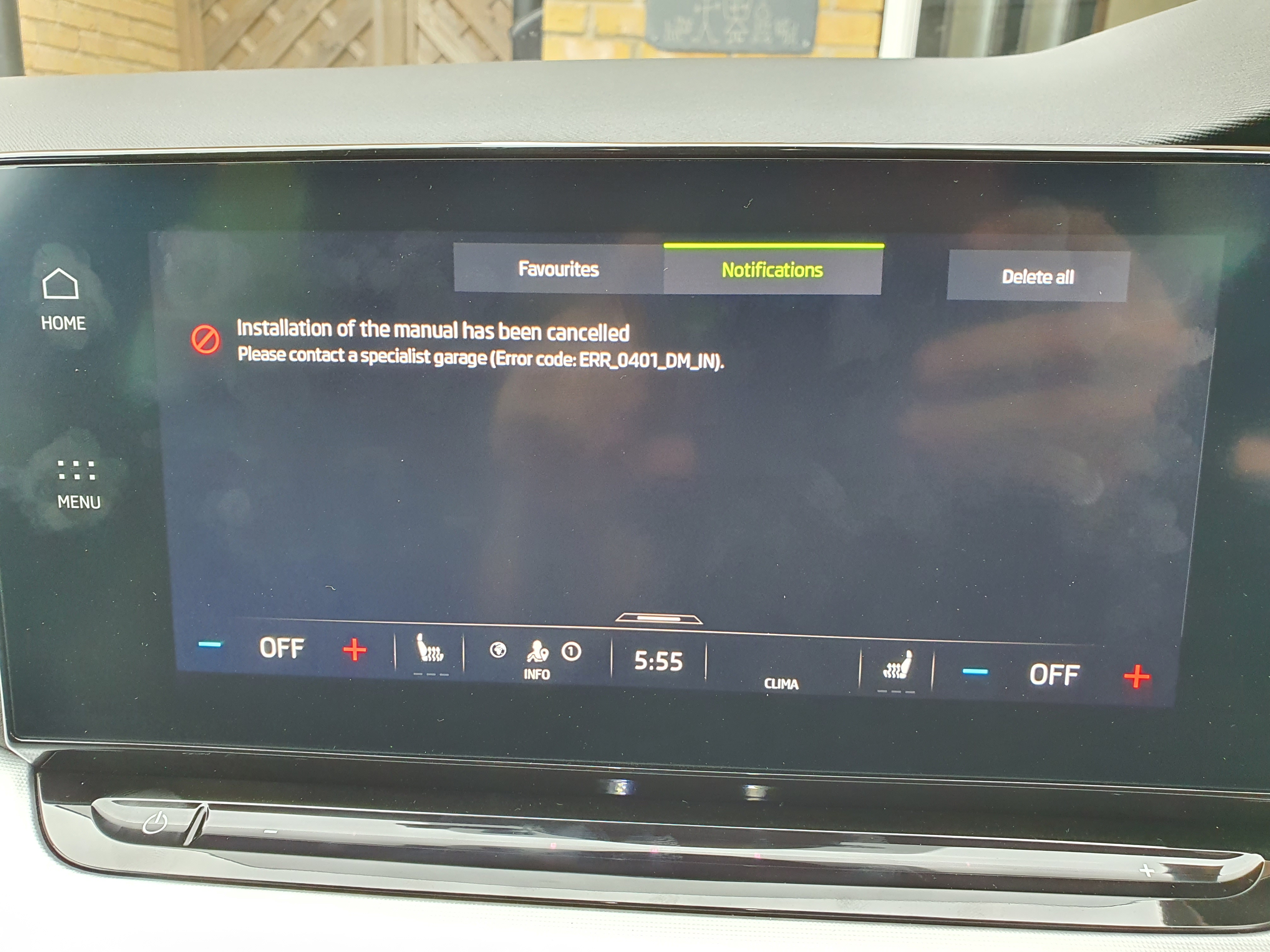

App/online portal not updating
I've fixed this now, pulling a couple of fuses and rebooting the infotainment system did the job.
The only world I can see is in the bottom centre, it's slightly greyed out and I get the following error every time I start the car
