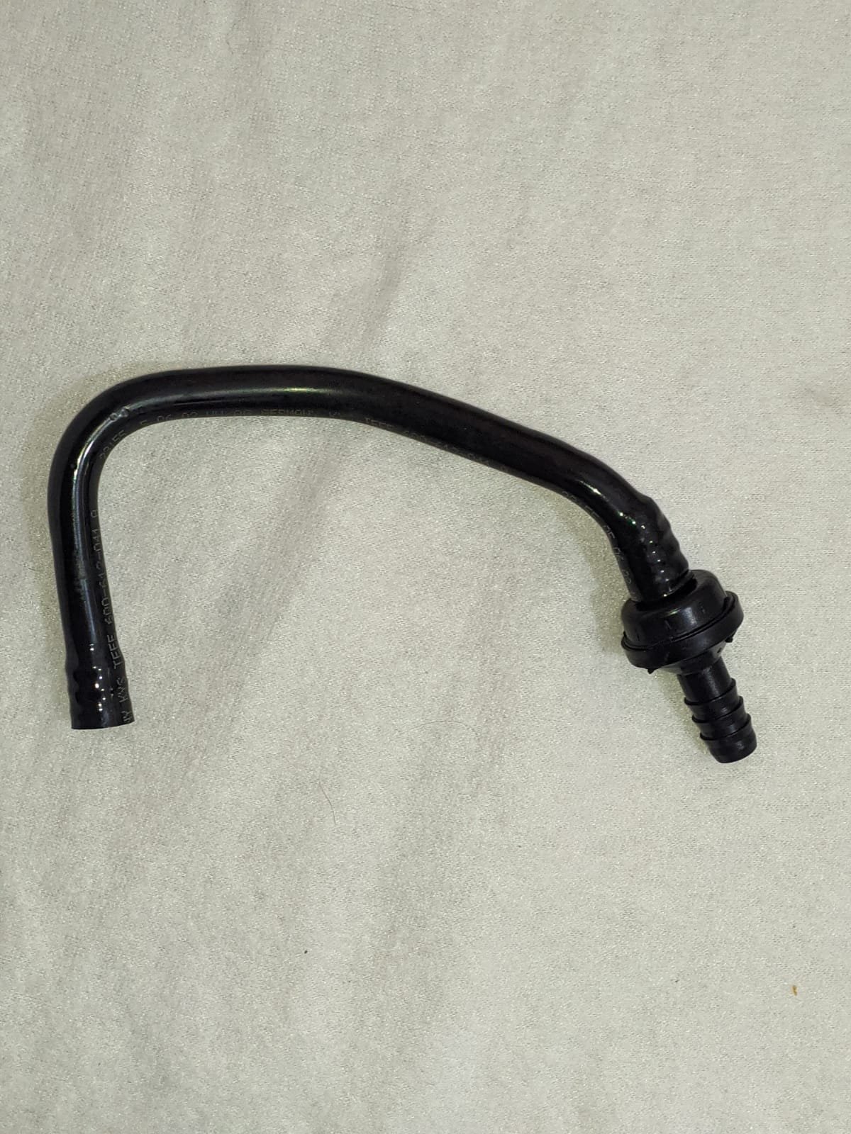

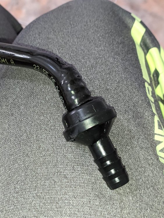

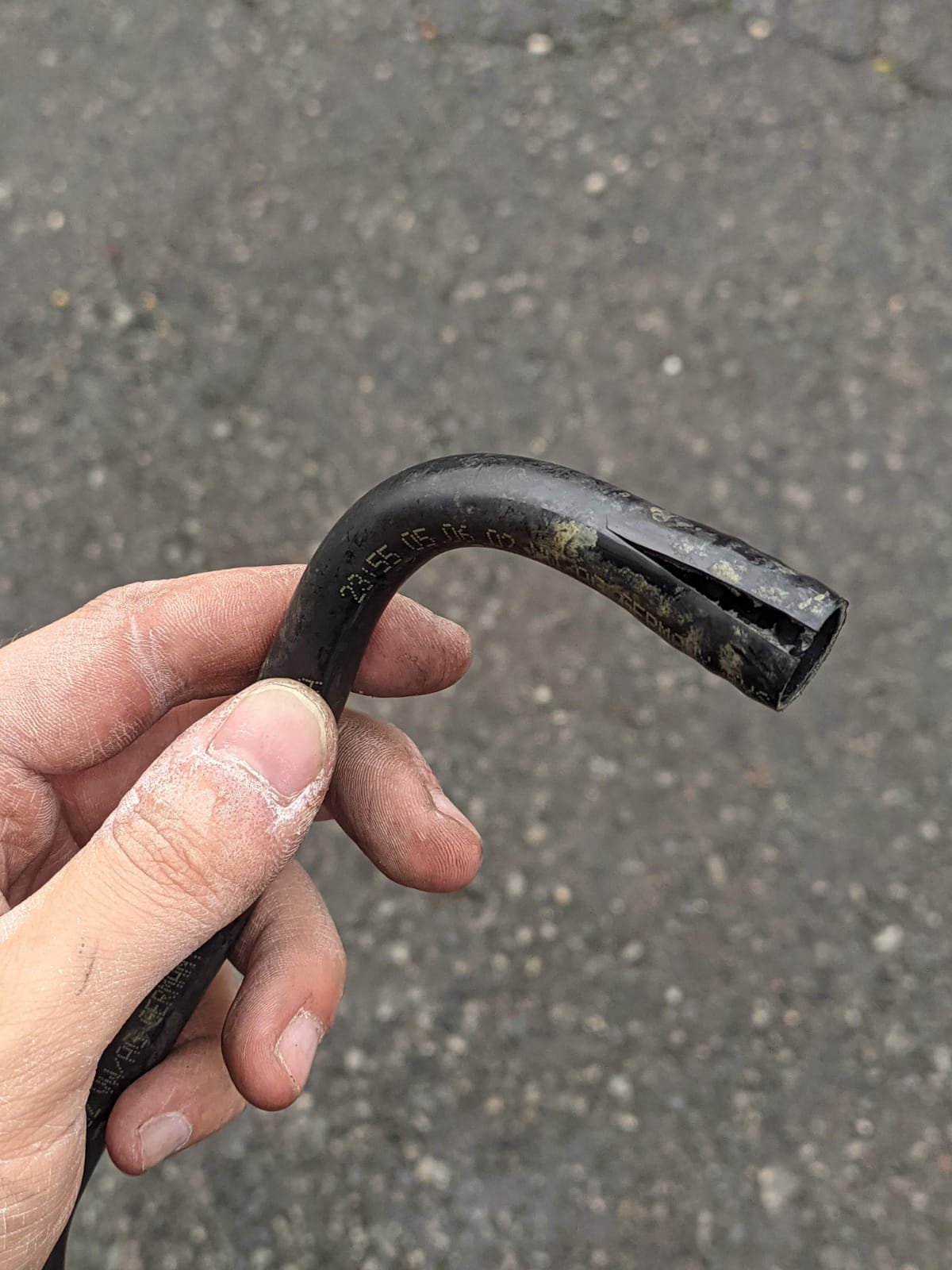

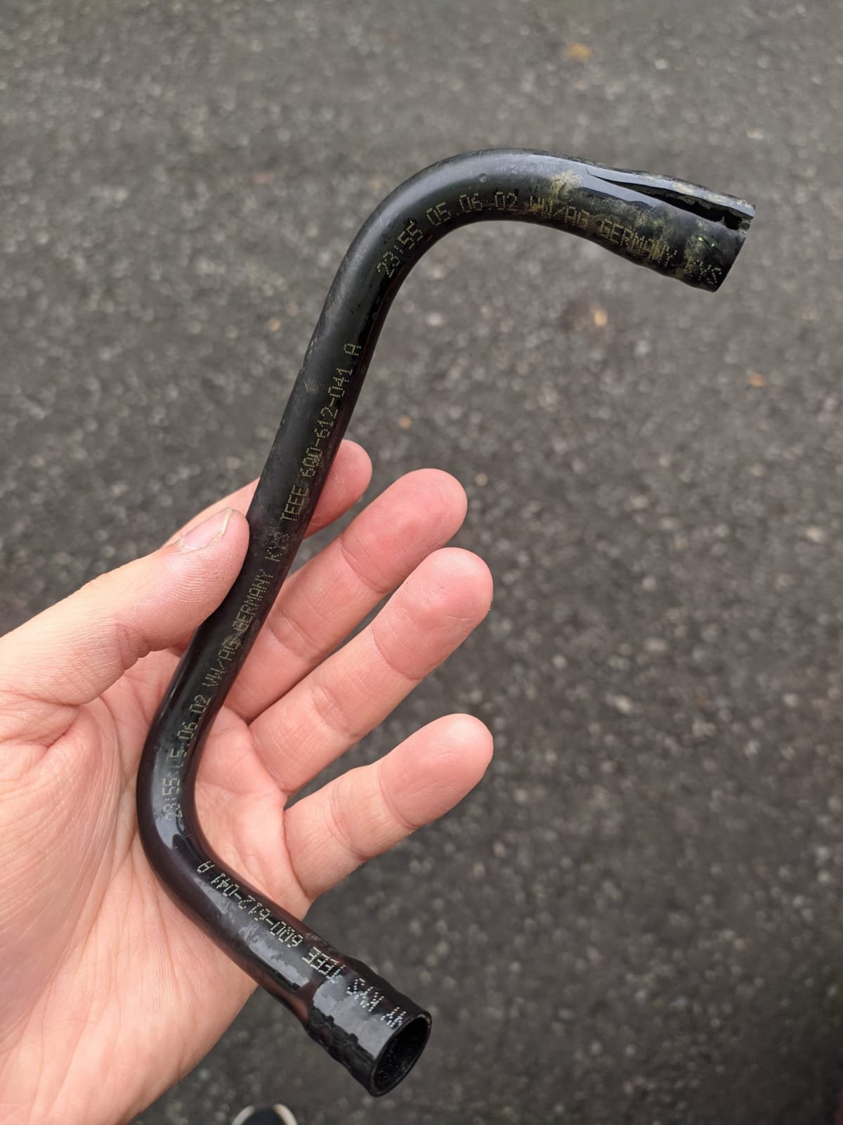

  19. You're welcome. Like you said, I should mention that you must make sure it's long enough after cutting part of it. I have the AQW engine and with heat it was easy (but you need lots of patience) to mold it in any shape you need. Why Skoda didn't change this, I don't know. They didn't do anything about the water leaks in the first gen Fabia either.
  20. I can vouch for this. Checked a while ago on my car, boom huge crack in the hose. I had a vacuum leak for months and I didn't know why. Instead of buying a new one which is very expensive, what you can do is carefully and skillfully cut off the broken part, and use heat to mold it on the piece of plastic pipe where it should be connected. Works a treat
