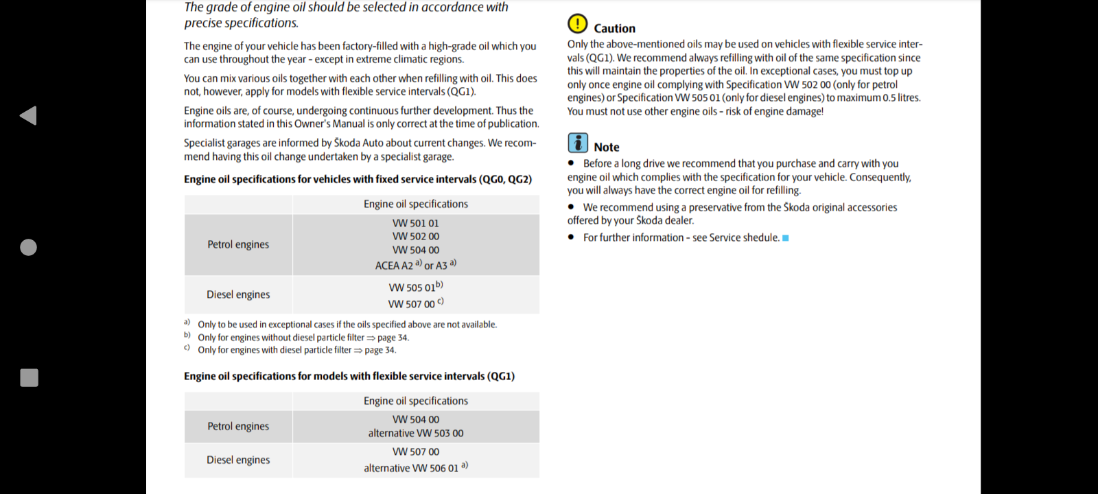

It says that here the bzg engine can use pretty much any engine oil, https://www.car.info/sv-se/skoda/fabia/fabia-combi-12-24070200/specs
What is the correct engine oil? Also isnt it better to use a denser oil for a more worn engine?
That list is rubbish.
The correct oil is one that meets VW spec 502.00 or 504.00. Where there is choice of viscosity choose whatever suits your climate or operating conditions.
What does 502 and 504 mean?

Standard 504.00 oil is 5w-30 suitable for most european climates.
Standard 502.00 is what the BZG was factory filled with and is probably what it was designed in mind for and is usually 10w-40. But lots are 5W-30 nowadays.
Guess you meant 5W40?
Yes, ok I stand corrected.
