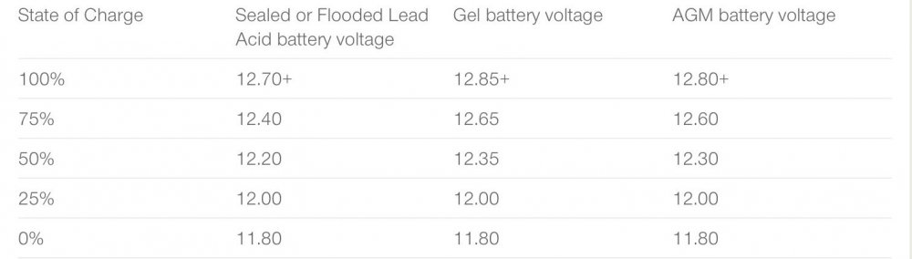

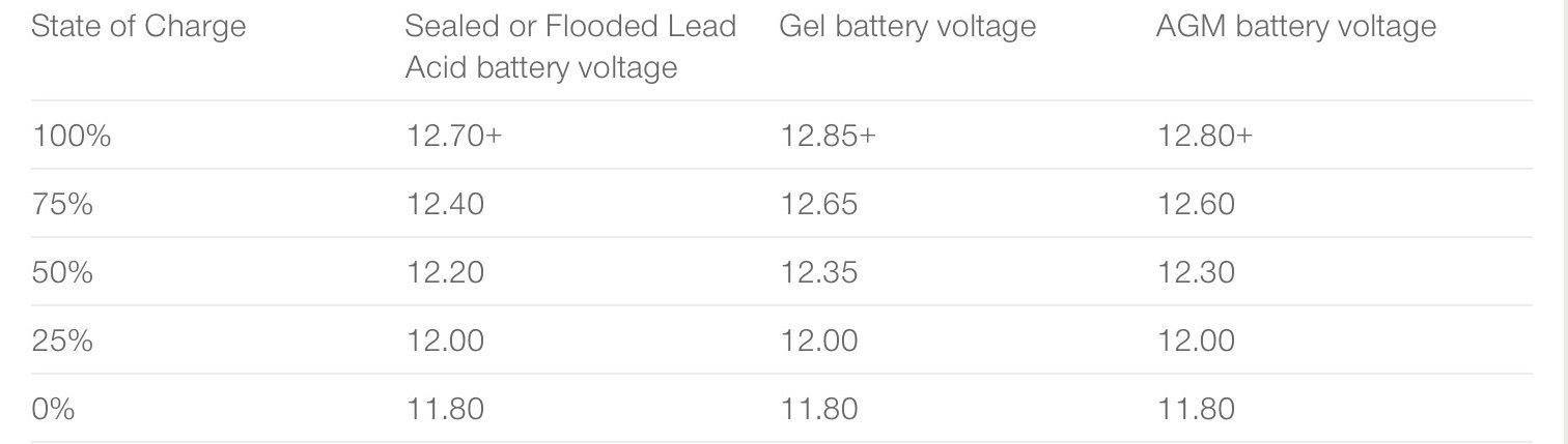

This is the correct table for agm batteries, so at 12.6-7 your battery is fine, remembering that your car BMS  will not charge to 100% to allow for regenerative/ overrun charging.

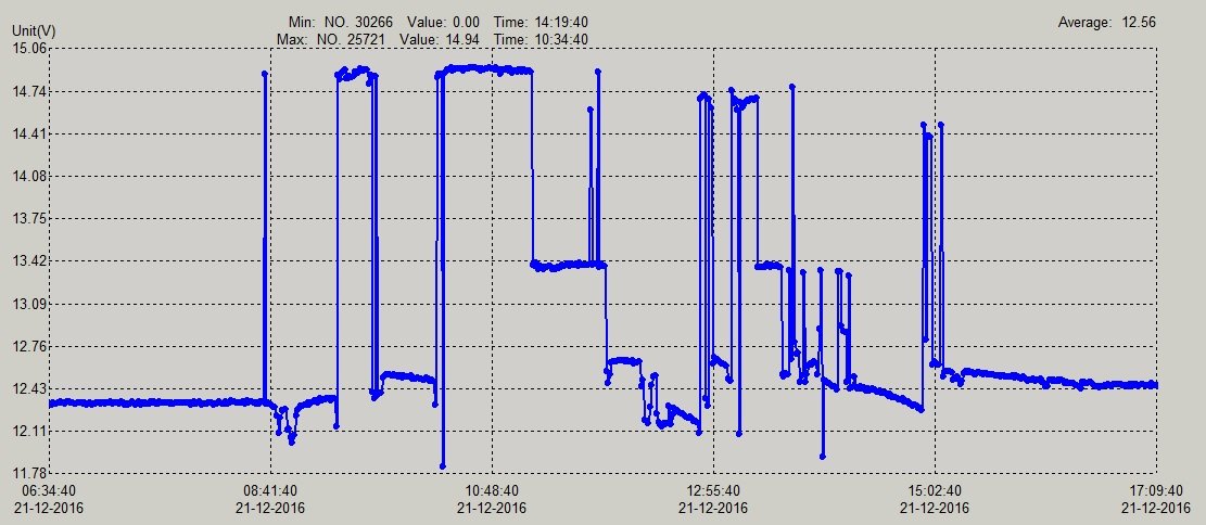

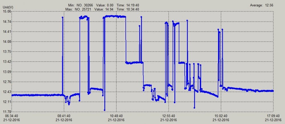

Voltage log... maybe of interest.
You will see below a voltage log of my 2016 MY17 Superb (190) taken on a 250 mile trip on mainly motorway. About four stops in the journey, weather dry, temperature about 40f, average speed about 60mph.
This was taken when the car was about six months old, factory fitted battery Varta AGM.Dec16Vlog.thumb.jpg.1eef1b4e652a19238f8792192556b825.jpg
Thanks for these graphs/tables, my thinking was a little old and applicable to Lead Acid battery - when I see 12.3v and below I worry. I hadn't realised the differences in battery tech, so it would seem my battery is perfectly fine and displaying similar voltages to DCC's above.
