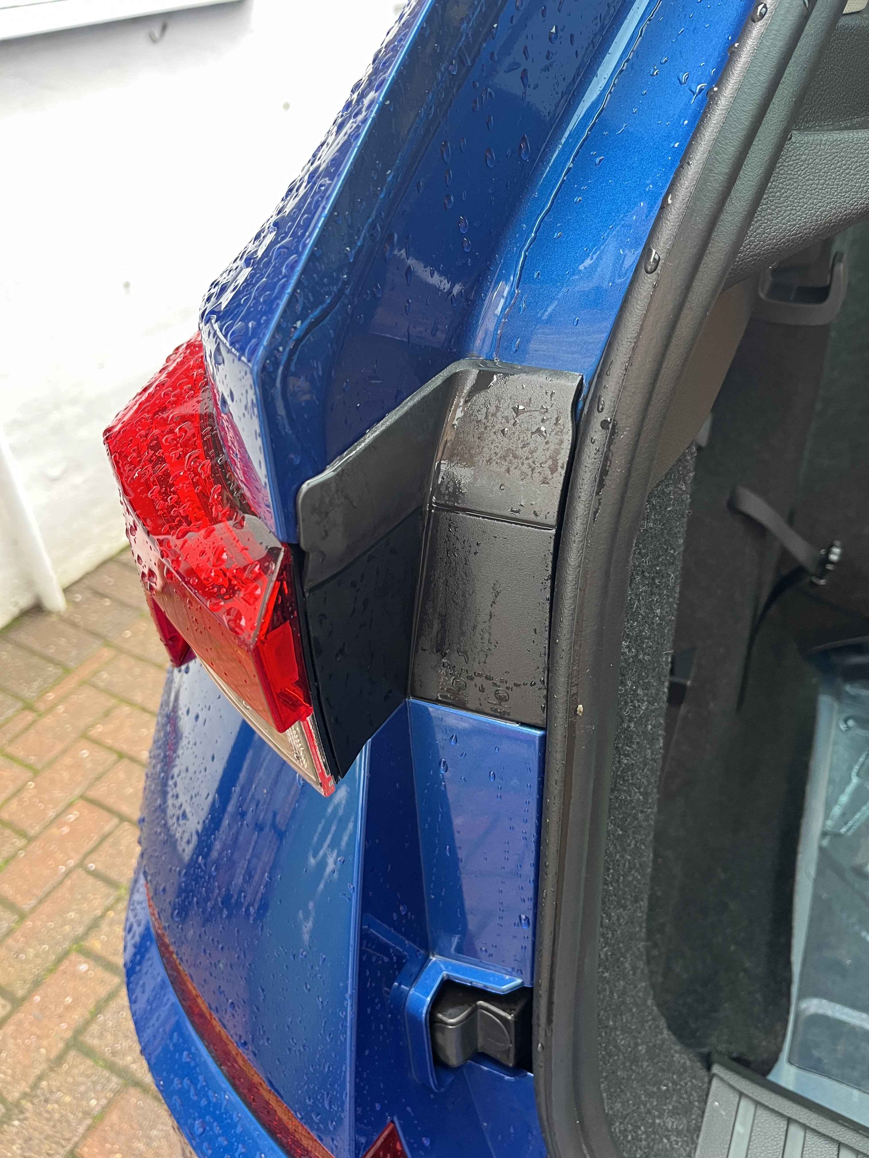

  11. Thanks for your best wishes. It was your tale of being without the car for so long that puts me off going to the dealer. I don’t fancy being stuck with a Fabia courtesy car for 3 months, compensation or not. Thinking about getting the trim off, I’m actually not sure that would help me. If it is a dodgy weld it’s odds on that it would be pretty inaccessible. I’ll see how the duct tape bodge goes and if it stays watertight I’ll probably take it off and silicone all round the edge of the shroud as a less unsightly solution.
  12. Thanks for your input Carefree. I realise that the light cluster bolt shroud (the rubbery bit) is not meant to be watertight. I found this out when pouring a watering can down the channel above it - the water runs out underneath the bumper so there is obviously a drain hole somewhere. However, not all the water was draining out because some was pooling in that cavity behind the trim. It seems that any micro hole could be behind there and so interrupts the water flow to the drain. So I figured that sealing the shroud would stop that albeit without fixing the underlying problem. So far so good. No leak after some pretty heavy rain over the last few days. I’ll continue to monitor it and when the car goes in for service I’ll mention it to the dealer.

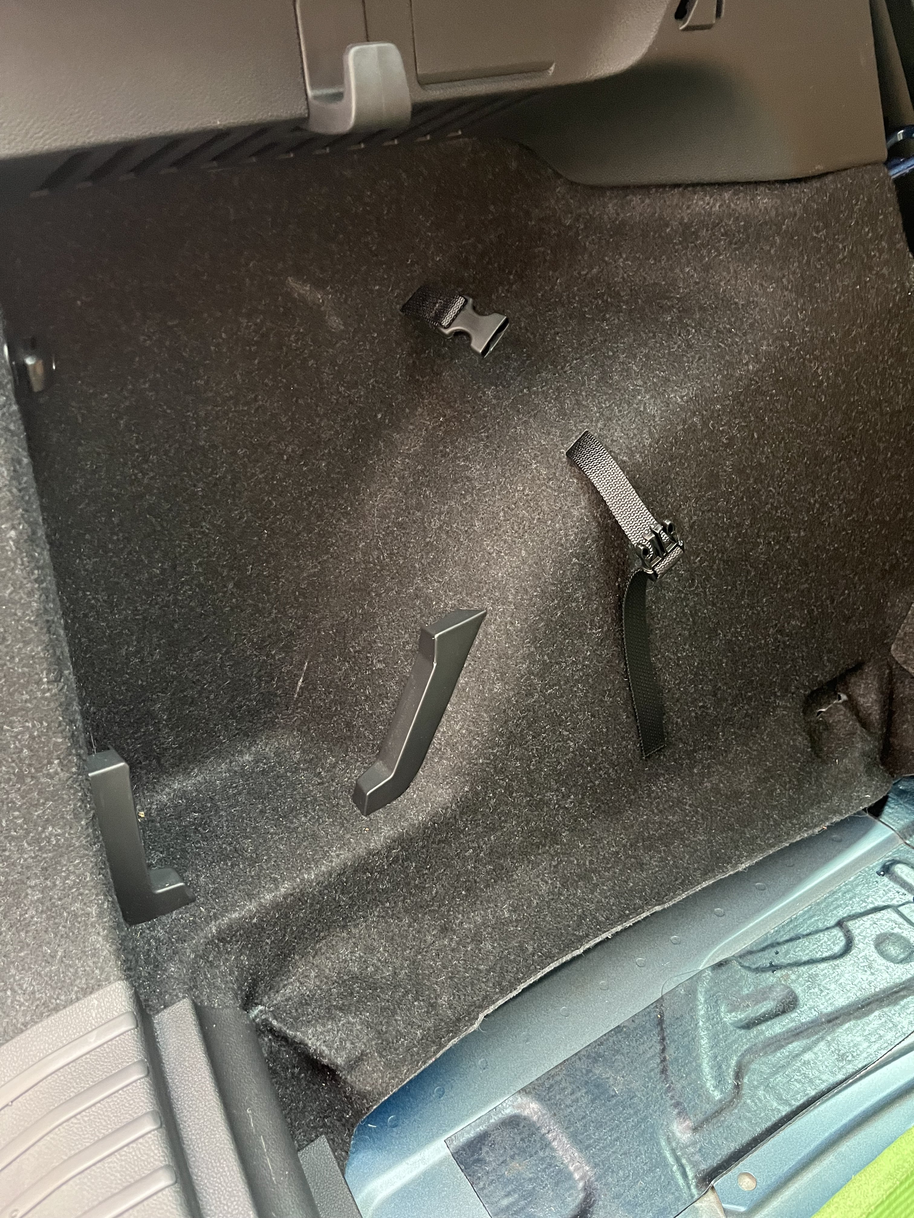

  13. I posted a few weeks back re a water leak into the boot. Not willing to have the car sat in the dealers for weeks for them to try and find it I’ve been having a go myself and I think I’ve found the culprit. The water is pooling in a cavity beneath the n/s light cluster. I think this fitting is to blame: The top of the rubbery plastic is not a flush fit against the bodywork so I think that water runs down the gap between tailgate and rear wing and straight behind the fitting. However, there might also be an issue with the light cluster or even the reflector. To find out for sure I would like to remove the boot side trim: But I don’t know how to do it. The load net retention hook (top left) is simply screwed on but I can’t see how the storage cubby channels are secured. I’d be grateful for any help for how I can get the trim off.

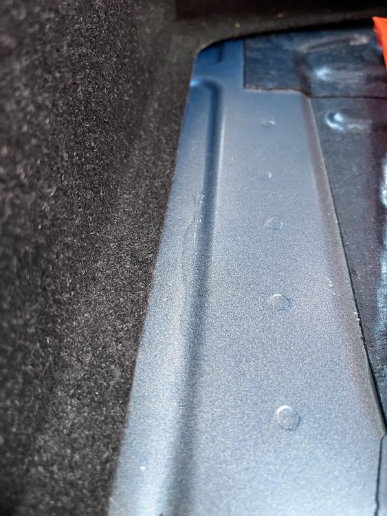

  19. Update - took some photos last night. Seat cushion: Boot floor: The passenger side boot liner (LH side of photo) is wet along its bottom edge but doesn’t seem to be wet higher up. The driver’s side is completely dry. So it looks like the leak is definitely on the passenger side. Next step is to play the hose over the top of the car, particularly on the tailgate, and see if any water comes in. If not, I’ll hose the wheel arch to see if the issue is there. Given previous comments re the invasive nature of any investigations carried out by a Skoda workshop, I’m aiming to at least identify the problem before contacting the dealer.

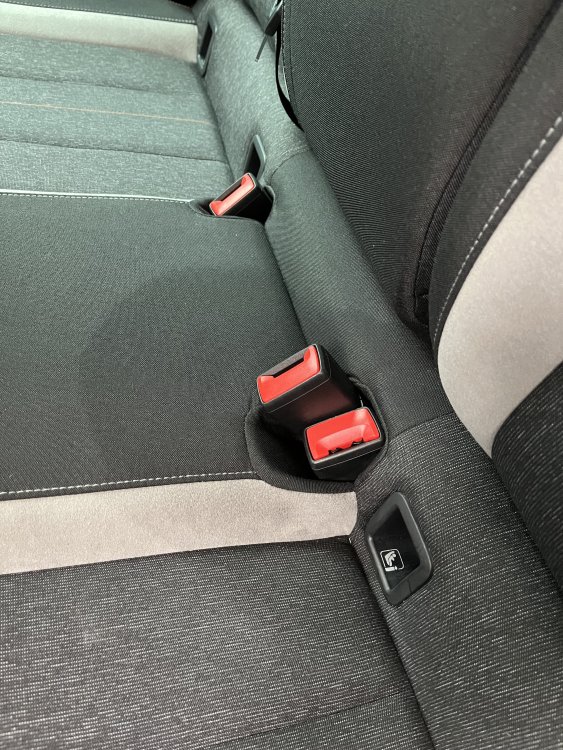

  20. Update - torrential rain today, so checked the boot when it finally stopped to find an inch of water in the wheel well. The front of the boot floor, behind the seats, was also wet, something I hadn’t noticed before. Going into to back seat area I then saw that the central part of the rear seat was also wet. So it’s definitely getting in from the top of the car somewhere. Tomorrow I’ll try and take out carpets and possibly the seat, also try and look behind the headlining.
