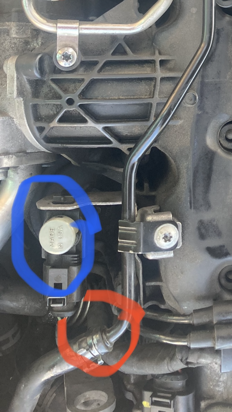

  6. Thanks mate,, is it this bit circled in blue ?? The white/grey cap thing seems loose ?? Rattles if you touch it,, when I did the inlet maybe I’ve moved or split something when moving it out the way, I’ll have a really good look at all the pipes tomorrow when I get to work thanks mate,, P2563 —- turbocharger boost control position sensor A circuit range/performance—- has popped up twice I’m using just a cheapo reader that I’ve had for ages, can’t do ABS or Airbags

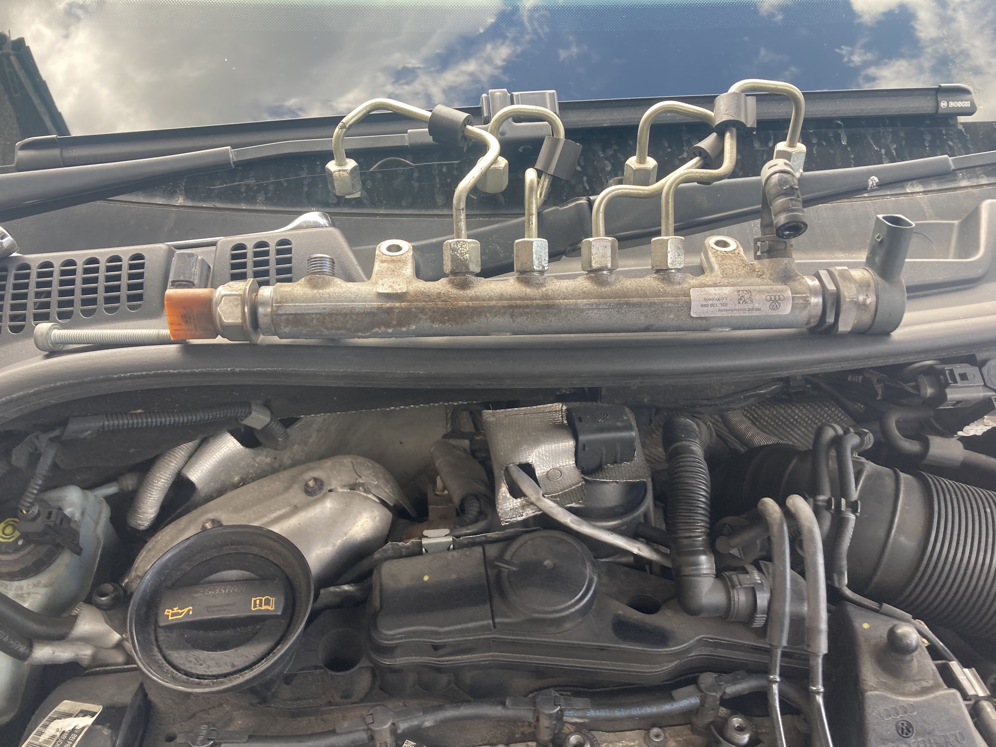

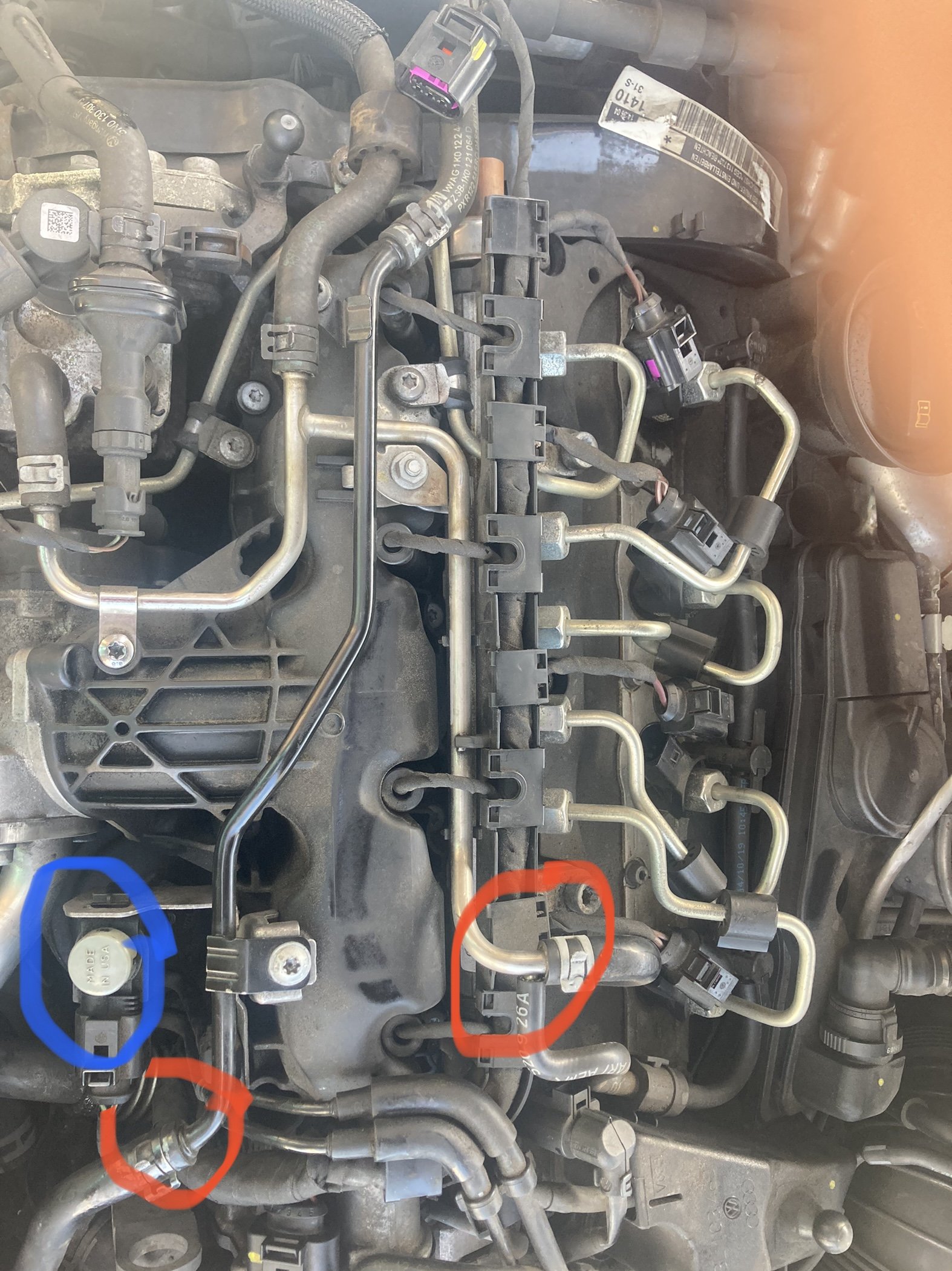

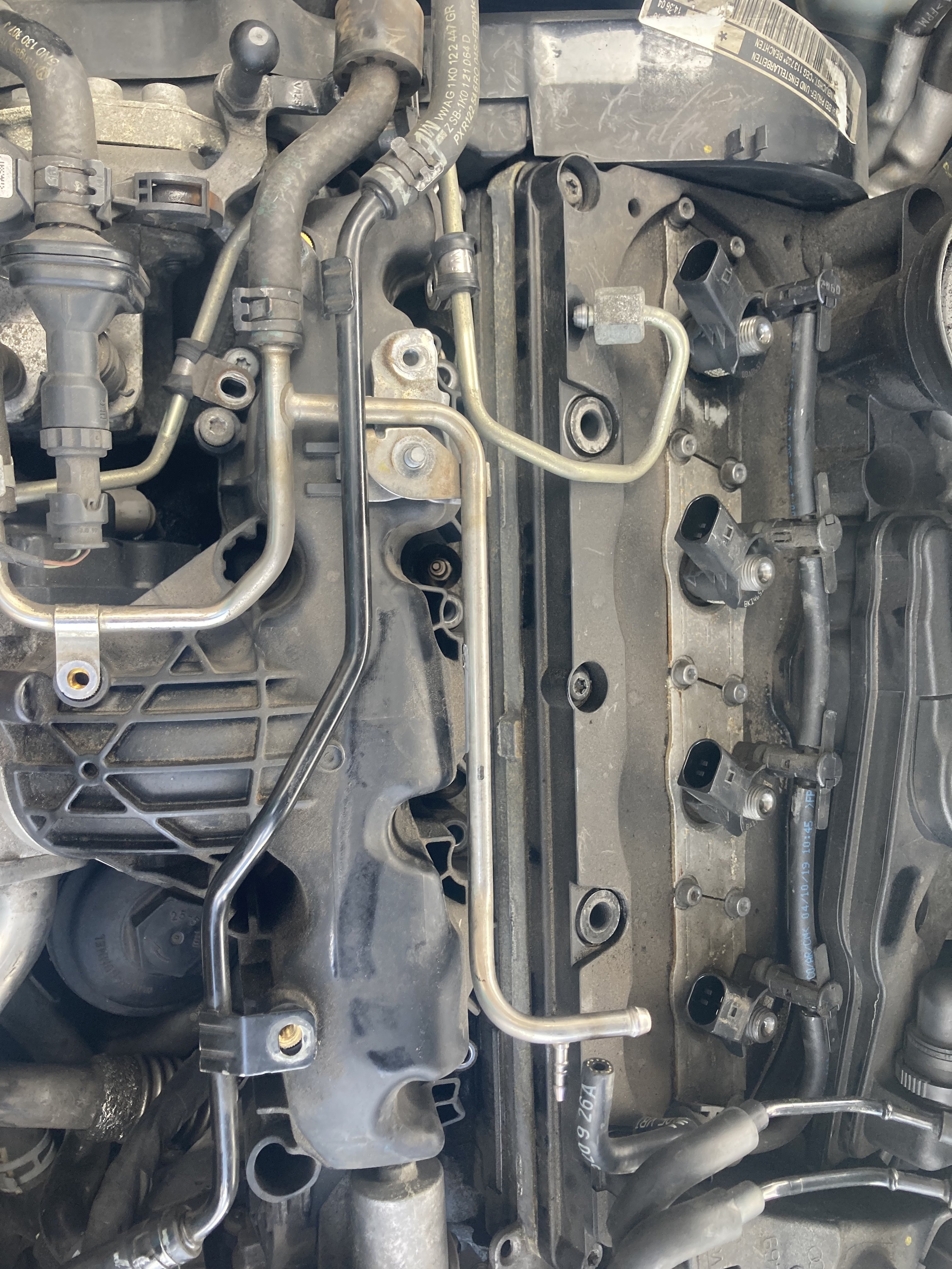

  12. Hi peeps,,, fitted a new inlet due to P2015 code,, all good so far after a week or so,, was I bit of a faff but with my limited knowledge I managed it. forgot to take photos in stages but I got carried away and just ploughed on 🤣. The red circles are were I unclipped hoses so I could wangle it out and get other clips cables etc past to tuck out of the. the inlet is held on by T27 torx I bought a 100mm deep one to get into them, you also need a10mm spline socket for the injector rail and EGR pipe,, 10mm socket for the dipstick bolt, flathead screwdriver for jubilee clips or 7mm socket (I think), 17mm spanner for the injector pipe nuts, I started with unplugging all electrical clips to injectors, rail, egr, throttle body, and then I undid the 4 injector pipe bolts and the one one the left hand side or the rail, unbolted the 2 spline bolts hiding down the rail, then unclipped the injector wiring and pulled the glow plug sockets off and lifted up and to the right out of the way then unclipped the red circled hoses and all the torx holding down the pipes that clipped to the inlet,, removed the rail completely then I just unbolted the inlet and the jubilee clip on the throttle body bottom, EGR pipe making sure not drop the gasket,,and just wiggled the thing out to the right just moving odd pipe clip that got in the way,, kinda like this prior to removing. Once removed I just removed EGR, throttle body cleaned them up , absolutely caked in carbon build up, I then put them on the new inlet and then refitted,, I say it took about 2 hours to do but I spent 30 mins on cleaning EGR ,, oh and don’t forget to unbolt the dipstick I did 🤣 sorry it’s a bit vague but I’ll try n do a bit of a video with pointing at things and where I moved them 🤣🤣 I got the inlet from eBay to £72.88 2 year warranty

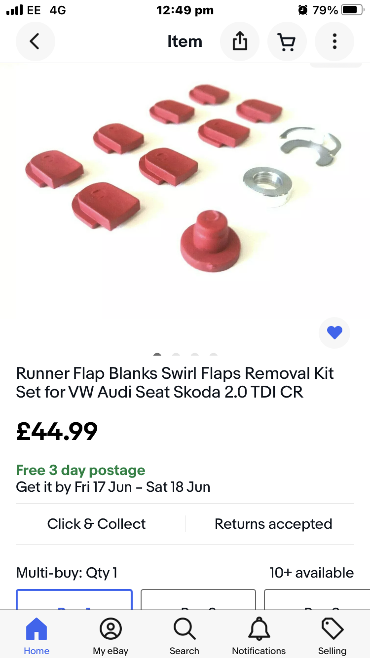

  19. Right P2015 code is now driving me potty 🤣,, I’m now thinking swirl flap delete ?? couple of questions if I may ask?? do I still need to leave the motor attached but not connected and do I need to keep it plugged in on the loom ?? does the kits come with plugs for to swirl flap holes or are they just left as a hole 🤣 is this the sort of kit I’d need,, I assume the red clips are just to block off where the metal rod goes through to link them together?? and the other plug goes in where the arm is ?? would anything need mapping out thanks peeps
