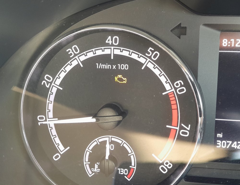

I've restarted it a couple of times since, ecu light out, but I have a start and stop system error that comes up just after I start the car, then it goes off again. If it was fuel related I'd have thought the issue would have occurred soon after I'd filled up, but I've covered 100 miles since I last filled up, problem has just occurred since this morning. When the ecu light was actually flashing the engine sounded like a bag of hammers.

Just started my car again, ecu light now flashing, before it was static, s/s light on as well, engine sounded rough, screeching type of sound as I was walking to my garage for my code reader. Got back to the car, ecu light now not illuminated. Checked with code reader again, same codes displayed, buy one now saying fault now there on start up. Engine sounds OK, but maybe slightly lumpy on tick over.

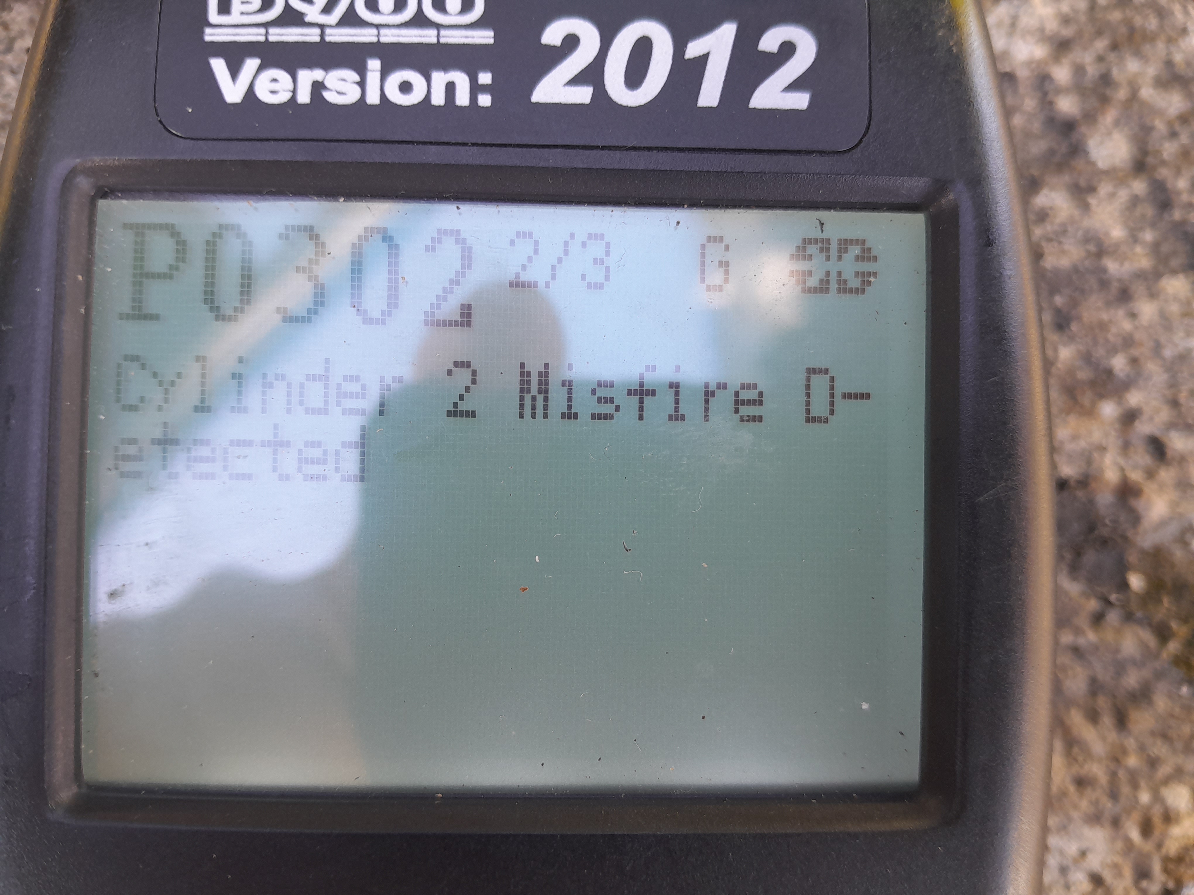

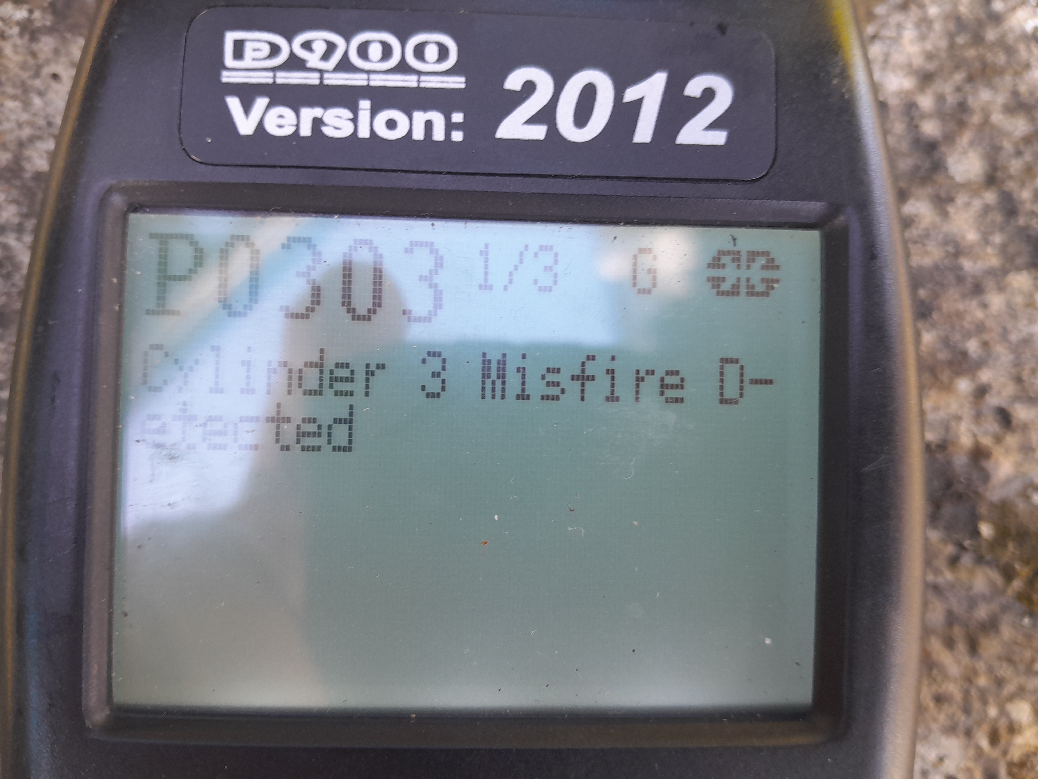

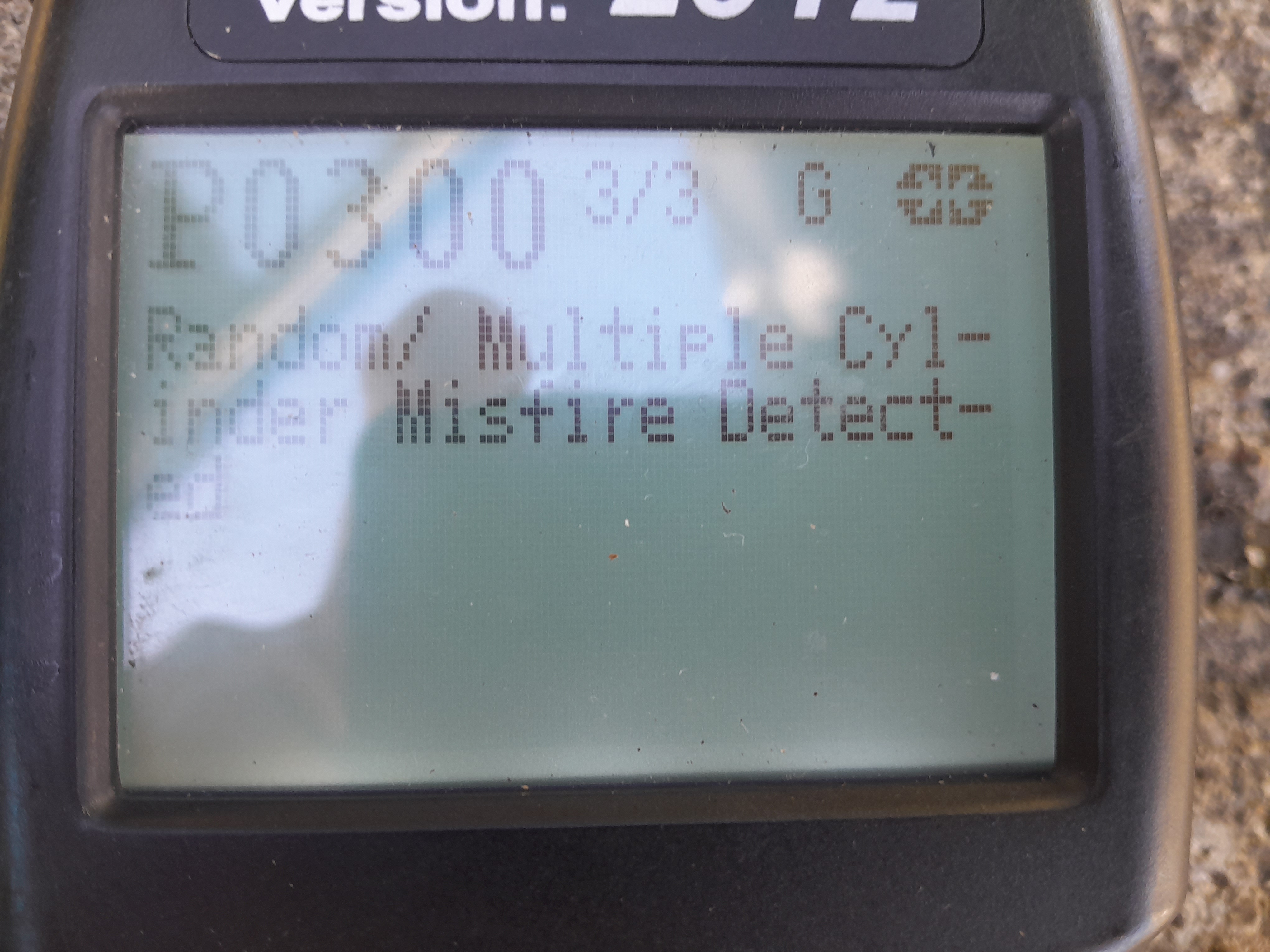

I took it from engine code on the v5. Do you mean chassis number? I'll have a look on the Cambelt cover. As I've had generic codes relating to multiple missfires, maybe not be a coilpack then? If they are single packs. Cars still driving A1.

Also come up with random missfires, reason I suspect coilpacks. I have the skoda extended warranty, so I'm booking my car in for a diagnostic. Plugs were changed last year my Skoda main dealer at 22k, car now covered 30k.

I own an 2019 Octavia 1.5tsi act dsg se, 30k on the clock, fdsh. My ecu light came on this morning and stayed on. Checked the battery, it's OK and it's charging OK. Got out my trusty generic code reader, came up with p0300, 302 and 303. So my guess new coil pack required. Fortunately (I hope), I've took out the Skoda all in service and warranty plan. I'm booking it in for an diagnostic, initially at my expense, my fingers are crossed. Owned the car a year now, so far its had a new battery (I paid), rear wiper motor (paid for under dealer extended waranty), rear brake pads and discs, I changed them. Anyone have any further ideas on possible fault cause?
