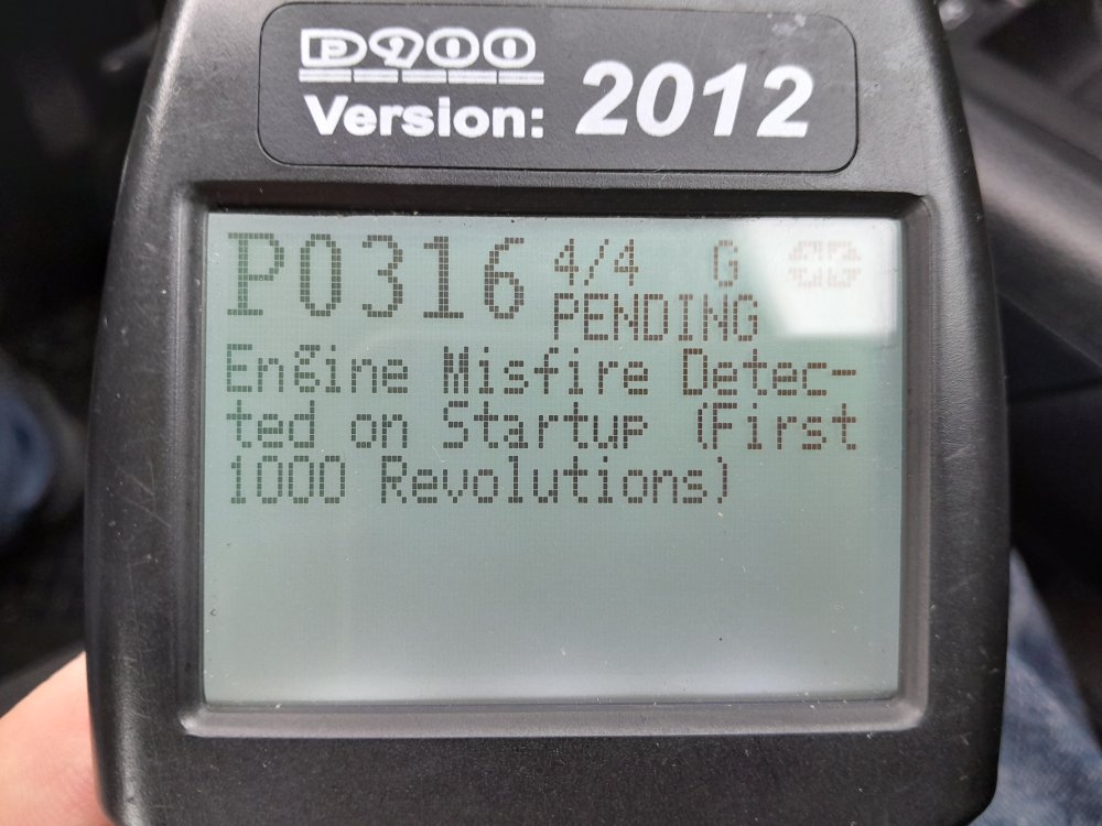

Light came on again from a cold wet start, ecu flashed for around 10 seconds went off again. Checked codes with my generic code reader, again. Codes logged pending, plus one extra than before. It's a 2-6 week wait, dependent on where you go to get an diagnostic booked in at the dealers. Once I get to the bottom of it, I'll post again. Extra code attached that wasn't added earlier.
