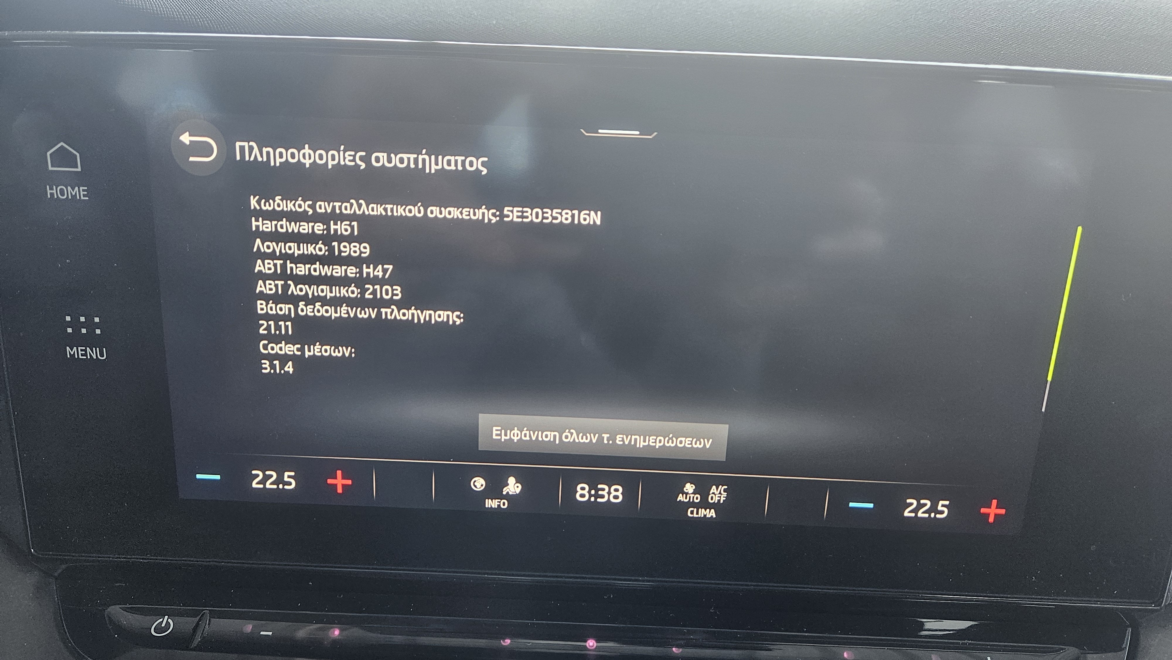

  2. Hi, Today I dropped my car off at the dealership to have this problem fixed. They called me and told me they would replace the main unit of the infotainment system. They actually did. I picked it up and they informed me that the replacement was done. There was no other way to fix the problem. Even though 2 years had passed (that's how long the warranty is in Greece) they told me that the entire cost was covered by them. After 3 years, however, I would have a problem. I am sending 2 photos, before and after. you can see the differences in hardware and software. Newer hardware with older software version than what is available. It's 1969. Maybe 1989 would be appropriate, I don't know, I guess.

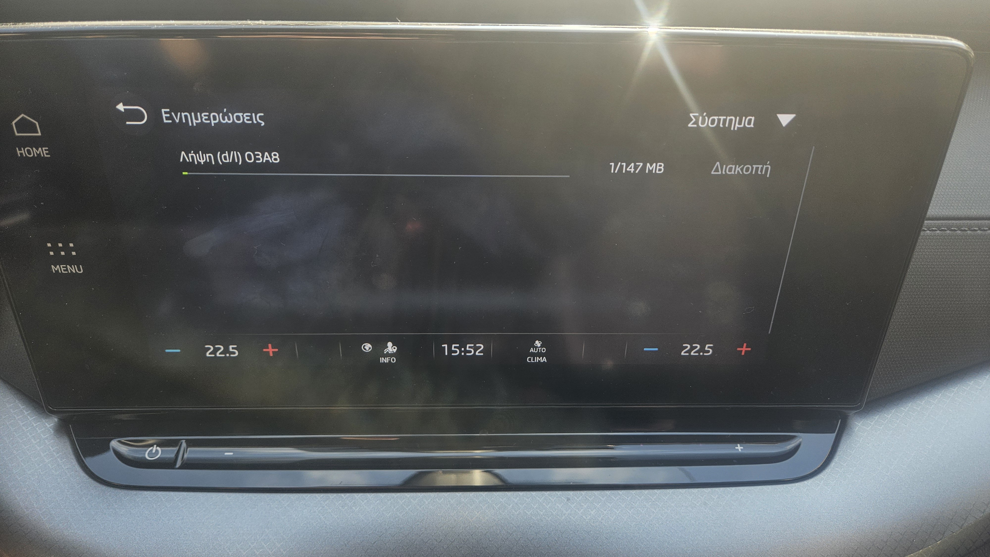

  8. Hello, still not found a solution. The last option is the dealer. I will set an appointment and i will inform you about the results.

  11. On Monday the infotainment inform me that a new update found and download begun. After the download was complete and I arrived at my destination, I turned off the power and got out of the car. The next day when I got in, it asked to start the installation, I accepted it and when it finished the installation, a series of repeated resets began as I was driving. There was no sound, so after 14 resets, the infotainment stopped working (thankfully because I was dizzy from the restart sound) Obviously something was wrong. When I got home and had time, I stopped to see what was happening. The user (me) had been lost and I had to go through it again. I did the procedure and thought that everything was over, as I entered the menus, adjusted the sound and put some FM stations in the memories. Everything seemed fine. But when I went to the main screen (HOME) it got stuck and after 1 to 2 minutes it reset. This happens as many times as it went to this screen, on the rest I see them normally. Sometimes the sound is not there, but this happens from time to time. Today the same thing again, it seems that there is some problem with this screen (HOME), when I get to it, it gets stuck and resets itself. This is the status of my software. What I thought about was reloading 1989 manually (that's how I had done it the first time.) Can the same version be done again in the same way we know as an update? Does anyone have any other ideas? What can I do before I end up going to the dealership?
