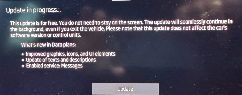

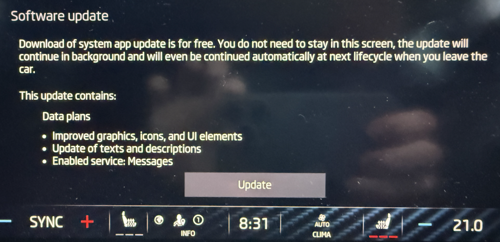

For the past week I've been receiving a nortification of a software update to install. I've immediately started the upgrade, and it reports a successful installation. However, the next day it prompts again for the update. I go through the same procedure., and the following day I'm prompted again. My car is currently on infotainment version 1941:
Has anyone else that this issue? Can anyone tell me what this software update could be for? As I've never previously had an infotainment upgrade I'm not sure what the screens look like for that. Part of me is hoping that it is an update to the infotainment, but I'm not convinced.

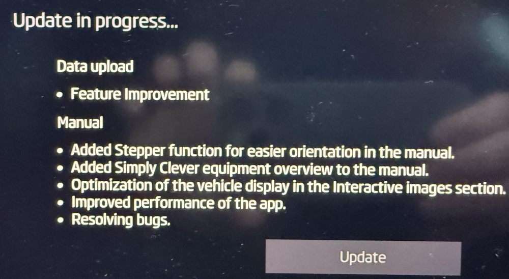

I am wondering if it's two updates that are conflicting. The text on the update message is different today:
It only mentions updates to data plans, and says that the update does not affect the car's software version. Yesterday there was far more components being updated. It'll be interesting to see when I get the message to install tomorrow if it's back to the more extensive update.

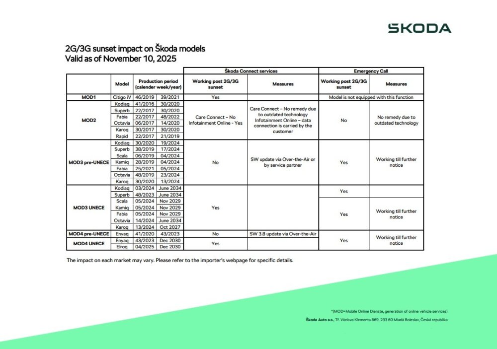

I thought this maybe was because of the 2G/3G network closing in near future
Unlikely; Škoda have told me the SIM system in my 2020 build car is 4G.

I was told the same by my dealer that the module is a 4G LTE component and therefore not affected by the 2G/3G network shutdown.
It seems a case of Skoda sending a communication to people not actively affected by it, and therefore causing confusion.

2G, 3G Sunset
@Thomas_Toget the I read that chart is that your 2021 Octavia comes on the row “MOD3 UNECE“ - which shows your car will be fine post ‘2G,3G sunset’.
