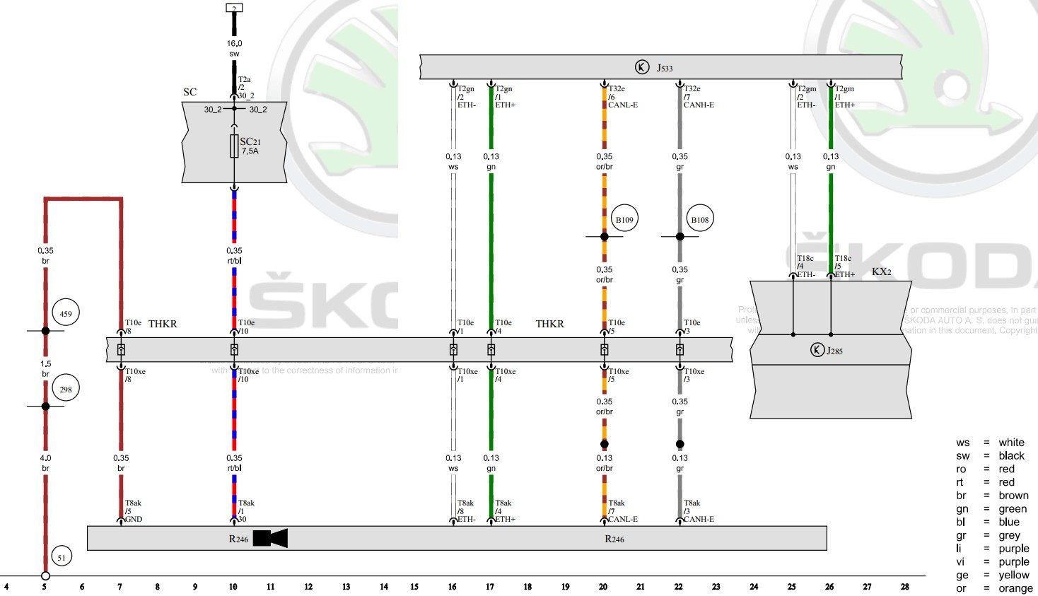

Hello everyone, I have decided to retrofit Blind Spot Assist myself. I am currently gathering information and materials. I will share my efforts with you as they unfold. I don't know if I will succeed, so I haven't yet predicted 100% success. The information concerns material codes and the method of their installation. Finally of course there is the programming of the system which will be done by on-line connection to the VW servers. So, so far I have collected some materials. The schematic: The codes of the radars: The brackets for the radars To be continued...- Rear bumper removal
