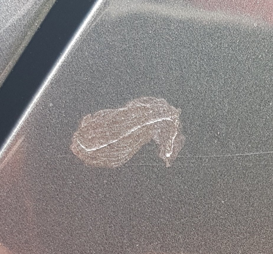

  10. I have the 'graphite grey' (I believe) Mk4 2020 Octavia. I recently bought two touch up paints, both via ebay, one from r.s.autoworks (marked as LF7C) and one from ab.touch-ups (F7C), they seem identical to each other, but are lighter than my car, see photo Do I need to shell out nearly £30 for the 'official' Skoda parts e.g. the one in Swindon? Does anyone know if this is a better match or another supplier? @EchoWisky what year is your car and did you get a good paint match?
