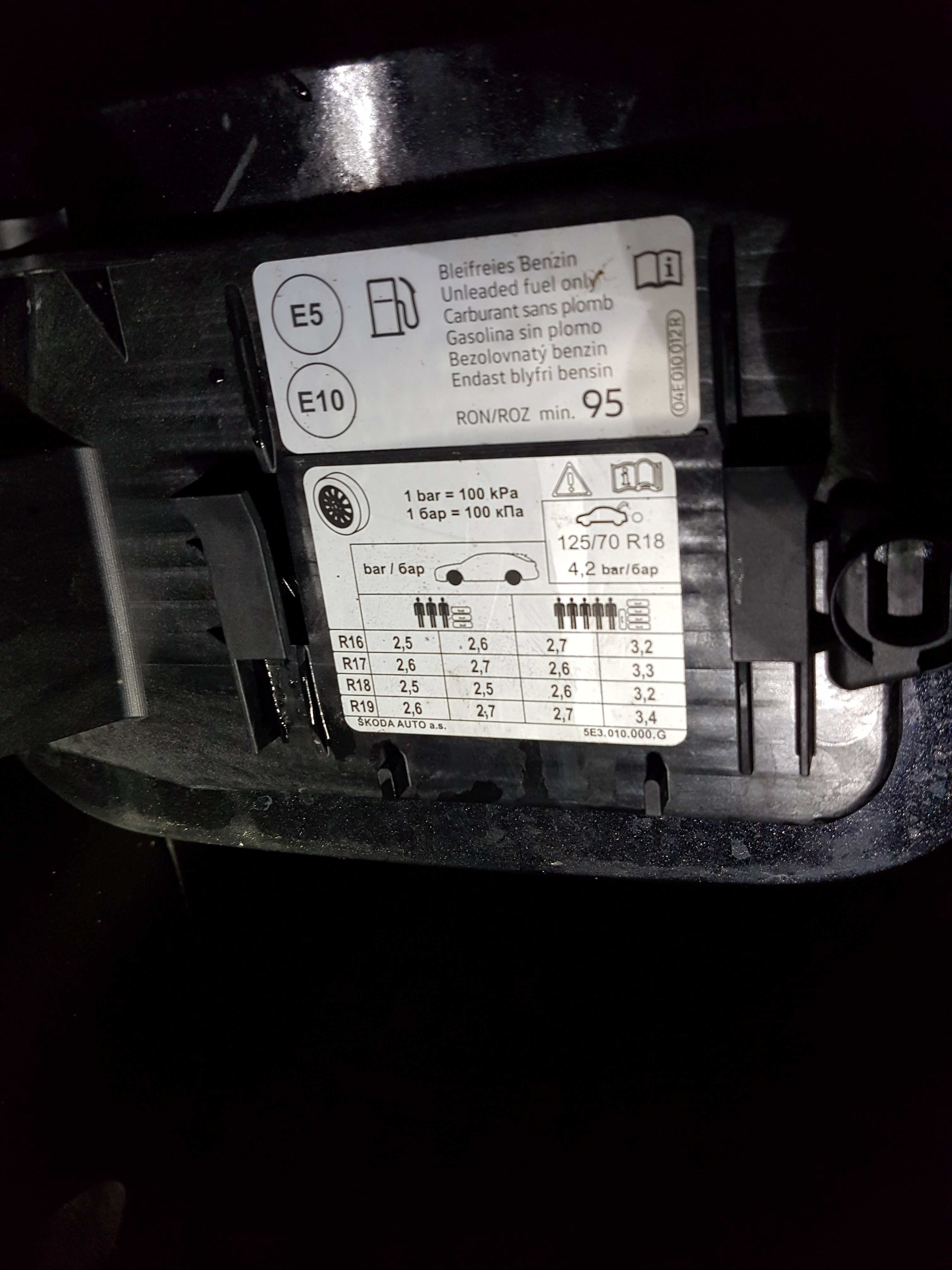

A picture of your particular label would help

Hi again, please find a photo of the fuel filler flap20211127_233215.thumb.jpg.c8ef714fb746d6440d66c75bb55d2586.jpg

The fuel filler label only shows fully laden front and rear (and the space saver spare, fully laden), they seem to have dropped the lightly loaded pressures.
The 5E3 code on the sticker should refer to MK3 Octy? Or am I mistaken?
That photo is of the fuel filler flap on my Mk4 Octavia, thanks

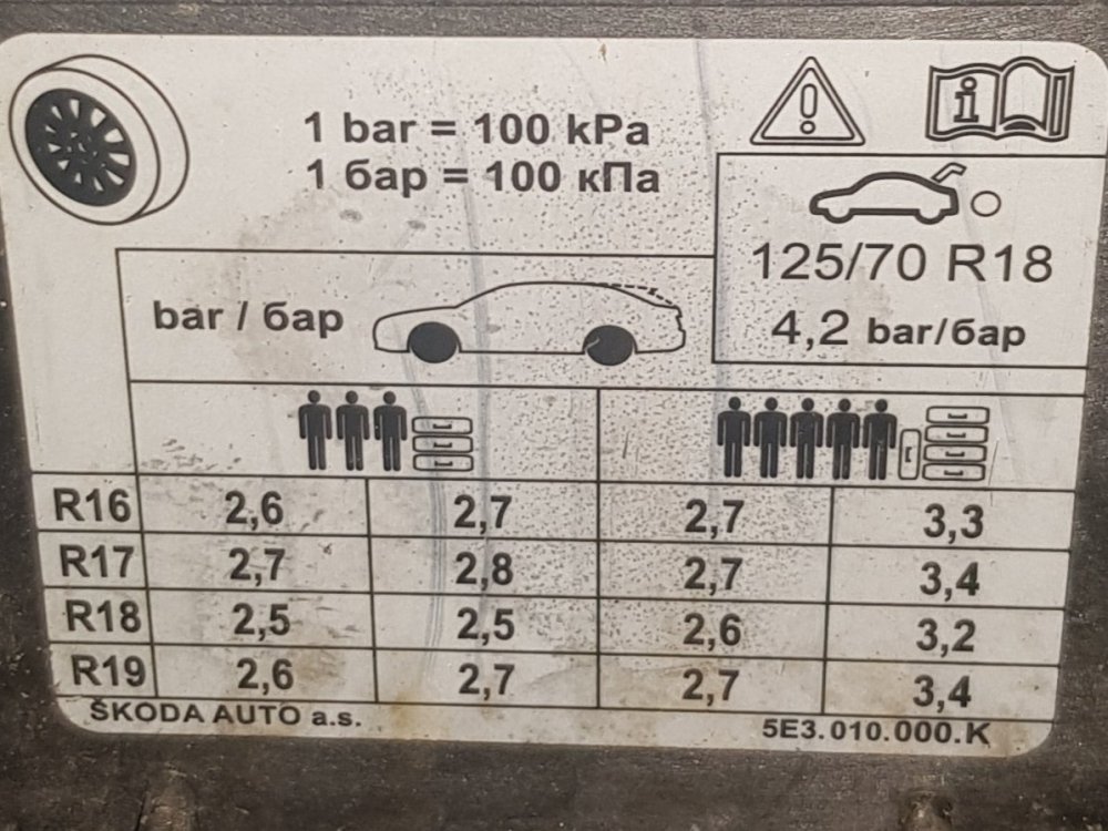

My car is 1.5 TSI Octavia Estate, with R17 tyres, 'normal' (not low) profile
The figures shown in filler cap are in photo:
Front 2.7 bar rear 2.6 bar, and rear 3.4 bar with full load
This equates to 39 psi, 38 psi and 49 psi - these are very high esp 49 psi ?!!

You appear to have transposed front and rear tyre pressures - rear pressure is normally a little higher than fronts. EG. left hand column is for front pressures.
I didnt transpose just misread the rear as 2.6 but my question remains - don't these seem very high pressures? (Ignore the winter tyre thing)
No, as I said in my 1st post, I normally run my 16s at those pressures.

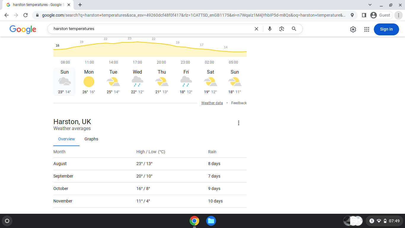

Re the advice about Winter and tyre pressures and increasing.
Same stuff for a couple of decades, and this is not Winter or winter temps and All Season / Summer bias tyres are not as Winter Tyres well.
The plus 0.2 bar or the likes are Cold Temp settings, as in set at the temp that day or weather not the same as if a freezing ground temp at night and maybe 15*oC air or road temp day time.
(Not set in a heated / warmer garage.)
Head for thinking and feet for dancing. & location location location.
'The nights are drawing in'
After a heat wave English Bank Holiday Monday comes maybe a rainy week and a few cold nights Oop north. Even frost before September.
