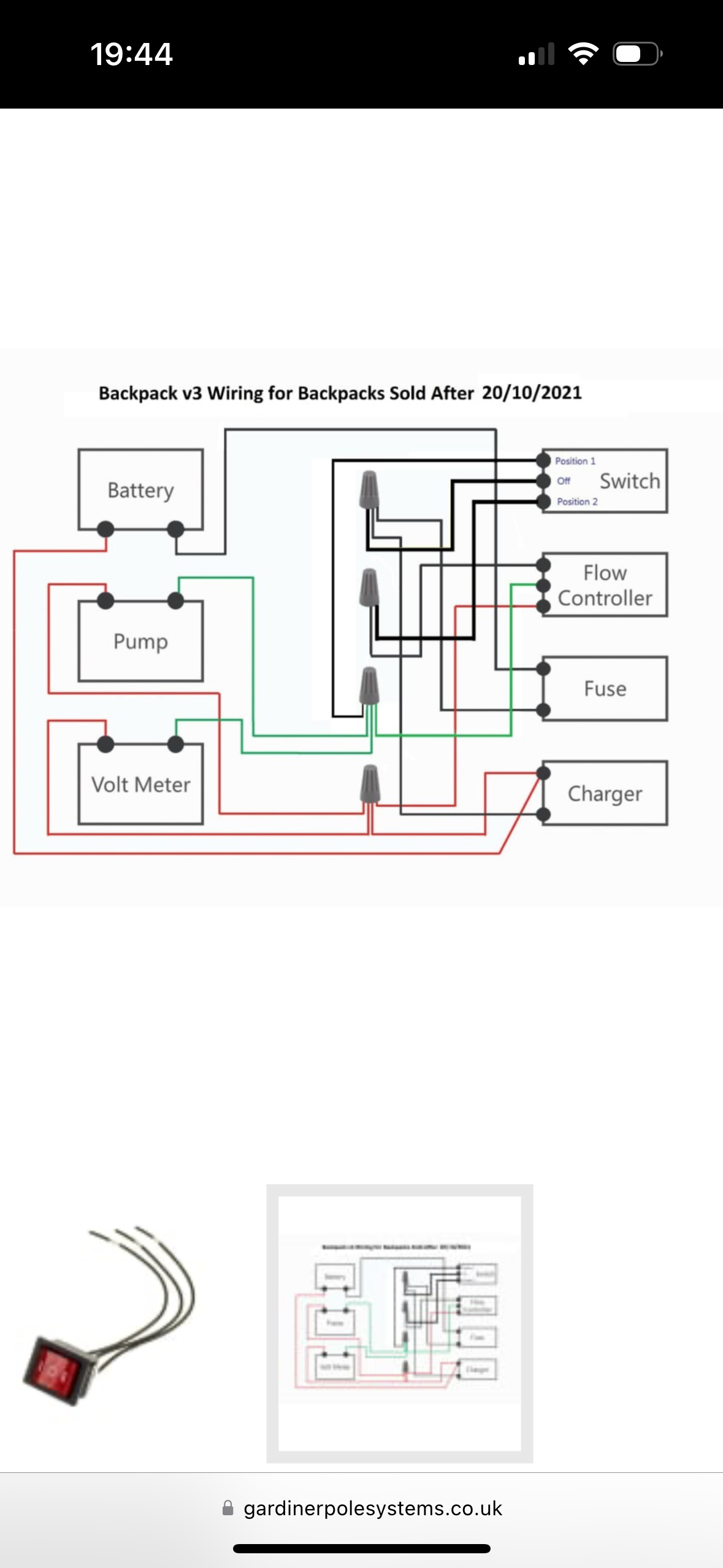

Hi I’m trying to add a remote control to a water pump circuit but struggling to get my head around things. Below is the manufacturers wiring diagram and I want to add a remote control unit, this has 4 wires, 2 positive and negative input and 2 for output. It needs to work after the speed controller. I want to be able to turn the speed controller on and off remotely and leave everything else to work as was. Help would be much appreciated.
