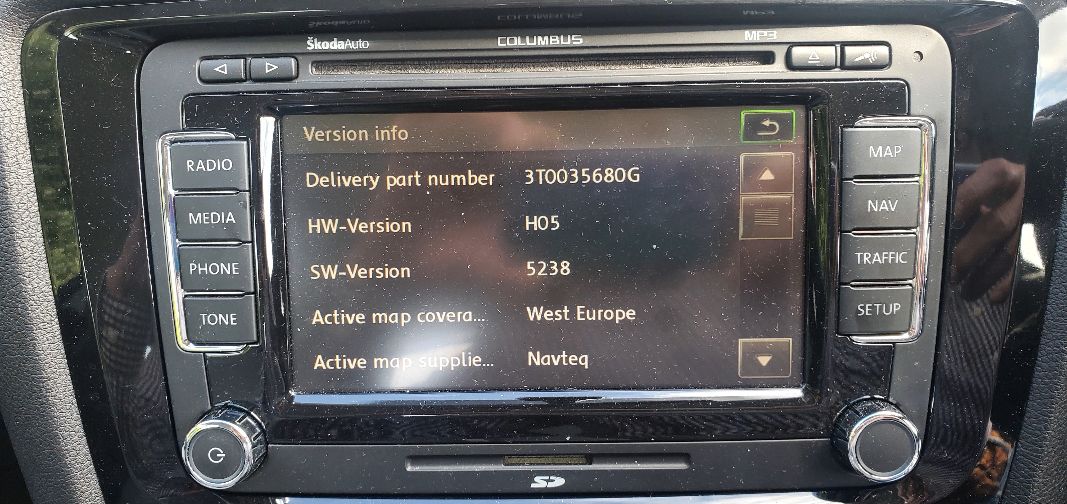

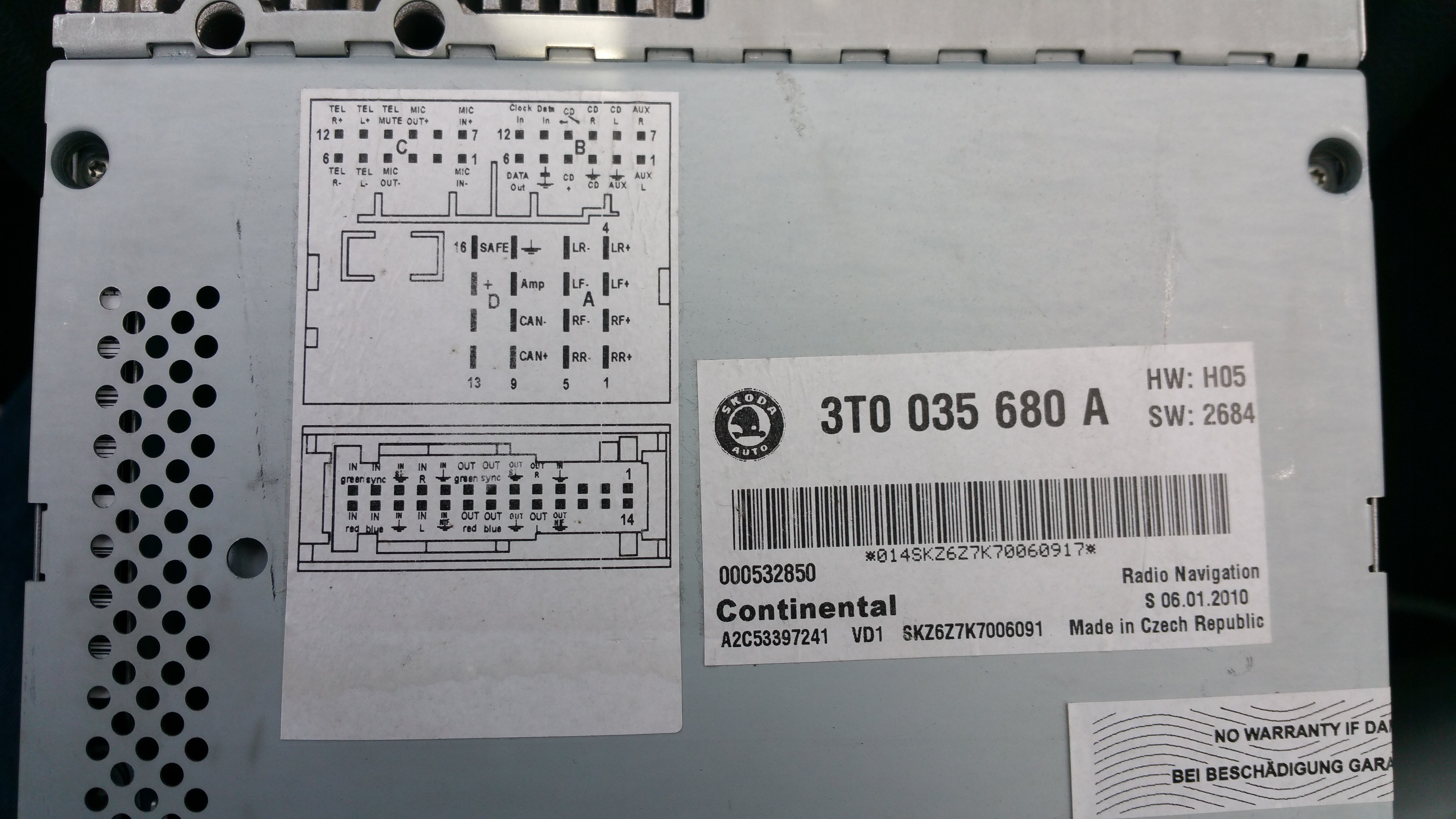

  10. Hi, I have the Columbus 3T0 035 680A fitted to my Octavia 2010 L&K software version 2684 according to the label attached to the unit. The unit itself is reporting part number 3T0 035 680G software version 5238. Can someone tell me what the last software version was for this unit. I would like to update it if possible. Thanks, Kev.
