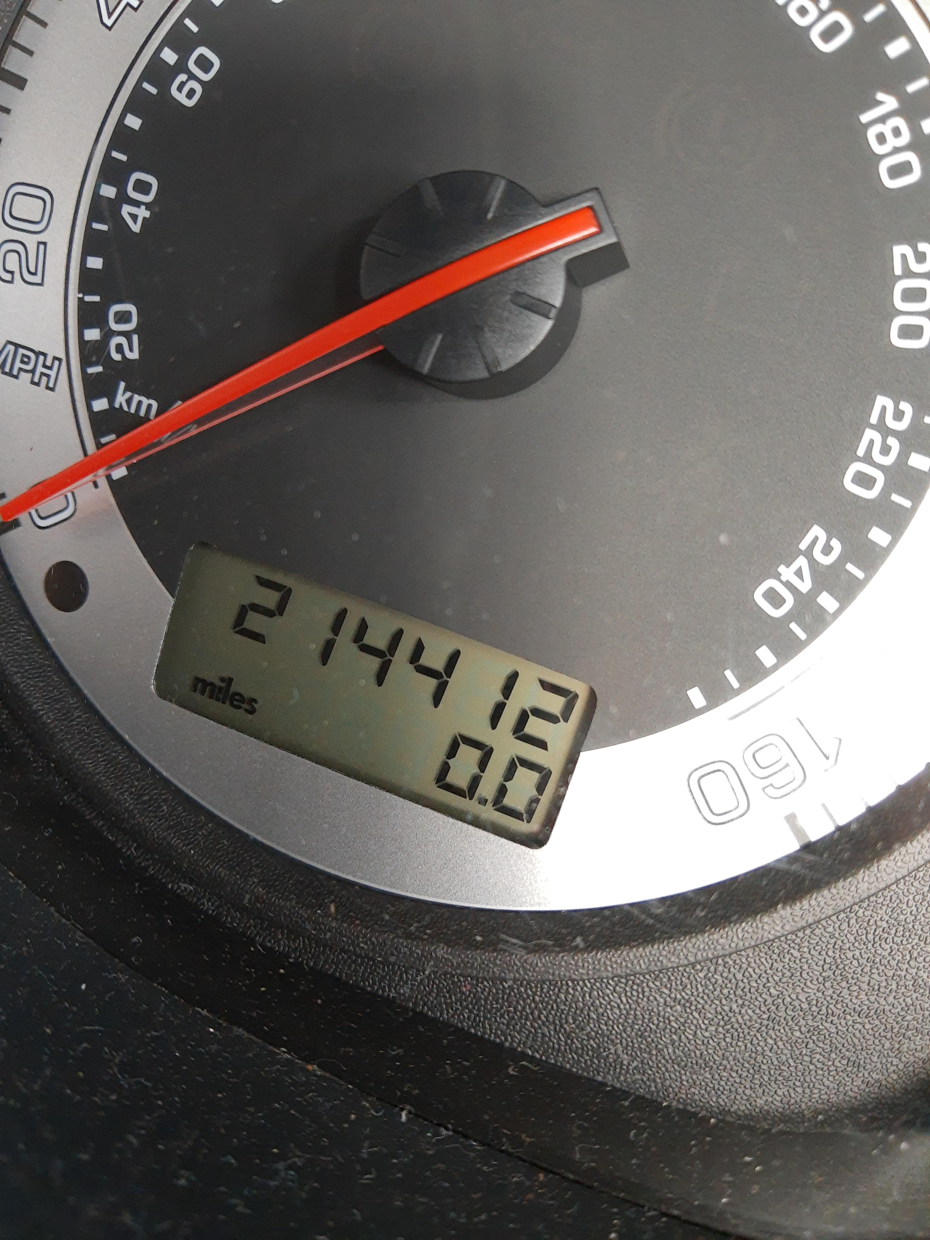

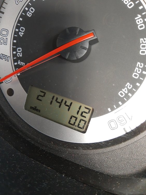

Where's all the high mileage people gone?! 😜 Not doing anywhere near as many miles as I used to. Missed the 214k mark but happened to catch the palindrome as I stopped to fill up and reset the trip.
