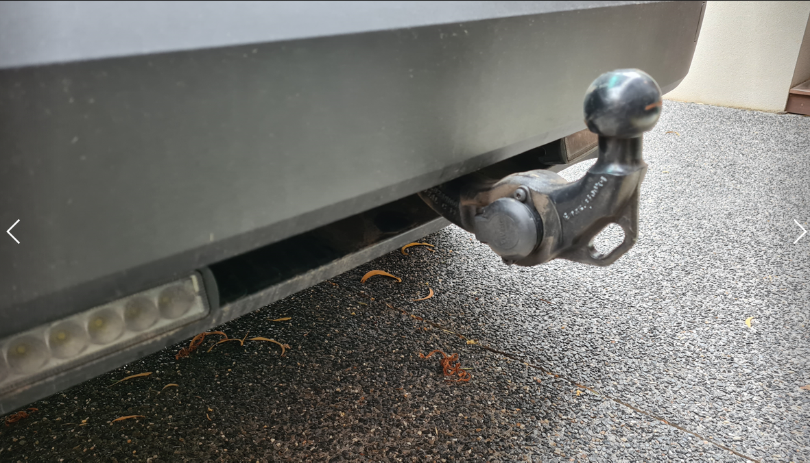

  2. Yes that's what I have and yes it can be installed with the virtual pedal. The kit for that towball actually comes with a new set of sensors for the virtual pedal as the originals need to be removed and repositioned which would destroy the adhesive tape. The dealer who installed my tow kit (Geelong) didn't install the replacement sensors, they just taped them to the bumper with painters tape. Consequently every time I walked past the rear of the car the boot opened. I had to remove the bumper and attach them in the correct position using the adhesive tape that was already on them but never used by the dealer. To be fair to them, they were newly a Skoda dealer having previously been Ford I think so the techs were probably learning as they go. I scanned the installation manual and attached it to this post if you'd like to review it.
  3. It was installed pre-delivery, presumably by the dealer. (wasn't a perfect job but that is off topic). If it's out, and you pull the button it flops down and then you push it back up with your foot until it goes "clonk" and the magnet sticks again. You can't remove the actual tow ball, it's the same piece of metal as the gooseneck. Very different to the typical Hayman-Reese thingo that is common in AU.
  4. I had it from delivery, that's pretty much how it works. Do you have any specific questions? It sits pretty close to the bumper, how much clearance do you need for the bike rack?
