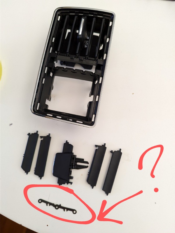

  18. Does anybody know how to reattach the metal bar to each of the vent arms. My children managed to kick the vent and it fell apart. I've tried a million times and it is the most frustrating part in the history of parts. Im generally patient but this thing has me beat
