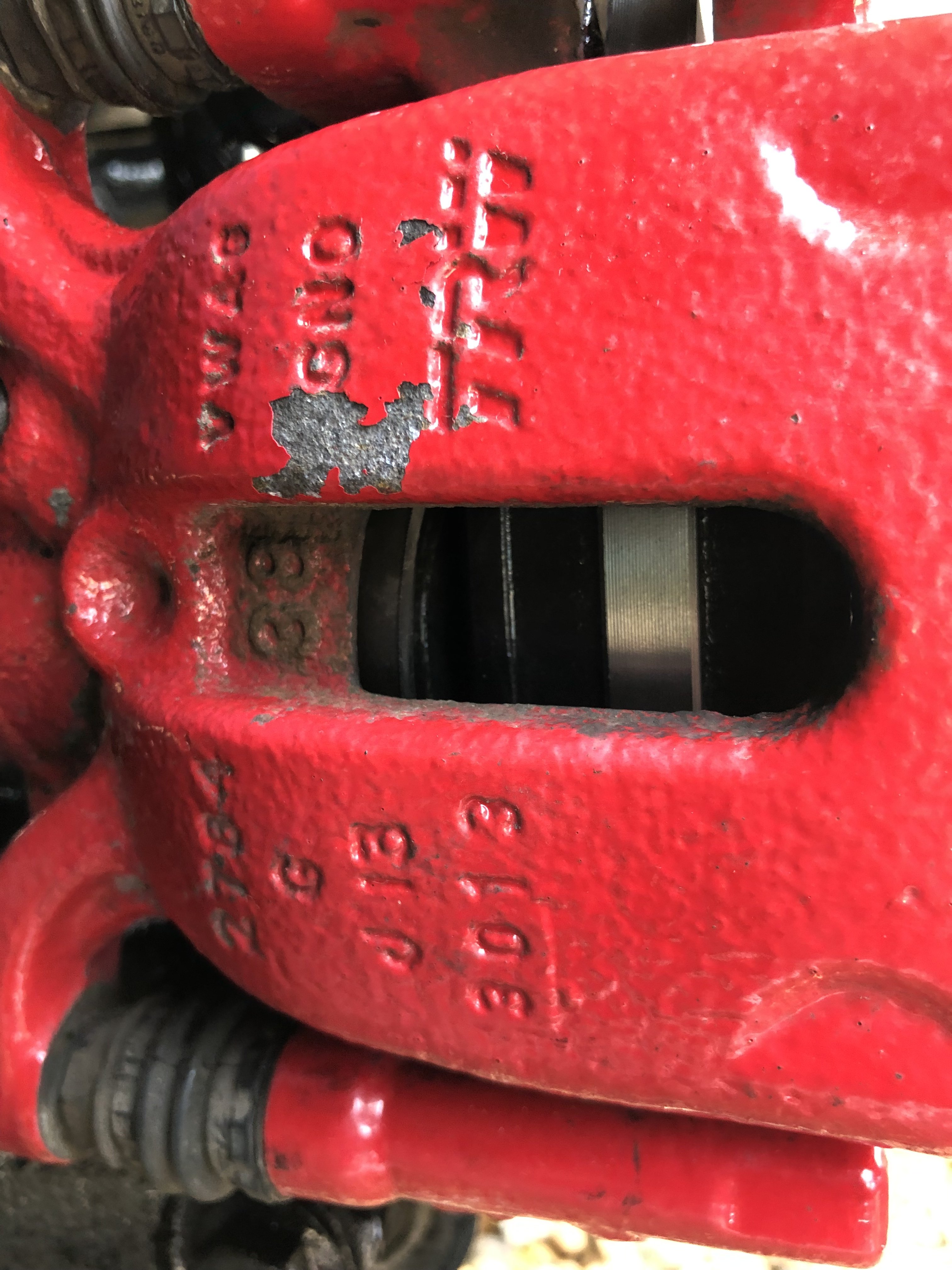

  16. Brilliant thanks very much! Found them. Wonder how much they are from Skoda?
  17. Did my pads and discs today but noticed a small rip in the dust seal on the left caliper. So I’m looking for a replacement. I took a photo but I’m massively confused by that part number! Anyone know what the part number for a replacement caliper is?
