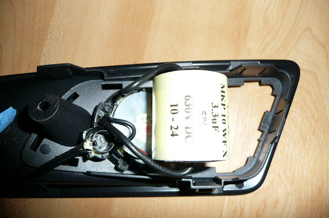

This is a worthwhile mod, but don't bother with the high grade capacitors. I was suckered by the "Audio grade" ones as recommended by Genoa1893 (I've spent a load of time and money refining my hi-fi at home). The problem with them is the size, they're huge! They do fit behind the door card but it's a really tight fit.
Original spec cap was 7mm diameter x 11mm
Audio grade cap 33mm diameter x 35mm
Edited by r6ymy
