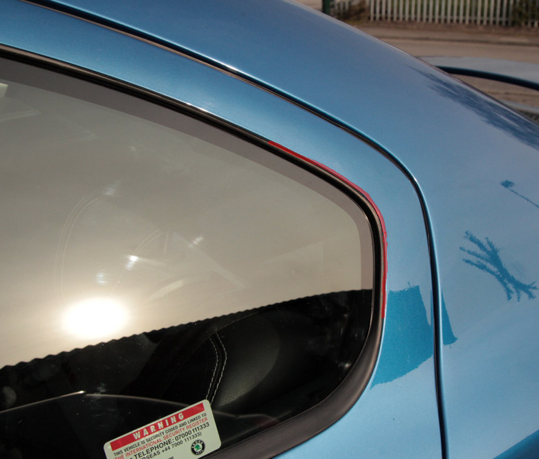

A friend and I spent about an hour driving the motorway between junctions sticking tape around the windows and we found that the wind noise on my car comes from the gap between the window seal and the door. The tape as stuck in the picture below silenced the wind noise on both sides (Except now I I can hear the wind noise from the wing mirrors - with the radio off :p)...
Any suggestions as to how this can be sealed? I'm thinking a syringe with a fine point filled with black silicone might work, but the seal doesn't lift easily and I want to leave the seal looking as completely OEM as possble. I'll probably run extra sealing all along the sill of the window as a tiny amount of water sits in that gap anyway.

There's literally nothing to see. The picture I linked in post #26 shows the locations where I taped off the seal to eliminate the wind noise, so the chances are these locations in your car are where you need to target - tape them and see.

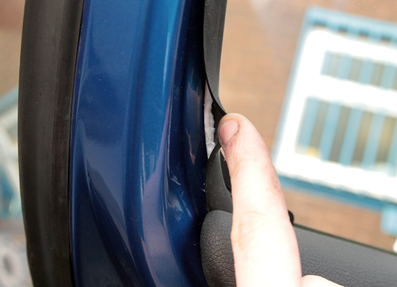

I had noticed that the window and gasket 'assembly' would shift around in the door frame, maybe 2-3mm if I pushed left-right (towards/away from the centre of the car), but not on the other side. The location that it shifted is shown below:
On the inside of the door there is a rubber 'boot' that sits all the way around the inside of the door frame and appears to be the same part that the window sits into on the outside. Lifting this up showed a bit of dust in the location shown in the above photo, so I'm pretty sure that was the offending area.

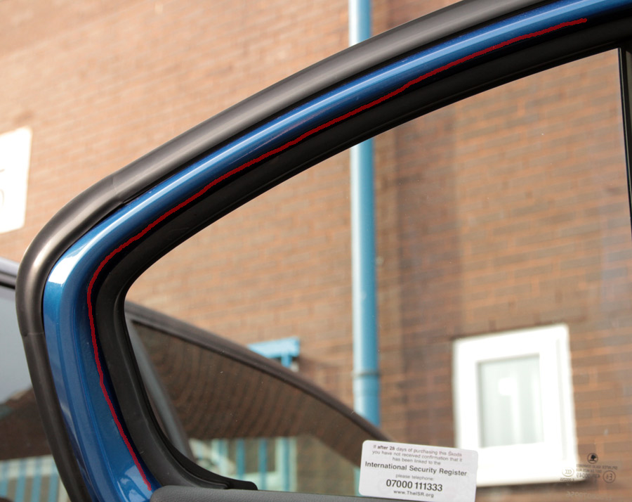

Rather than sealing on the outside (which also uses a very small amount of sealant which might degrade with time?), I chose to seal on the inside. I went all the way round to make sure I got all the possible areas where the wind noise could come in (red line):
You can afford to splodge quite a bit on as it's completely out of sight, plus when the boot flips back into place it will automatically squidge the sealant into the right places to form a seal.
