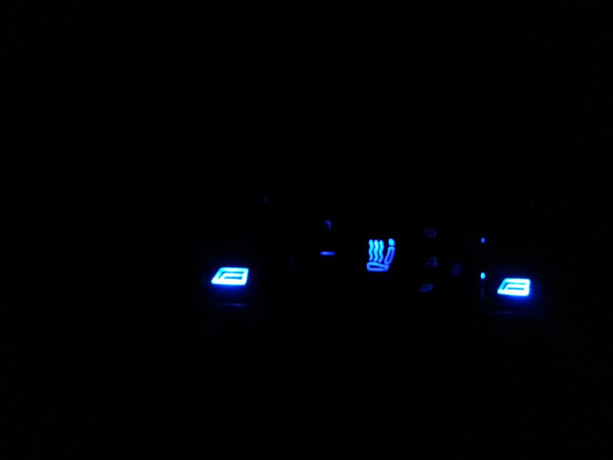

I changed mine to blue led the top part unclips and bulb is one with two copper wires and a green cap on it... and soldered in just don't brake switch as its £70 from skoda
