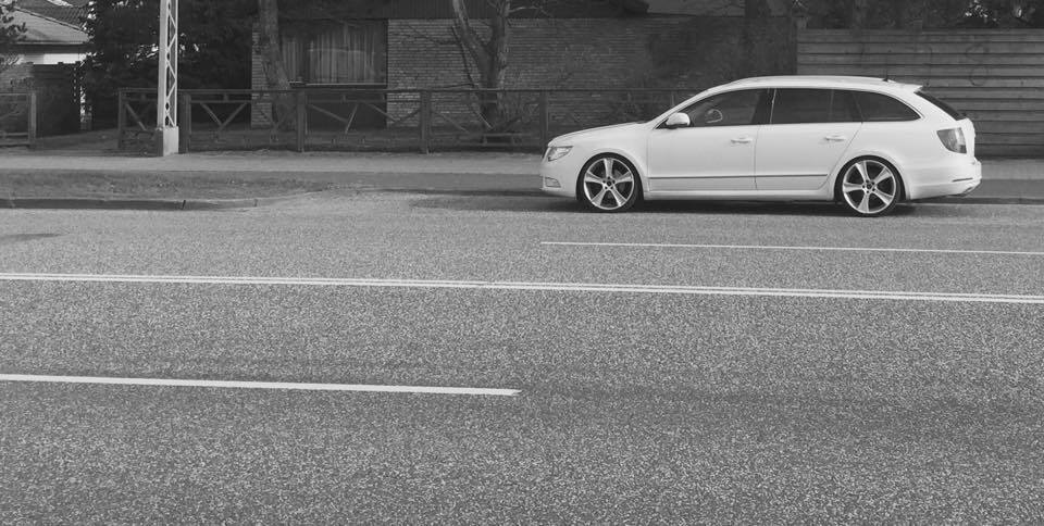

Specs of the Wheel - 8x20ET45, 225/30-20 :nerd:
This is my Spath SP18 - 8x20ET45, 225/30-20.
Wow!!! Looks spot on

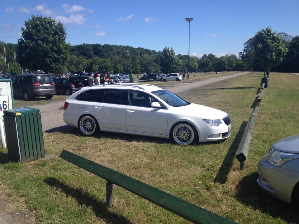

post-129805-0-33624200-1430377762_thumb.jpgAnd this is my BBS LM (replica) - season 2014 :notme:
Front: 8,5x19ET47, 225/35-19
Back: 9,5x19ET49, 235/35-19
Looks really good! I was affraid that 20" do not fit and ordered 19", allready regret my choice. I allso ordered h&r -40mm springs, what chassis you roll with?
10460227_10203151887332891_2667230932234338009_n.jpgAnd this is my BBS LM (replica) - season 2014 :notme:

attachicon.gif10460227_10203151887332891_2667230932234338009_n.jpgAnd this is my BBS LM (replica) - season 2014 :notme:
Nice one! I hade BBS LM 19" last year, sold them and the plan was to buy 20". But since I had the OZ´s I just had to see how they fitted the car and it was OK. I´ll probably go for 20" next year :-P
