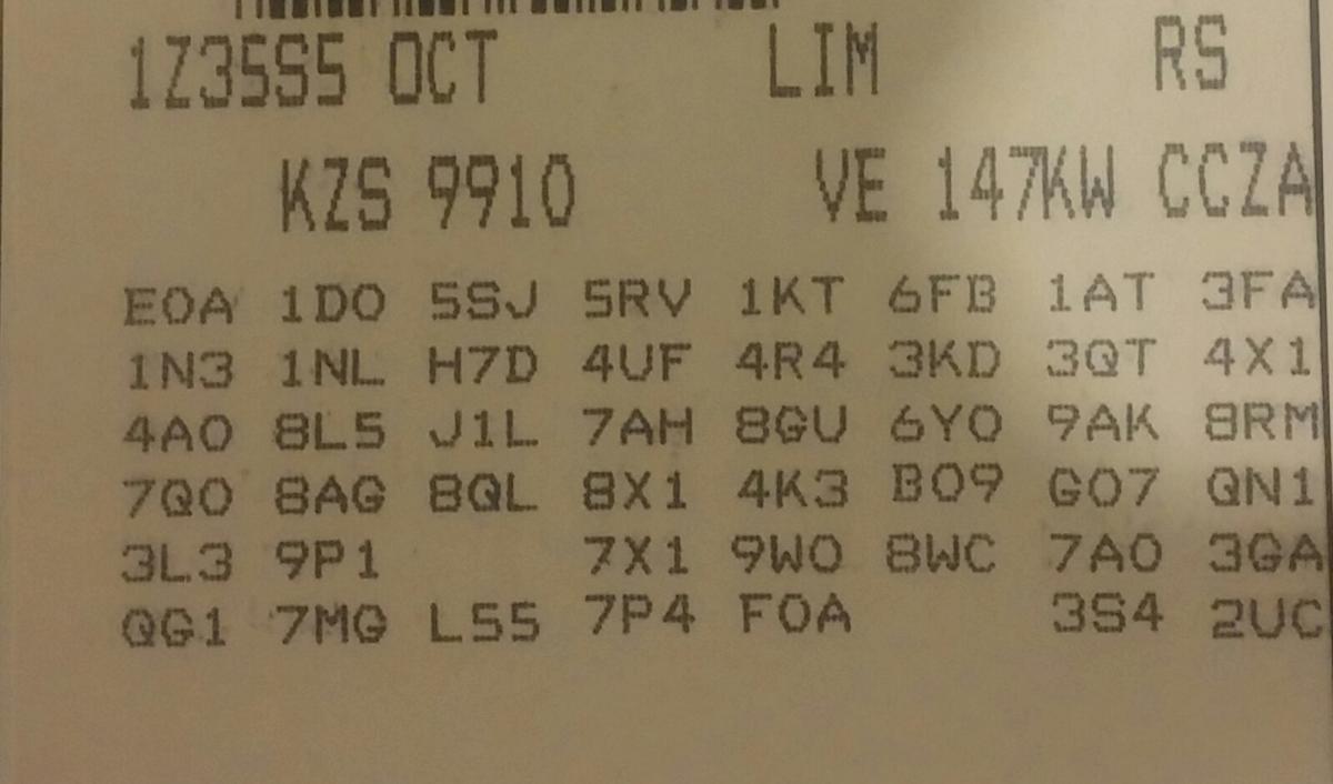

Sorry to revive an old thread. I am searching for the method to determine my rear brake size. I have looked at the sticky on the MK2 Octavia thread but the Brake info has been removed for the time being.
I want to replace my read disc and pads since there seems to be a lot of rust build up around the disc lip. Each time I go for a service/health check, the report always indicates this but it doesn't affect my MOT. I just want to change them since the rears haven't been changed since new and its at 58k (5.5 years). My pads do not need replacing but this is more for my peace of mind.
Could someone please indicate what I am looking for to determine between the two sizes? I have a late 2010 (Nov) Petrol VRS, CCZA. I will keep searching the threads in the meanwhile.

Look at the PR codes on the sticker on the boot floor or in the front of the service manual. One of the codes will be for the rear brakes and should match up with what comes up on the ECP website.

You can run the codes through a website such as:  http://vag-codes.info/#option-decoder   to get the descriptions.
For instance my car has - 1KF = Disc breaks, rear.
Then when you search on ECP for rear brake discs for an Octavia 2.0 diesel you should be able to see info under "Fitment Detail" a list which includes things like:
  Diameter (mm) = 282
  PR Number = 1KF, 1KP
From doing this I now know my rear discs are 282mm

Just had a look in the car. The lable has washed off. Luckley enough my work car (which is another Octivia diesel!) has the lable in the service book. Had a look on euro car parts, ive got 2 rear disc sizes! :/
1U is the MK1 and 1Z is the MK2 Octavia.
If you don't have the sticker then best to get a dealer to check against your VIN for the disc size.
So I was having a look in my service book for the code for the rear brake disc size. It says 1KT. Looking at ECP the discs at this size have a pitch of 100 but I'm certain my wheels at 112. Have I got this wrong?
1KT should be 272mm.  you are right, your PCD is 112mm.

Thank you for clearing that up brad!
