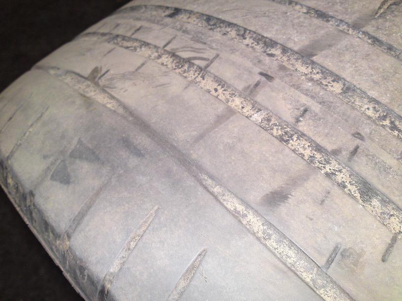

Took my car in today to get the Vredesteins fitted on the rear. Had the alignments checked, albeit not using a lazer alignment setup, all appeared ok.
Fronts have 3mm tread and are wearing evenly, so should last a few more weeks.
1 rear ok, just looked like a nearly spent tyre. The other was remarkable really - as has already been discussed, it looked a little like a 50 pence piece, in a subtle way - there were 5 or 6 flat spots, obviously the cause of the noise.
These were conti 3's. Strange that the other rear tyre wore normally, so something might be up with the geometry at the back, or the tyre was a dud.
The tyre-guy said he's seen this a lot with Conti's, but only on Mercedes Sprinter vans!
Back in the car, noise completely gone - very happy.
Remains to be seen how the Vreds peforme and wear, but time will tell.
Here's a pic - doesn't really do it justice as you can't really appreciate the 'flatness', but look at the lower tread line, which obviously should be of a consistent width - where it narrows (and you can see it narrowing again on the horizon of the tyre) is where the tread has worn down further.
