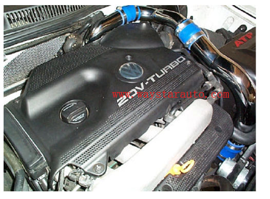

hi would a golf mk4 gti turbo fmic kit fit a octy mk1 vrs......i no that the kit doesnt have the map sensor plug on the pipes but would the pipe go over my engine and bolt to my turbo as it does on the golf? any info would be great full thanks
this is a pic of the kit
I have been looking at this and as the engine layout is similar/identical I was considering this route as well. I have already modified the Turbo to Pancake pipe as it is really prone to leak boost. But the pic you have up is of the larger intercooler core (like the Forge one) which will be a bit too big unless you plan to go big turbo
why is it to big???
that size is fine pressurised system there will be no extra lag on a single pass core

so this kit should be fine then also does this kit replace the pan cake pipes and other standard intercooler pipes...as this kit ithink goes other the engine and the pipe goes on to the turbo and the other one goes from throttle body to intercooler? am i right....thanks
Edited by vrsjaw
yes mate thats correct does away with the pancke pipe as it runs down the right hand side of the engine to the turbo good way to do it if you have room as its not then bolted to the hot engine block like standard
i thought the pipe off this kit goes under the front panel then up to the front of the engine and over near the rocker cover and then near the tip ?
yep i think thats what i said right hand side of engine???
:giggle: sorry i red it wrong....so il buy it then :thumbup:

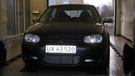

this is trhe diy kit i did on my 220 turbo

The kit will fit the VRS but you will need to be prepared for reforming some pipes and bending them to accomadate coming up through the front of the engine and slam panel up and over to the rear of the block to the turbo. Probably also on the other side to get a nice bend to the side of the inner wing up to the inlet.
As been mentioned there are a few folks on here that have done the DIY route with success and at the same price a that kit. There Kits however had the turbo pipe routing underneath the radiator and back through the standard route(like the ABD one) to the pancake pipe, thus avoiding any reworking over engine. I think that looks better than a pipe sitting over the side of the engine IMHO.

I Too have been looking at these FMIC's however, there is no nipple on the turbo pipe for the N75 valve.
or dumpvalve but easy to add on cost prob £10 to get someone to add to ports
if i orderd this kit of the pic i posted where does that pipe go to ..the one that goes over the side of engine .i know it goes to the turbo but i cant see where the out let is on the turbo...
is it that big silver pipe that goes near the back of the rocker cover? also bin speaking to a lad who says he can map mine to all the mods av put on with out driving the car?

Ill have to take pictures of mine, as my pipes are very similar to your thumbnail above Rob, they route the same way down the side of the engine...
