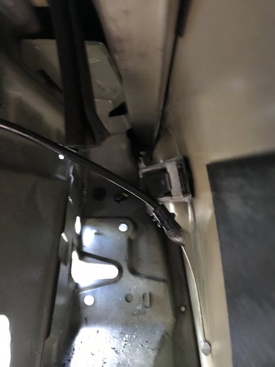

This is the box you are after, note the connector, it fills with water and has no where to run away,.
The clip here pulls up and the connector pulls out at the same time

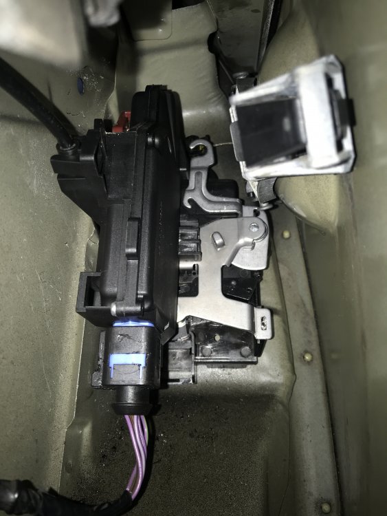

This is what I found:
I used some contact spray on it and it worked a treat.
Make sure you check this too!

Tried this today, great help in getting to everything but the connectors in mine are fine no sign of corrosion at all, looks like a new motor for me !!

Well I tried the contact cleaner but alas no luck. Bl**dy thing still doesn't work and now the inner to the door handle has stretched so I can't open the door from within. To make matters worse you can't take up the play from the inner door handle end so the locking mechanism (& attached motor?), has to come out. A ten quid cable and mega fiddly trouble - unless anyone has a better idea or experienced this sort of thing before. Incidentally, what's the black box thingy for? (the bit shown in the photo's that leaks water).

sorry if i sound a bit dumb but what connector is it that is getting water in?
is it the one on the bottom of the window motor that is in the pic above wrapped in cling film?
yea thats the one.
the blug goes in and seals in but some how it seems water seaps in to it thru the actuall box then gets stuck at the connector pins.
