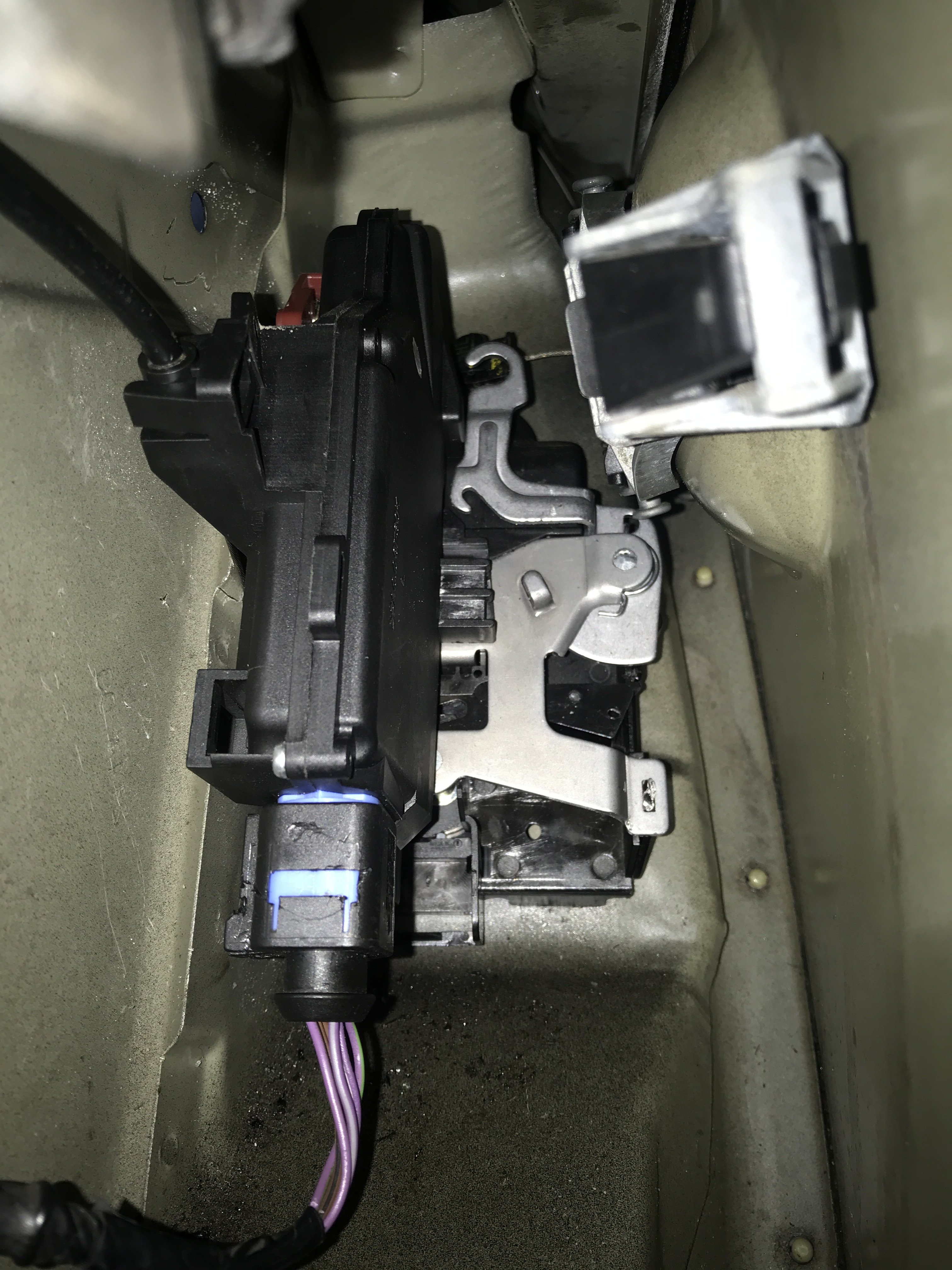

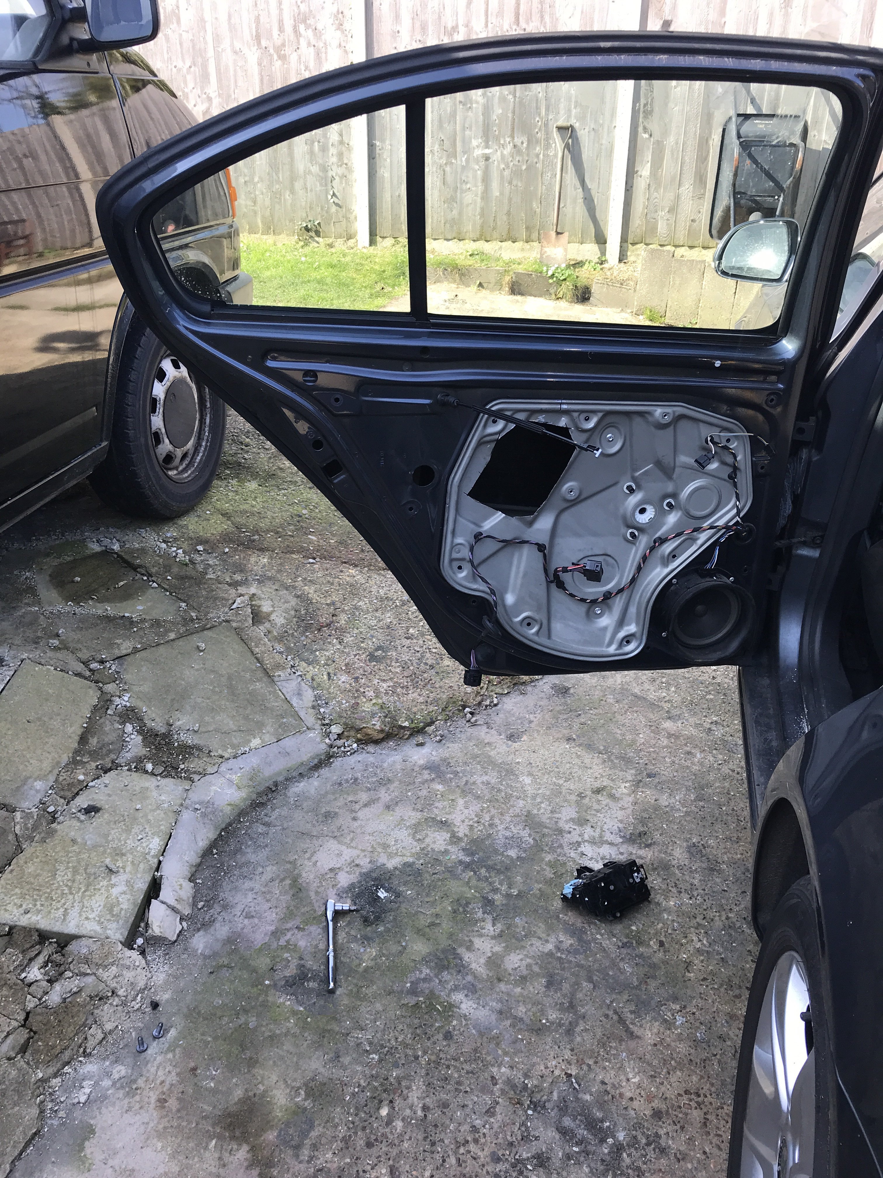

Appreciate your reply’s fella , could you direct me to what I need to try to make move to unlock it ?  I guess it’s not the end where the plug goes onto it , I kind of have enough access to get my hand in there but just don’t have a clue what I am supposed to be trying to do to the actuator to make it unlock ,
i can see the motor under the plastic I broke off but not much else ,
i am at end of me tether with the thing , wish I knew how to unlock it

Right, once you have exposed enough the innards of the mechanism, there a gear setup from the motor to a large cog that spins a "bolt" that bolt slides the dead lock out into postion and also rotates the locking levers.
It is spring loaded to want to stay out.
So, you need to get 2 narrow allen keys into the mechanism.
One to turn the cog, and thus the bolt, and the other to hold it in place while you reset the turning one. I cant remember which way it turns, but you know pretty quick. Turn it one way a bit, and let it go, if it springs back, thats the correct way.

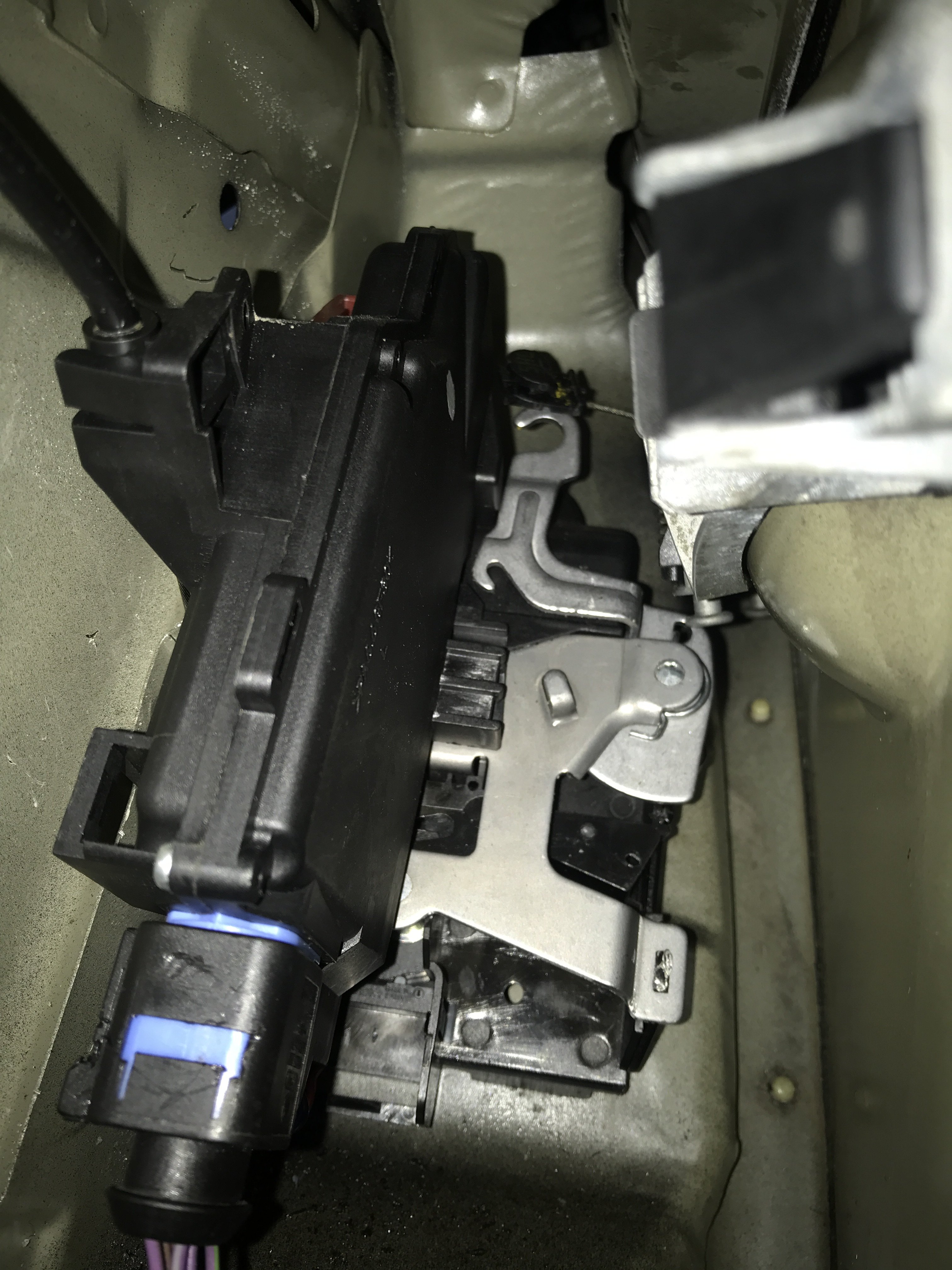

well now I have a loose cable from door handle, how can I reconnect that? Does the door handle outside need to come off?  I not sure where it connects to on the new unit?
Also so I have plugged the new unit into the wires and there doesn’t seem to be any life in it!

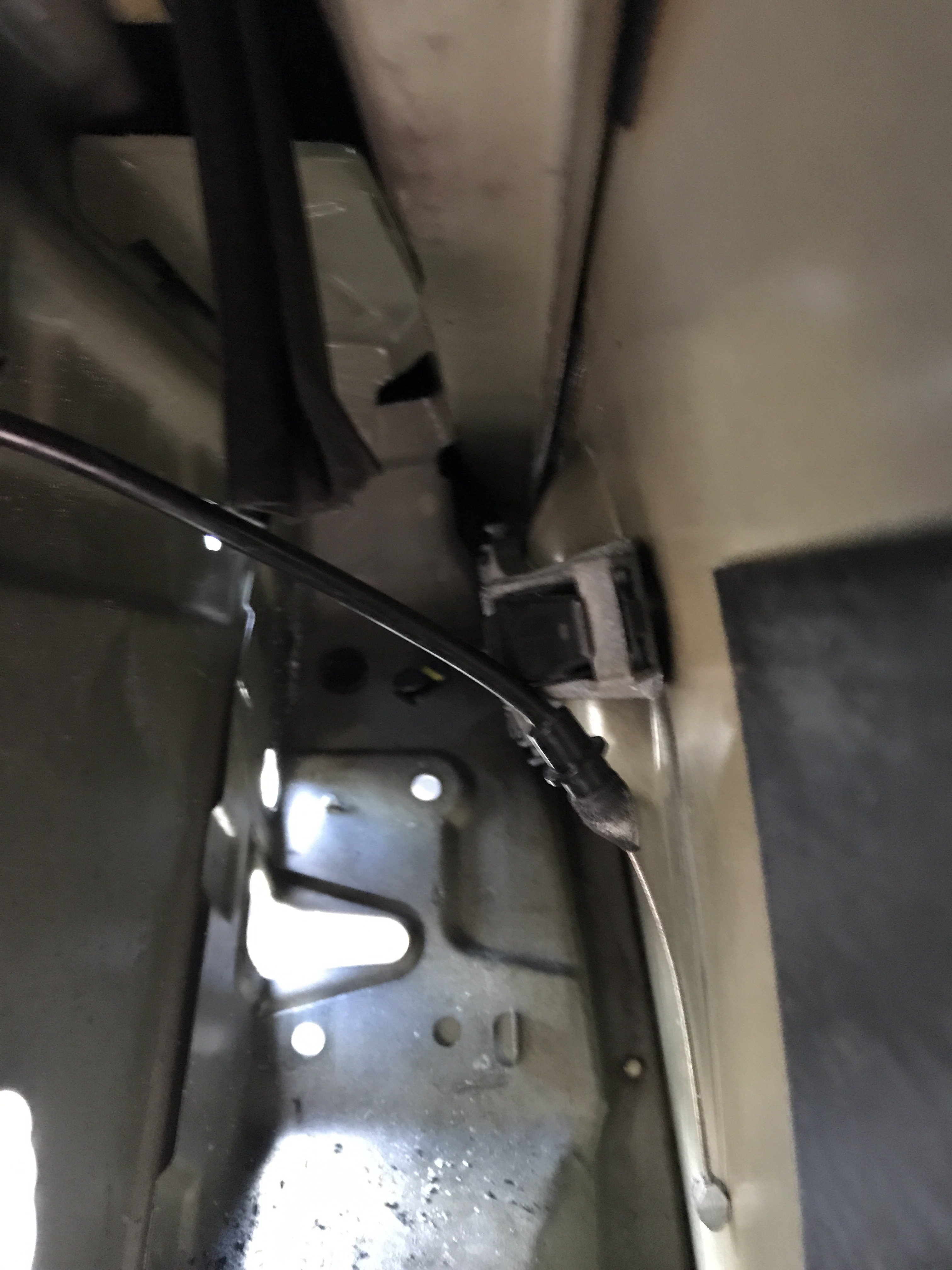

Ok can someone please explain to me how I am supposed to connect the outer handle cable to the hook (top silver)
i am going to try the both cables connected to see if can get lock to pop , if not it’s going to have to be another demolition of lock which will be bad news as I have terrible headache an stress  from this now
Ok I managed with continual tap with hammer to the new lock to hear the mechaniasm move which released the lock! so I managed to open the door,, what a relief!
So I shall now buy I used genuine part rather then new Chinese part,
Does anyone know if it possible to connect that handle cable from the inside panel or does the handle need to be removed?  the cable is already connected to the handle part it is the cable tot mechanism that needs to be connected and how to do that I was fiddling with it for over an hour and could not get it to connect (blind with one hand in confined space!)

from memory (in a mk1..) its was easier hook the cables on the lock and feed it through to the outside.. dont need to remove the handle, just the back end covered part (needed to be off to remove lock mech anyway i think?)
