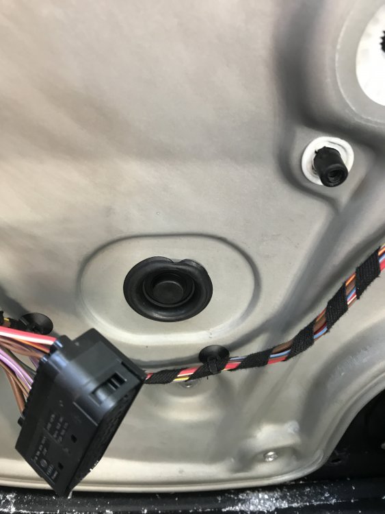

Hi, so I removed the drivers door panel and now am pretty concerned that I need to drill pop rivits out to get to the next part! Is this where the wiring goes bad as the stuff I can see looks fine! That goes to windows etc 84D34533-1716-454E-8CDE-DD872F0BA662.thumb.jpeg.44518f31f1366a659db42d01543004b7.jpeg
The wiring is the multi-coloured bundles. You need to continuity check the wires (and if it's just a CLS problem, need a wiring diagram to tell you which wires) and inspect the multiplugs that connect (there's an example of an unused one on the end of the blue and brown pair about  mid-door left) for corroded contacts.
The wires around the door all seem fine ,  there is no power getting to the wing mirror as it just turns the left side when the switch is on the right, also indicator in mirror not working also the locking actuator not getting power , I found the wiring where loom joins door to main body of car was very corroded, I cleaned as best I could and put small gasoline on the connectors , has not rectified the problem , I not sure if there are wires underneath the door panel that need to be drilled out and looked at ?
It's quite possible that the broken wires are in the door bellows (not illustrated).

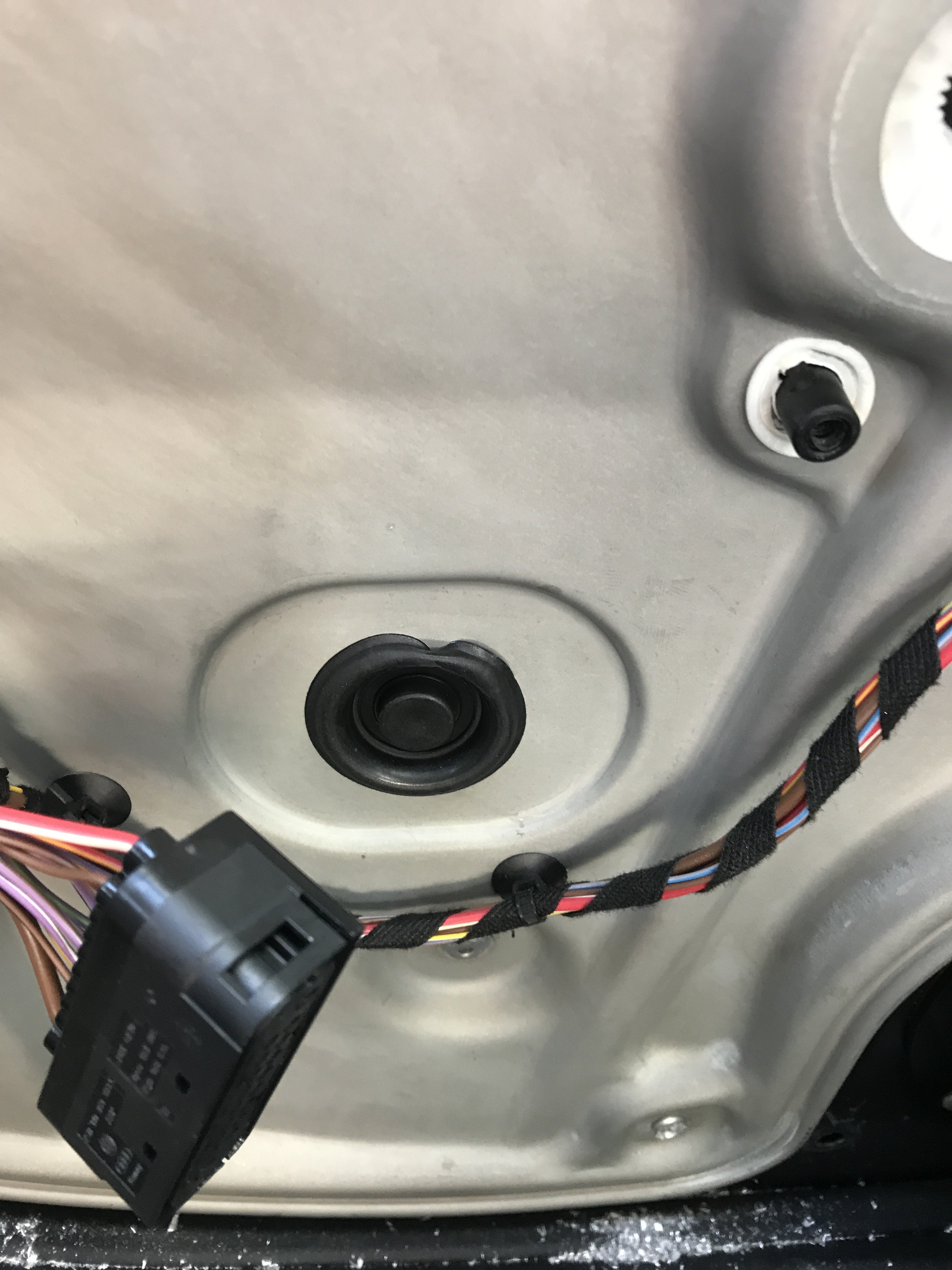

, I intend to do the back door first now as I have the new actuator so will at least be able to finish that once started,  , one more question, does the window have to come out to fit a new actuator door lock ?

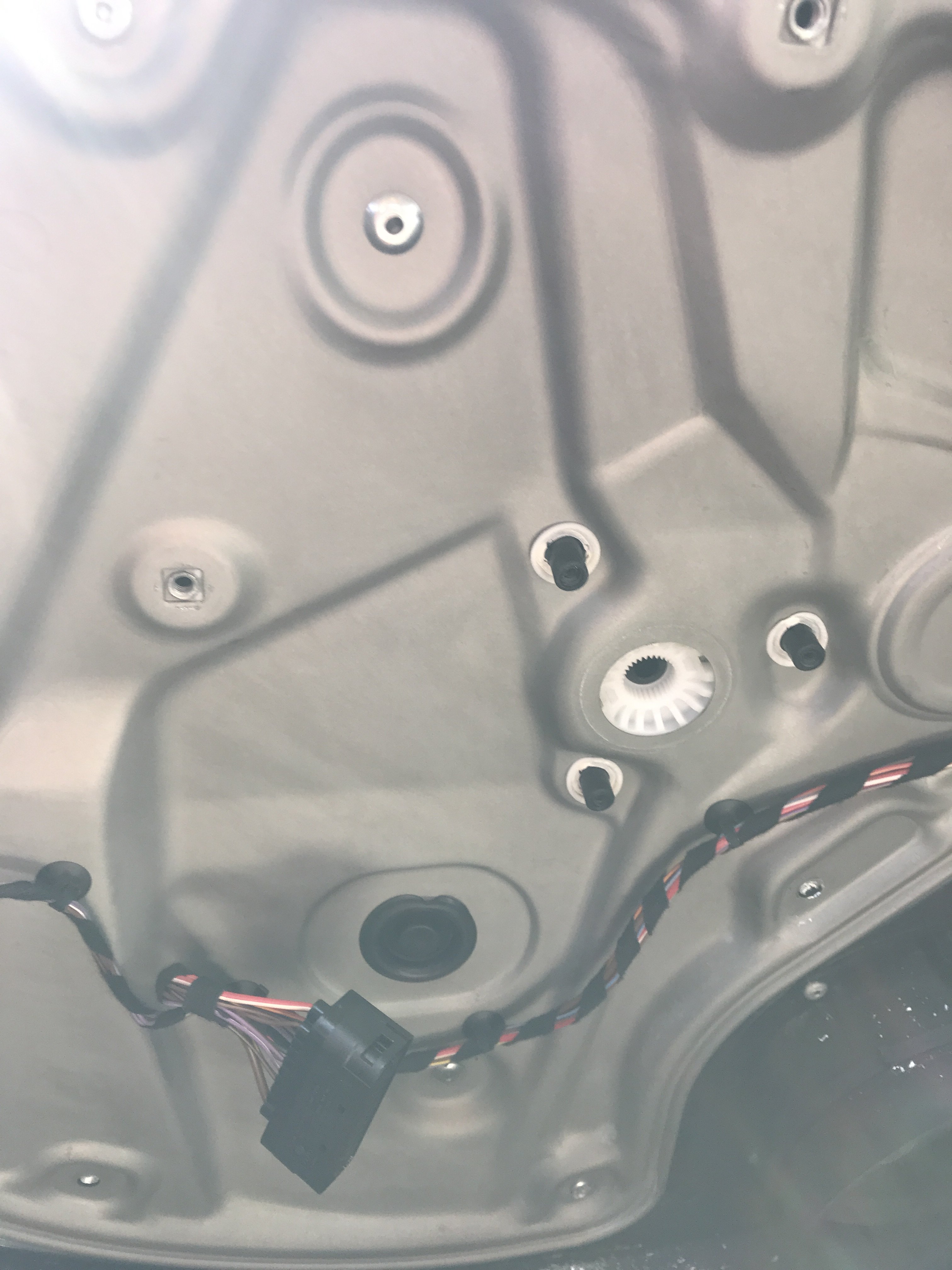

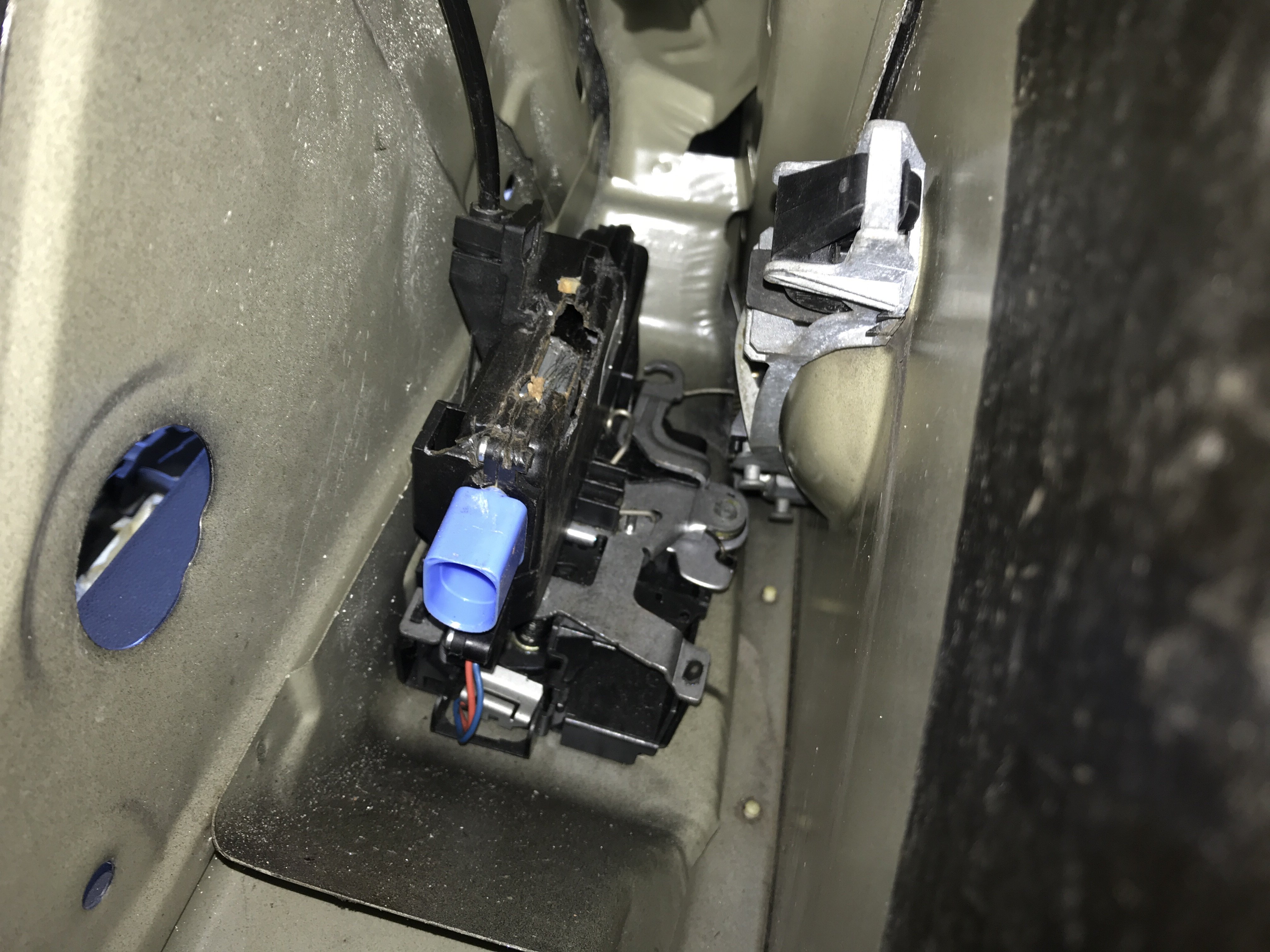

This is where I am currently with closed rear door to change the locking actuator ,
can anyone who knows tell me if the window needs to come out as I have drilled the rivets now and the window cables are behind , I can feel resistance so don’t want to break anything !
Not sure the next part to do this

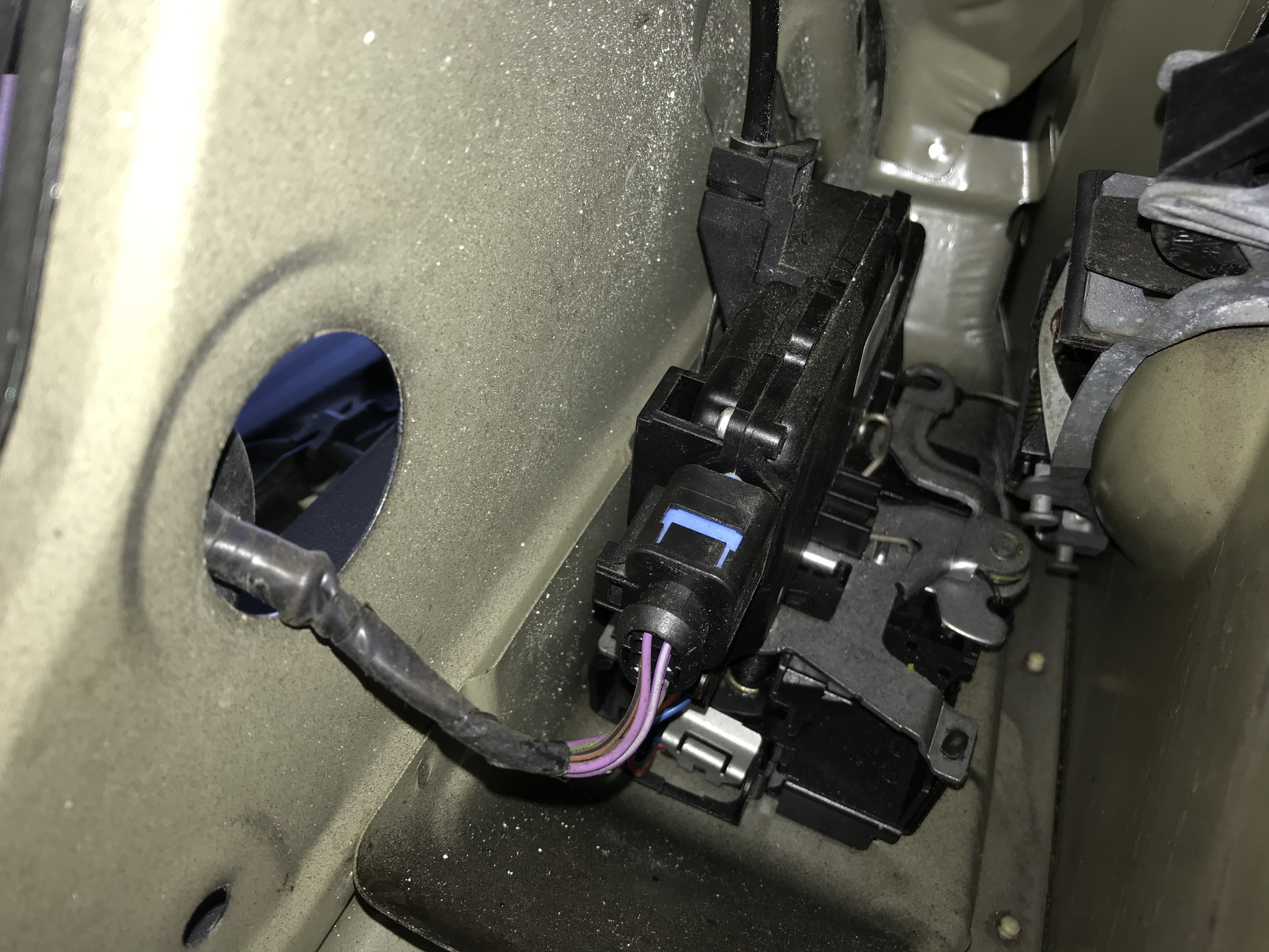

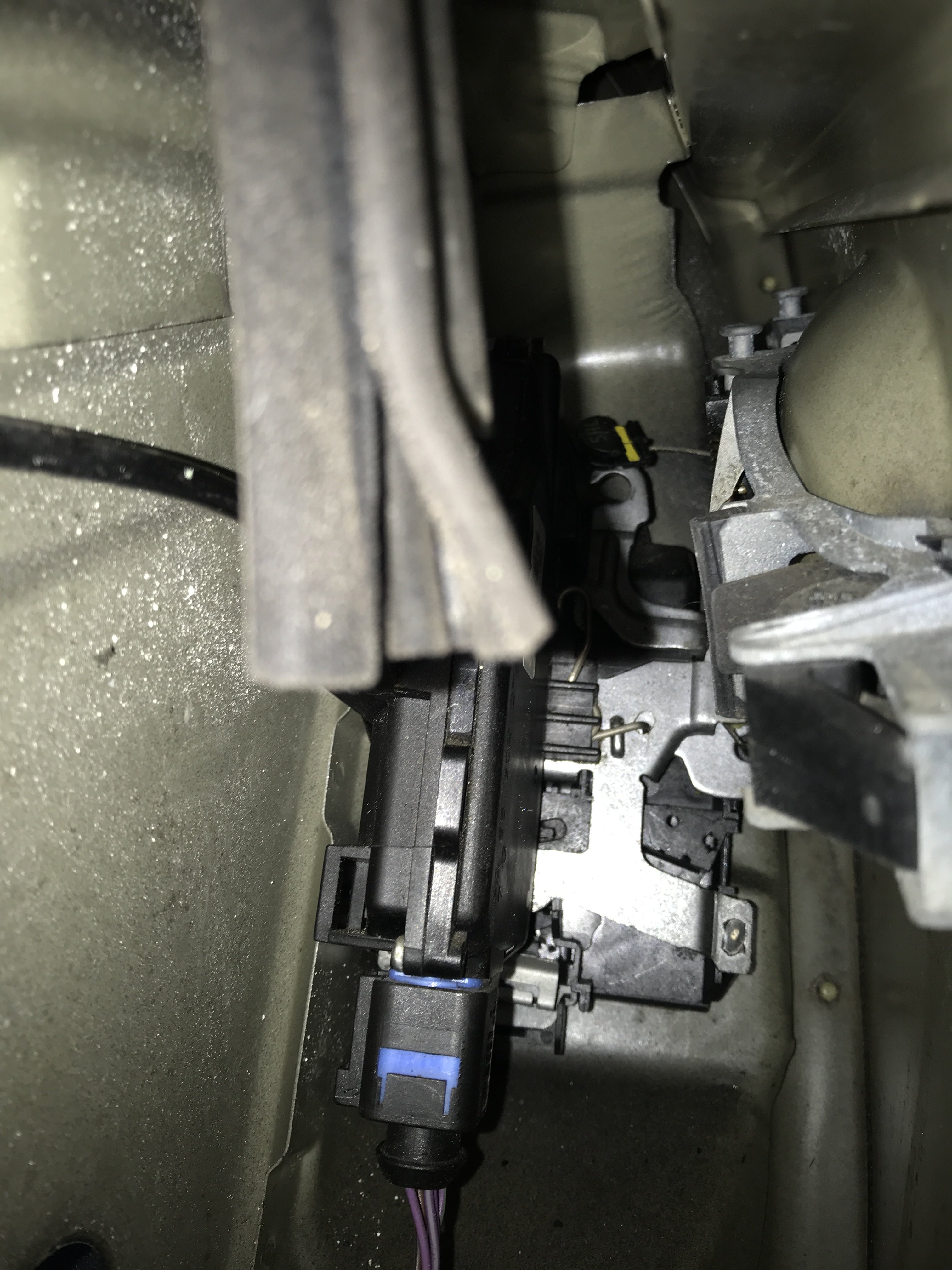

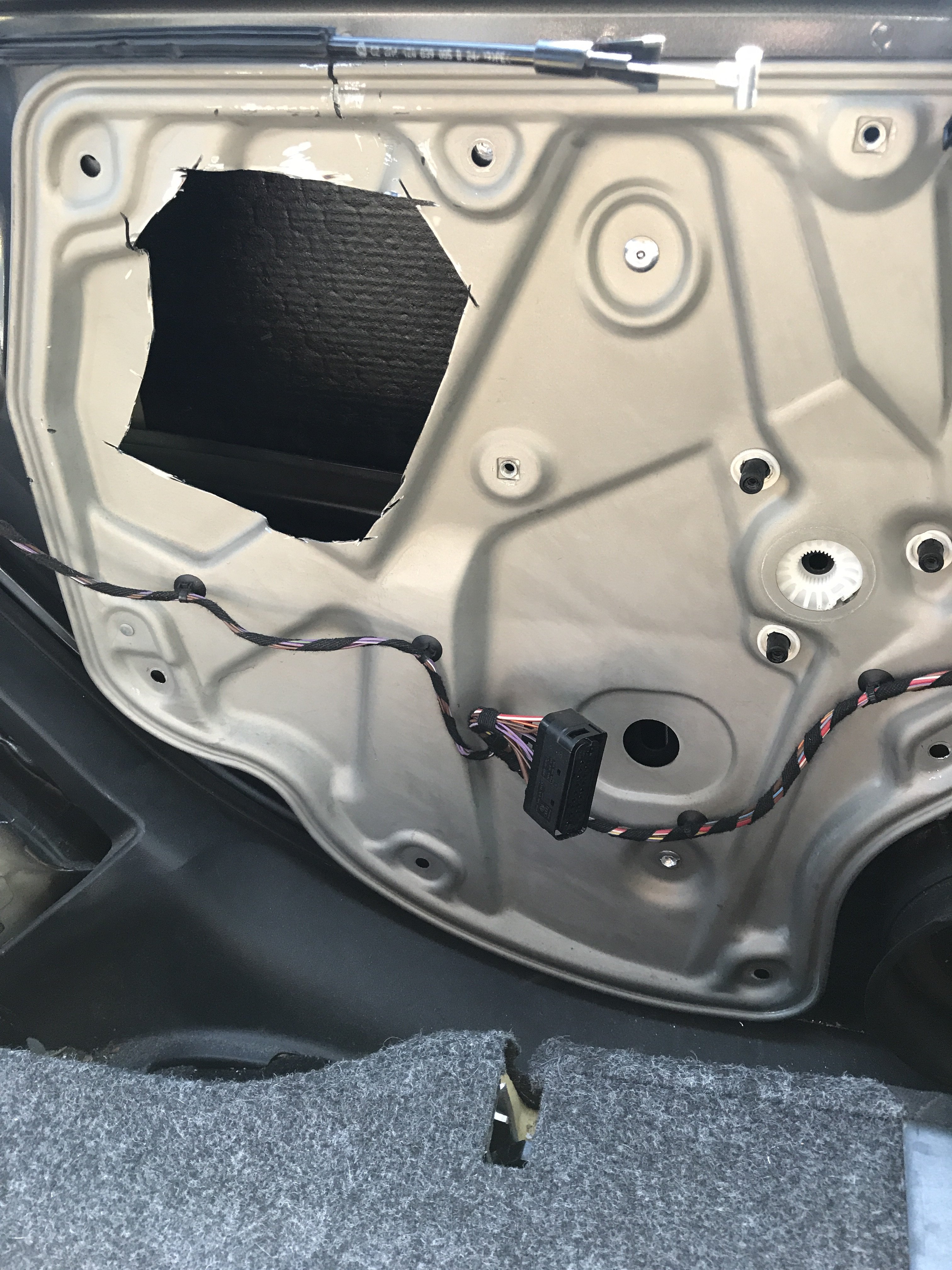

Hey thanks nige, I am past the point of return and after talking to Skoda main dealer on the phone they told me there is no way to save the panel (the metal one ) so I cut a hole in it, I can now reach with my hand the actuator but cannot for the life of me get it to unlock , I have no idea how I am going to get this door to open and the worst of it is the cable from outside handle has now come off  so I can only use interior cable to open the door if I can get the thing to unlock
here’s my latest, I am totally restricted on room and can only just get my hand at the acuator
Anyone know how to release the lock with it as it is?
You need to get at the side of the lock mech to cut it open, hopefully enough to expose the drive cogs inside
There are two motors in the lock assembly unlike the MK1 that only has the one, you might like to try this, from the window motor 18 pin connector, pin 3 (Lilac/Grey wire) this is the common for both motors, then motor 1pin 15 (Lilac/Green wire ) & motor 2 pin 5 (Lilac/Brown wire)  so by applying a supply to either  pin 3 & 15 or 3 & 5 this should directly drive the motors, I can't say which is the lock or unlock motor though
There is power to the thing as it’s still connected , it’s completley dead, I need to manually unlock it , I saw somewhere that there’s a point you can drill into but that’s not option (I cannot find that info now anyway) but I need to release this with one hand blind as can’t see in there while my hand in there, I’m completely baffeled and it’s no longer enjoyable at all!
Not necessarily true; prove that with a continuity test, or try running a temporary wire from another transient live in the CLS.

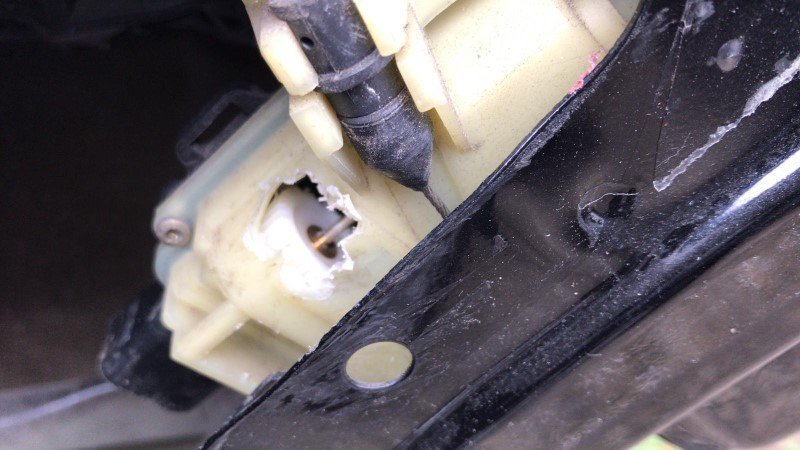

Think I have been defeated, I have smashed a part of the side plastic from the actuator but just cannot get anything to do anything with screw driver chisel into the guts of thing , I think I’m lucky to still have the inside cable attached
