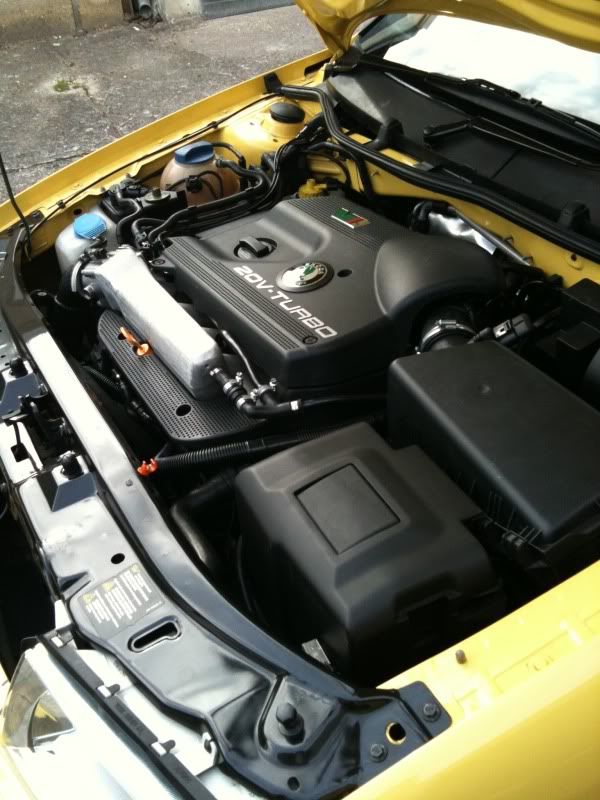

A few issues after getting the engine in and all fluids topped up, like leaks from power steering system and coolant. But all sorted now :thumbup:
From earlier today before fitting bumper shell, and plenum scuttle cover/wipers
Edited by Leeboy

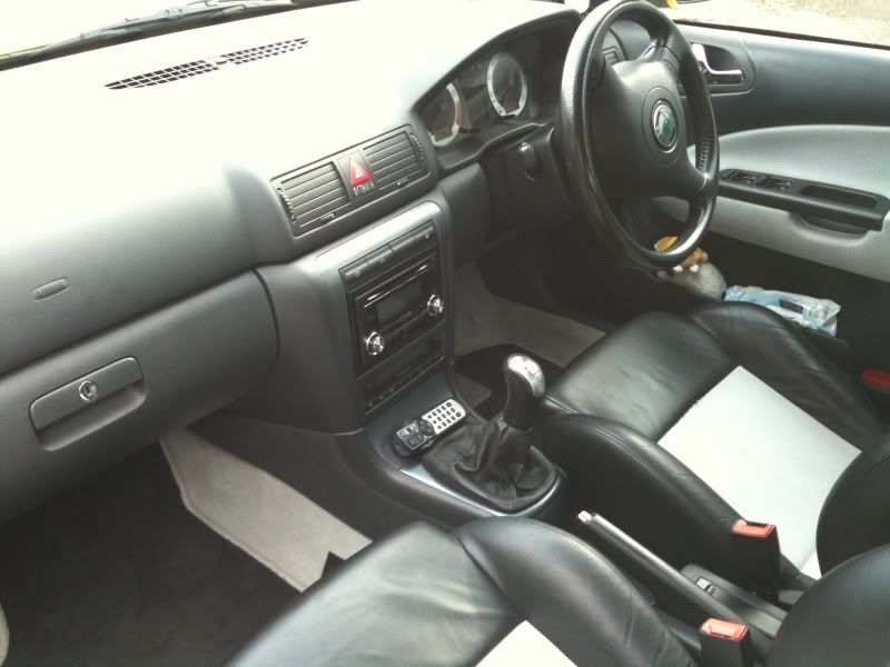

Today, number plate on (had to cut screws off flush with boot lid), gearknob on (replacement thanks to Mark), also removed rear Skoda badge - not very good condition so need to get a replacement.
Also need to make a shopping list of a few other minor bits and bobs to complete the engine bay (like fuse tray holder that sits on top of battery)
Radio install underway - sorted drivers side speaker wiring, still need to do n/s and put in the wiring for an amp and sub in the boot.

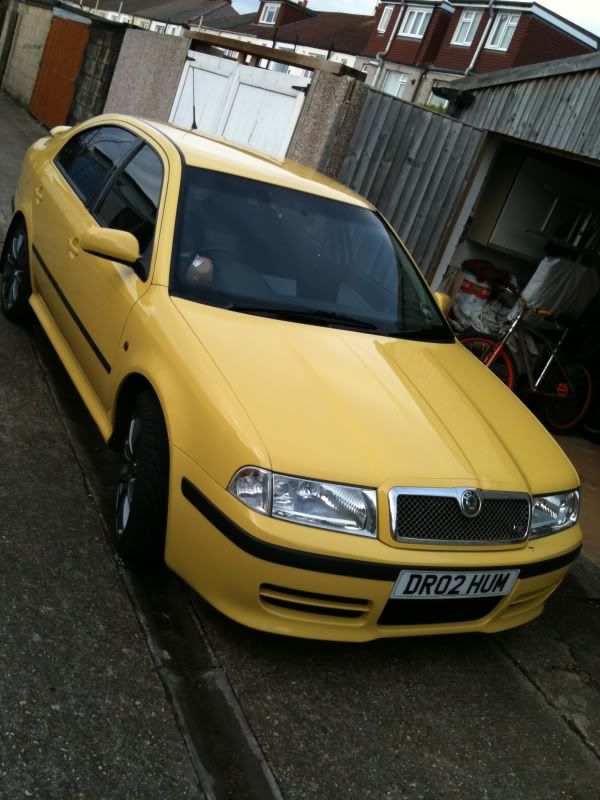

Most of the above now sorted, gave it a washand wax this afternoon, all looks good despite it now being eight years old!
and it use to look like this until feb of this year:

thanks, yeah, you're right about enlarged through the slam panel, also though, there's the drillings to take upper strut brace and cut outs in the under side of the bonnet.
All bits that came off have been sold on to give others grin factor.
Car went back to standard so it could become a daily drive once again. Previously it was getting next to no use whatsoever!
