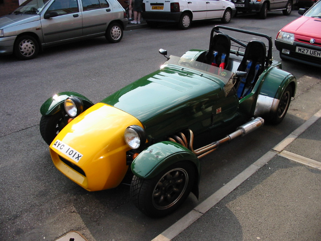

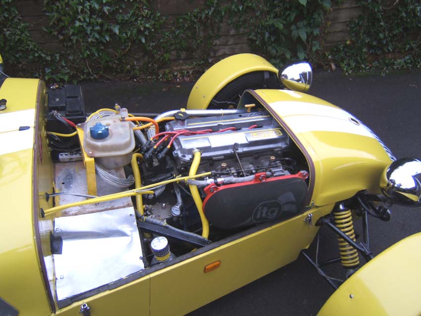

Here is my Brothers Westie which we fitted a Fireblade engine into :D & My Seven which we put a Ford Zetec into with twin 40's :D
Both were pretty awesome machines in their own rights ...

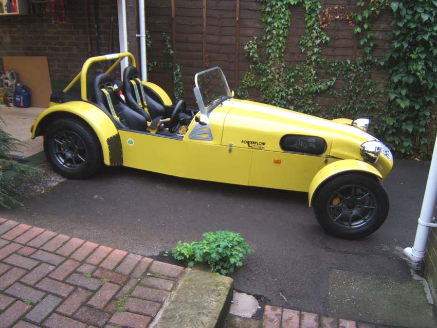

:) My kit car...lots of fun to build, and even more fun to drive. :giggle:
