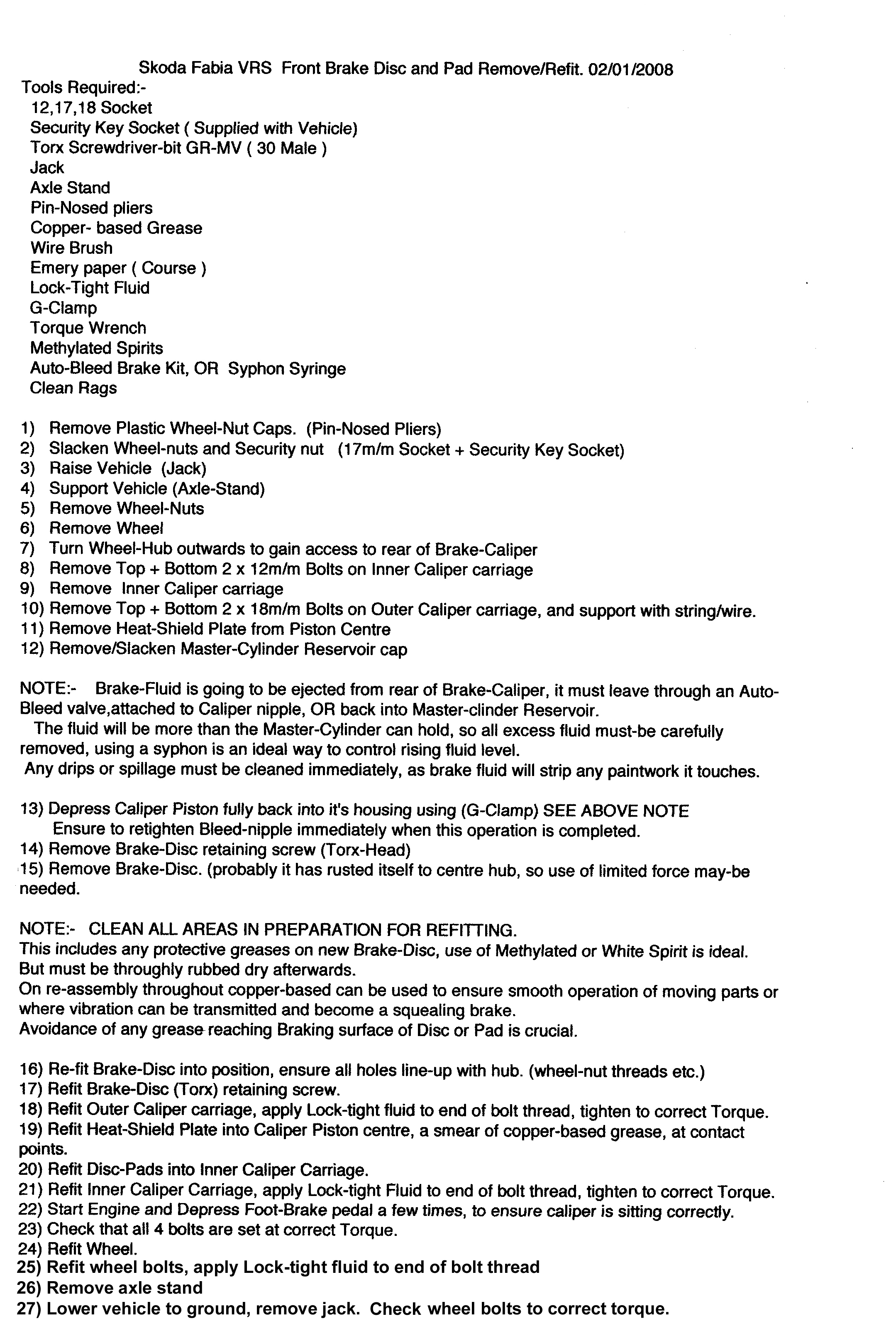

The bolts come with the new pads.
If no new 12mm bolts just put a dab of 'LOCKTITE' on end of each thread end bolt.
Make sure discs don't also need replacing.
Attached write-up, missed adding ring spanners 12mm and think 14mm, (for brake carriage runners.)
No wear sensors on my pads, I just cut them off if they are on new pads.

I'm not completely "with it" with Fabias, but I'd reckon that a 1.9 Comfort will have the FS3 (or is that FS2) calliper on the front, which is nothing like the VRS one. If I am correct, and if you have rear discs brakes, then there is more to replacing them than doing the front ones. Maybe buy a Haynes repair manual to fill in the missing parts!
Also, I don't think that Skoda fitted this car with disc pad wear sensors - best way is to get the O/S wheel off and see if you can find a cable coming from the inside pad - this will also let you establish if the pads are needing replaced as well as the discs.

No, its not difficult at all, I was just pointing out that the previous to me poster was handing over probably the wrong info. Only thing to watch out for on the fronts is that there is a "tang" sticking down at the bottom of the front calliper fist assembly and that tang needs to be eased into place first or you will never get both secureing/guide bolts in. For the rears, you will need to buy a piston retracting toll from Halfords - to let you zero or wind back in fully, the rear pistons, after refitting the rear calliper fists Haynes does outline how to get the brakes to sort themselves out so that the handbrake is okay. If you need to replace the discs, the front ones come off quite easily, for the rears, the calliper mounting bracket needs to come off (extra 2-off bolts - maybe buy new ones). To move the rear callipers well out of the way it is better to remove the clip that retains the handbrake cable - it just eases out with a small screwdriver - and presses back in.
I'd say that the next comments on checking the free movement of the moving assembly was said to assist in your bid to get a better feel to the brakes, ie just in case the pads and discs were okay "then check the free movement of the moving assembly" just in case it was seized - either way, I'd expect anyone replacing their brake pads or pads and discs to always do a proper clean up of all parts and remove rust where is was causing a problem, with Lucas front brakes make the guide pins spotless and apply a spot of brake grease where appropriate on the surfaces that touch (not frictional surfaces though!).
I'd like to think that anyone looking after their own cars, would do a brake "clean up" after winter as that will avoid the moving parts from seizing up - its a very easy job if you have front and rear discs - and if you have rear discs, maybe consider fitting some external helper return springs if the handbrake levers are not being returned to "off".
