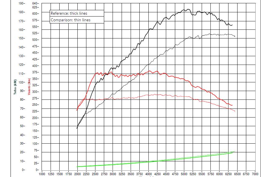

I think I know which car you are referring to, which made 252bhp if I remember rightly, which I'm sure was not accurate. But no it was not that car, the 251bhp car that I'm referring to is a Mk1 Seat Leon Cupra AUQ.
I have posted our dyno plot of the Leon somewhere on here before, but I can't find it on this computer.
If you'd like to know more about how we map cars, why not come along to the open day and we'll show you exactly how. Either that or you can come and show us a thing or do, given that you seem to know more about it we do.
Edit: Found it.
Edited by shark_90
ben a graph means nowt get some logs up of the car
the problem is ben how much do you know about mapping ????
you are the one claiming 251 bhp and a octy vrs running 252 bhp with your map on that has now blown its new turbo??? and the fact it was spiking power and was dead after 5k
i dont wanna cause trouble mate but you got to expect people questioning your power figures when you come on saying you have done something that many a tuner havent been able to do even after spending thousands doing so
i dont think im a guru but like to think i have an understanding of what is and isnt achievable....
you show logs of airflow ign advance boost ect etc then we can see from that how the map is working
this will have fuel logs ambient temps etc etc
this is the only way to see what the car is doing anyone can stick a graph up of silly power means nothing
The invite's there, if you want to come up and talk to us feel free. I haven't said every car will make 250hp, I've said that one car did on rollers I trust. I didn't mention the Octavia because I didn't trust those figures and there's obviously something wrong with the turbo on that car. It didn't run any map for long and has been standard for most of the time that I've known the owner.

i undersrtand from other sources that mikko is one very clever guy when it comes to ecu and and understanding and de coding various faults codes in ecu's thats not what i have a problem with its your bold statements about getting 251 bhp from a k03s turbo
the engine is good for 250
the fueling is good for 250 but the turbo is NOT
a standard sidemounted car can be pushed to around the 220 bhp mark no further and this has been done by certain tuners
thus k03s have been pushed to the limit running race fuel aggresive maps etc etc and still not made that figure
what does mikko thng is achievable from his maps???
mybe saying what i said about what do you know came across rude thus was not the intention just i want to find out how you have done something that hasnt been done if you can back them up with logs etc etc then fair play
i think you are a good bloke ben and have done well it just i dont believe that 251 bhp claim i would have this same argument with other tuners im not just picking hole in your company buddy
