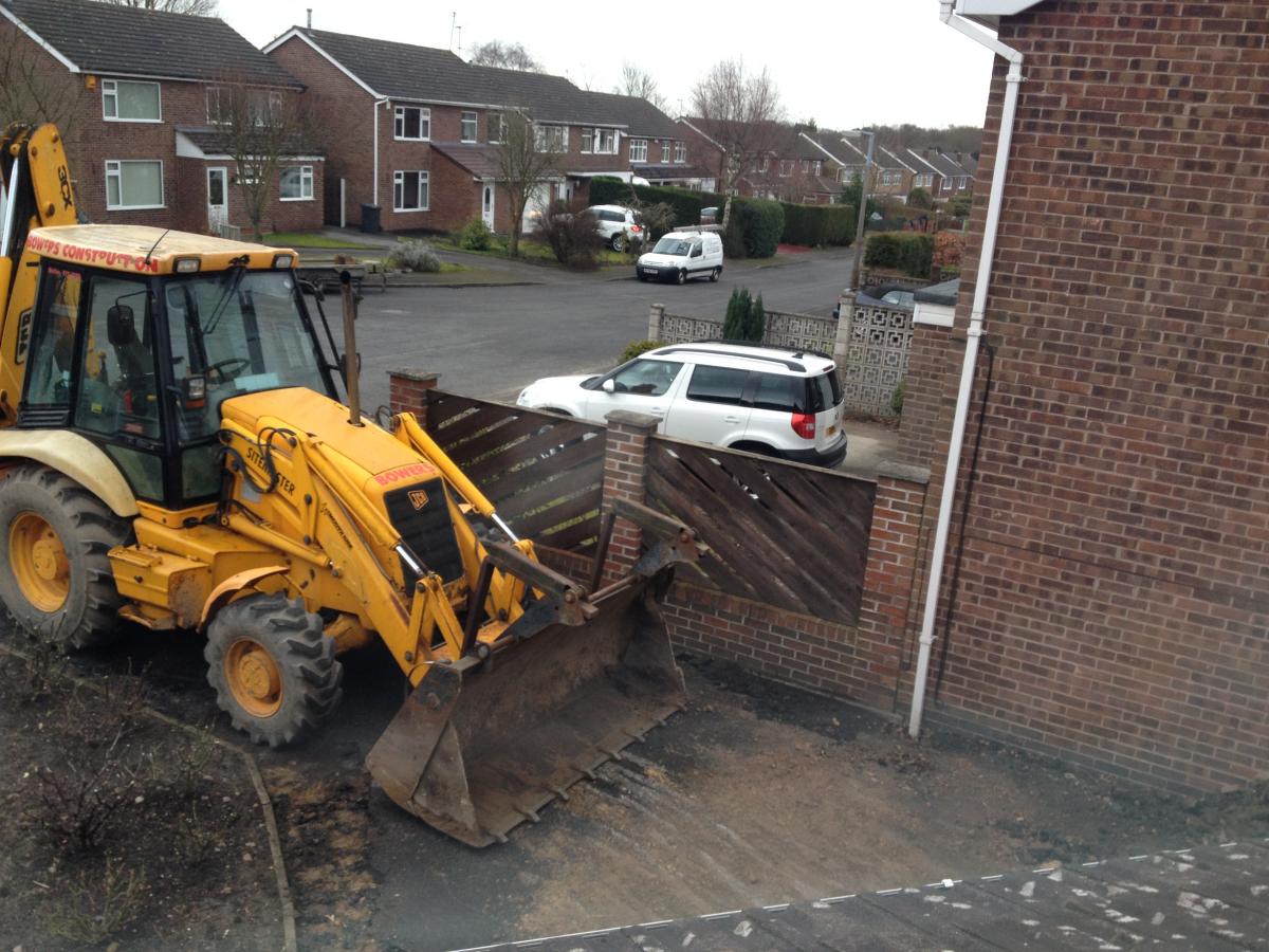

My car is not happy having to spend her time outside on our neighbour's drive. Currently I'm looking out of our home office window at a full size JCB on the drive
That looks a serious bit of kit for the driveway! Make sure that they compact the subsoil VERY well.
I have 4 Yeti sized depressions in mine and I did watch them doing it! :wall:
With the current weather the underlying soil is probably saturated and will require considerable battering.
