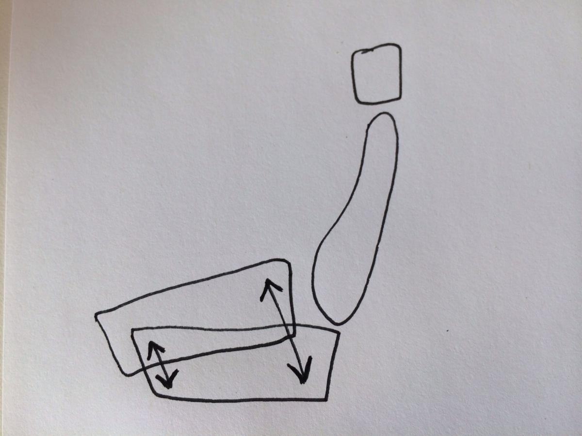

Not really, only 6ft and 34" inside leg.  Nonetheless, even with the seat fairly low it doesn't provide quite enough support at the front edge, ie above the knee - reference steps 4 and 5 in the Recaro guide to seat adjustment.  As I say, I don't get the serious discomfort that you experience, but it still feels not quite right.
Note that step 3 in the Recaro guide is about adjusting the seat height.  In the Yeti, raising the seat actually tips it forward (I assume it only really rises at the rear) so IMO it's actually not possible to perform step 4 independently of step 3.  Currently, if I raise the seat per Recaro's step 3, I feel as if I'm being tipped forward into the footwell.  That is uncomfortable, as it forces me to keep my legs braced (albeit just a little) and is probably quite poor ergonomically as well.  That's why I want to try adding a fixed amount of rise at the front of the seat, so that I can have the overall seat height closer to what it should be.

Like all VAG cars the non electric Yeti seat goes up more at the back than the front as you ratchet it up. In this fashion:
