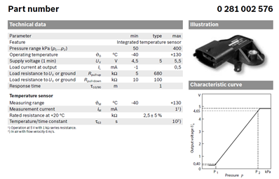

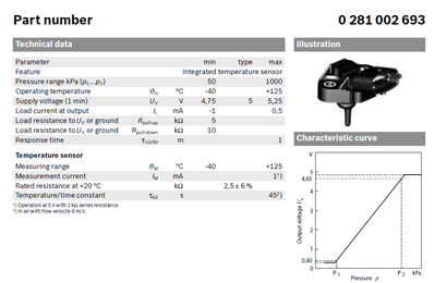

Why do you need a MAP sensor that will go to 5 bar?

I won't raise the pressure on the fuel rail that much. The pressure right now is 2.5 bar which is really low. I will just play with the fuel regulator to increase it to 3 bar. I would like to change the fuel injectors too, but the ecu drives 14.# ohm injectors. This makes it a bit hard to find larger injectors.
Did I say 5bar? Sorry, I meant 10 bar. All I am doing is tricking the ecu as you see from the illustrations. I have read that ecu can’t read above 1 bar, 1atmospheric, from some reason. These things I am going to find out when I start playing with the ecu.

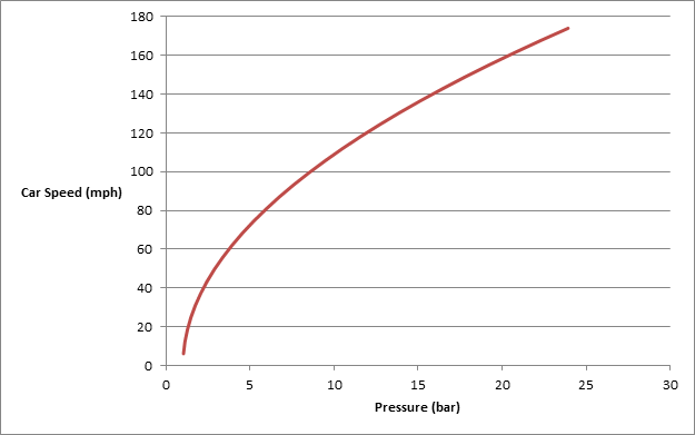

About ram induction, let’s say that we have a very large scoop making air velocity going into it considered relatively zero to the air traveling along the bodywork. Let’s say also that the air traveling along the bodywork is 80% the speed of the car because of friction forces. Taking these two assumptions and putting that into Bernoulli's equation we get this chart.
I would like to say here that this is a really liberal approximation especially at low and high speeds. However, it gives a good image of what would happen.

Just one thing, the pressure in the chart is absolute pressure not gage pressure. If you want gage pressure just subtract one bar.

What size scoop did you calculate would produce those figures?
The ECU can't read above 1 bar because it will never see a positive pressure higher than that - it's a N/A engine and the inlet pressure will seldom be above atmospheric anyway, and will only do so if there is an odd event happening in the inlet (I can't even think of one offhand), or a tiny bit above because of atmospheric conditions.

I really stressed that the figure is very liberal representation. According to the first assumption, the scoop is so big that the air velocity going into it to the engine considered zero compared to the air velocity travelling along the car bodywork. I mentioned that is no good at low speeds because the air is not travelling fast enough along the bodywork to satisfy the first assumption. Also, it is no good for very high speeds because Bernoulli's equation fails itself. Bernoulli's equation works for incompressible flows which is not the case for air at high deferential pressures. I will get you some empirical results if god may. That would be a very nice to put them against each others.
About the MAP sensor, do you mean that the ecu ignores it because it is not in the injection timings map itself. If it is the case, it would save me a MAP sensor because the fabia's can read up to 4bars!

On the ram air front, let's see your maths. I think you've made some sizeable errors. As it happens, in a former life I was an instrumentation engineer, so I spent years measuring flow rates etc in large industrial processes (actually in the nuclear industry), so I'm not afraid of a little maths, nor talking formulas, etc. I think your calculations are massively wrong, and don't think you should waste a lot of time chasing up a blind alley, but I'm prepared to be proved wrong, so let's see the maths and see what's what. Why do I say this? Because all practical experience points to it, particularly in the field of motorbikes where I spent a fair bit of time in the past; ram air boxes etc didn't provide gains of even a fraction of the order of magnitude you're talking about on machines doing 160mph; I think it's unlikely to work on a car doing half that.
The MAP: The ECU ignores it because it will never see such figures. It's not uncommon to see people replace MAP sensors with ones with similar output characteristics in the original pressure region but with a higher maximum pressure, but that's when using forced induction. The standard ECU on a Fabia may come with a MAP sensor which could sense higher figures than it will ever see in practice (I have no idea offhand what it uses), but the ECU will not be programmed for such because of the characteristics of the engine - it may be that the signal conditioning in the ECU before the ADC would mean it would be incapable of reading large positive pressures anyway (you'd need to see the diagrams to have an idea about that). If what you say is correct, then that's would indeed save you the cost of replacing it, but I think it's the least of your issues here - as said ages ago, you'll need a programmable ECU if you want to do anything worthwhile anyway.

About the figure, I am very sure of it if the flow was water instead of air. Anyways, I will find a way to send you the EX sheet. It isn't anything fancy believe me.

It's actually much more complex than the sheet you sent me, which also ignores the outflow (i.e. going into the engine) - that is a considerable volume of air which would flow out of any ram system. Rather than work it out from first principles, I did a bit of searching, and found an interesting post on the subject, which I'll copy and paste here:
