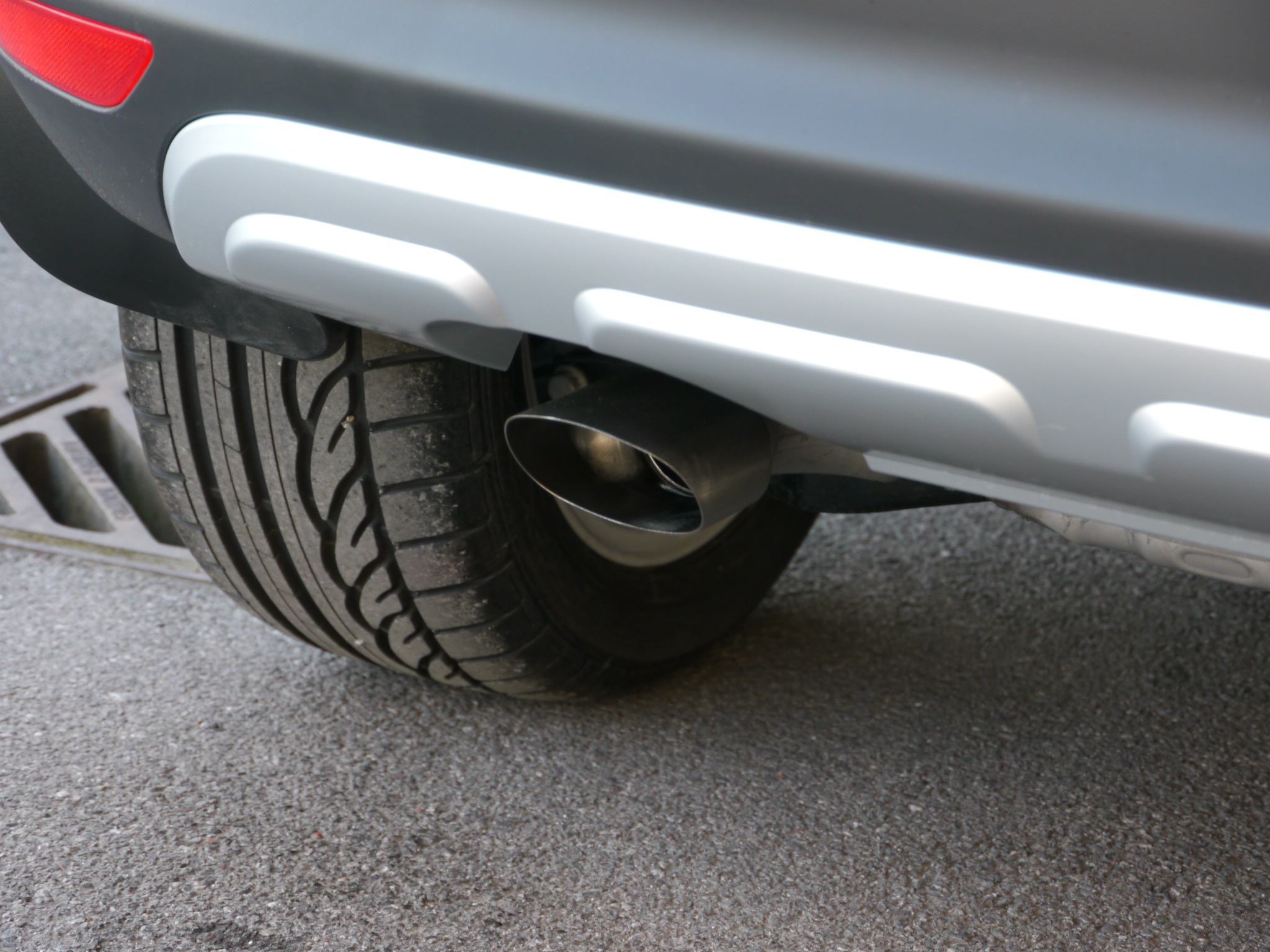

Every Yeti I have yet seen, from 4x4 diesel models to 1.2 petrols has had the twin tailpipe set-up that is basically in every picture where they are visible in the brochure. Including the chrome pipes option in the accessories brochure. A recent visit to a dealer I saw a 1.2 petrol with twin tailpipes. I couple of weeks later I went back, and the showroonm Yeti, still a 1.2, had been replaced, and now had a single large oval tailpipe. I mentioned this to the salesperson who replied with "they must differ based on what engine it has". Now I know this cannot be true. Does anyone else know if they are all being changed as standard - I assume these things can change based on supplies etc, but the exhaust seems such a part of a car's character that I'm surprised they would change something like this on a whim.

Mine is an August 2010 model, and has the single pipe. They moved the jack and tools to under the spare wheel, and changed the exhaust at the same time, all the 1.2's are like that now as far as I know.

The 1.2TSI switched to a single pipe WK22/10 due to a new rear box being required when the Tiguan floating rear assemble carrier (sub frame) was replaced with a cheaper and simpler Golf rear frame on the 2wd models. This change also effected the other 2wd engines but they retained the twin pipe arrangement. Also necessitated a repositioning of the tool box under the spare wheel as the new exhaust occupied the space previously used for the sub-floor tool box.

Thanks for the thoughts guys, especially such a definitive answer from plumber. I think the oval pipe looks suitably chunky, but does the 1.4 still have the twin pipes? Is the chrome trim available for both types of pipes?
My 1.4, delivered end of November 2010, has the twin pipes.

Confirm that a 2011 1.2 TSi is a single pipe.
