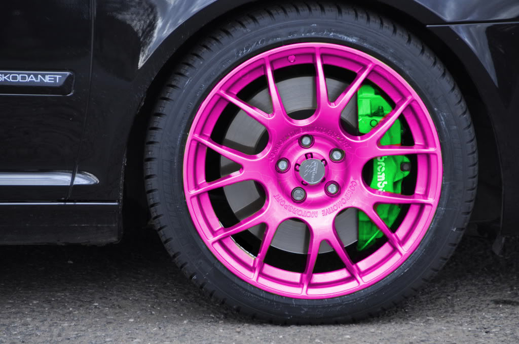

IMO they look good too, even with gold wheels :thumbup:
They look awesome imho, not sure about the row of weights on the wheel rim though!! :no:
There is always this option, if you have an 'in the closet moment'...... :rofl:
They look great. Did they fit on standard carriers or did you need to get some custom ones made? I read somewhere that getting the right size rotors can be difficult too?
From what I can remember they fit on standard carriers, I certainly didn't get any custom ones made
