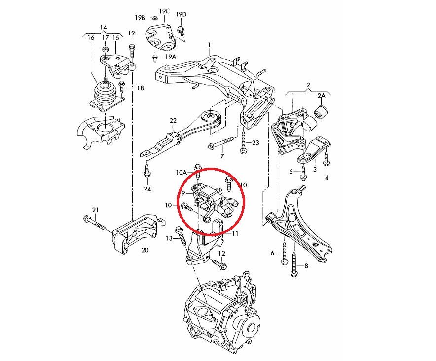

I now have set of engine mounts to fit.
I just need to get the gearbox mount now for the full set
I'm still on original PD100 mounts, but they seem up to the job, and its the lower engine mount movement which can kill the top mounts. So I think me fitting an ultra-soild bush down below (sounds so wrong! :D) has preserved the top mounts. I know there are kits out there for £200 odd, but I'd sooner spend on something else more fun :D
The last run at the pod i could here the engine/gearbox clunking on the gear changes, and at Mallory i could here the same when downshifting whilst stomping on the stop pedal. So i guess mine might well be on the way out.
Makes sense to do tem all IMO. Ive heard them in Jamies car and they are abit OTT when the car is initially turned on from cold but once warm you will hardly notice them
Like a little matchbox car :rofl:
What would those engine-mounts retail at?
